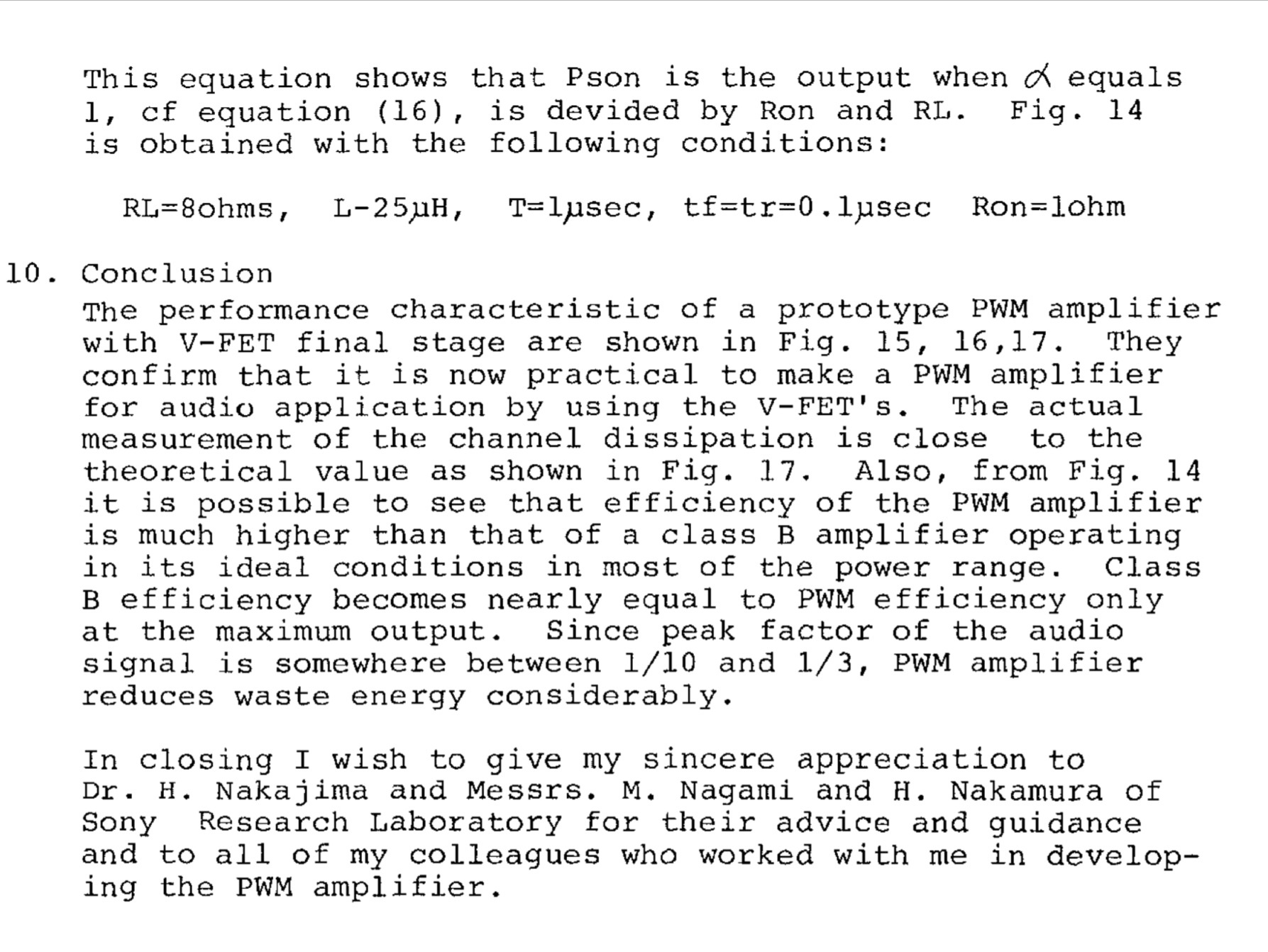

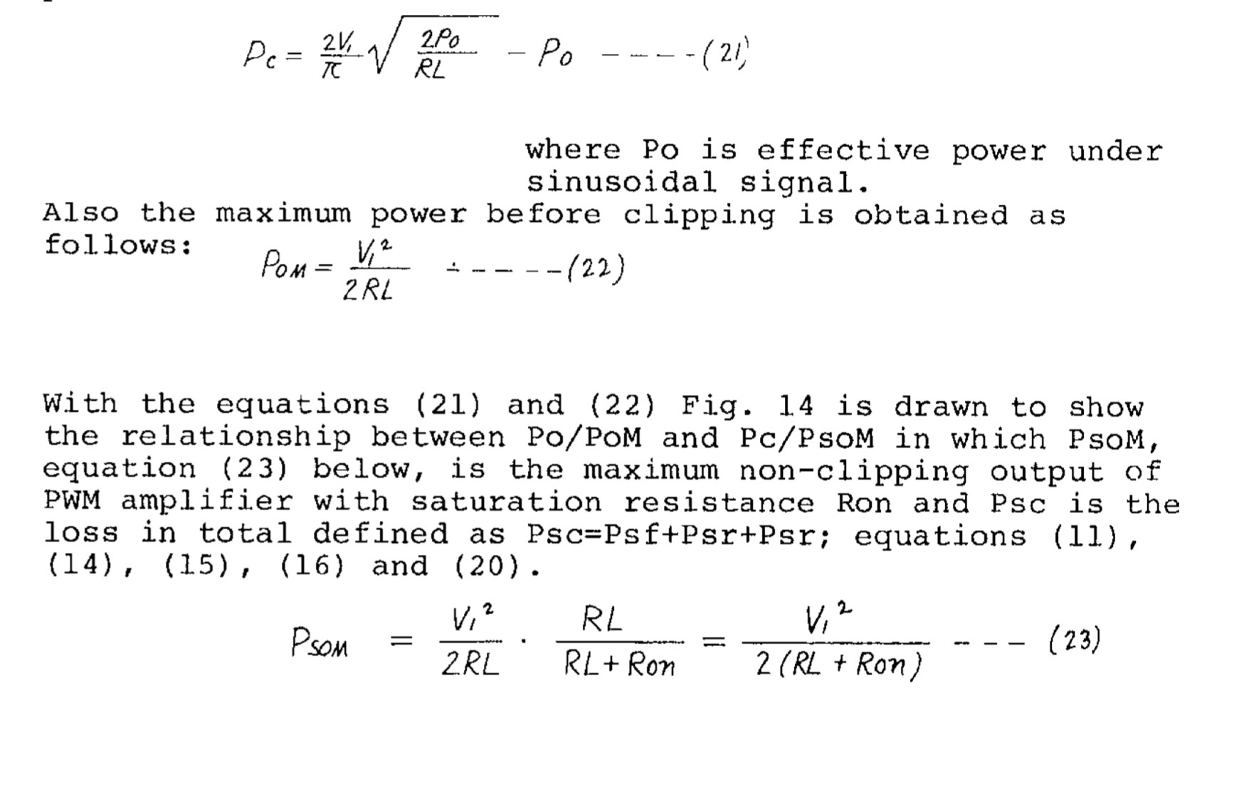

I was curious about R=1 Ohm of 2SK82
mentioned in datasheet from post #151.
Apparently this Ron is Vfet saturation resistance value.
