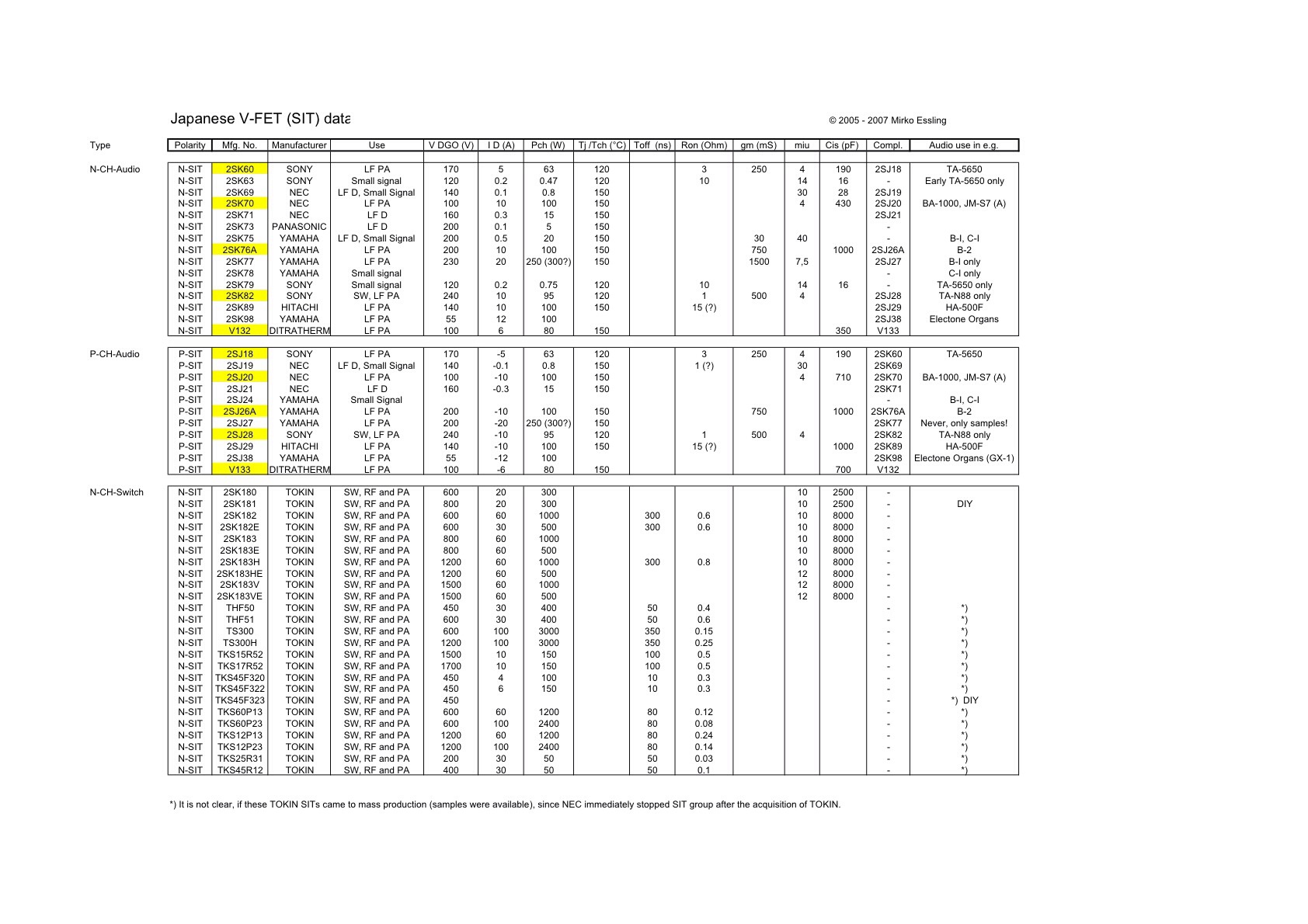

I'm happy to see that the Tokin SITs might be at least semi-legit. I might buy some, I might emulate them with big mosfets....
Generg have inspire Wrenchone to play with Tokin's.
After emulation amp name from Vfet it be V'fake ?

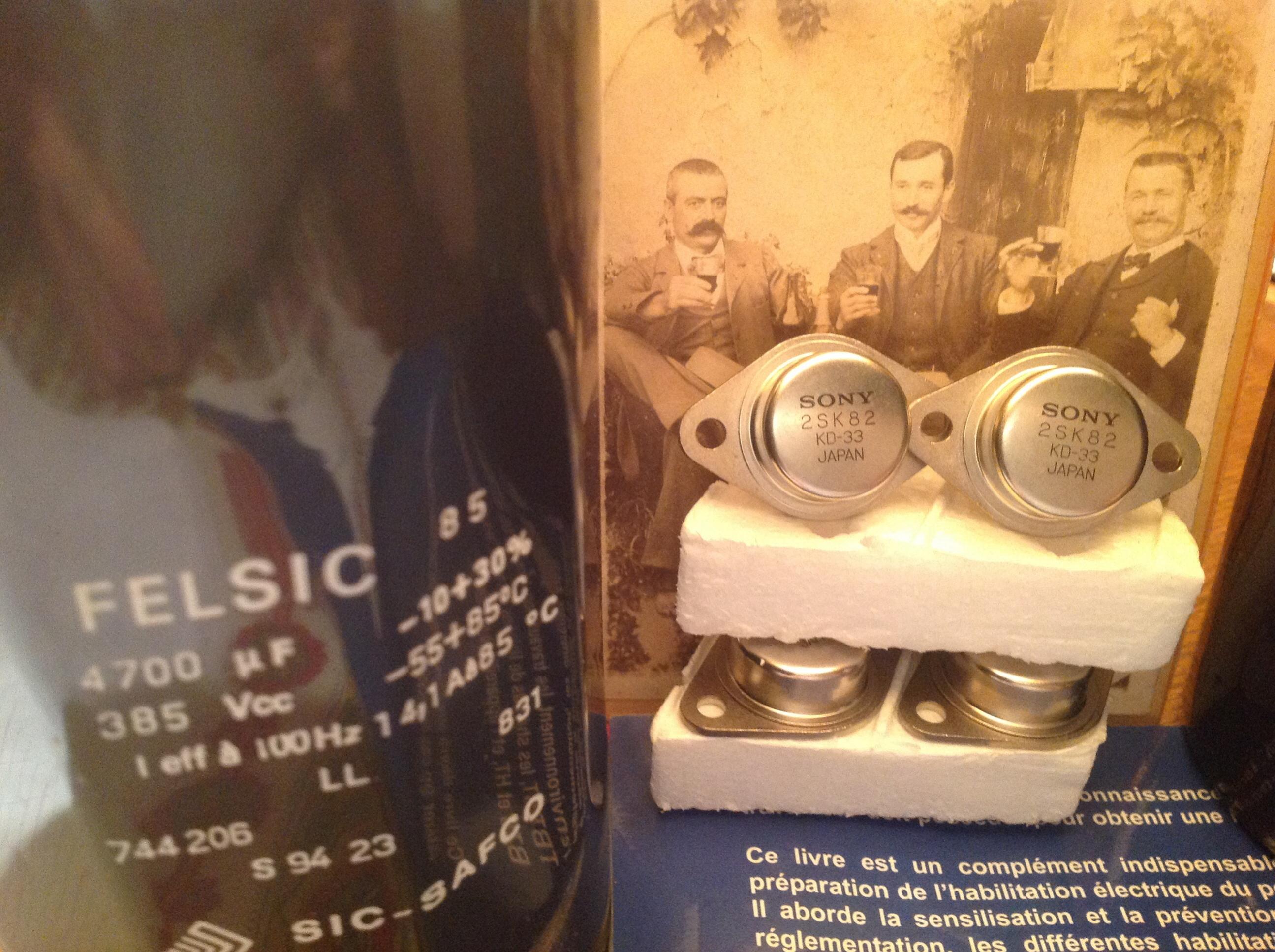

I must wait to run Vfets hot and collect parts to be ready.
In spare find caps 4700uF | 385 Vcc for Ironamp prototype is to much ? Voltage normaly 160 Vcc it be around four time.

this caps are perfect for the job , better be safer than playing with fire like me with 35V power cap with 34V rail 😀

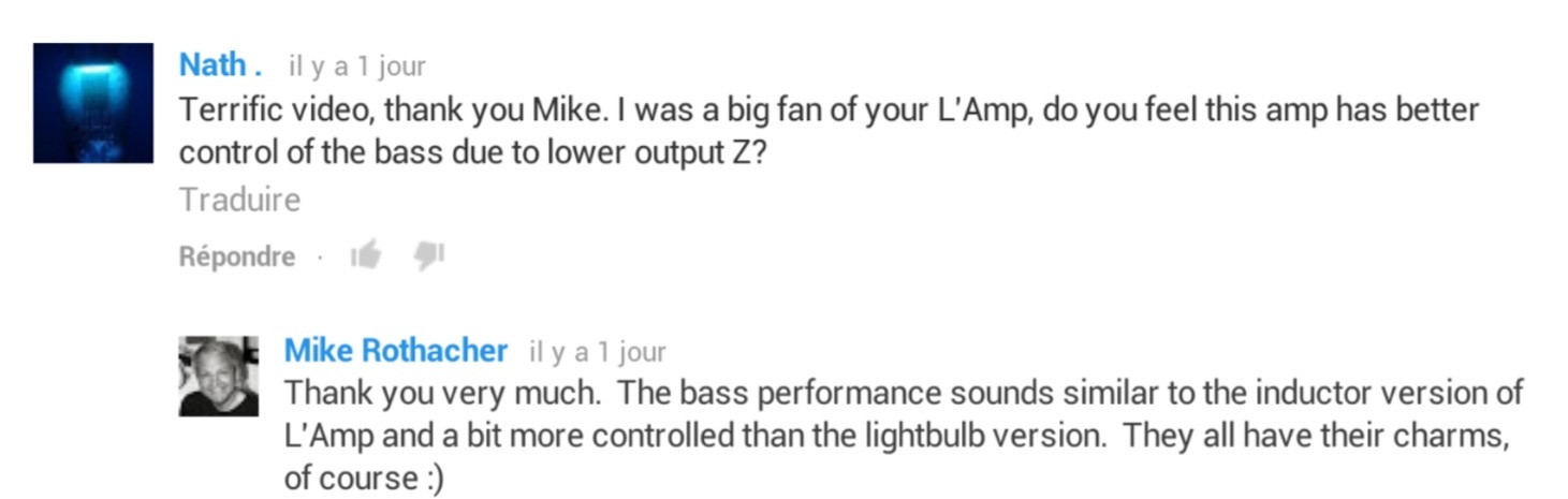

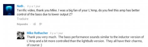

finally on the sound side the CSX1 ( single ended mod ) is the most pleasant of the 2SK82 sitamp i have built . the only concern is about the shy bass . bass are there but with no punch or power has i had with the inductor SITamp .. so i have two way to search , changing the 600ohm input transformer with a 10K 1:1 and search a better CCS load than the 2SJ28 ..
what about the bass with the Ironamp and it"s transformer output better damping i presume ?🙄
Let's come back to Ironamp 😀

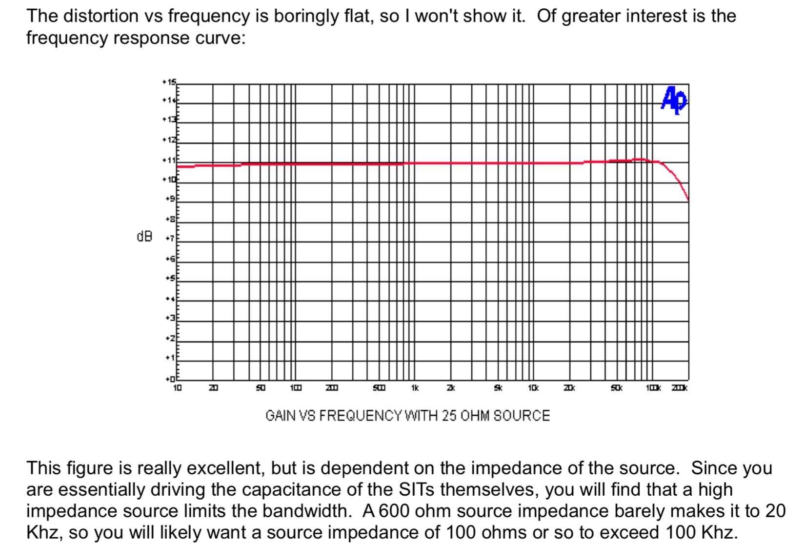

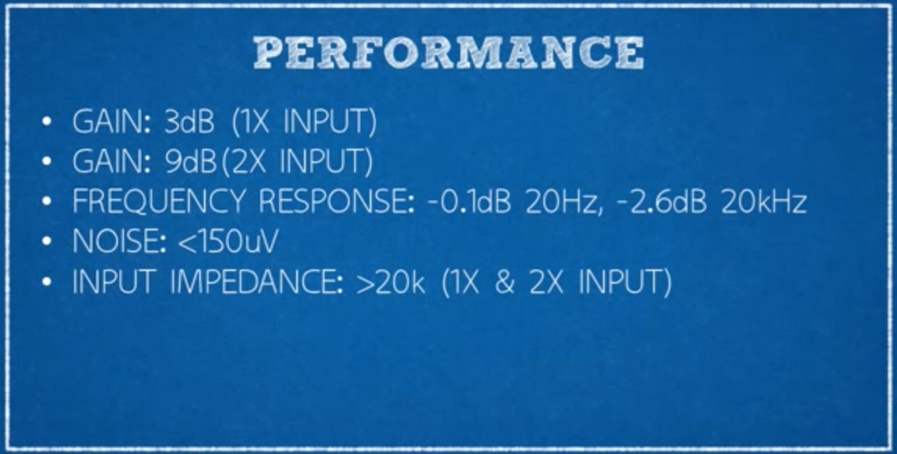

20Hz have -0,1 dB roll off so is great score for low frequency response. Damping ??

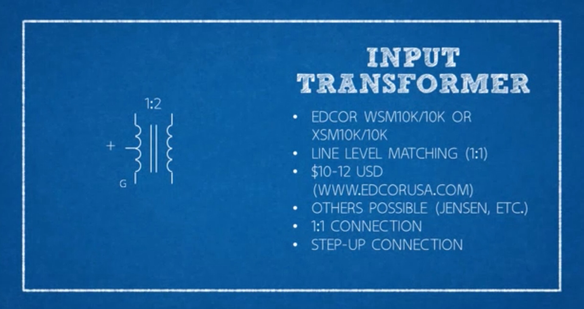

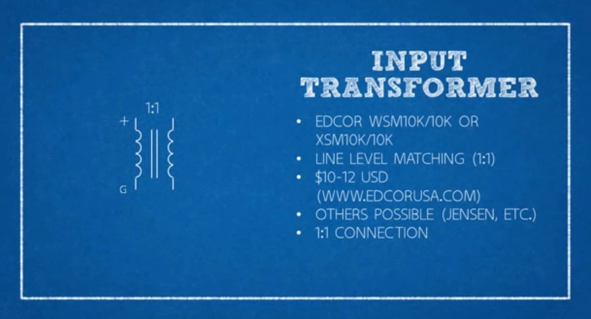

Two amp's Iron and Sony have possibility to configurate primary
maybe this is game to play.
Joint images extracted from Mr Rothacher video.

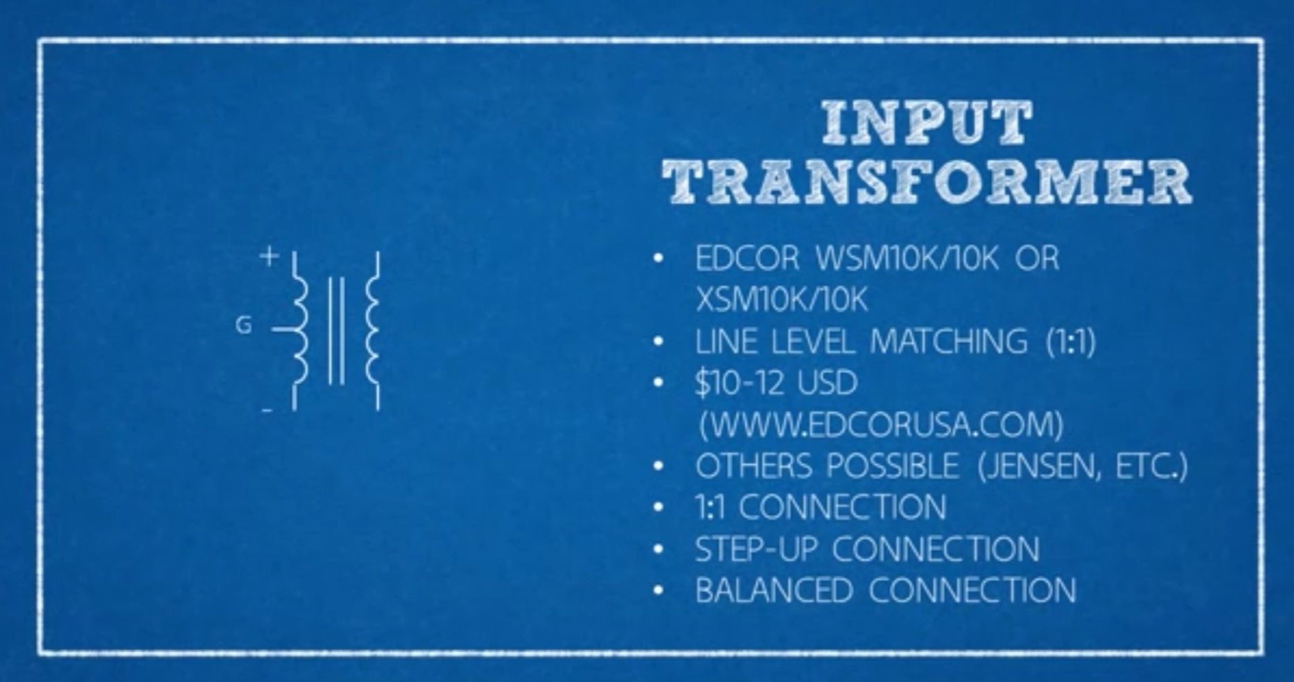

i have a 1:1 cinemag for input

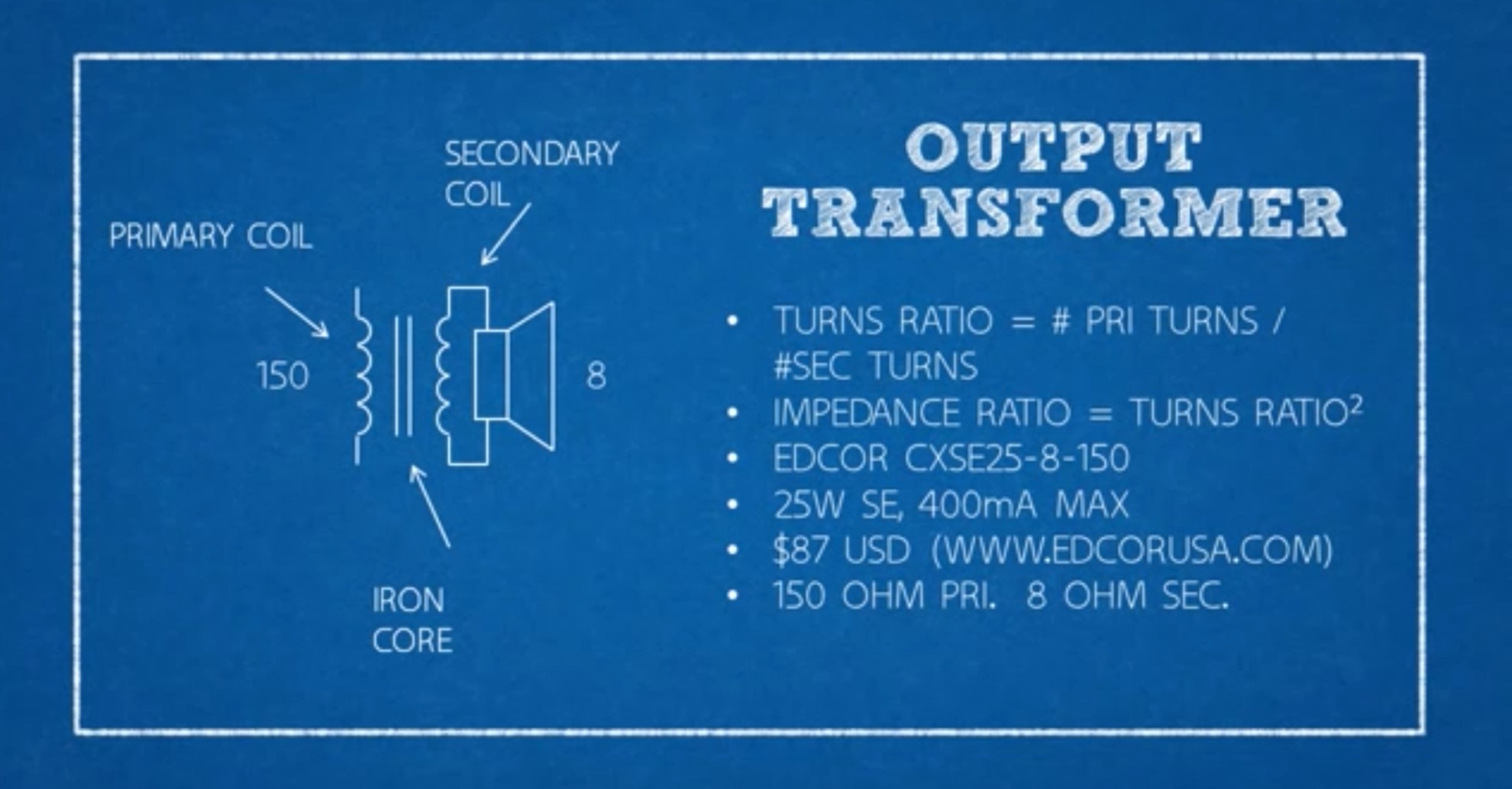

and the last but more important is the output power transfo..
what will be the best primary resistance value for the 2SK82 with 95V on it?
Hi Juanitox

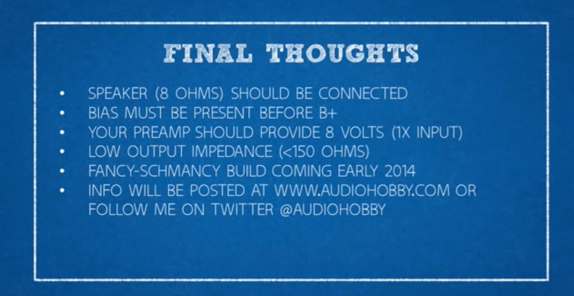

On schematic output transformer primary have 150 Ohms
with 8 Ohms secondaire but 100 V tension.
Imho if Mr Rothacher made this choice it was calculated
around best sweet spot , why make modifications ?
Lundahl distributor in France give you informations
contact him if interested correct prices :
Lundahl1
contact e-mail : info@ceresaudio.com

i think michael use 150ohm because he find only this kind of primary on the market transformer avalaible. you can use a 7k transformer to load a 300B but it will not sound a good as a 5K or 3.5K.
that"s why i want to know the internal resistance of the 2SK82 at 95V to make the right custom made transformer 🙂
From last update Michael say he was wait for specialy made
Edcor for this project output transformers 🙄

Sorry after verification this morning from update Ironamp video and is about customised INPUT transformer.
Probably output signal transformer data change too ....wait and see.
