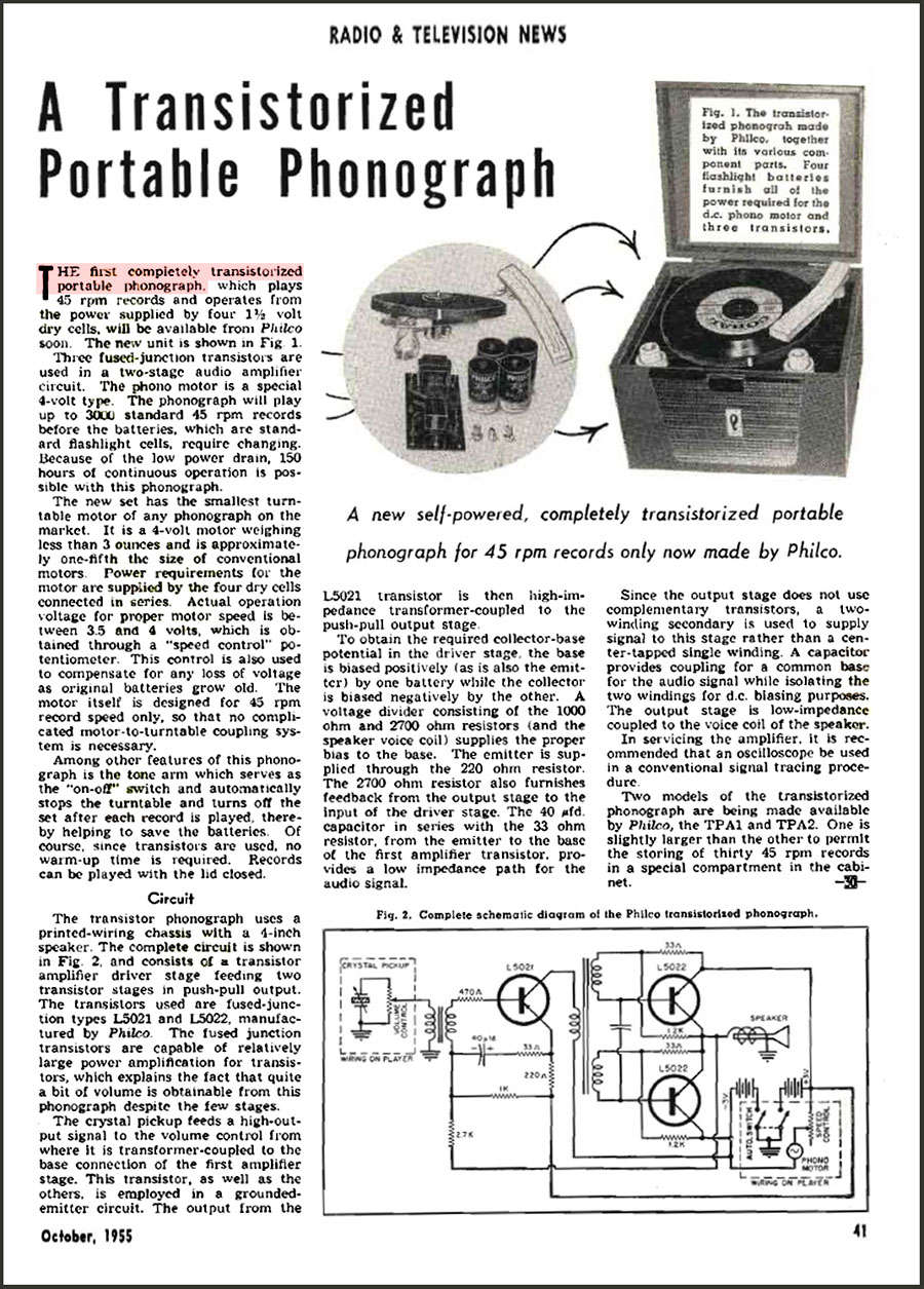

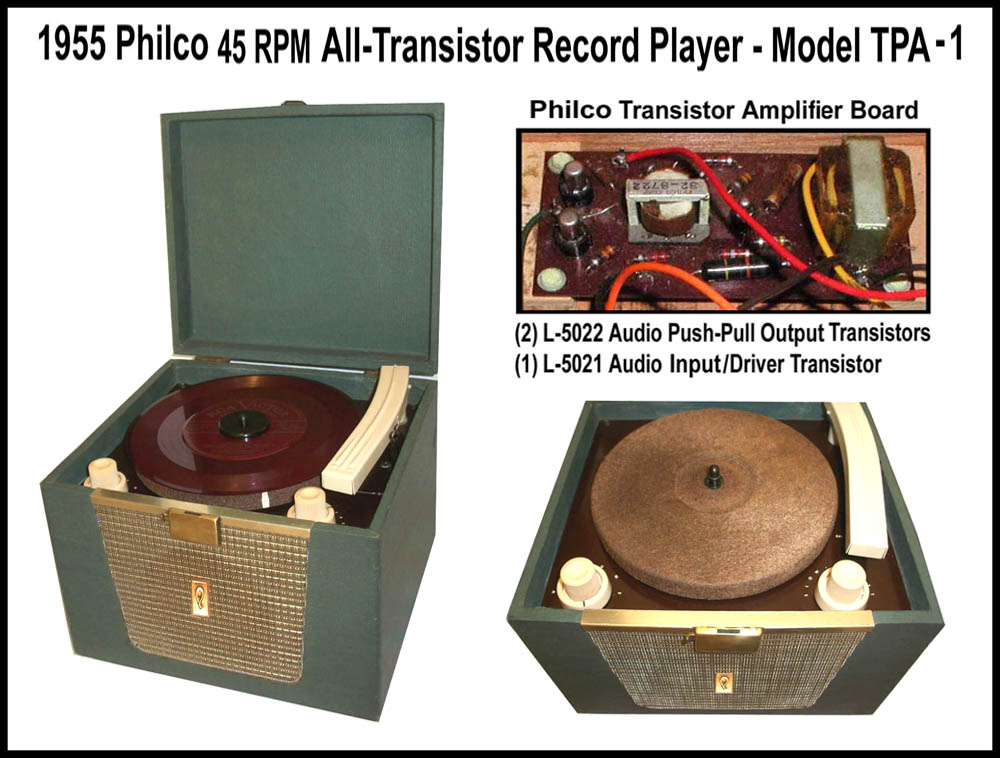

In early transistors days we have see interstage transformer coupling
solid state amplifier in commercial phonograph from Philco
that is fun to read page with topology explanations from year 1955.
Iron was commonly used and little count of components
i like it ...and though updated to "modern" era can give purer sound.
For better vue please zoom on
Best regards
Ok Philco is push-pull one 🙂
Was just inspire me to think how much complicated be make
parallel single-ended Ironamp with twice of power ?
