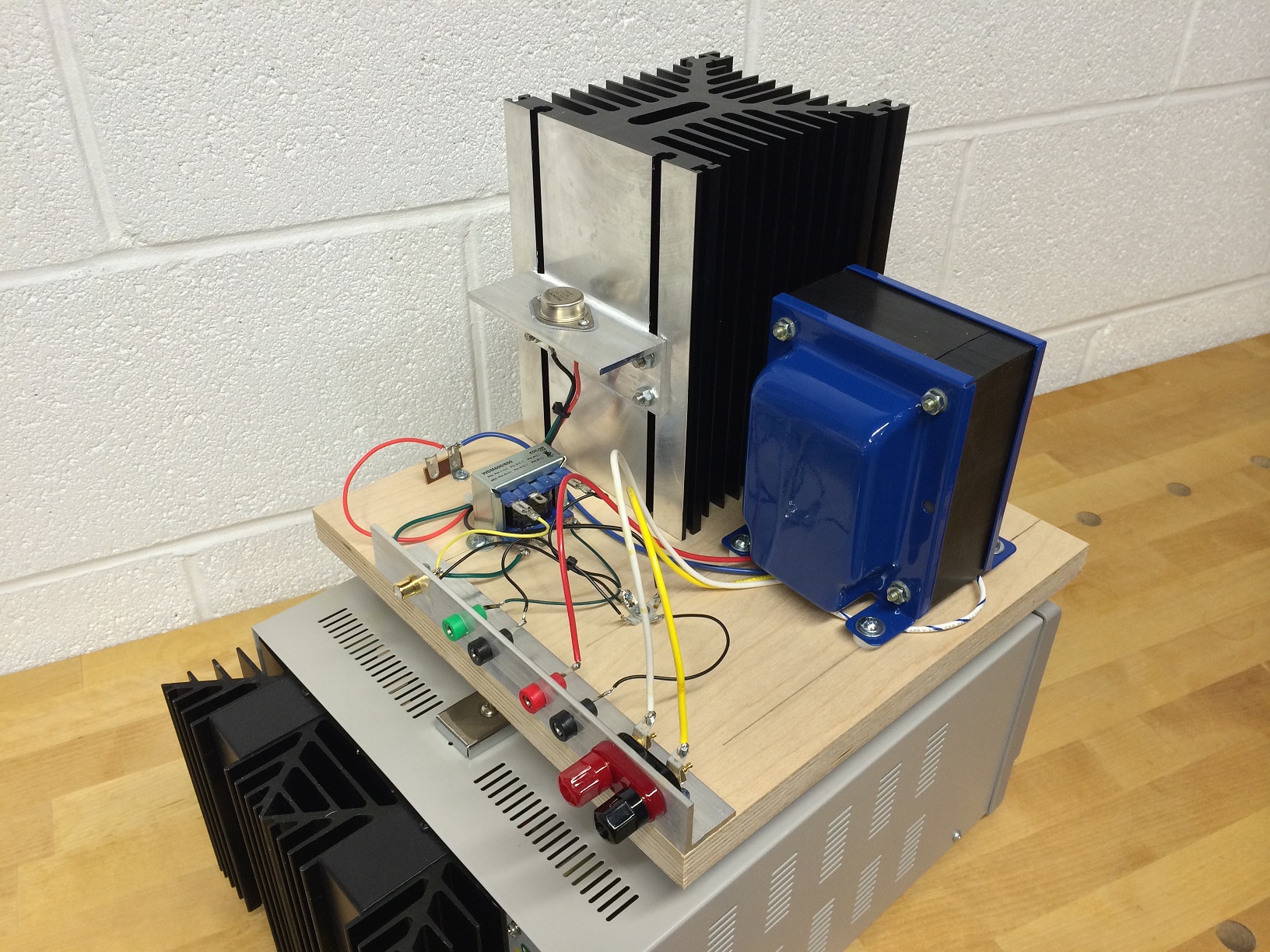

Naked prototype shot:

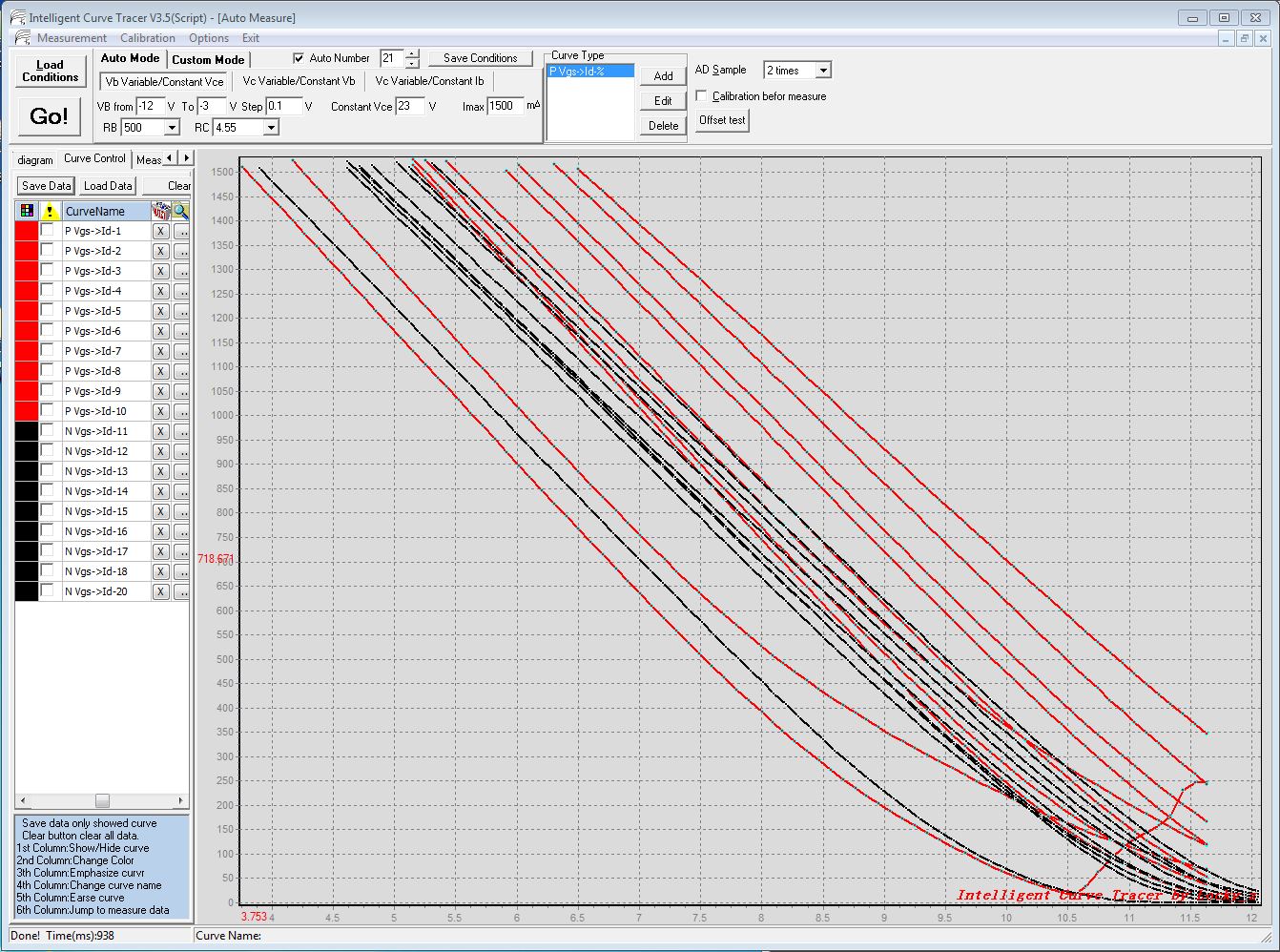

I have measured as good as I could ten SJ28 and nine K82, so I dare to say that at 1,3A for instance the working point of Papas Push-Pull they differ around 4V.
So Mike it is really good to have some margin…..
there is one SJ28 KF instead of KE but he is not outside…….
As far as I remember the KE and KF was a pinch Off voltage and this marking seems not very important for matching for Iron AmP or the SONY AmP…..
Of course my input data I choose for the tracer are self-made without any deeper knowledge….
I am always happy to see at least a curve…..
the picture shows in red the SJ28 and in black the SK82..
So you see that it is possible to find close pairs!
