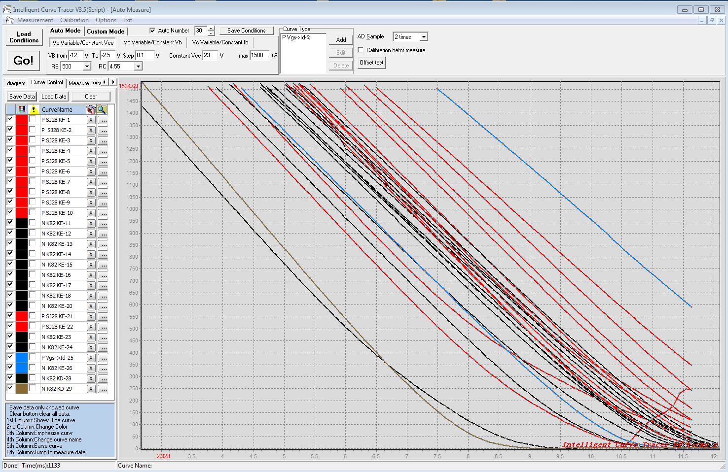

some postings back I wrote….
"There is one SJ28 KF instead of KE but it is not outside…….
As far as I remember the KE and KF was a pinch Off voltage and this marking seems not very important for the matching of Iron AmP or the SONY AmP….."
i wrote this because the one KF I had was embedded in the KE lines…
But the SK82 KD I used for Mikes L´Amp clearly needs lower gate voltage for the same drain current….
So the classes are important, sorry…only the one KF seems not to behave correct….
in the picture the two left curves are the KD….!

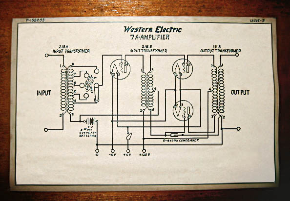

Early period amplifiers like 7-A from Western Electric
have transformer coupled inter stage

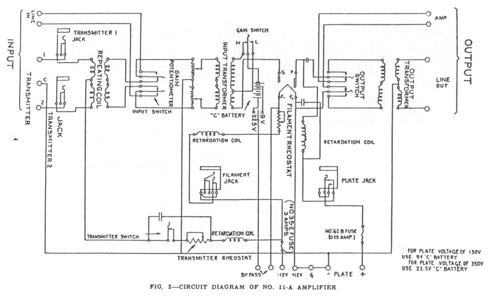

and 11-A be another interesting single-ended iron amplifier
Western Electric - Rosetta Stone for Triodes
Hope You enjoy !

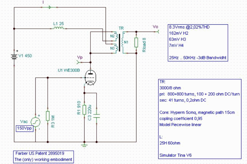

Compensated Ironamp?
Temptation to build a SIT ironamp is high.
However, apart from the semiconductors it is an entirely new amp compared to one of the known L'amp versions and it requires major investment. Do we really need to go the whole nine yards to experience SIT with transformer output*?
After rereading the articles in «*L*'Audiophile*»concerning the NEMESIS amplifier, i came across the «*Compensated Nemesis*». Also rereading the blog from 2005 «*DC compensated SE output transformer*» i thought i would share what i came across, since not all of you may be fluent in French.
The result is that we may be able to do an ironamp without buying a SE output transformer.
Those who allready have a L'amp version could use their power supplies.
Those who have built the inductor version of the L'amp might be able to put their chokes to good use.
Those who have spare heat sinks can do a CCS version.
In «*L'Audiophile*» Pierre Johannet presented the «*Compensated Nemesis*». It uses a gapless output transformer (actually a mains transformer) with flux compensation (CCS version). (translation of the article attached)
In the blog «*DC compensated SE output transformers*» entry #122, plovati posted a proposal for a version with a choke. (cf. Attachment)
I prefer the inductor version over the CCS but care must be taken to guarantee more or less equal currents in the windings...
Best regards
