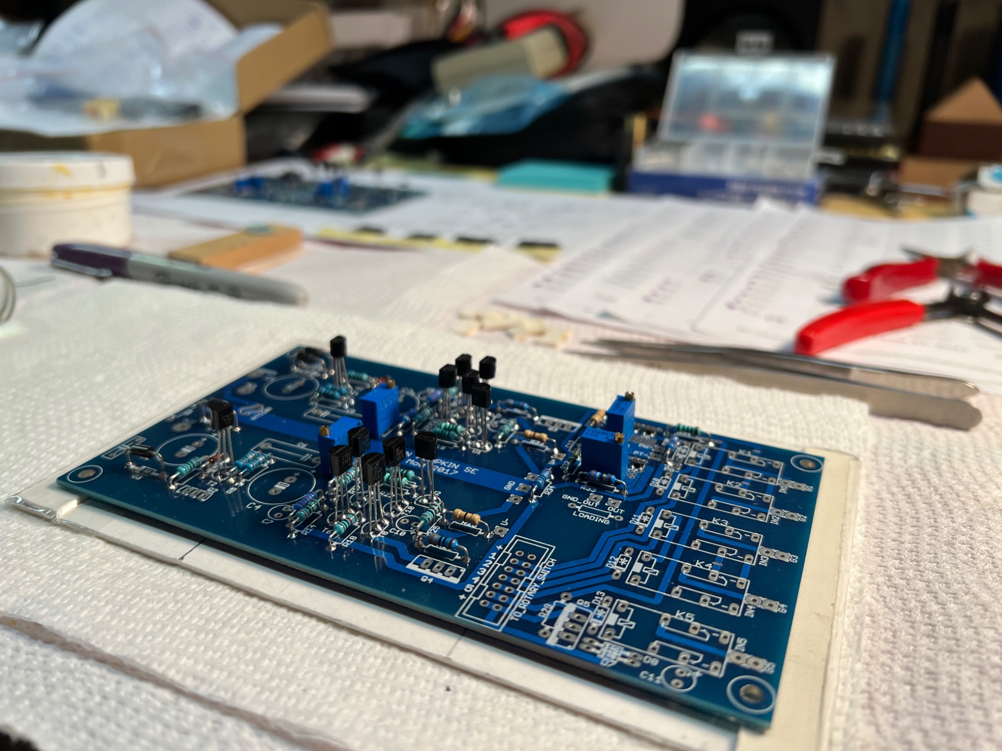

The Iron Pumpkin is coming along slowly…sometimes just a few parts at a time. It’s not easy to be hunched over the bench for a long period of time.
I didn’t realize how long it’s been since I ordered the original Pumpkin boards. Must have been before BAF 2019.
I was looking for some reference pics for my board version and had to dig through the beginning of the thread to find something the same.
Oh well, if I had built it right away I wouldn’t have the opportunity to have all the bells and whistles and the sexy case 😉

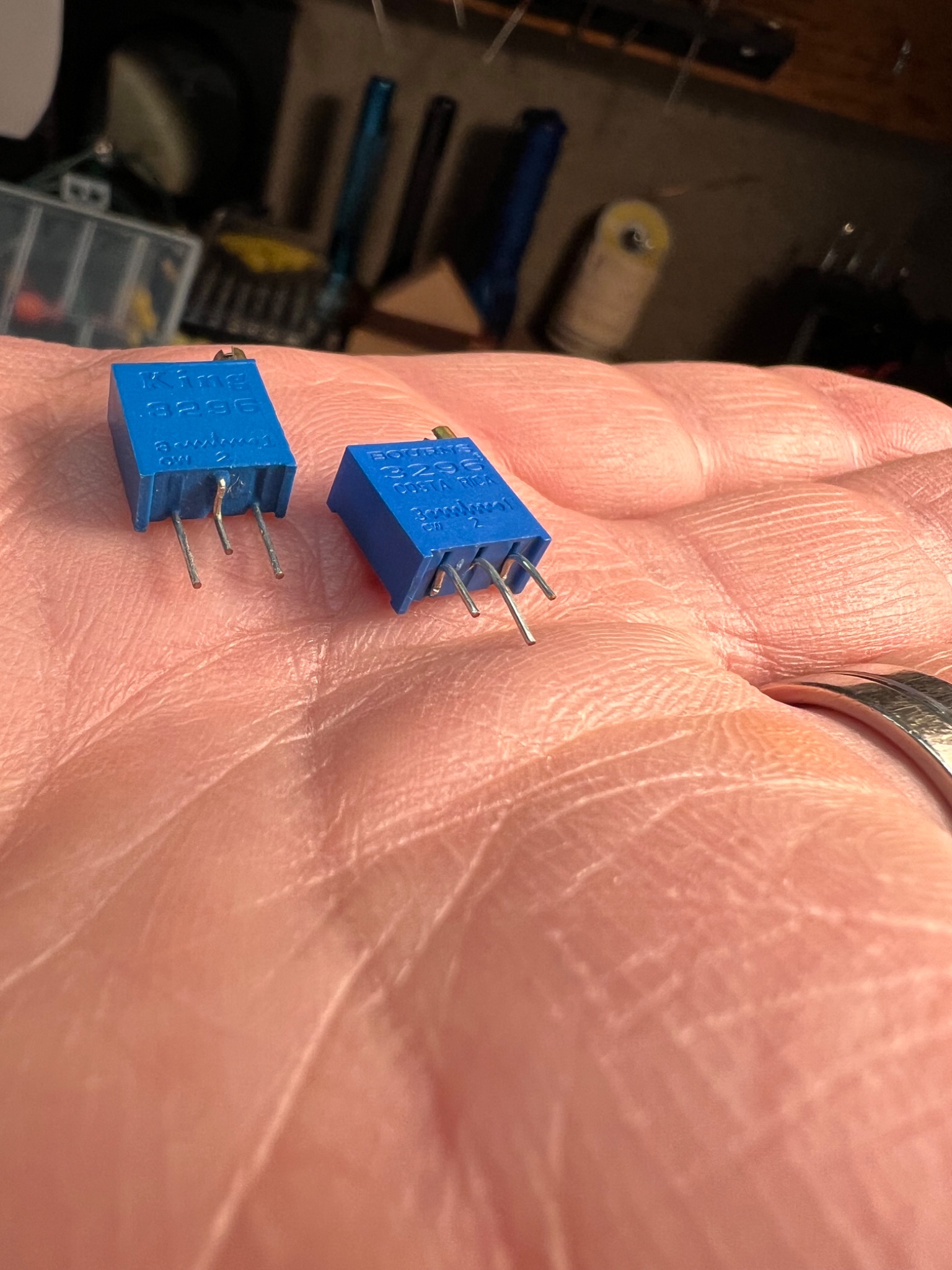

Had some fun playing origami with pot legs yesterday to try and get them to fit the footprint of the boards without interfering with resistors nearby.

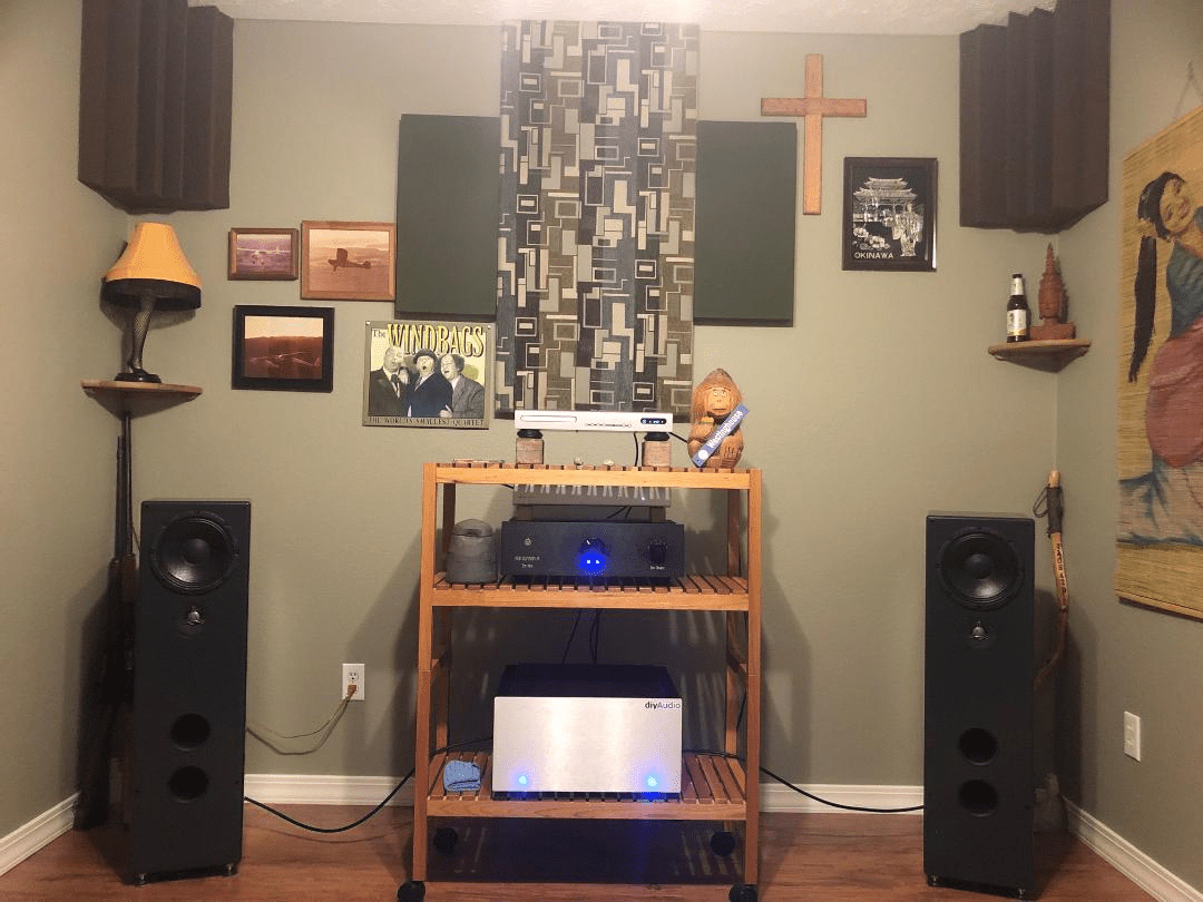

Recently moved my system to a room dedicated to its purpose, which is as a single listening position system.
Pictures are posted here as 002 is the centerpiece of my system.
CD transport - S(chitt) Urd
DAC - S(chitt) Gungnir Multibit aka Gumby
Preamp - 002
Amp - Aleph J monoblock (I know the sticker is a bit cheesy, but I felt compelled to give the community some recognition.)
Speaks - Tekton Lore Reference w/Be tweeters, full parts upgrade package

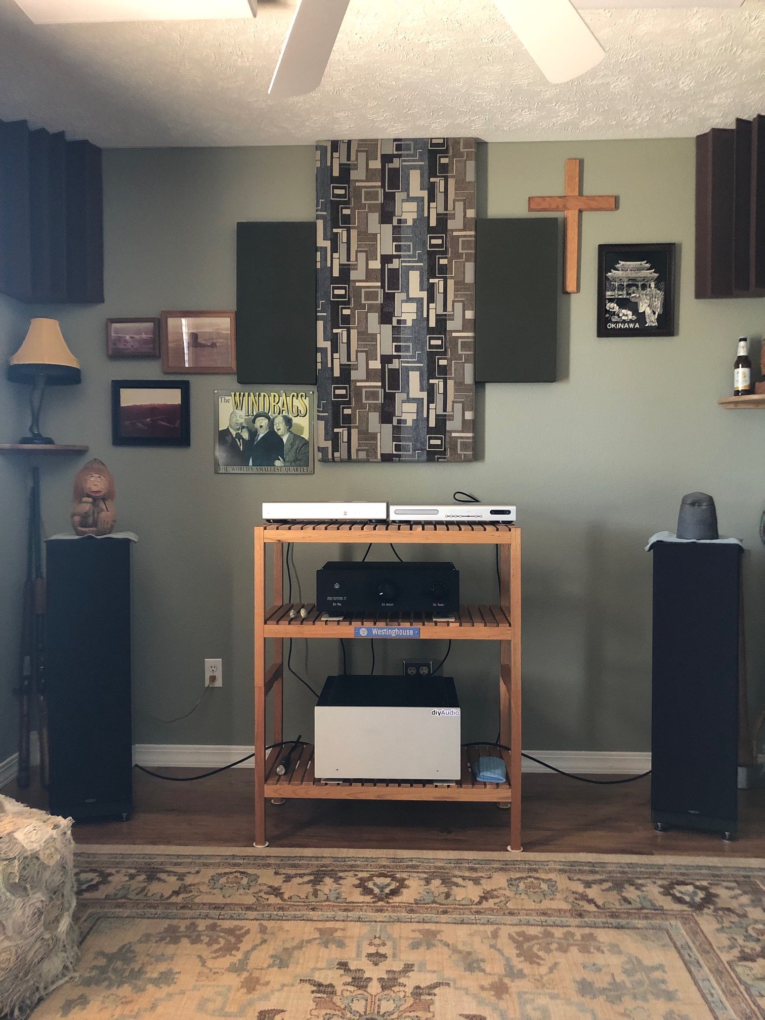

Recently decided to see if there was anything to the "never stack components" maxim. Been meaning to for some time, but the system sounded so good, it was easy to put off.
I am still trying to comprehend how as little a change as can be seen in the before and after pics can yield such dramatic results.
Nothing new was introduced except the hardware store furniture sliders in place of the casters, just rearranged the components using the vibration dampening pads (from Herbie's in Austin, TX) that were already in use.
SQ improvement put a big grin on my face that is still there every time I listen. I'm talking across the board better, particularly female vocals.
I even think I know now what "micro dynamics" can do for sound reproduction .
I've said before that the "music was all there", well now maybe that is actually so.
