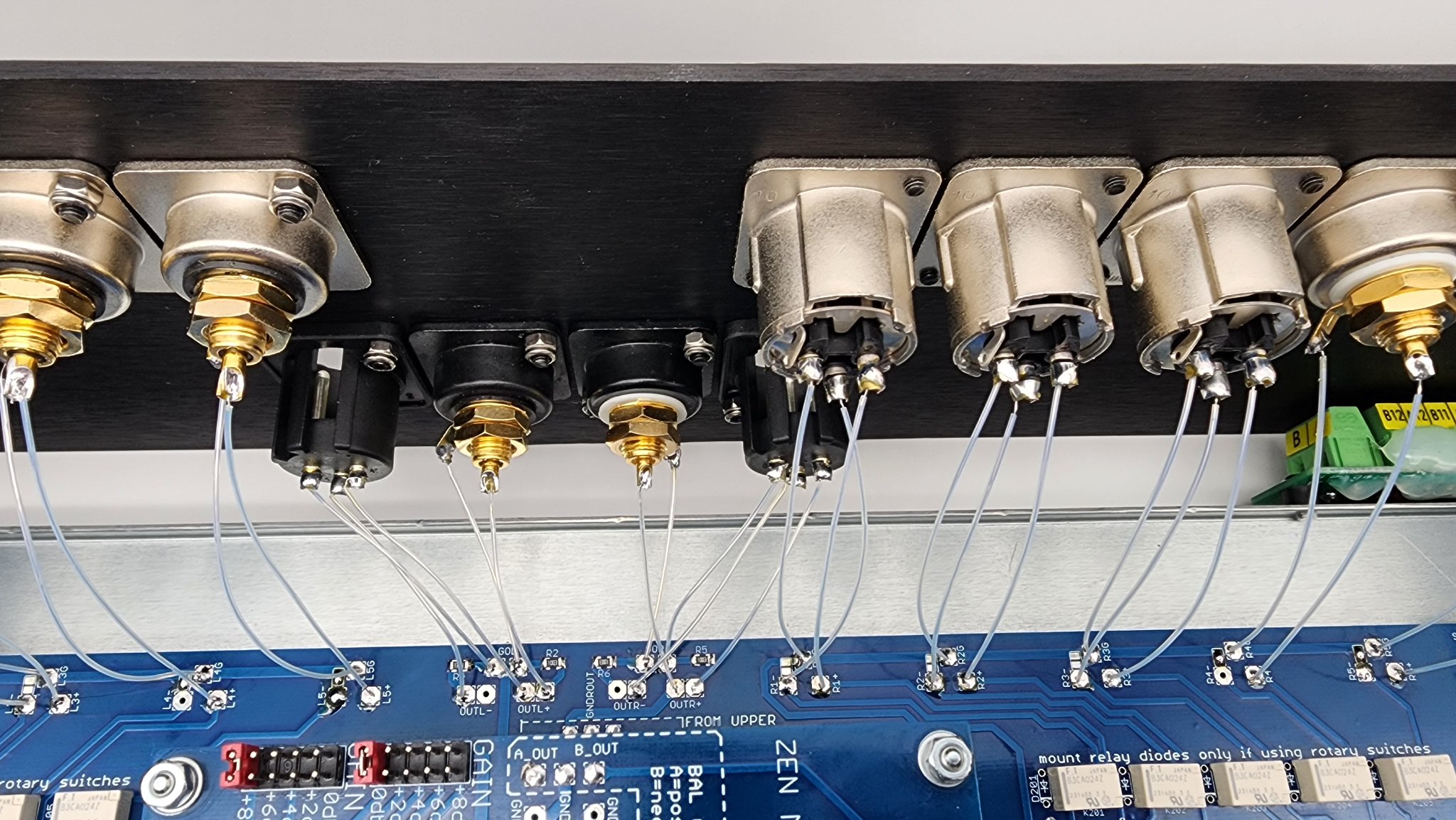

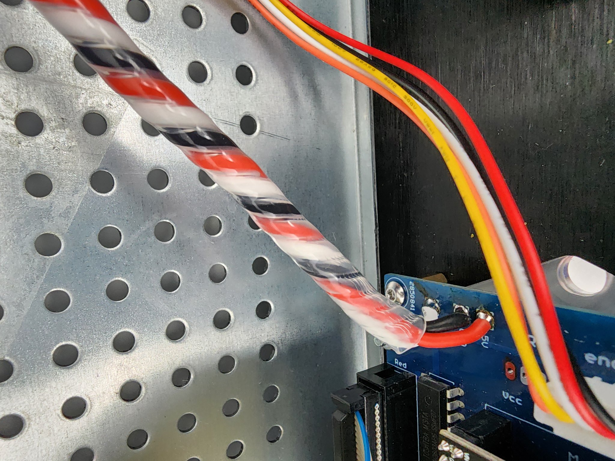

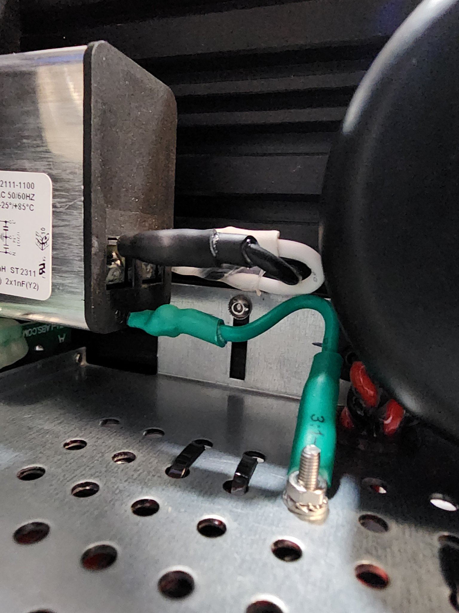

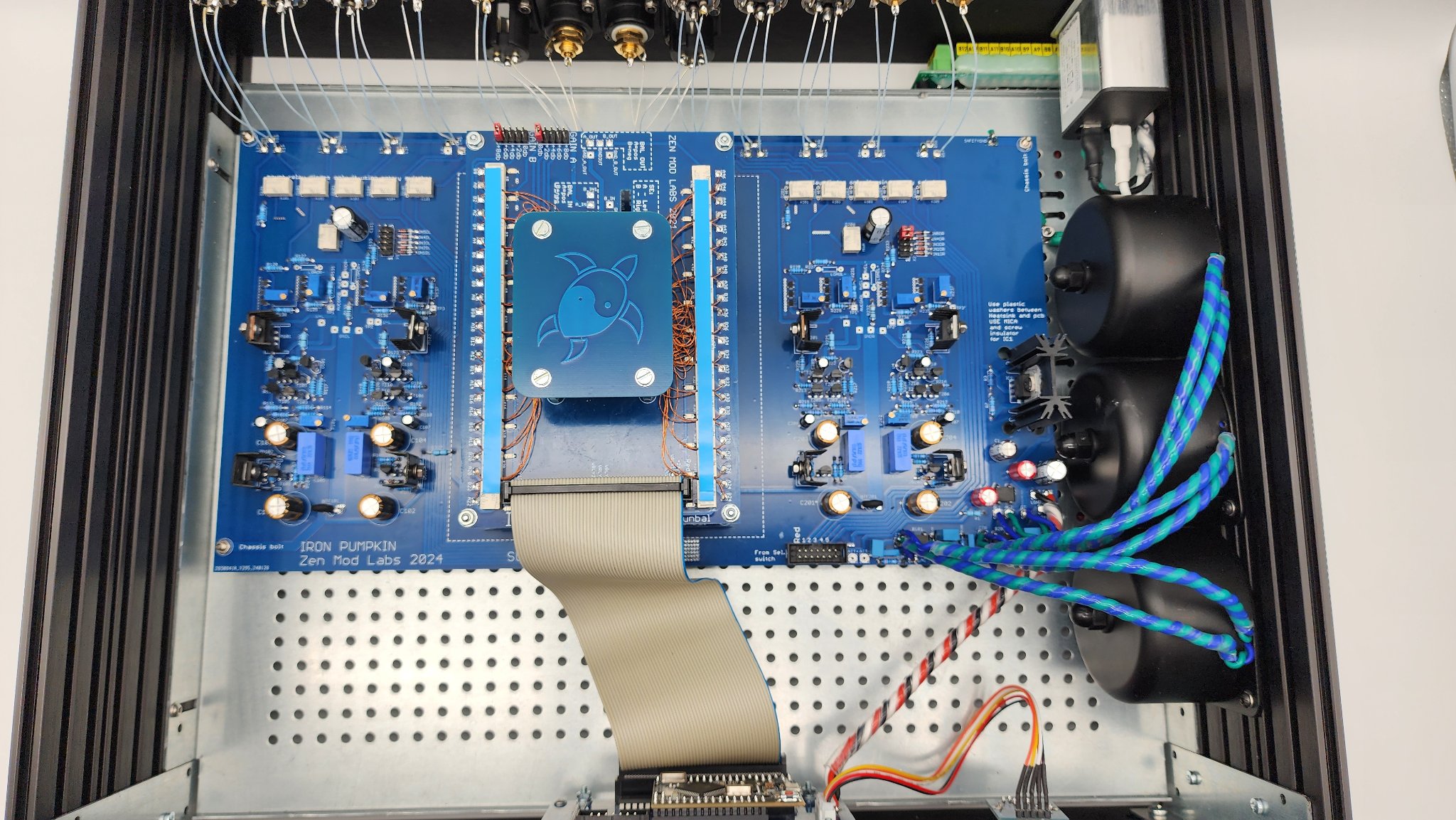

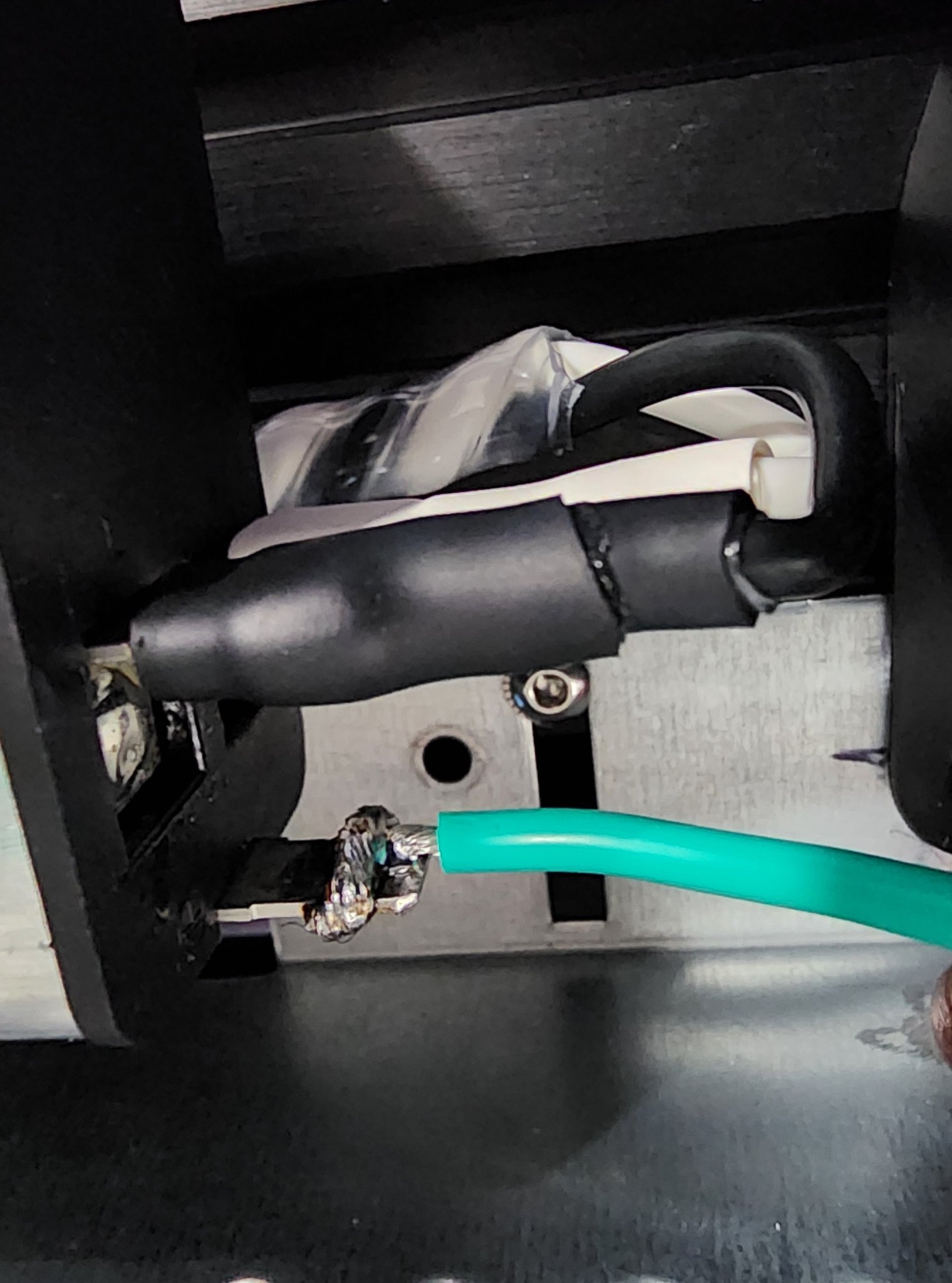

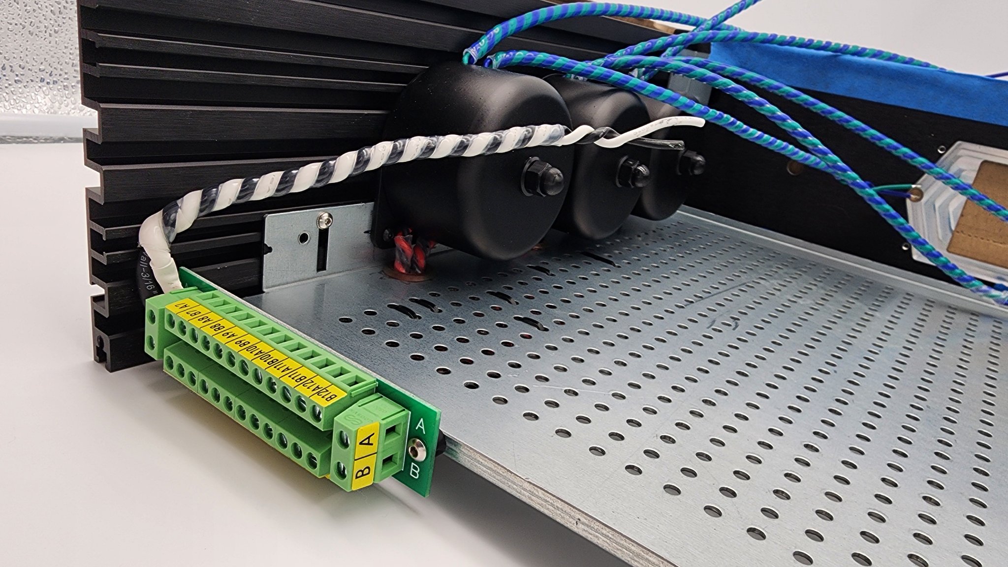

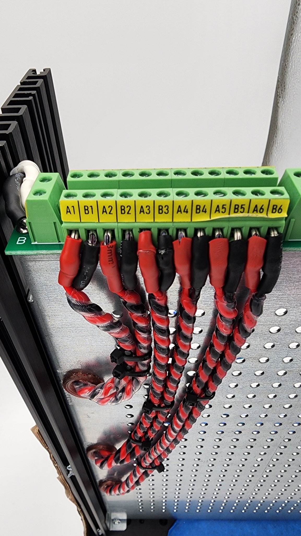

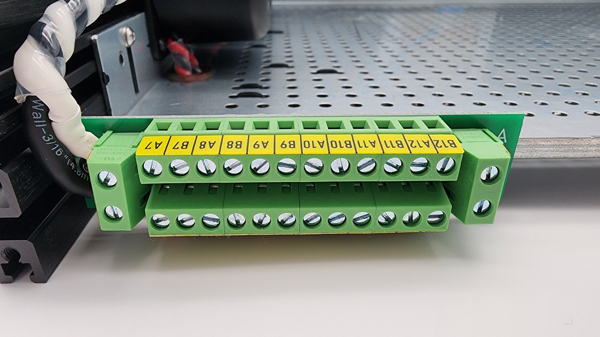

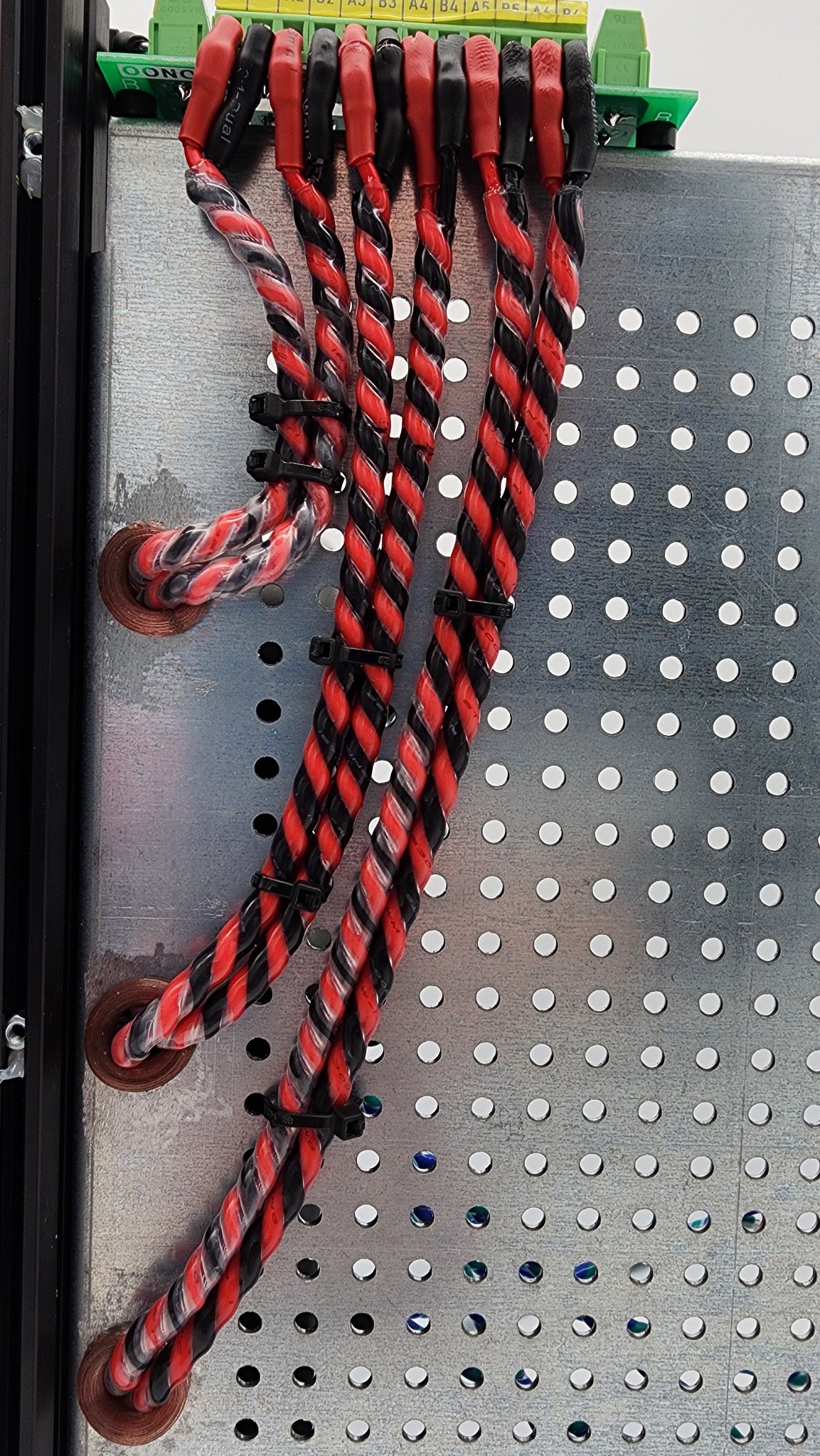

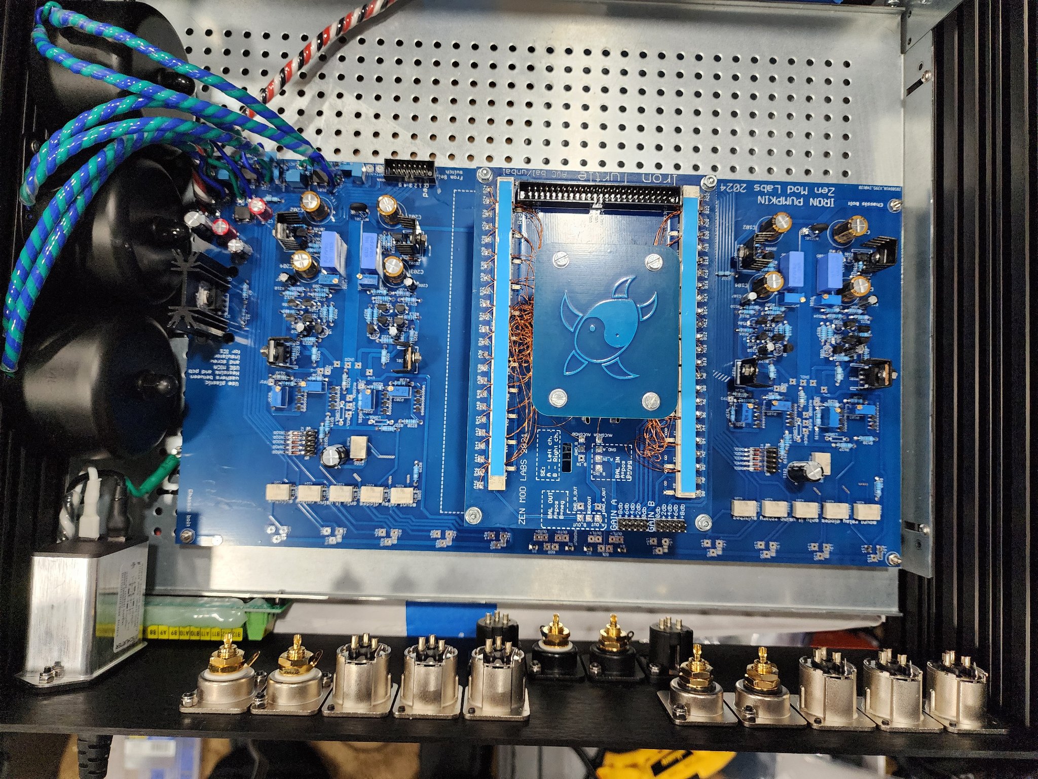

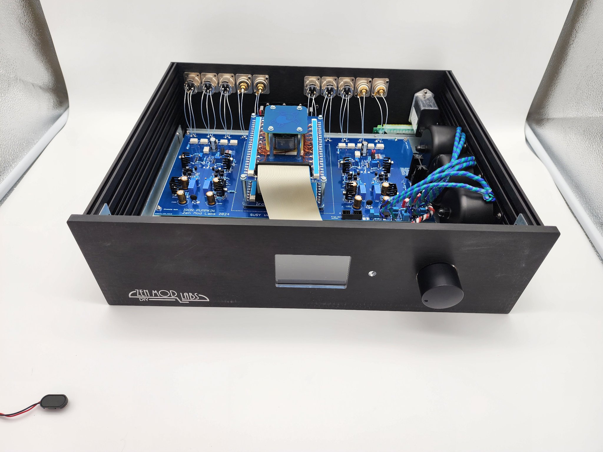

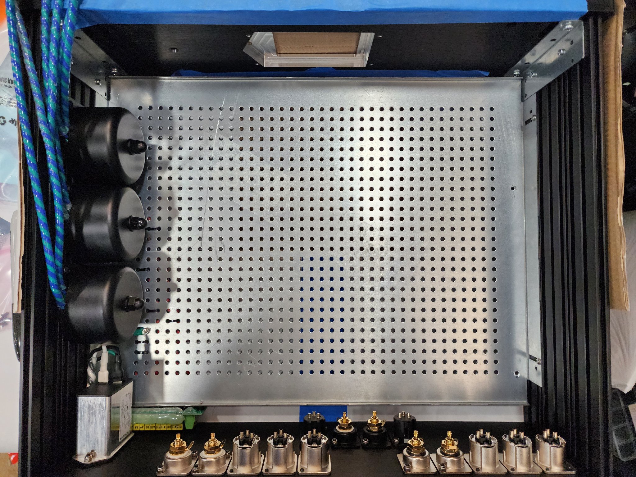

Here's some pics to help others. I went with Eric's silver wire with PTFE insulation for input/output. I will say that I would not recommend that due to the significant effort required, but it's how I chose to wire the input/outputs. If I could do it over, I'd just use good/standard insulated 28ga or 30ga wire. Other than that choice, the Pumpkin was very straight forward.....but pics are always helpful and how I was able to finish the Iron Pumpkin. The schematic, layout, and eagle BOM ensure one installs all the right components. I succeeded in all the wiring because of others photos and questions on this thread (and the tips and tricks thread)

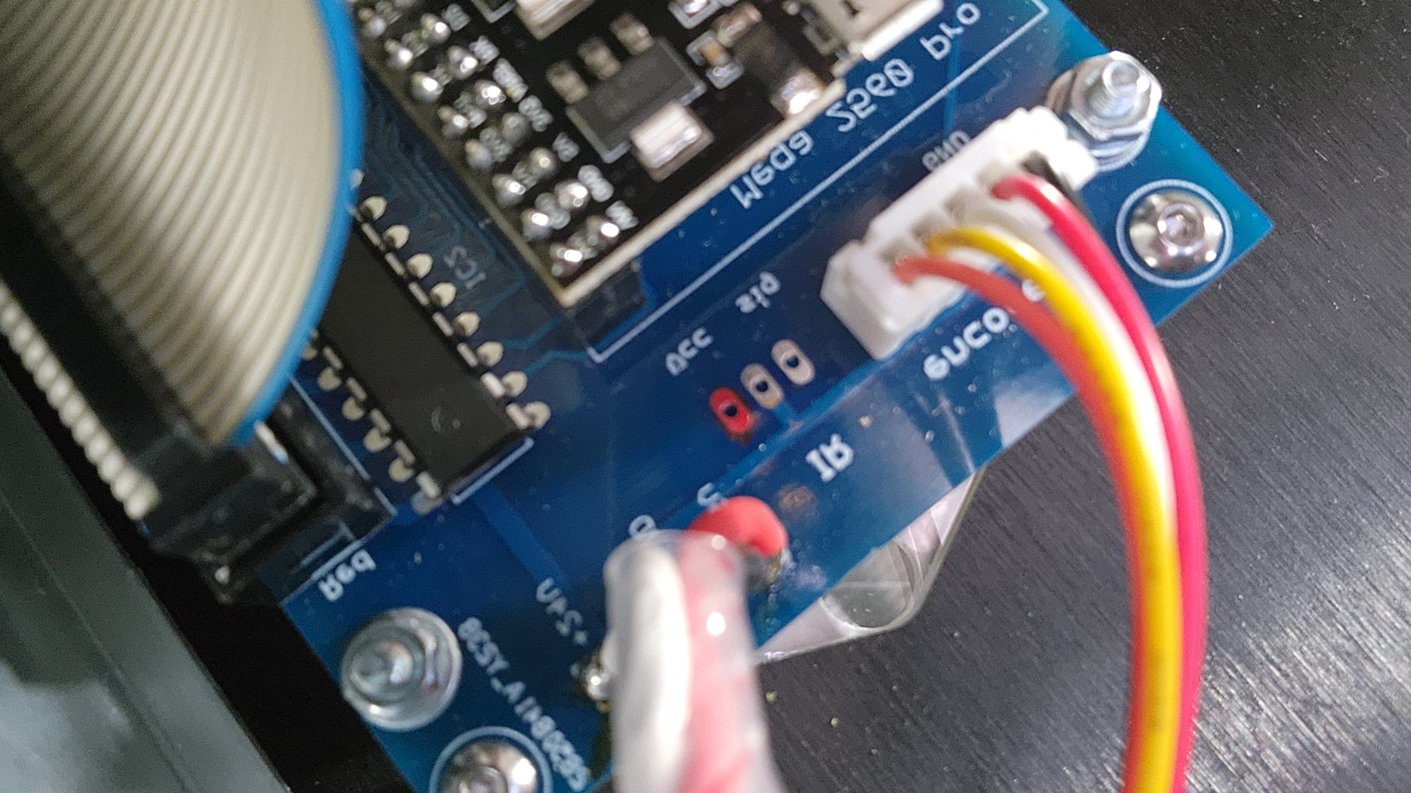

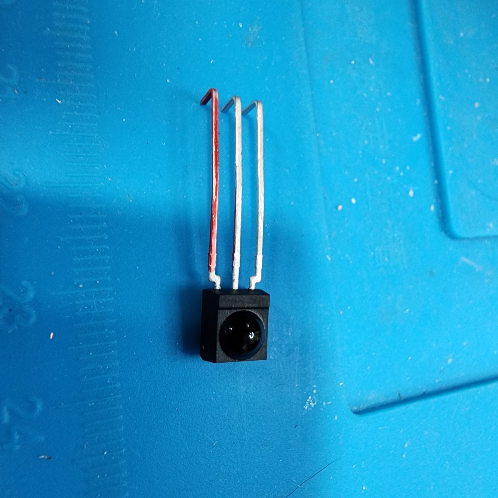

I ran into an issue with the Iron Pumpkin today. I finally got some CR2032 batteries from Bezo's bookstore and the remote does not work. I get 3.1V across the two wires of the remote with the battery installed, but none of the buttons don't do anything even when pointing directly into the receiver port (with the Iron Pumpkin on). Where should I start with troubleshooting?
Check the pinout for your ir receiver to see if its mounted correctly. If all good send some commands with the remote meanwhile you monitor the gnd and out pin of the ir sensor and see what happens.
You can check if the remote is sending something simply by looking at its led through the camera of your phone.
I definitely see the remote sending signals via my phone camera. Next step is open the Pumpkin and try resetting the headers.
Found the missing part. I'm sure this will fix my problem 🙃
Yep, confirmed...when you install the IR sensor, the IR remote works.
now take 5cm of cloth Tessa tape, and lay it inside, to cover IR and IR window
it'll look much better from outside, not being looking-window inside
you have that detail in bunch-o-pics
observe, now - with IR installed, it sounds even better
