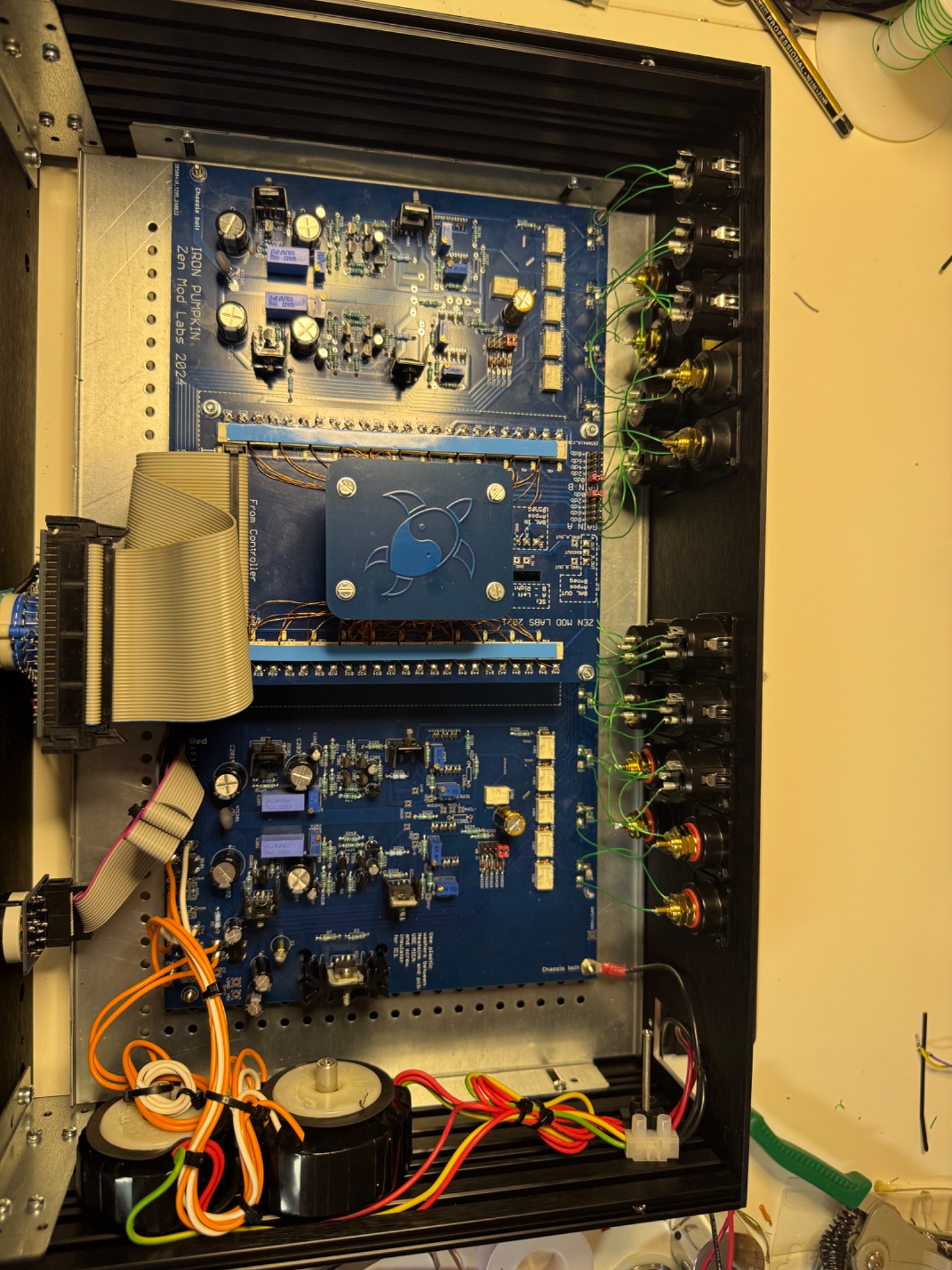

in big zip file, containing pics, which I'm sending to all interested, you have all necessary info how to wire both Turtle decks tidy
for lower deck, bare solid cores of 15mm length are enough
for upper deck, longer straight wires, just slightly leaned
so, no need for any wire loops and looping

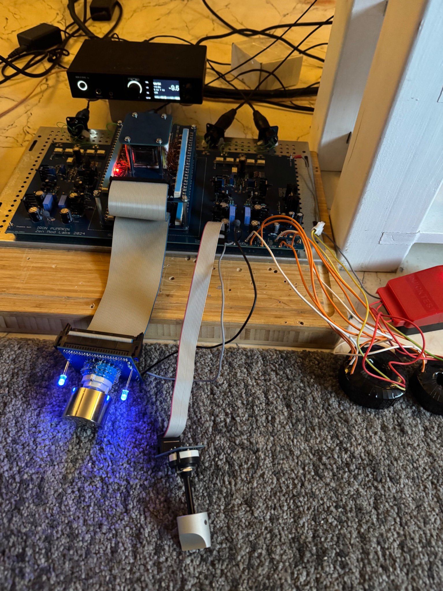

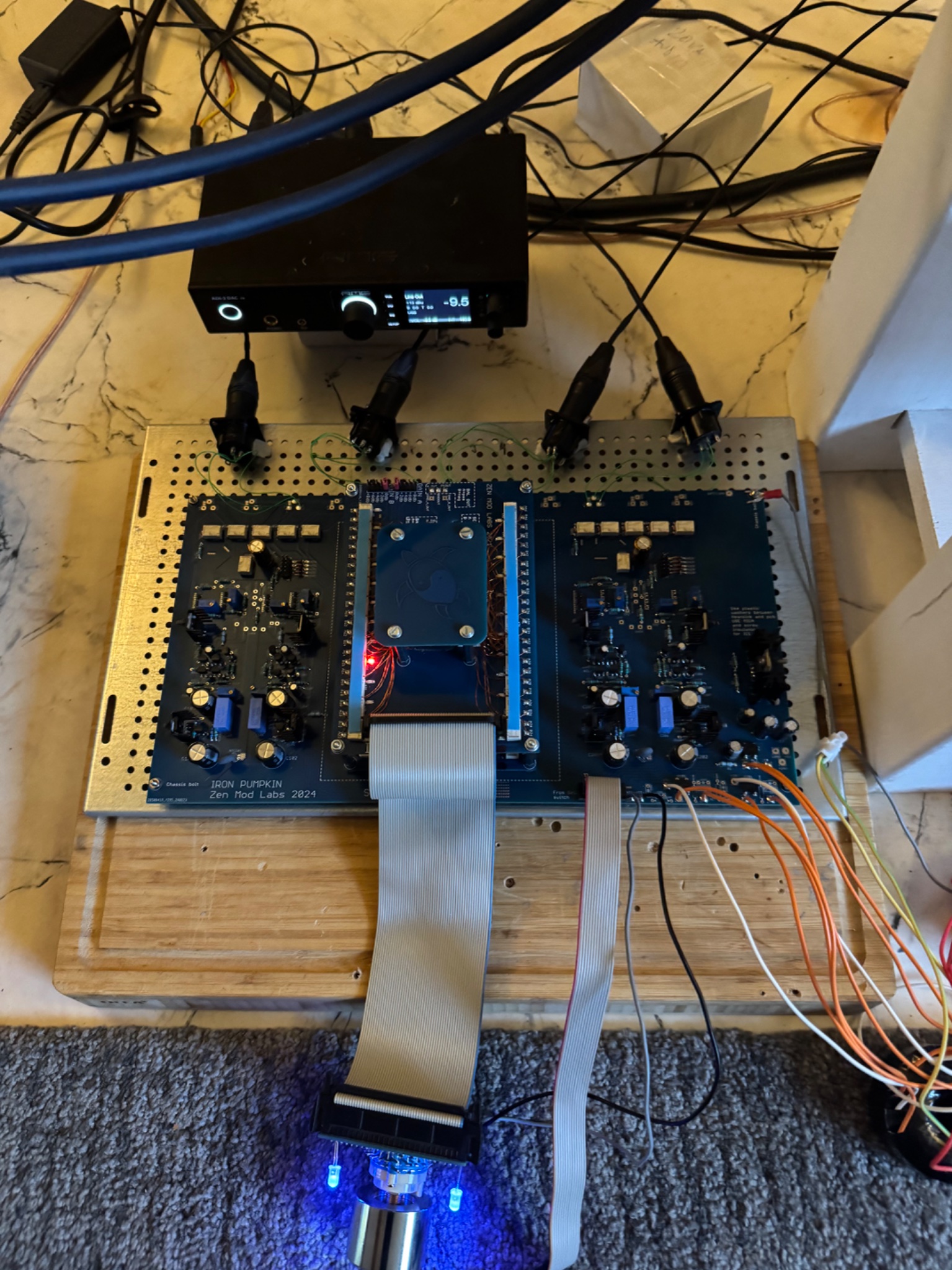

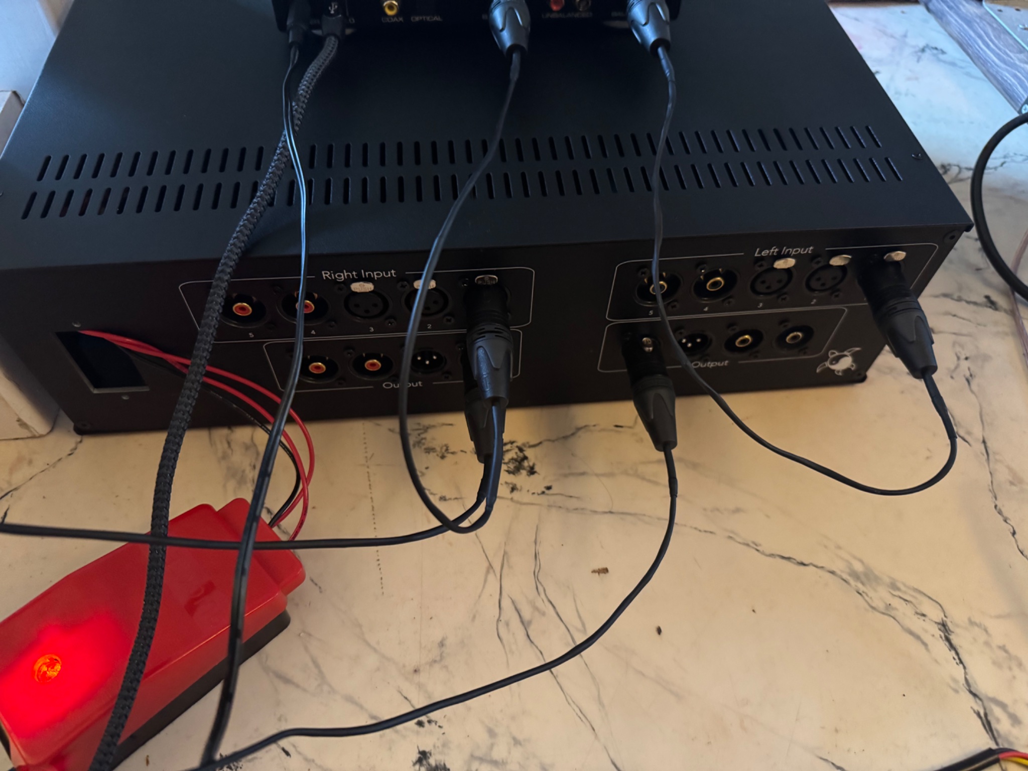

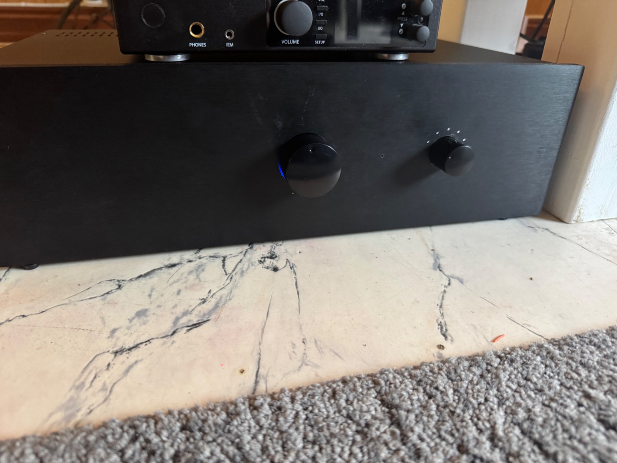

holy crap on a cracker 😀. Sound wonderful, fuller and louder, I’m coming from a hificollective TVC
In waiting to, get cabinet from Italy
