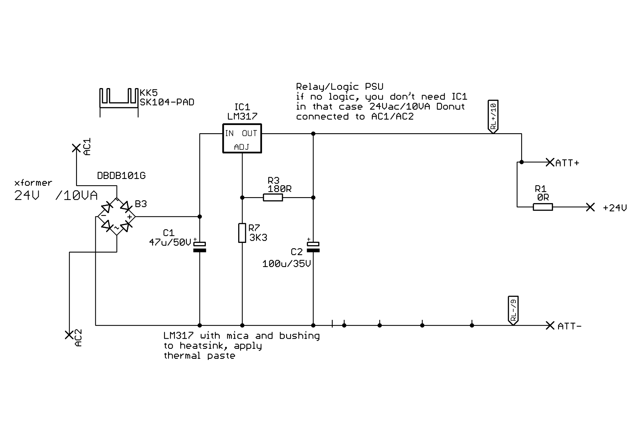

I’m not getting any voltage into the reels, i have switches not logic, do I need to connect the ct tap ?
inputs switch (5step) is working with just flat cable
for 24-step volume switch, you need to have connected flat cable to Turtle, and two wires from MoBo
near input switch IDC header on MoBo, you have 2 pads marked as ATT+ and ATT-
logically, solder two wires there and to pads on switch, marked ATTSWITCH+ and ATTSWITCH-

But do I need the ic1 to get 24v out to attswitch+ and attswitch-
It says no ic1 when no logic, so I don’t have any there.
There is no voltage on attswitch
I have ≈32v out from rectifier

you don't need 7805 (for logic 5V PSU) but you need LM317 with accompanying parts, for +24Vdc relay PSU
totally characteristically for ZM - IC1 is typo; it needs to be phrased as :
like this:

Relay/Logic PSU
if no logic, you don't need IC2
in that case 24Vac/10VA Donut
connected to AC1/AC2
like this:
in your case - just LM317 on heatsink, no need to bother with Mica and bushing - just blob of thermal paste and bolt it directly to htsnk
I installed a lm317t and are getting 24.4v out from ATTSWITCH+, is that ok or little too high ?
ref. to pic above
U=((3K3/180)+1)*Uref
as Uref is typ 1V25, but per datasheet and also in reality, in range of 1V2 to 1V3, everything is as predicted
but, most important - relays are perfectly happy with anything in range od 20-28Vdc, so just chill
and, voltage will practically sag for few hundred of millivolts when reg is actually loaded
