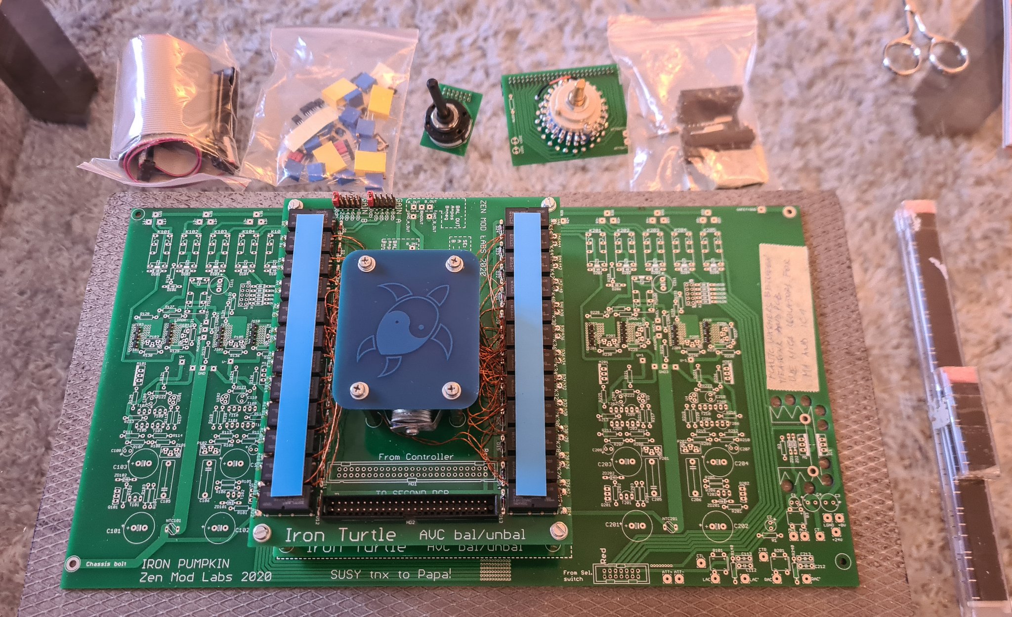

I couldn't wait (contribution to the GDP can wait...) and opened the package. The kit had a protection against atomic, biological and chemical weapons so it took some time 🤣
Cold joints and fried critters. Better seek reimbursement from Mighty and send that wreckage to NMZMVDF (New Mighty ZM Viking depository facilityI couldn't wait (contribution to the GDP can wait...) and opened the package. The kit had a protection against atomic, biological and chemical weapons so it took some time 🤣

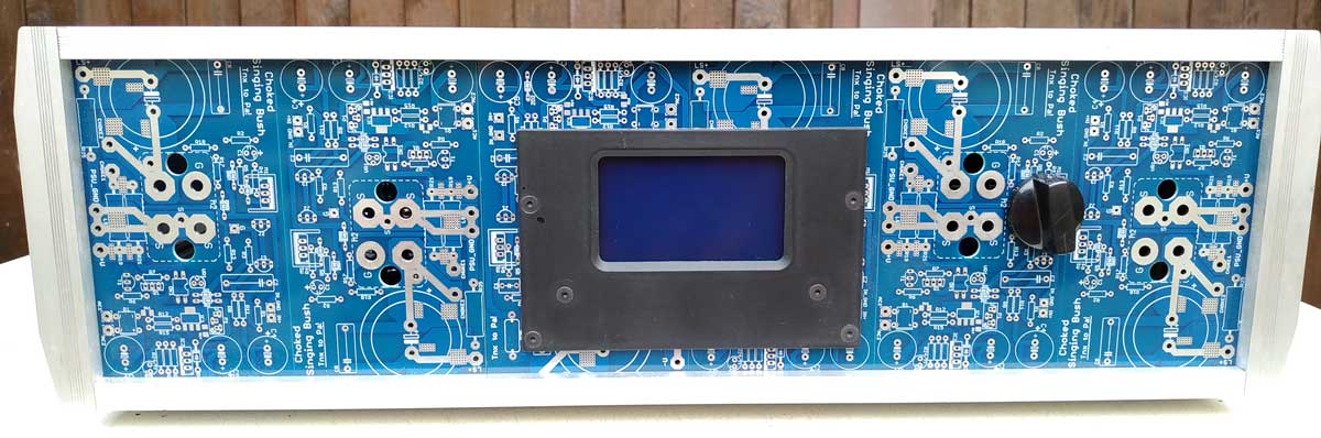

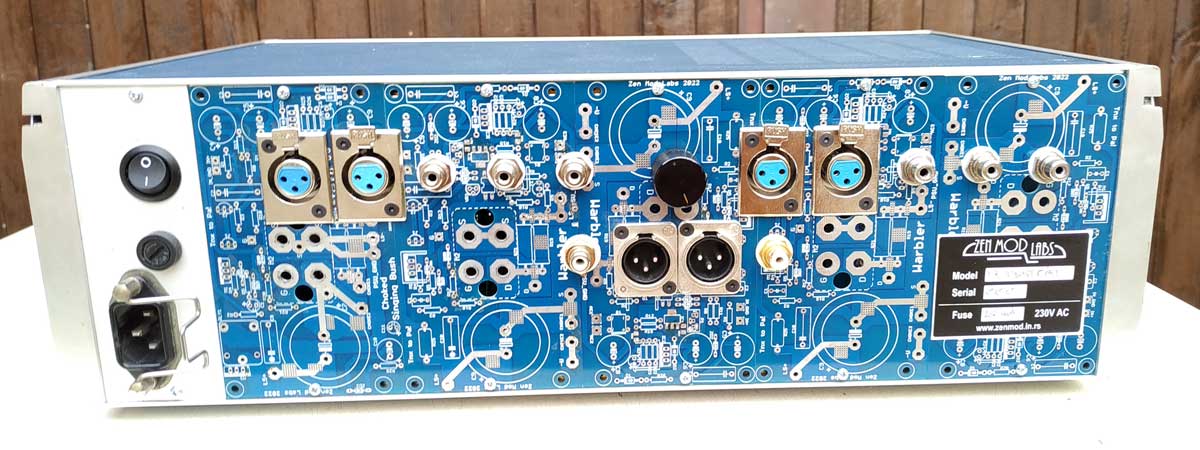

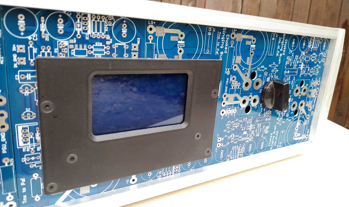

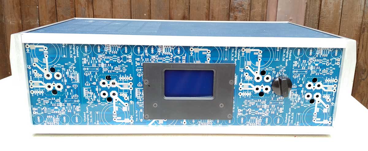

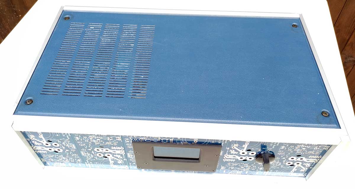

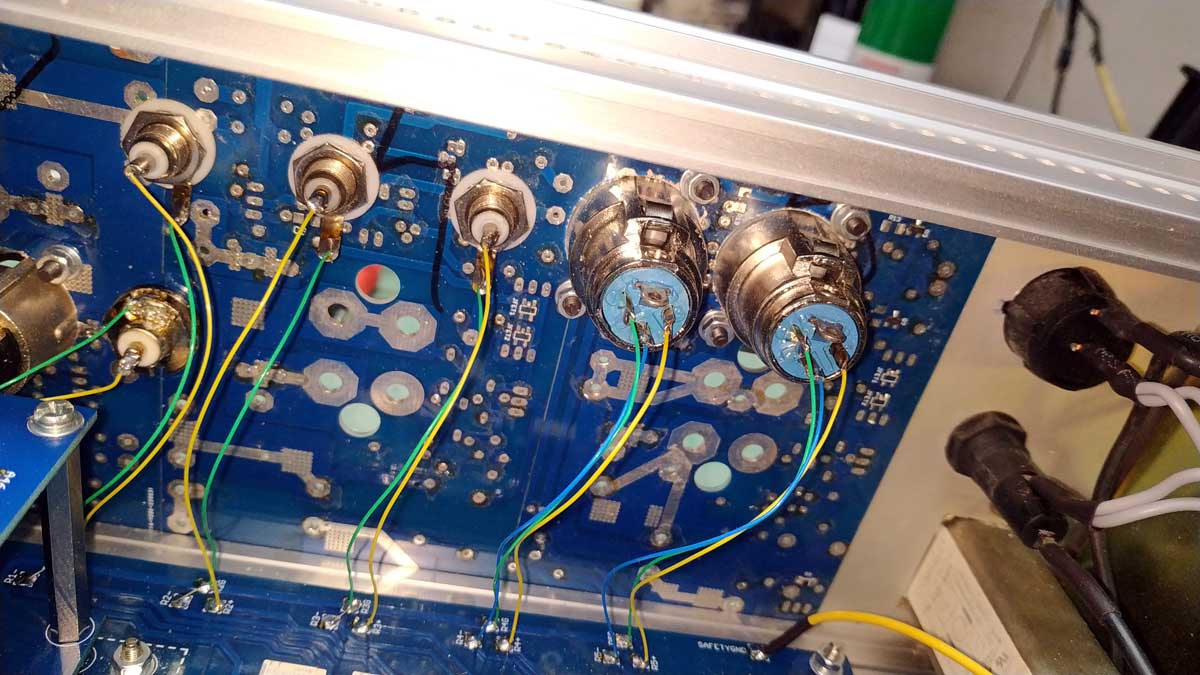

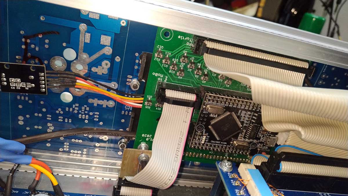

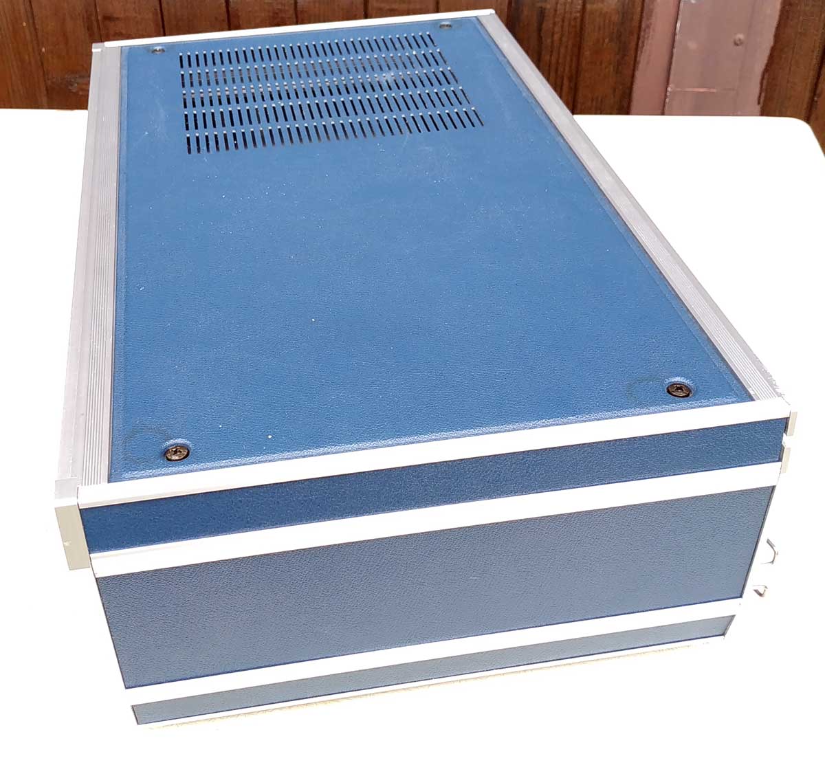

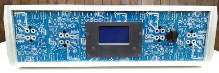

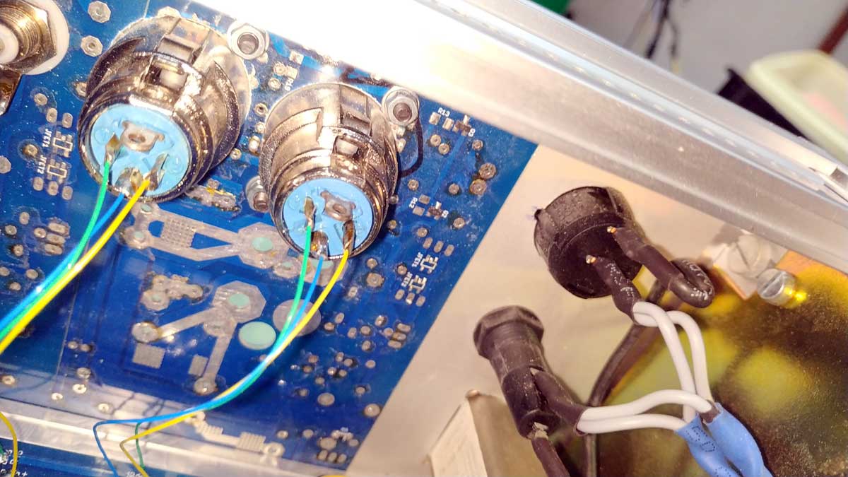

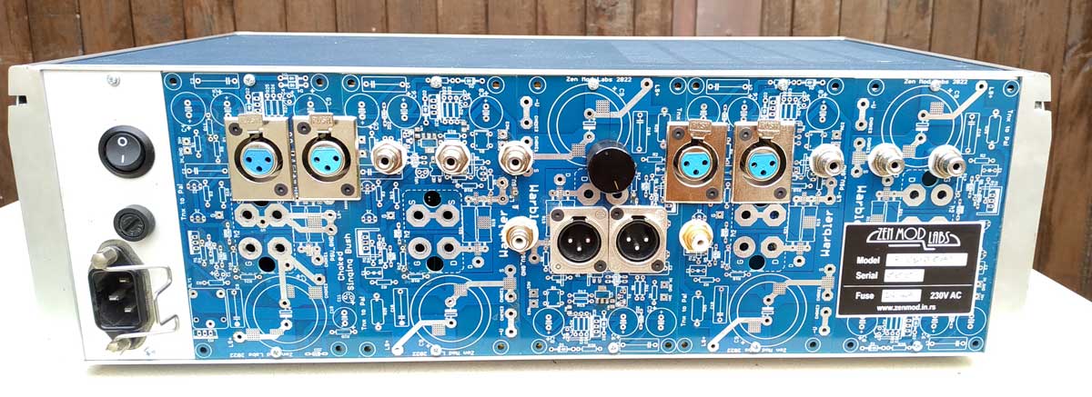

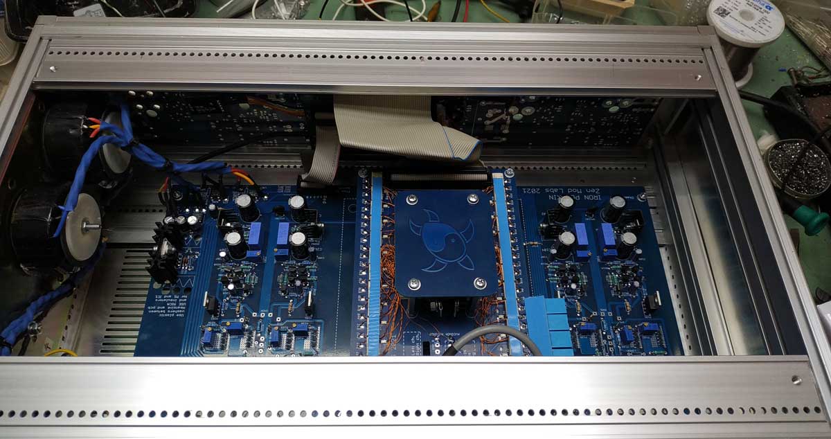

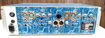

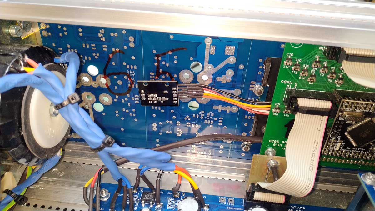

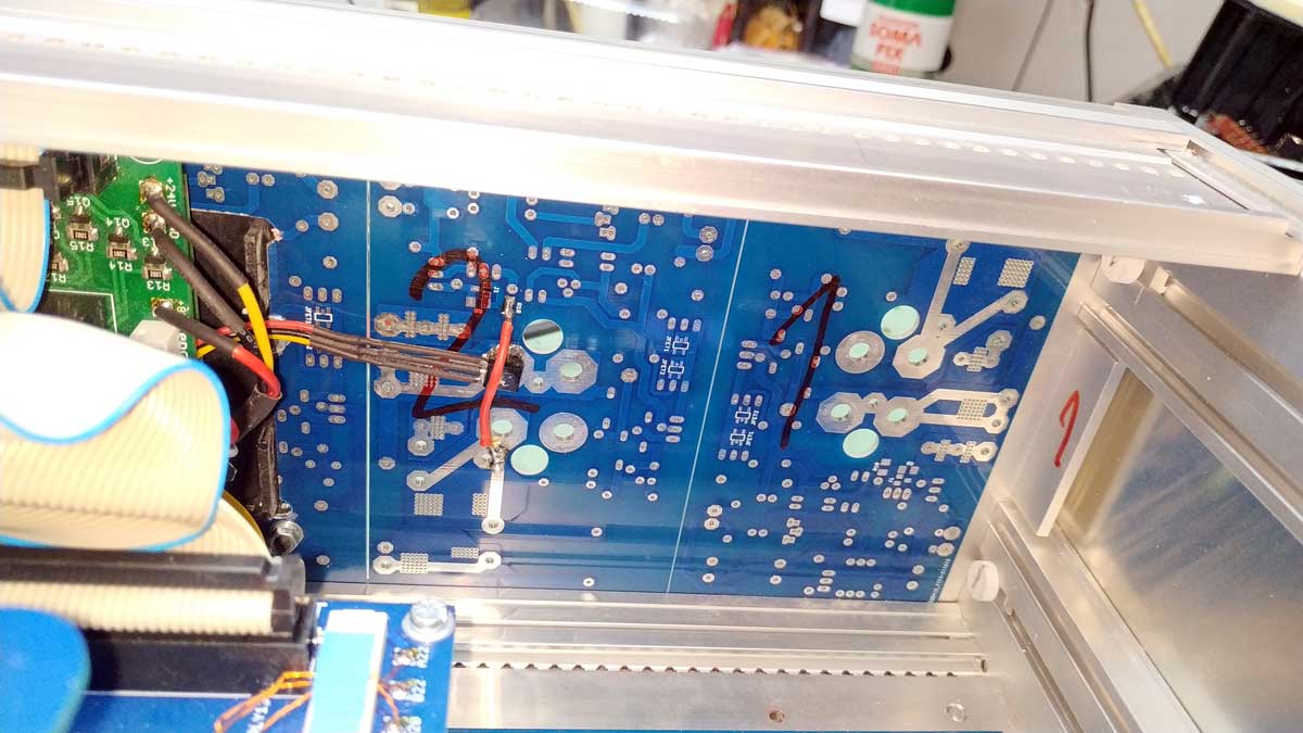

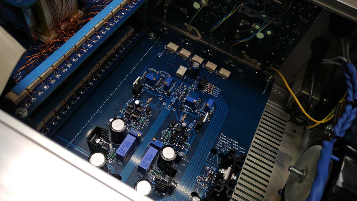

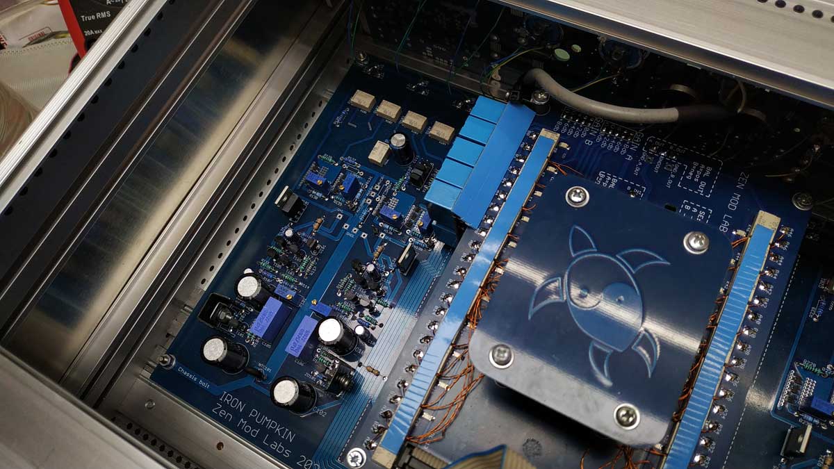

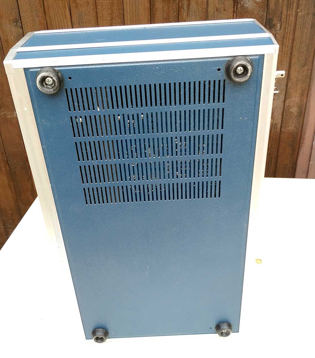

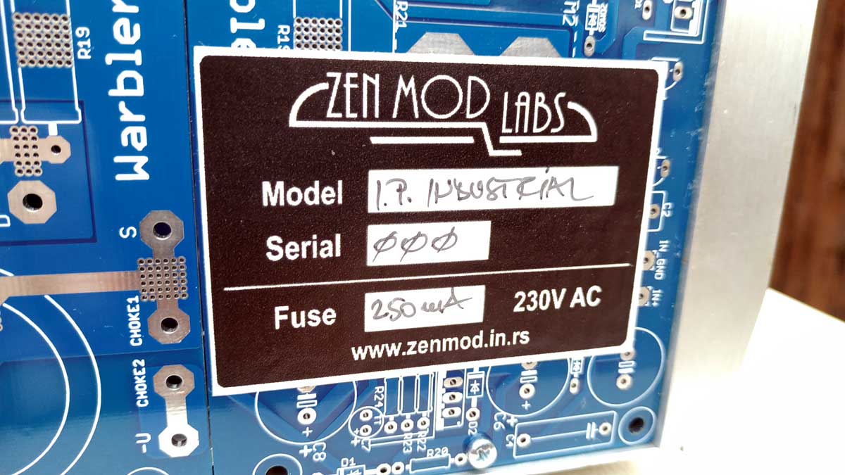

Make it super ugly - only possible way to have it for good, without someone buying it of me, as it already happened few times with those I had as mine - simply because they already been on disposal. One of cases I bought cheaply, exactly for prototypes purpose, redundant pcbs ( leftovers from protowork) used for both front and back plates, old/initial crude display. As intended to serve also as demo specimen, set of gain setting jumpers replaced with battery of relays, controlled with 5-step rotary switch at back. Title on functional display sez "SE", will re-flash later, because I evidently made it balanced - 3 SE inputs, 2 Bal inputs.
Lousy pics - Alu case elements showing bad on white background
