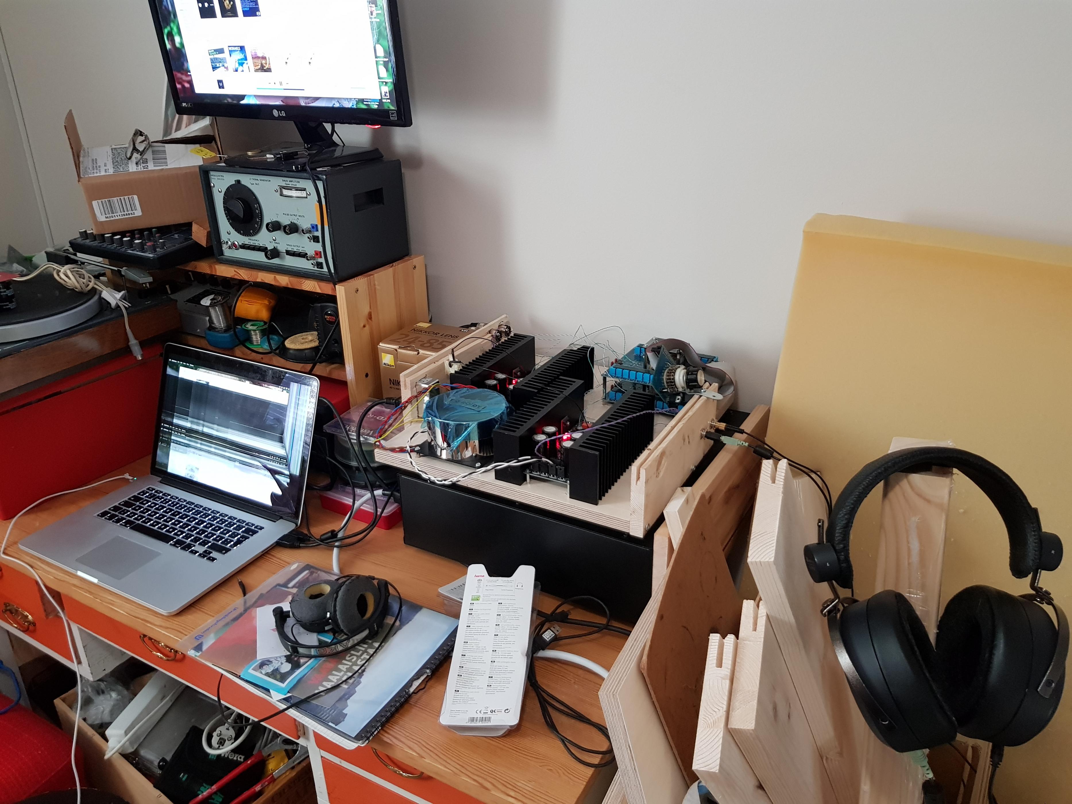

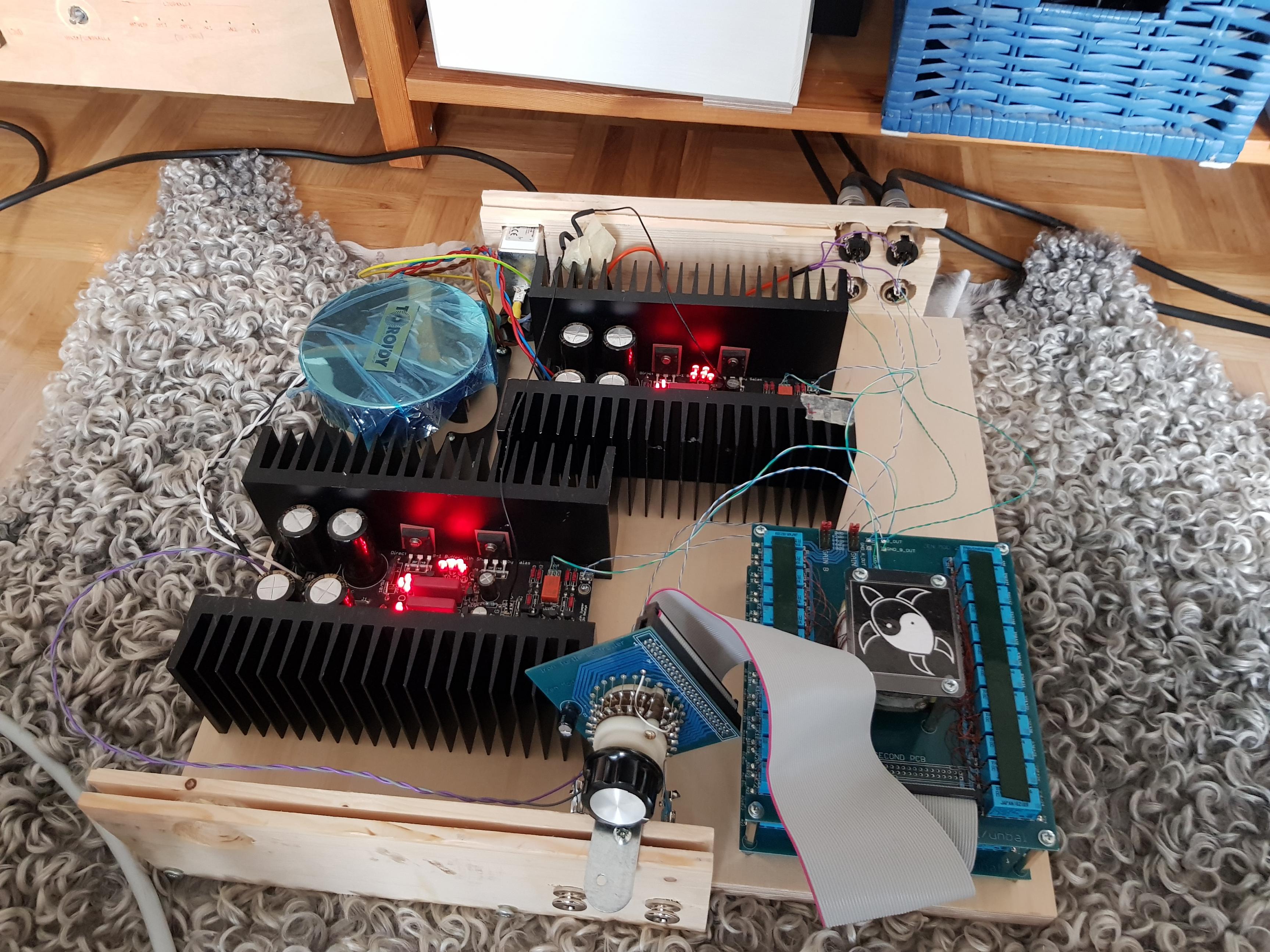

Hi!
I've got a quick and dirty set up of my Iron Turtle going. I had though not to post until I make a proper home for it, but that will take at least 2 years (building a kitchen and play room takes priority) so here goes!
The buffers are dual DCB1 with the output resistors removed and grounding as per Tea-bags post. Audio ground is connected to ground on the Turtle pcb. Proper plug and play.
Original B1 can drive Turtle to good sounding results.
The setup is completely silent driving head phones. The sound is just great, I'm able to listen to music for a whole work day without getting tired of it.
For living room use, I took ground and positive phase to the kit version of the sony v-fet part 2 amp. This reveals:
1. My tweeters are cracked by happy babyfingers (domes make funny noises when pushed hard) and my previous source is too crappy to reveal this
2. I have ground loops (probable culprit dac, can't remember amp-wiring but my friend sov has ordered fancy pants rectifiers so will have too inspect soon enough.)
So, amazing head-phone amp and best pre I've had but unable to properly evaluate because of deficiencies in rest of system. Hobby work cut out for 2020!
Thanks ZM!
