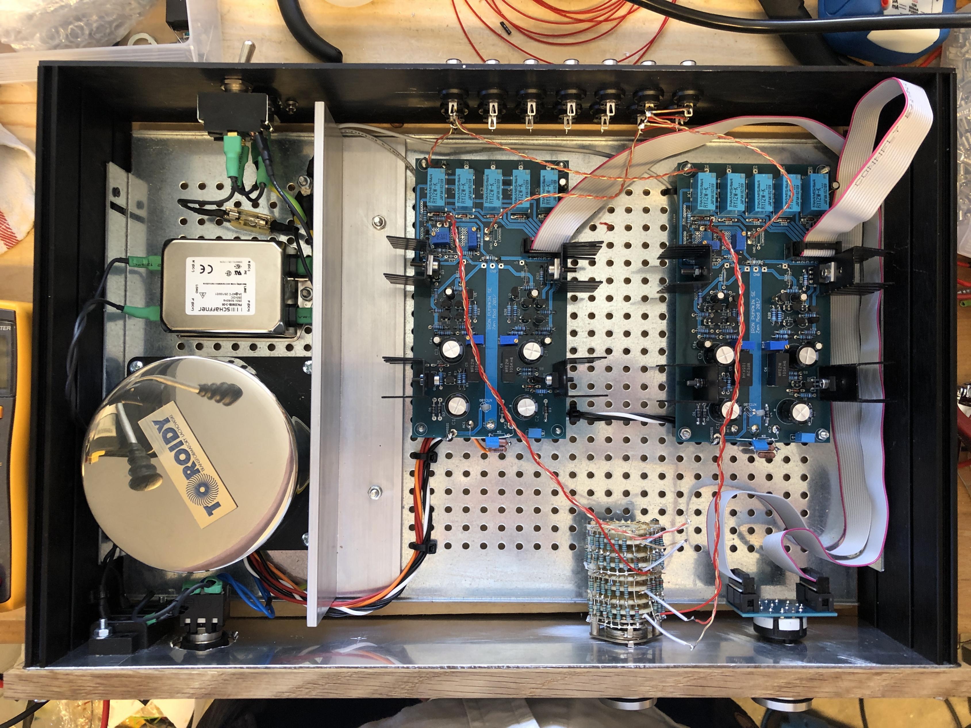

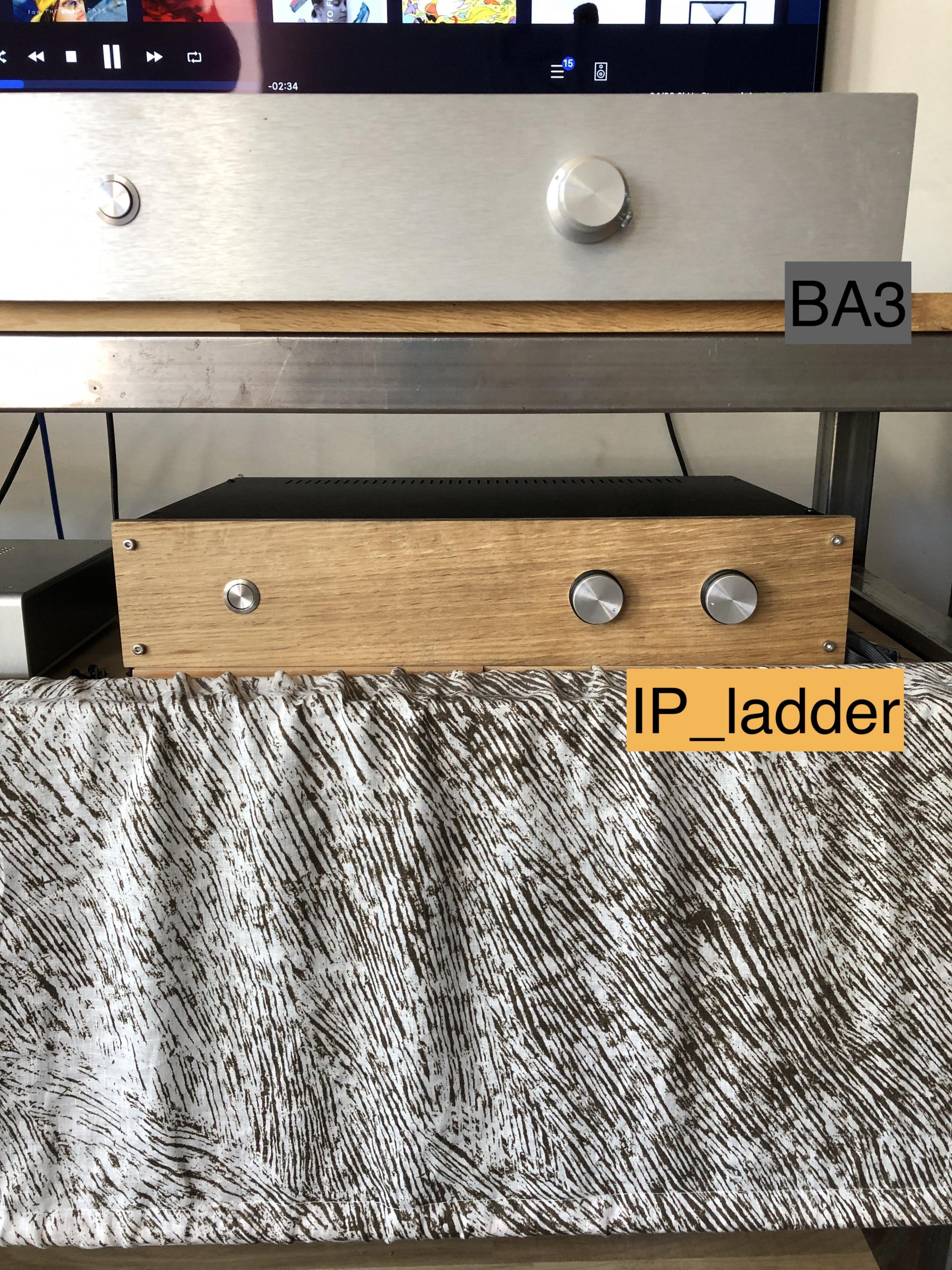

Finally I put the IP_SE_TL together. The TL is for Turtle-less. Frankly I was a little nervous for having a solder bridge somewhere. While powering up and setting voltage and offset I noticed how gentle it setled to stable values and took some measurements . In all gain contradictions I hooked the Pumpkin to F4. ZM, know the cricket behind the speaker. I heard it smile with a wicked twitch in the corner of its eye. My brain has normally a burnin for a couple of weeks but after 30 seconds I too got something twitching in my eye. Thank You, ZM!
With F4 and full throttle I got 80 dB in my sofa. I will set it up with F6 and Aleph J later if my smile fades 🙂 I don’t think my speaker(105dB) has ever sounded so nice.
My wife is happy withe oak front so now I have to upgrade the other ones.

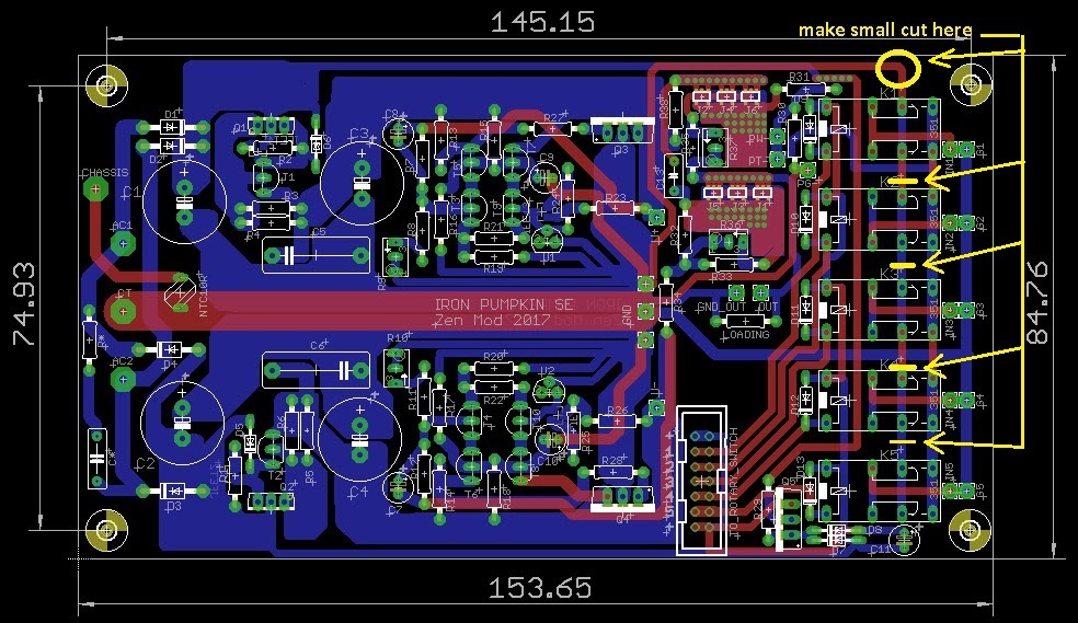

when in mood - you can remove htsnks from mosfets, no need for them
later, if you have xtalk between selected an not-selected inputs (depending of Rout of your sources), cure is simple
high Rout enabling xtalk
remedy is disabling grounding of unused inputs and parallel connection of "normally off" relay contacts
see attached picture
if you remove mosfet htsnks, you can find adequate L bracket to mount your attenuator in between channel pcbs, using extending shaft and coupler, thus shorting connection wires drastically
disassemble old bad pot with 6mm shaft, use its face part and you have nice sleeve for extending shaft , for front plate
one thing - I did found those pre-made ebay attenuators tricky - they can start cracking and loosing contact relatively soon
I'm using sorta same switches for controlling Turtle relays, but each one is disassembled and well greased before putting on pcb, which is logically not possible with already assembled attenuators
good to know, if happens, you're not first
