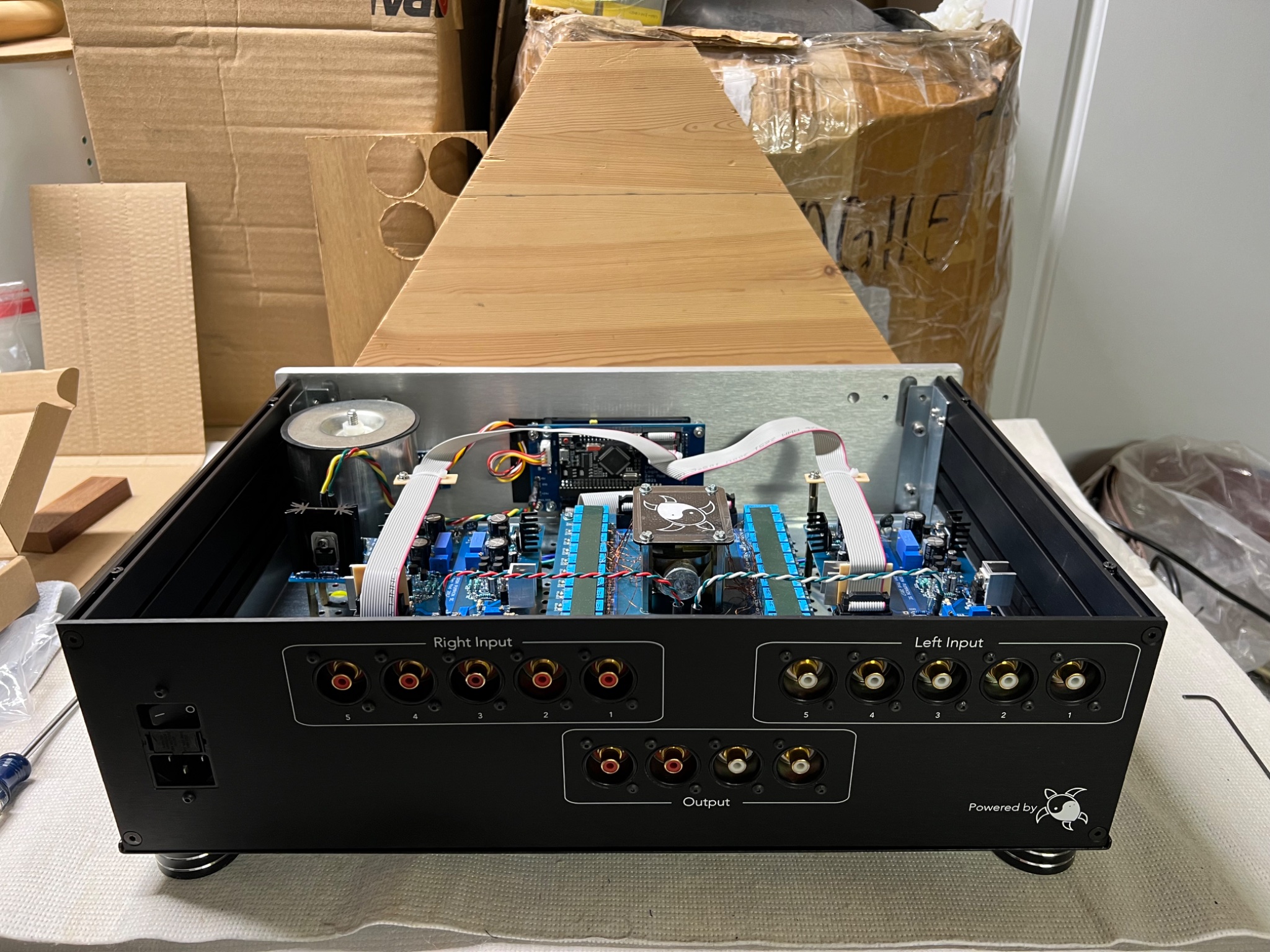

Rotary now controls source relays as well…”clickity clack clickity clack Easter’s finally here” 🤡

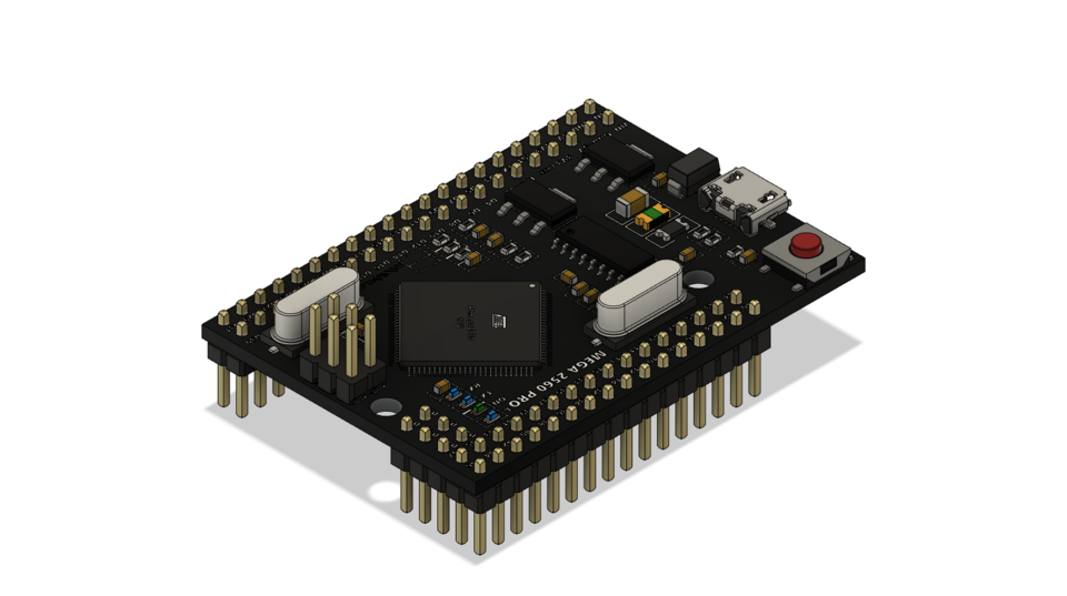

Unfortunately the remote still behaves the same…either I hear a click and no further response or sometimes it power cycles the Logic depending on which button I push.
I’ve got to figure out mounting procedure which I complicated with location of transformers and a few other things now. At least basic functions are there.

no need to change complete Logic module, if there is an issue (and it is, culprit explained few posts back), solution is - either programming Arduino at your place (all you need is open top lid and connect USB cable to Mega 2560 Pro inside) ... or ZM sending second Arduino, and then all you need is to open top lid, pull out existing and push in new Arduino
first option certainly faster - only if you're willing to mess with that ( download arduino IDE app. , ZM sending necessary libraries and code, explaining few simple steps)
other kits, that's completely your call
No such luck…kiddo has Doctor Appointment…sitting in office ☹️
I’m willing to take a shot at the reflash of Arduino…fair warning, technology hates me…it’s a mutual feeling actually😉.
Whatever can go wrong will…probably starting with pulling my hair out trying to find the right cable.
Then it will be a miracle if I can perform the flash properly with one of my Macs or older Windowz laptops…🤷♂️ Fun fun fun
procedure is simple ........ as I said - regarding hardware, all you need is cable - regular PC size USB on one end, Micro B on other end
but, you really need to hear it first ........ rest we can do via email
I can even help directly-remotely
, if you're willing to use Ultraviewer and, Viberrrr or WhatsAppppppp
if you have Windrek laptop, nothing easier ...... I don't even need to engage brain

I did successfully find a cable that has proper connections…hopefully it carries data and is not just for charging.
I also did search for Arduino IDE. First attempt at download gave me version I couldn’t use…only have Win 10 32 bit on old computer stick which is newest Windoz computer I had around.
Downloaded and installed version 1.8.19 successfully. Hope this will do the job?
Will ping you via email.

you really could hear it in meantime
for programming, you don't even need to power it off
though, as good practice, best to do it
will e-mail zip with all necessary files later, when I'm back home from wshop

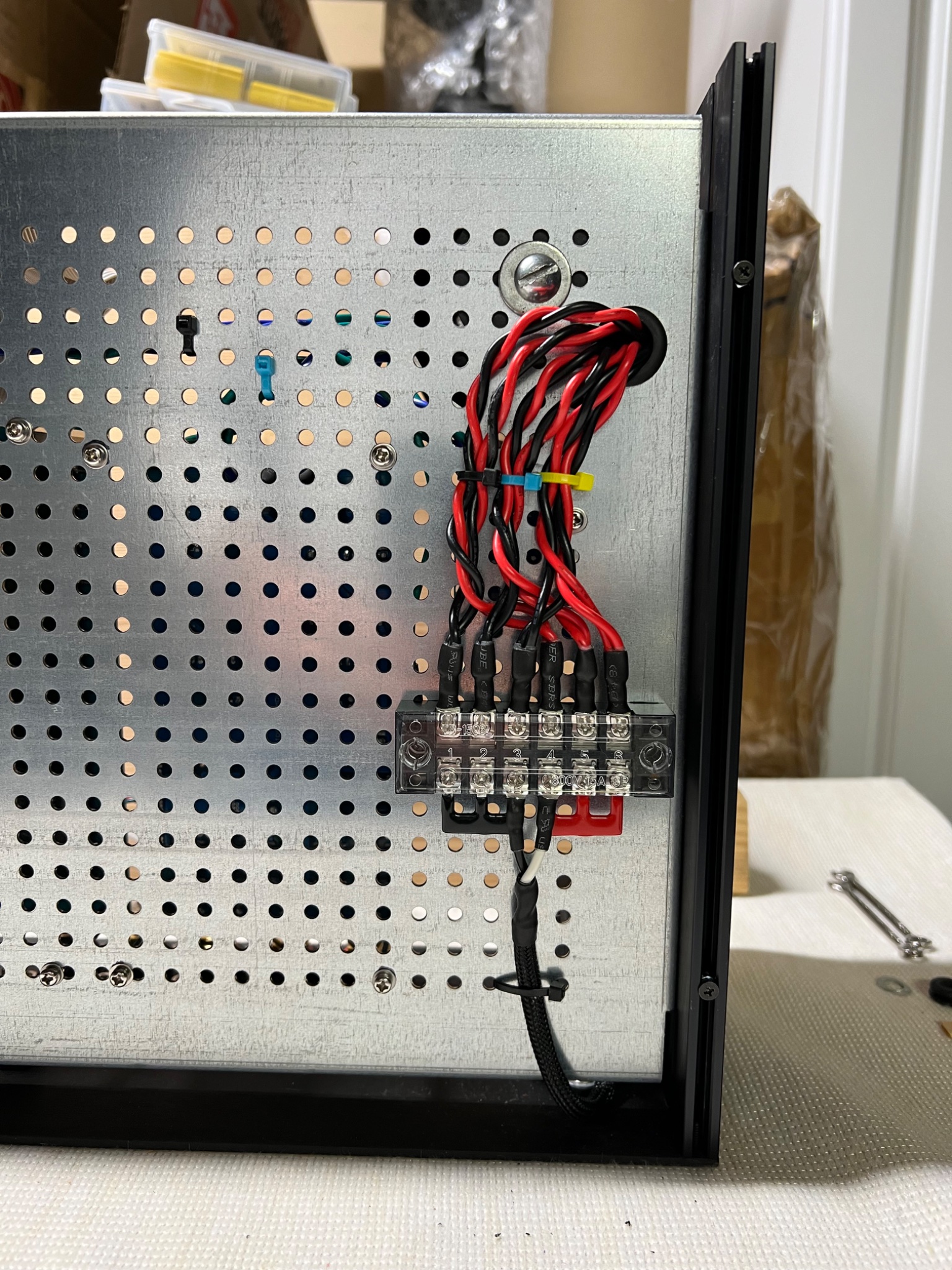

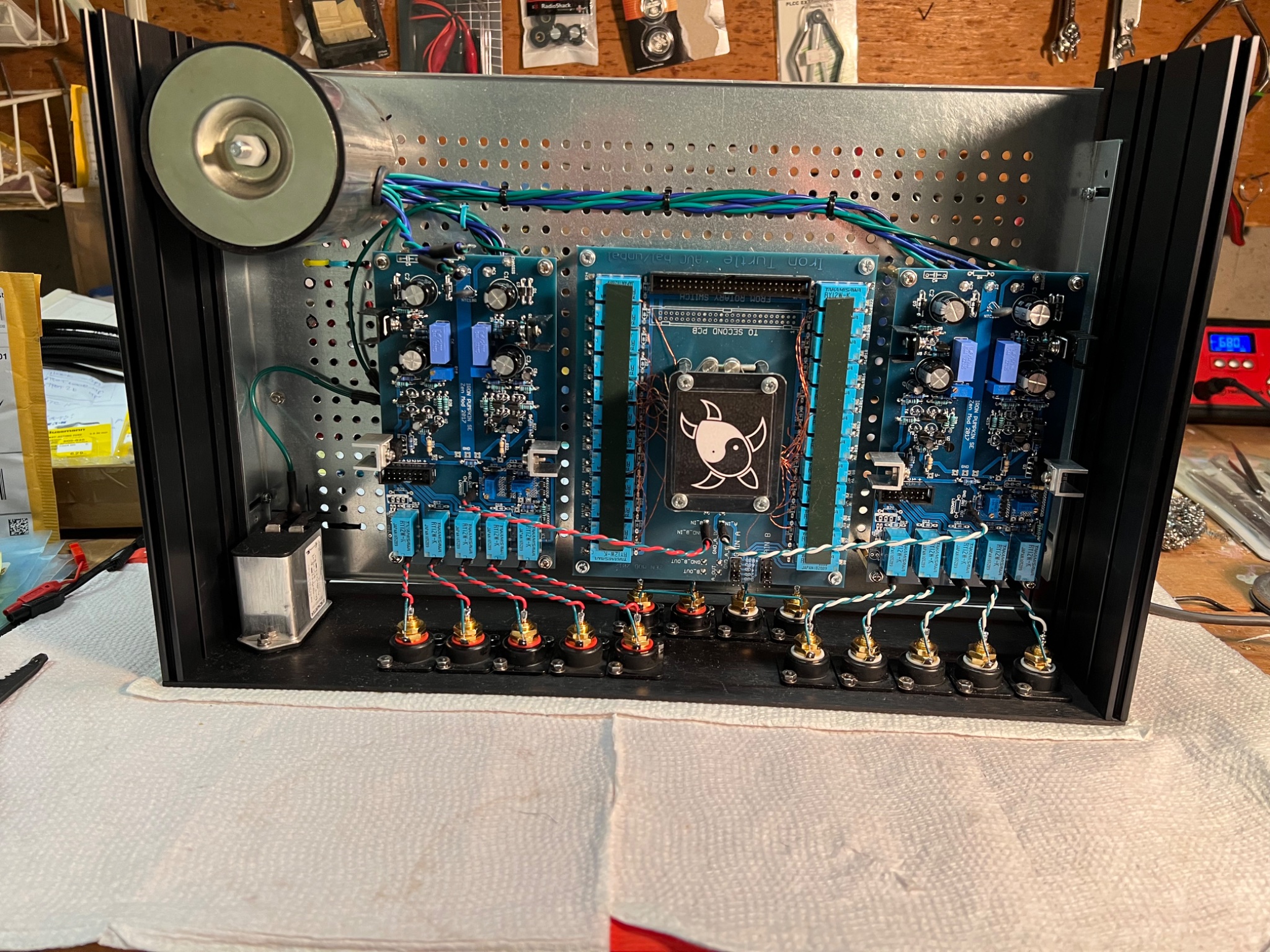

Problem, as I said, is genius decision to stack all trannies in custom shield can I built for front corner of case (away from Turtle as much as possible).
Well…it makes assembly of faceplate bracket not possible without loosening everything to shift it out of the way…I hope 🤞
Nothing near bench except crappy test speakers and an eBay chip amp.
I need to be able to have it in one piece and front panel not flopping about.
unbolt xformers, move them aside (trying to not break anything on pcb), mount front plate, bolt xformers back
Problem is even once donuts are shifted out of the way I can’t insert bracket hardware past lip on baseplate.
Baseplate was raised all the way up so power distribution for donuts underneath would have clearance
280mm deep case is PITA with all this hardware required for Logic. I had it on hand from that Modushop mis-shipment I bought up…🤷♂️

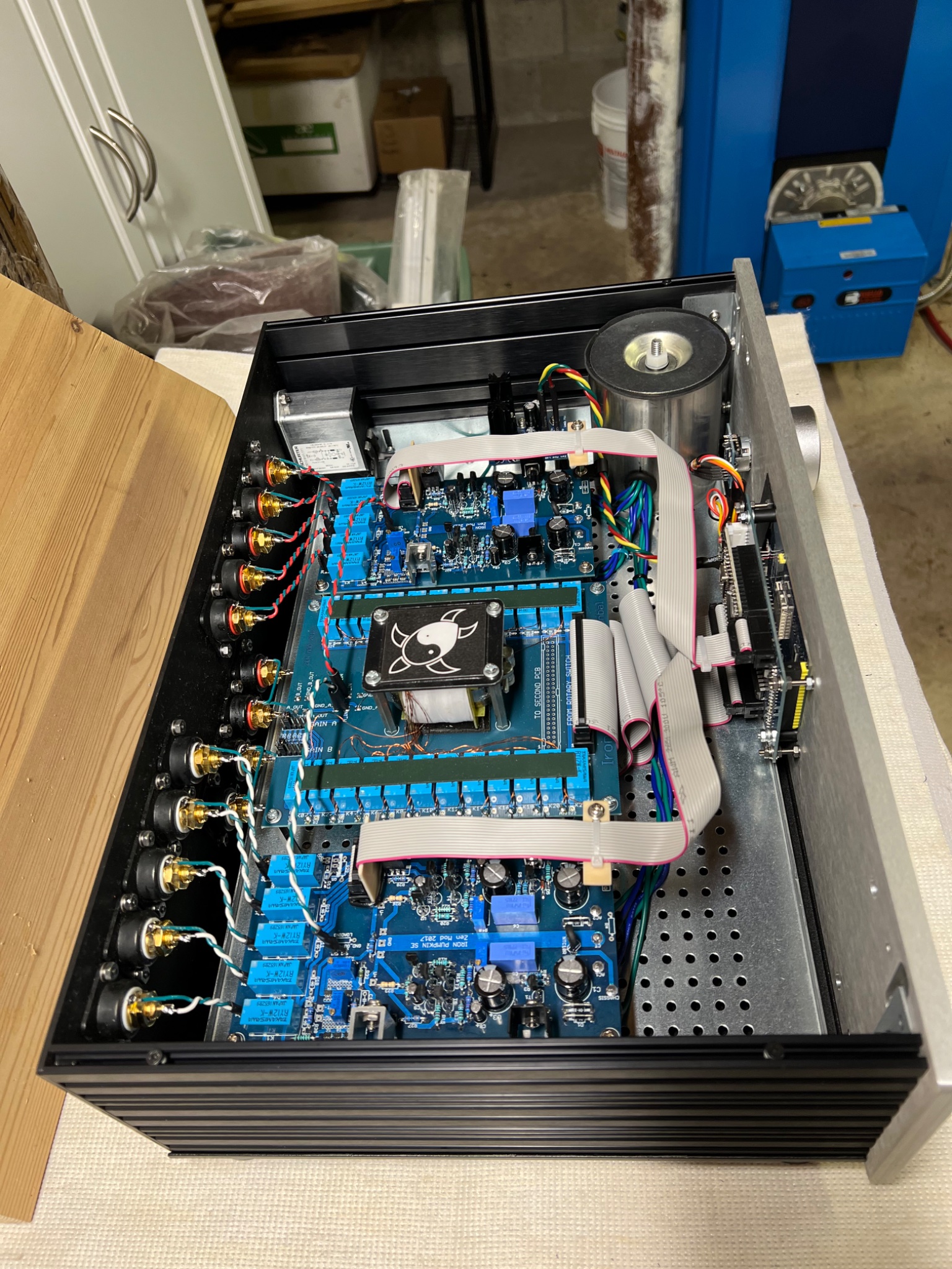

I'm doing it in 280deep, but planning is crucial
though, you had myriad of pics of my builds
Tanka and Tatanka must go in 350deep, slightly bigger and one more Donut
Yes, that’s what I thought I did
Us gringos are stuck with the 3 Antek donuts as only reasonable/affordable solution for Logic implementation I think.
Maybe someone will find a source for a sexy multi-tap donut like yours over here some day…

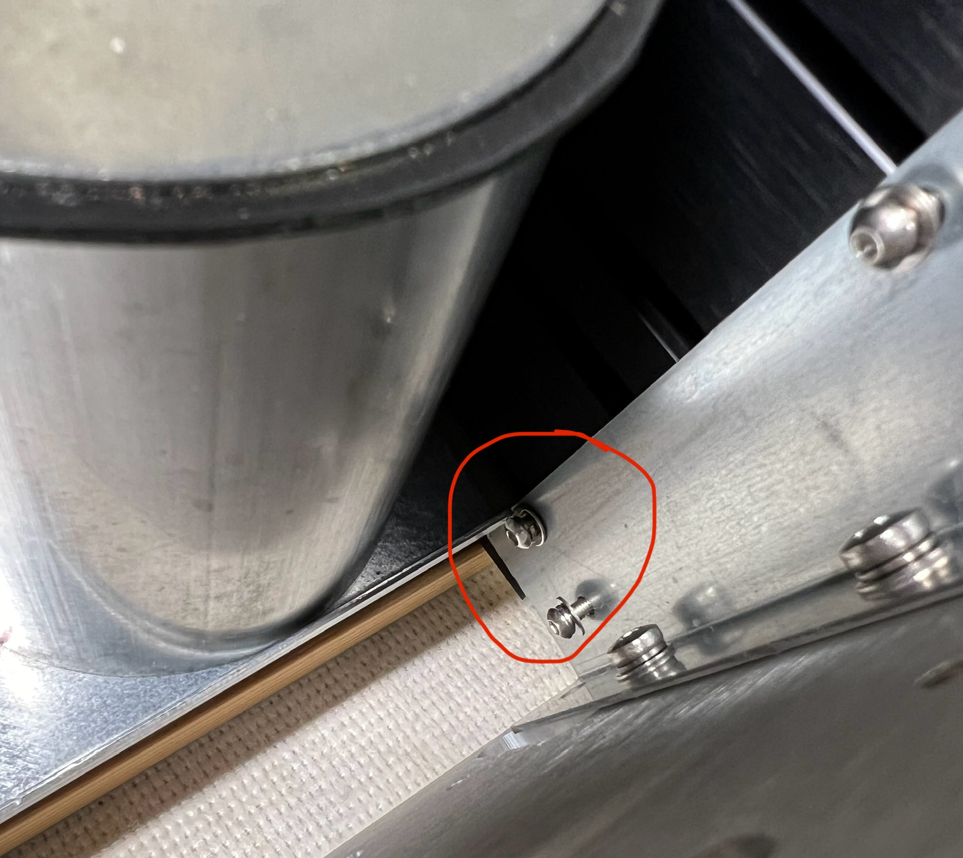

If you want the donuts shielded using the Antek hardware it just takes up too much real estate in the 280 chassis in my opinion.
That’s why I went with stacking the donuts and making my own shielded “Tower of Power”.

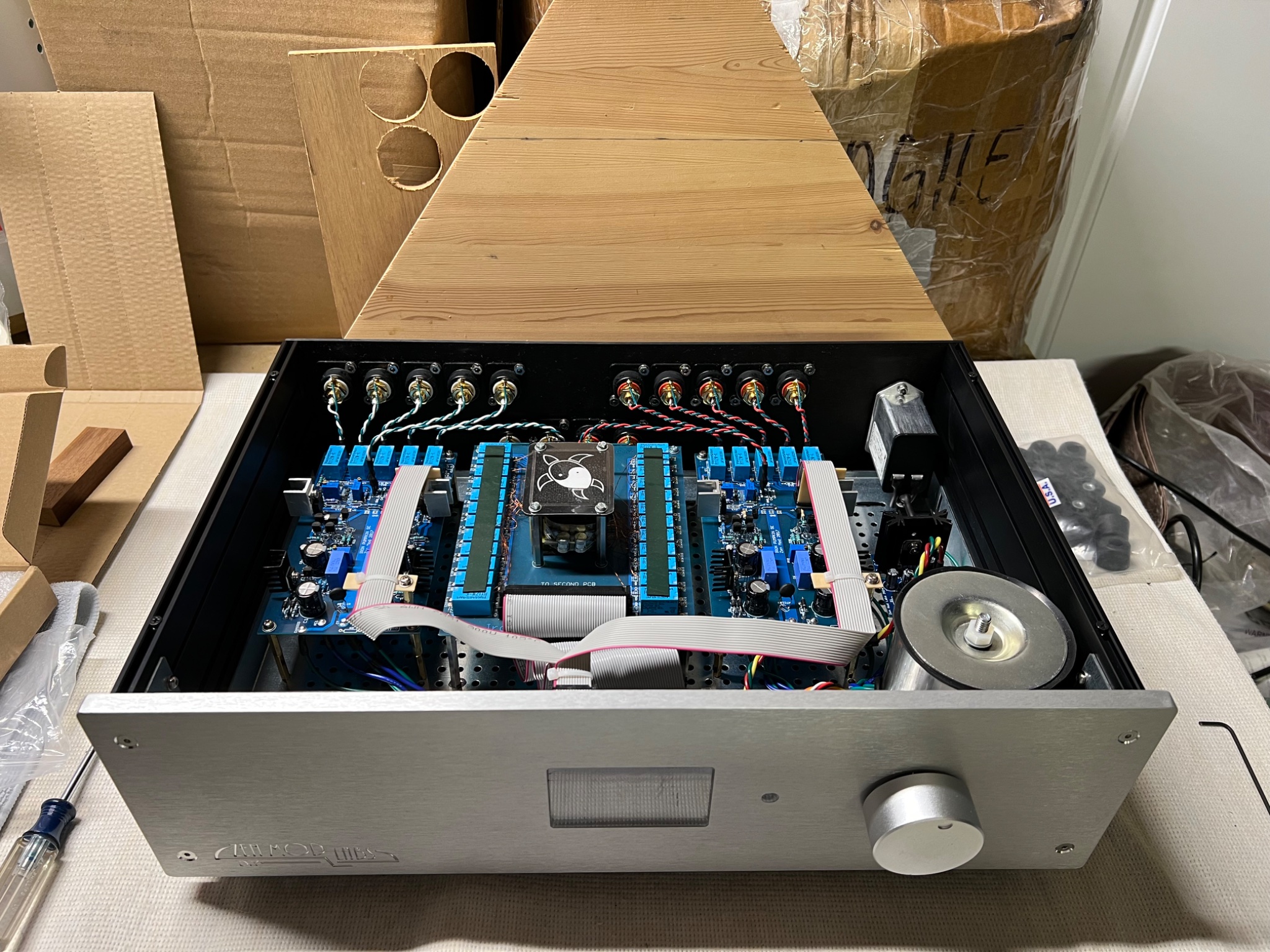

Anyway, I got it together after a little “Orange County Chopper” action with the angle grinder on the baseplate 😈
I’m gonna put it into the basement system after I have some lunch 🍕
I have never been afraid to grind my troubles away. I try not to make a habit of it, but when I am in a corner, somethings got to give.

It’s all good amigo.
To be honest, overcoming the hurdles is what makes the project more satisfying in the end…plus it allows me to be creative👍…that has kind of always been my goal in this hobby. I like to make pretty things that make pretty sound.
Sometimes it can be very frustrating when you feel like you made a lot of stupid mistakes…but hopefully you learn from them a little and make fewer mistakes next time!
So now I’m at that point where I get to sit back and contemplate all the blood, sweat and tears that went into this project and enjoy the fruits of my labor.

What is my first impression?
In a word…nothing.
There is nothing in my way.
The combination of the Iron Pumpkin/Turtle and the Babelfish J2 in this system is ruthless. It just plain exposes everything in the recording.
It’s not harsh, it’s not warm…it is just plain veracity.
Excuse me…I have to wipe some of Coltrane’s spit off my face…

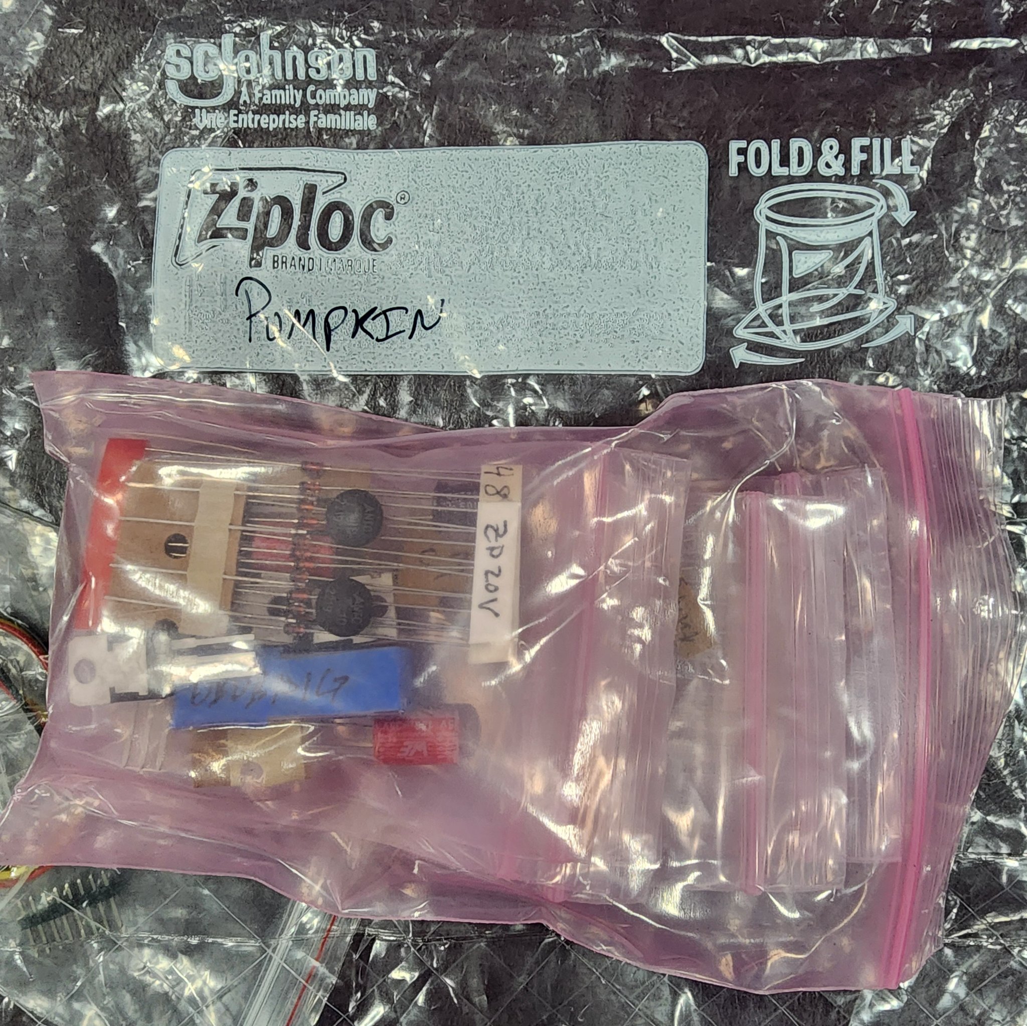

"May Day Give Away"
When I built my Iron Pumpkin I had to order a handful of parts as part of a "completion kit". I ordered more than I needed for one kit and built up an extra kit of parts while I finished off my Iron Pumpkin......
With that said, I'd like to offer a "give-a-way" to someone who has in hand, or has recently ordered an Iron Pumpkin kit from @Zen Mod and will benefit from a premade "completion kit" of the small passive components. This offer doesn't include transformers or distribution blocks, just the passive resistors, capacitors, and such to save time and energy seeking out the remaining necessary components.
If anyone falls into this category (you have a recently acquired kit, or have recently ordered a ZM Iron Pumpkin kit), the opportunity to get the remaining parts needed as a give-a-way should make a post here that you're planning to build a Iron Pumpkin and will benefit from the pre-assembled "completion kit".
I'm opening this "give-a-way" up through Wednesday, April 30 midnight pacific standard time. I will pick the top entry after a randomization to receive the kit as a "May Day Gift". I will ship free within the USA, or anywhere in the world for shipping cost (minus $5 from total shipping cost) as a thank you to Zen Mod for designing and providing such a wonderful preamplifier. Just know the value of the parts of this kit may make international shipping costs not worth entering. We're talking about probably less than $30 in parts, but it is hours in energy figuring out what parts you need beyond what's provided by Zen Mod in his kit.
