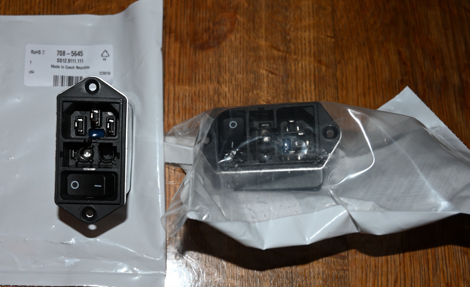

But it will take some time before a fuse can be mounted as I just discovered that "fuse holder" for the DD12 Schurter has to be ordered as a "side order".
Just a big hole........I thought holder was missing by a mistake but it is written that holder is a "side-order". Various versions exist!

MEPER I'm using a 500mA slow-blow fuse for 120VAC mains. I debated going with a 250mA slow-blow but didn't want to deal with start-up surges popping fuses. I also had the hiccup of realizing I need to order the fuse carrier separately.Ok, different version of T-types also exists......some more "T" than others......sand filled etc. Will check what I have.

Yes, strange that German terms are used when it comes to fuses (T = Träge, F = Flink). Maybe fuses were invented in Germany. We also have the DIN-standards.
When I order the fuse holder I will also order som T-fuses 🙂 from 100 mA to 200 mA.
In the USA, we just say the T is for "Time Delay", and the F is for "Fast".
I would be curious if the German terms were the originals.

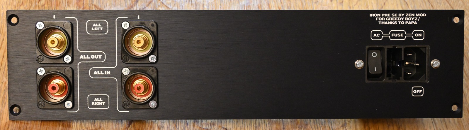

I mounted the back panel of my special version chassis. I use DAC input only and I implement no vol pot. Front panel is just black.
By a mistake I got yellow RCA connectors (instead of black) for Left input/output. I wonder how that sounds.
I am using Korg pre at the moment and made a test where Korg vol pot is cranked all the way up (I guess that will give a direct galvanic connection with ALPS doing that). Then DAC was turned into pre-amp mode. It works very well according to my ears. So I look forward to Iron-Pre with much shorter signal path and also a bit lower gain which will give lower noise (noise level is already very low).
