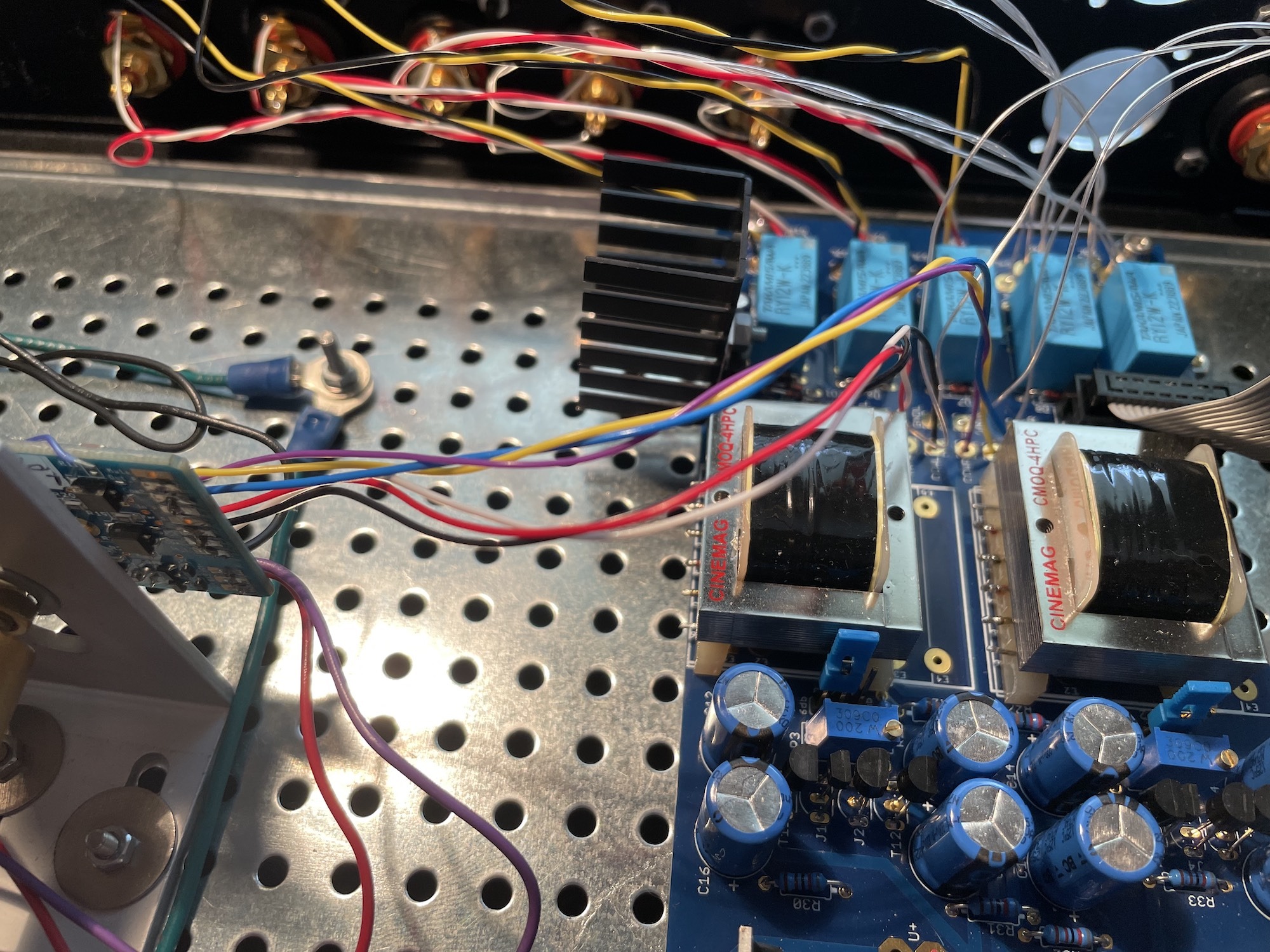

Do you have a pic showing hookup between muse board and iron pre board? Any other changes using the muse?I’m ready to talk about this. A little bit.

Thanks, I have one of Academy's muse and would like to use it on my Iron pre.
Russellc

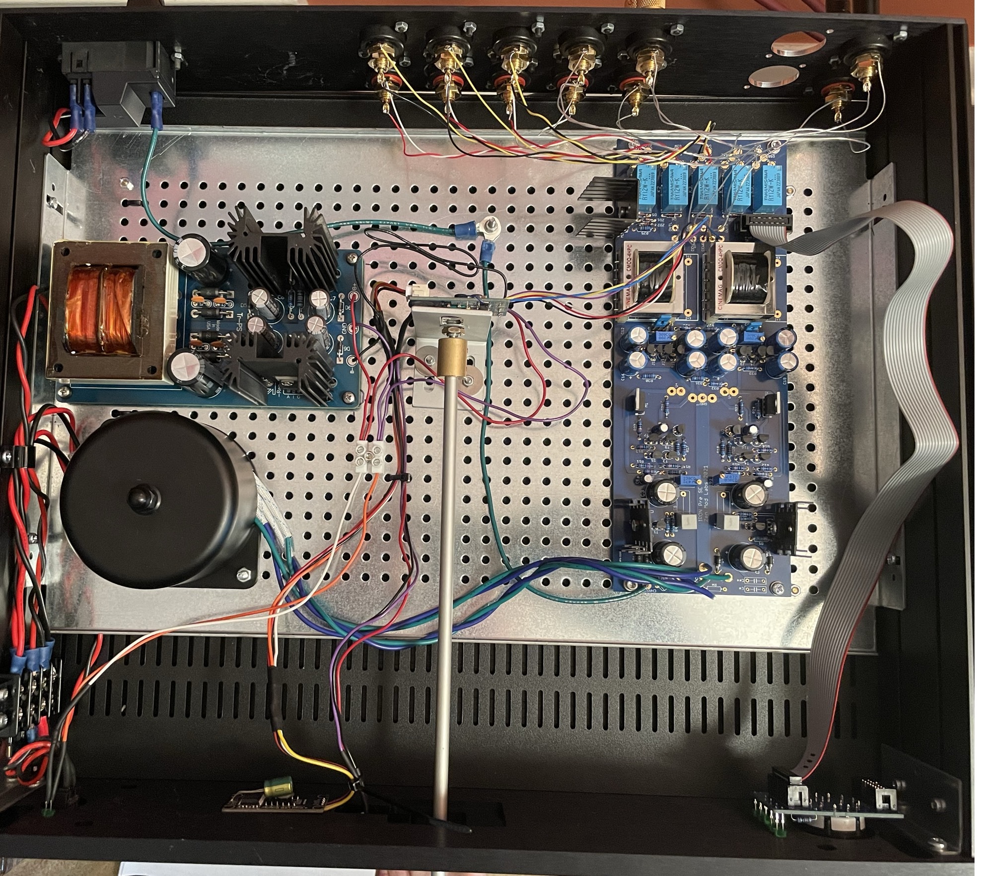

Here's a picture of the wiring between the board and the VCX. And a bonus picture of the Rosetta Stone that I referenced about one zillion times while swapping out the VCX for a regular potentiometer.
I just wired it in like a pot -- no extra capacitors or whatnot. Is this good? I dunno. Sounds good. I'm not sure I'm comfortable suggesting that anyone do what I did, but that's what I did.

Nice job. I've done something similar on a few preamps once I realized the sonic benefits of Muses, to say nothing of having a remote control for the family. It's worth the effort in my opinion. This is a tidy supply with it's own donut. Bunch of old Apple remotes kicking around that now have new life—it looks like you can program other remotes with the Academy control.

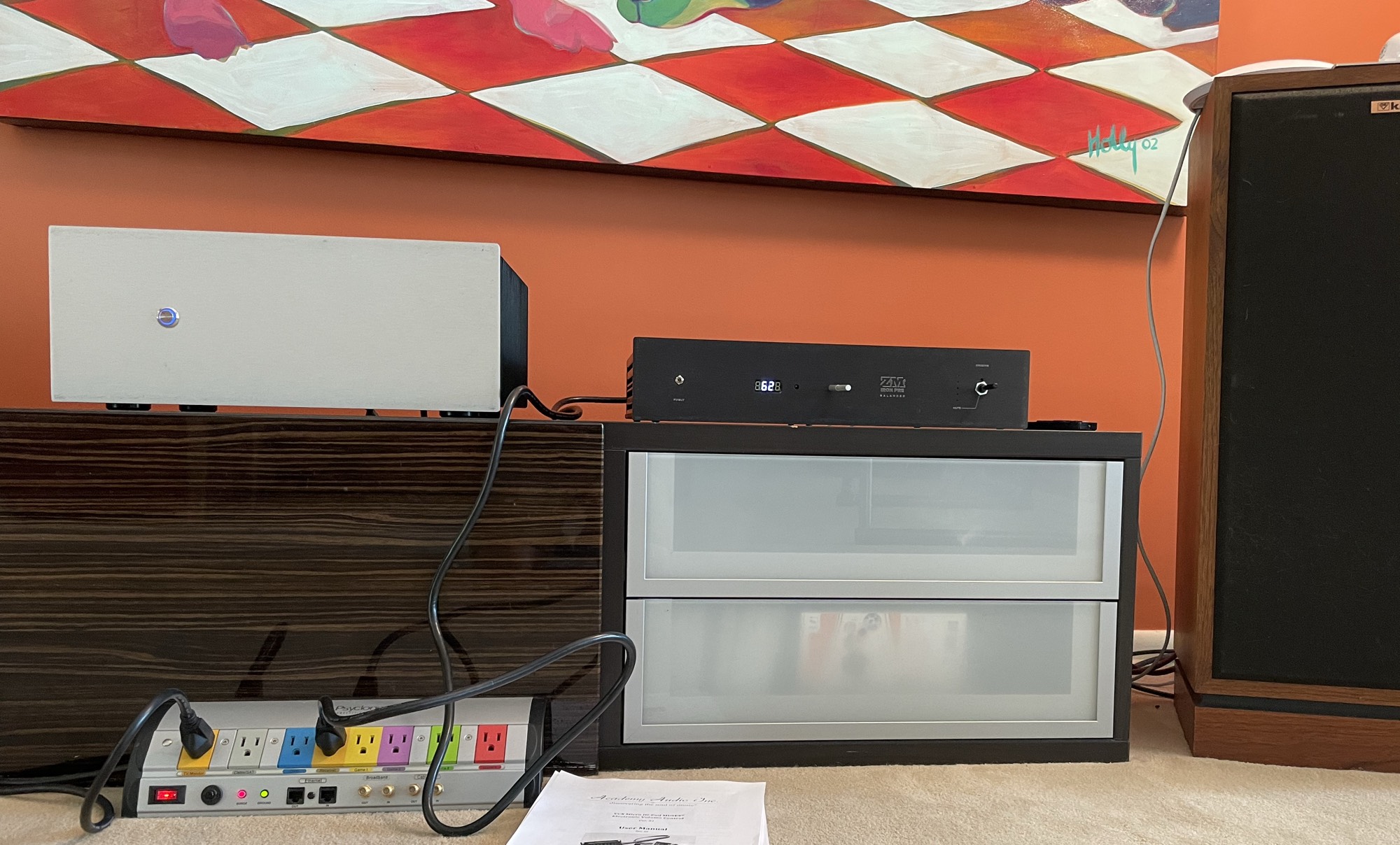

Just a sidenote, for those with Iron Pre's and Aleph-class amps, try pairing the two. I'm listening to records through my Iron Pre and Aleph "20" clone and I think they complement in neat ways. Think Tom Petty's Full Moon Fever, Lynyrd Skynyrd (self titled), maybe ZZ Top, this is a sound.

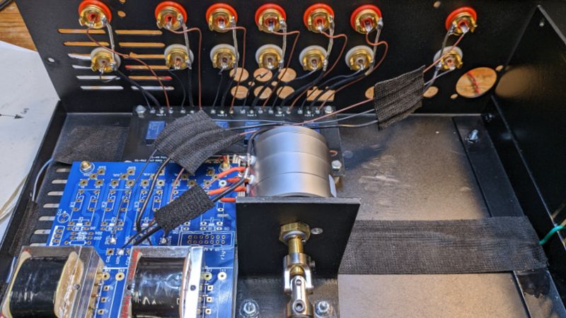

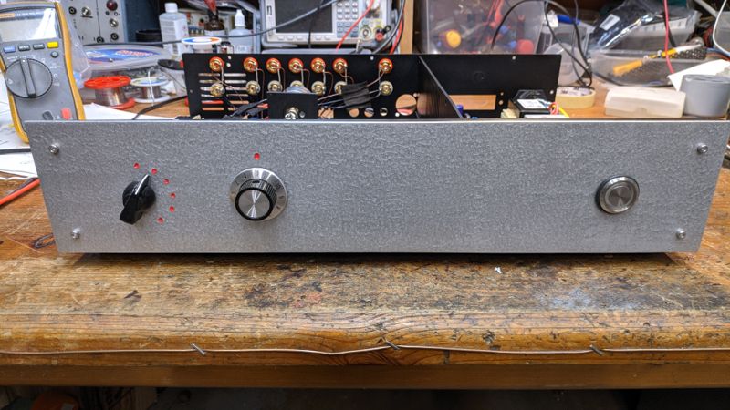

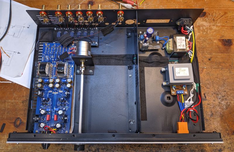

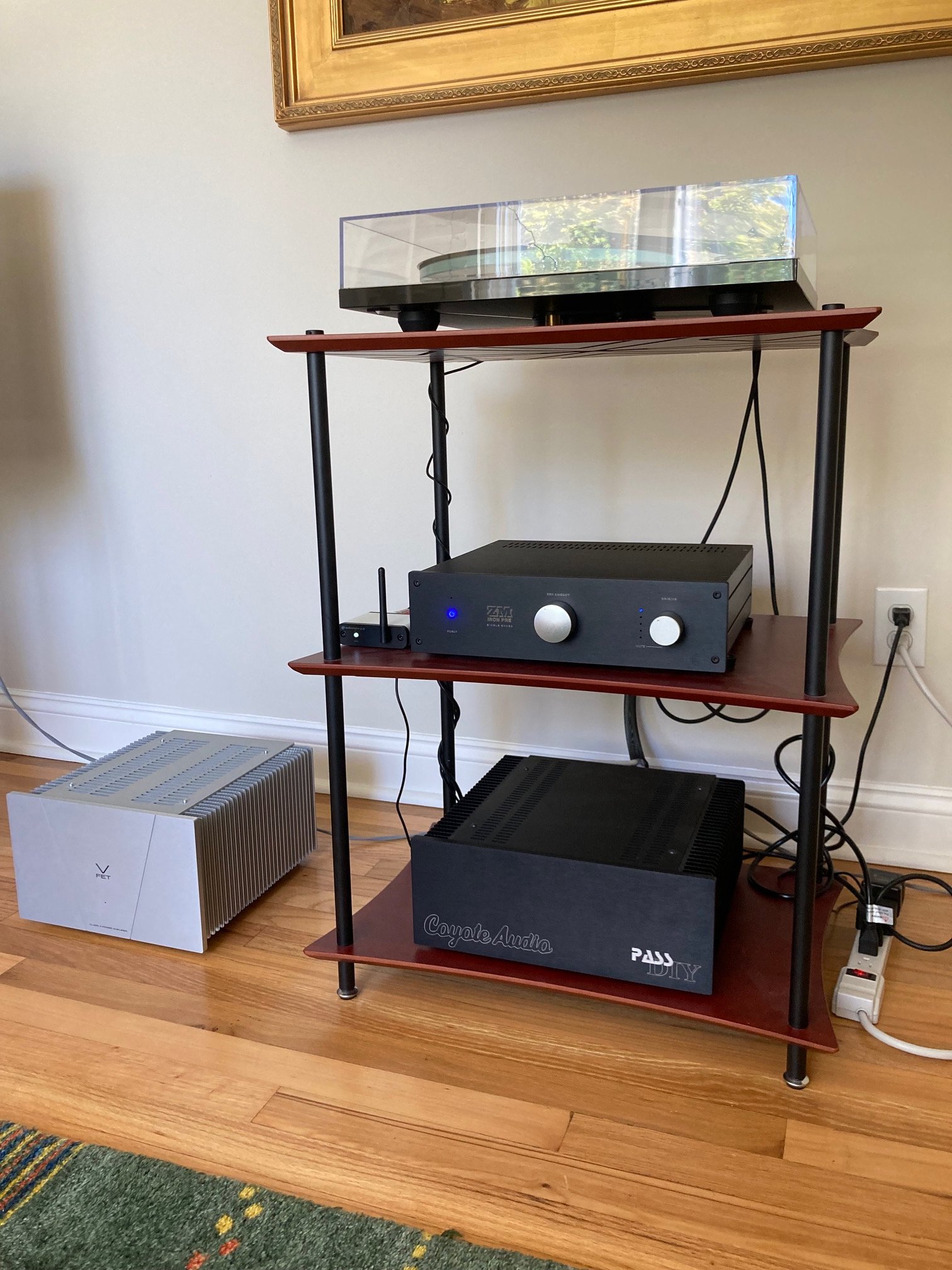

The last build I posted back up the thread a bit was for a friend who needed a bit of help getting it together. This build is my own one, all went very smoothly putting it together. I'm using my own relay input board as I have standardised on 6 inputs so the input wiring is a little different as a result. As with the on-board relay supply, this relay supply is completely separate to the audio power supply.
