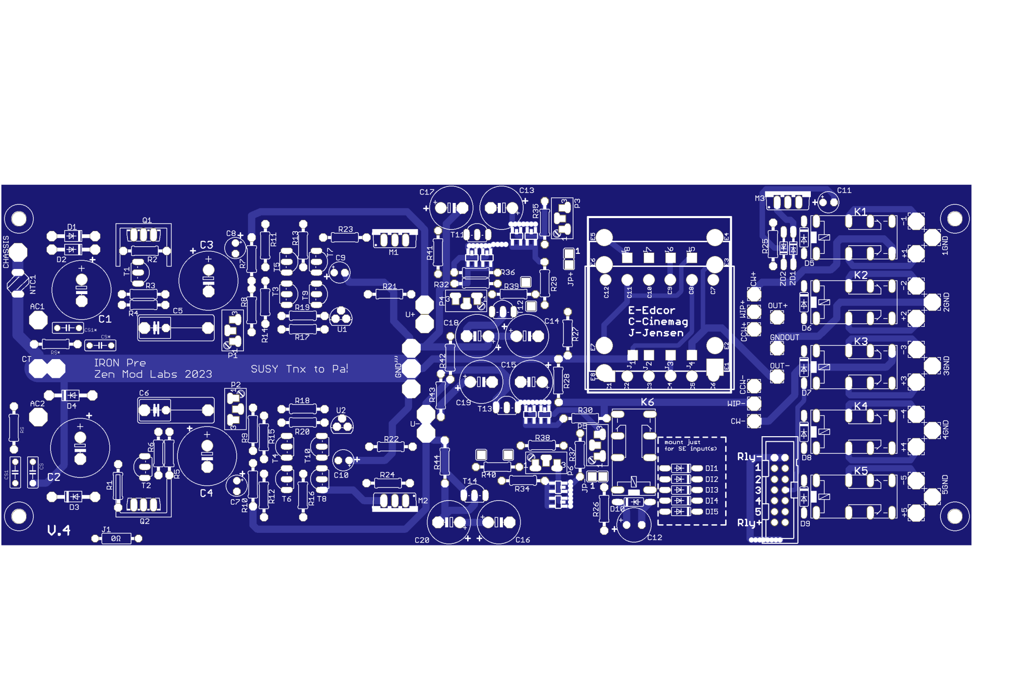

Then it is possible to mount the Cinemag without using a Dremel tool!
to my untrained eyes, it seems that you boyz made an issue of nothing
that right pin of small resistor is having exactly same height as pin of "regular" 0207
I've seen proper real ookoops in commercially made gadgets, no one really bothered to fix them for production
anyhow, that is already taken care of, for next batch of pcbs in Store
and after that, this is planned
only possible tnx to IAIMH eagerness
Eagerness <=> Wakooness

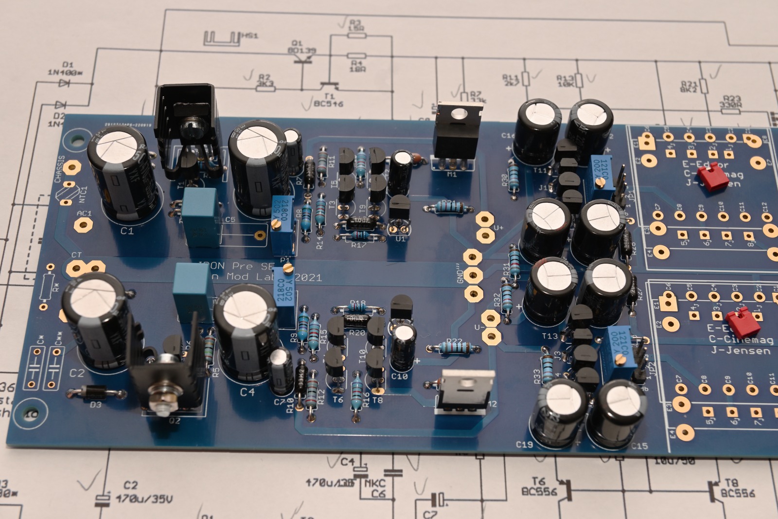

The trick is to avoid that solder it "flooded" too much at the "upper side". The small resistors have much thinner legs so maybe this makes it easier to apply small amount of solder......but the real reason why I used the miniature 330R was that I ordered them by a mistake.......most other resistors I got was the "normal" size 🙂
I haven't built the current version but thanks to MEPER's photo this really shouldn't be a problem with a recommended size resistor and a bit of care in bending the leads. It'll be a good idea to do a test fitting with the Cinemag transformer just to verify before soldering things in place.

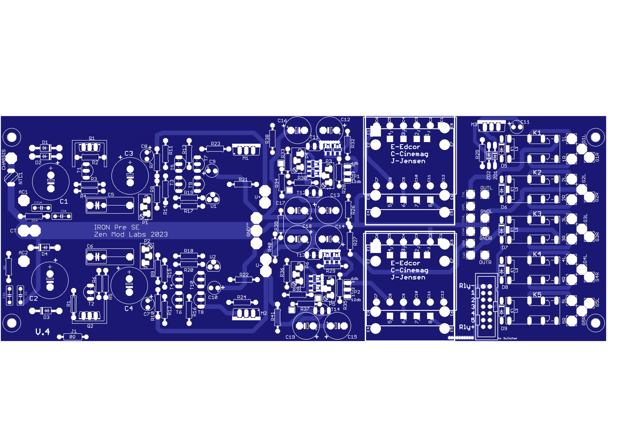

With the earlier prototype boards, one needs to snip off the four (unconnected) corner pins on the Cinemag, so this is pretty easy to do in comparison.
R3/R4 and R5/R6 is a parallel combination of 15R/18R.
Is that done to share the load or because it can be difficult to get the small resistors < 10R?
I have 18R in backorder but have more 15R "in stock". Would 2 x 15R work? (it would give 7.5R vs. 8.2R).
I ended up using 2 x 15R in parallel = 7R5 (a nice midpoint between 6 and 9).
I have installed most components. Hopefully without any obvious mistakes 🙂
Cinemags still have to go in. In principle the board could be tested / adjusted "as-is".
Think I used six different brands of resistors! ......what a mess.....and what about the red jumpers.....now everything else are mostly black and blue.....?
