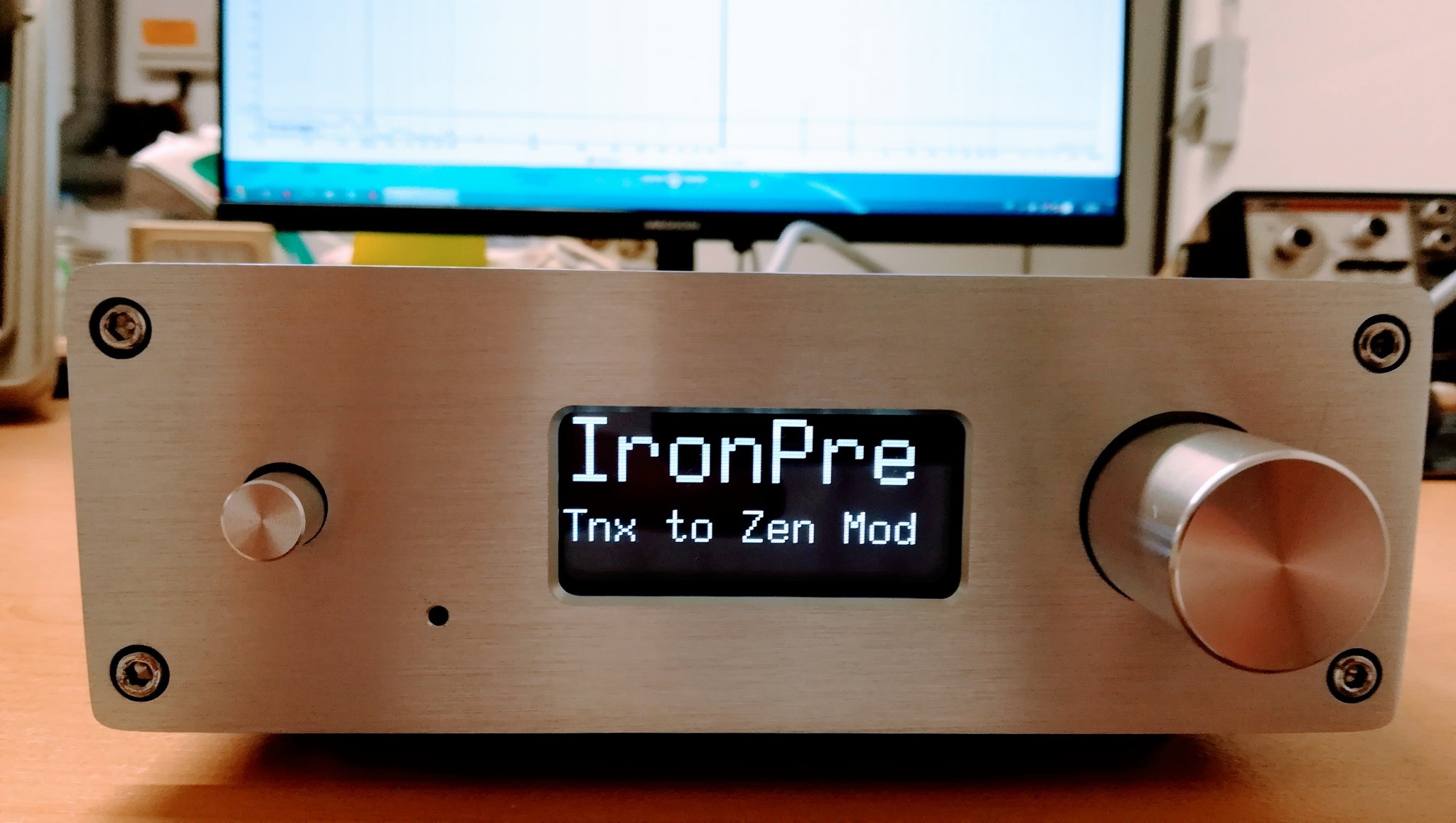

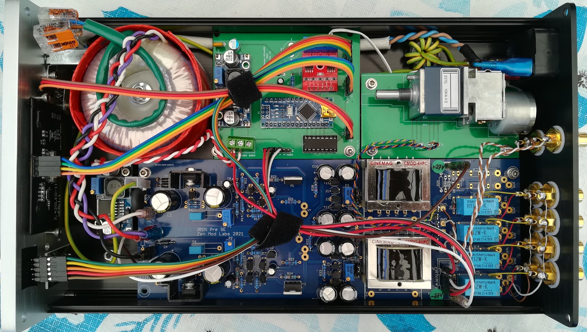

Yet another Iron Pre SE with remote control in a small DAC case. My build has four inputs and is using an 10k ALPS motor pot.
Remote section is fed from the pre PSU at +/- 27V points using a DC-DC step-down converter to 12V. Additional current required for Nano and OLED = 50 mA and for motor pot when active = 100 mA. This means about 2W more power is needed but is no problem for 30 VA donut.

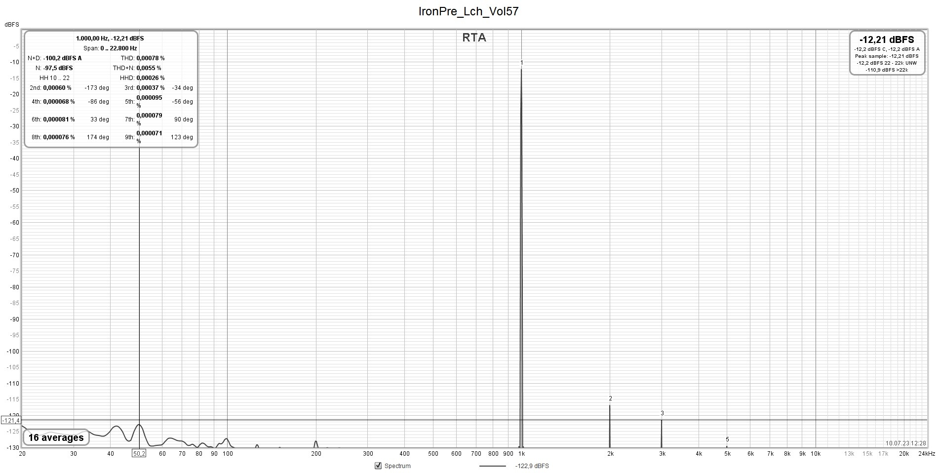

This preamp shows absolutely top drawer performance:
• Very low noise level. The highest level of interference components at 50 Hz is under -120 dB, which is practically hard to hear with 90 dB efficient speakers and my old ears.

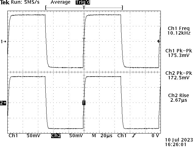

• The response to the 10 kHz square wave is excellent. I didn't expect this from the Cinemags and was at least anticipating some slight overshoot or wavy spot. But I have been proven wrong in the best way possible.
• There are no high-frequency interference components visible or audible that could come from the used 150 kHz DC-DC converter. THD level measured with REW is a bit better than one showed in loopback mode. So, the limitations of my vintage soundcard are reached.

Still looking through your pics at some of the details. One thing I never considered (among many) is that I have a couple of the 4-gang alps motorized pots for differential builds. Your PCB to connect to the controller etc. is brilliant...
Once I learn a more, I've got that added to my list to try. I'm taking a KiCad class .... but it's going slowly.

I also love the braided power leads. 👍Your PCB to connect to the controller etc. is brilliant...
Braids are nice but at least in theory not the technique that provides the smallest loop area. But as long as it is quiet, who cares. I have done it myself several times.

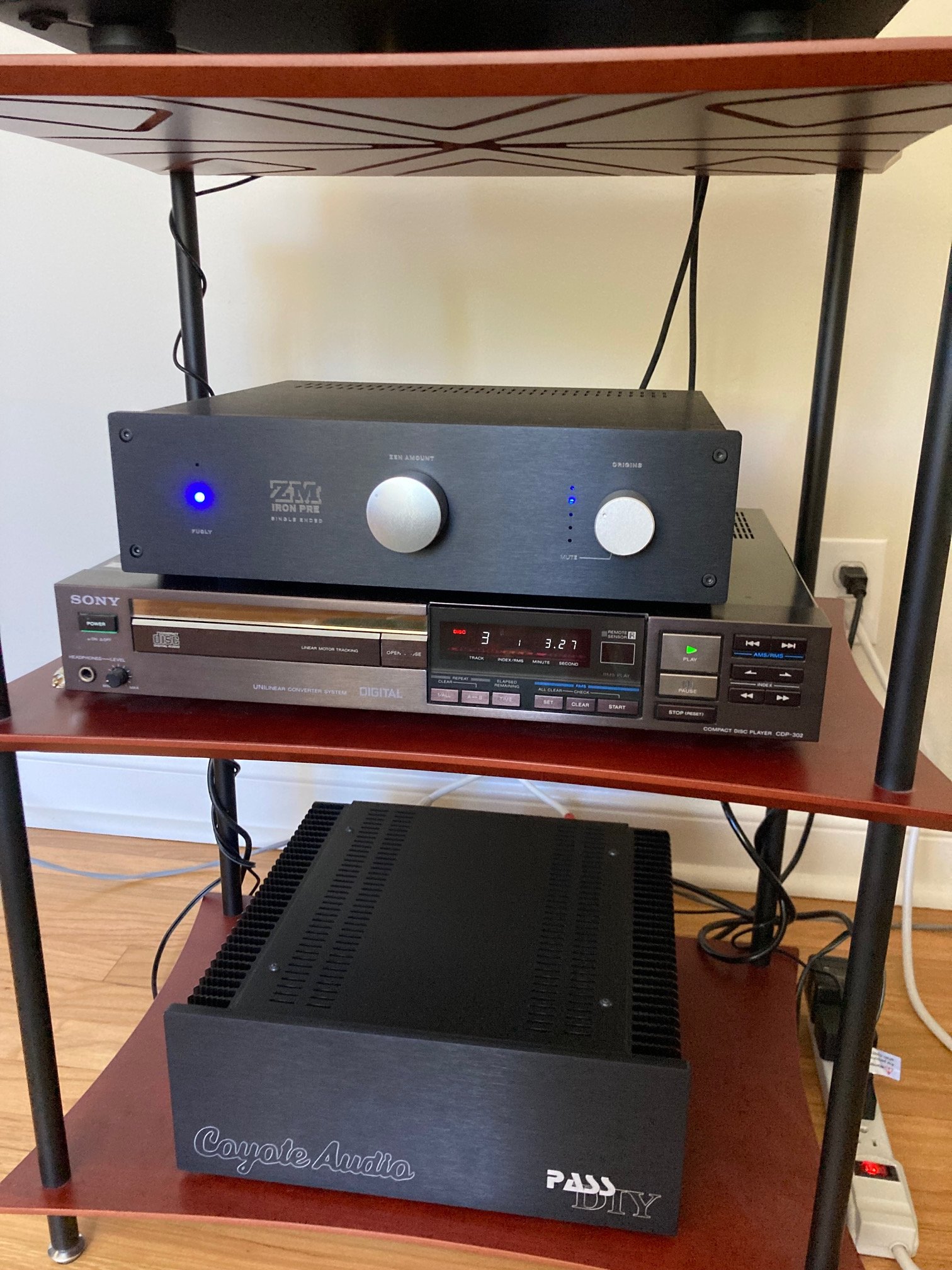

Can I just advocate for the Iron Pre for a minute here? This is hands down the most Roq en Roll preamp I've had in my system so far. I have an old Sony CD player, a CDP-302, that was on the fritz for a while. I fixed it today & put it back in my system & I didn't realize how much I missed my 90's alternative rock- Jane's Addiction, The Red Hot Chili Peppers, Radiohead, all that stuff where 'wall of sound' or mixed for 6dB of dynamic range or whatever was in vogue, just full fuzz full volume noise that can sound like crap on a system that isn't clean. This system is clean though, and the Iron Pre driving my Aleph 20 clone is just beautiful and forward and full of energy and nothing is missing and it's amazing to me how good this stuff sounds. The volume is up and I am dancing.
I like the effect of some passive voltage gain in my system. Of course it's important to use some good iron that is driven properly. Papa, ZM, Mark J., these guys know how to do it right when they implement one.
that's - Blue LEDs singing
no other secret
