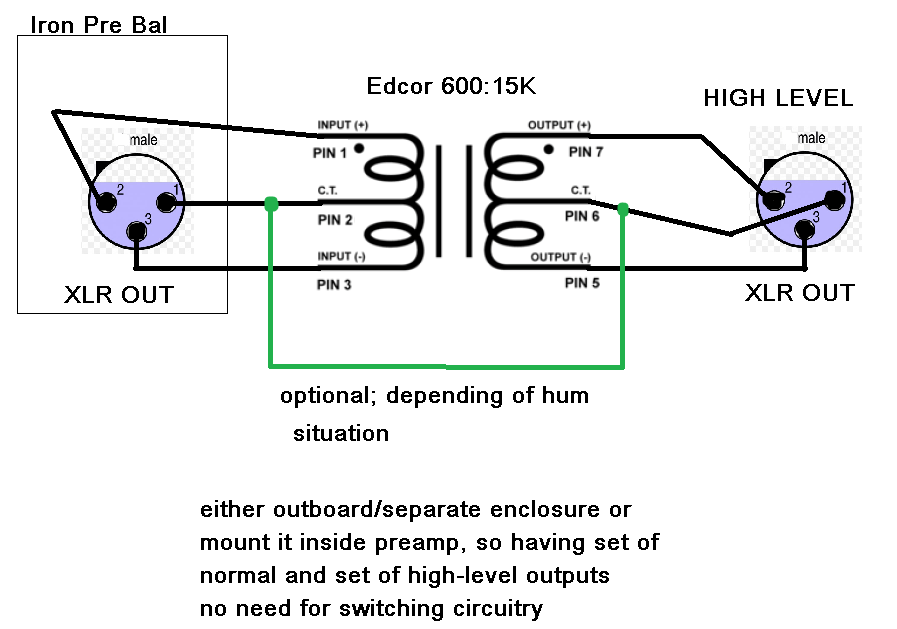

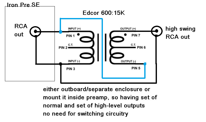

how to add Edcor 600:15K to Iron Pre preamps, both SE and Bal;
SE - to have additional 6V/V (almost 15.6db) of gain
Bal - to have additional 5V/V (almost 14db) of gain
note: see on Edcor site - 2 different wattage options of said Edcor; weaker one ( used in M2) as proven, stronger one (more lamms) for lesser THD when swinging high
bare with me - I did use female XLR sketch at first, by mistake
later edited to write male and blackened pins
take care of pin numbers, not notch triangle shown; anyhow, I'm never caring for notch in vivo - always looking at number of pin

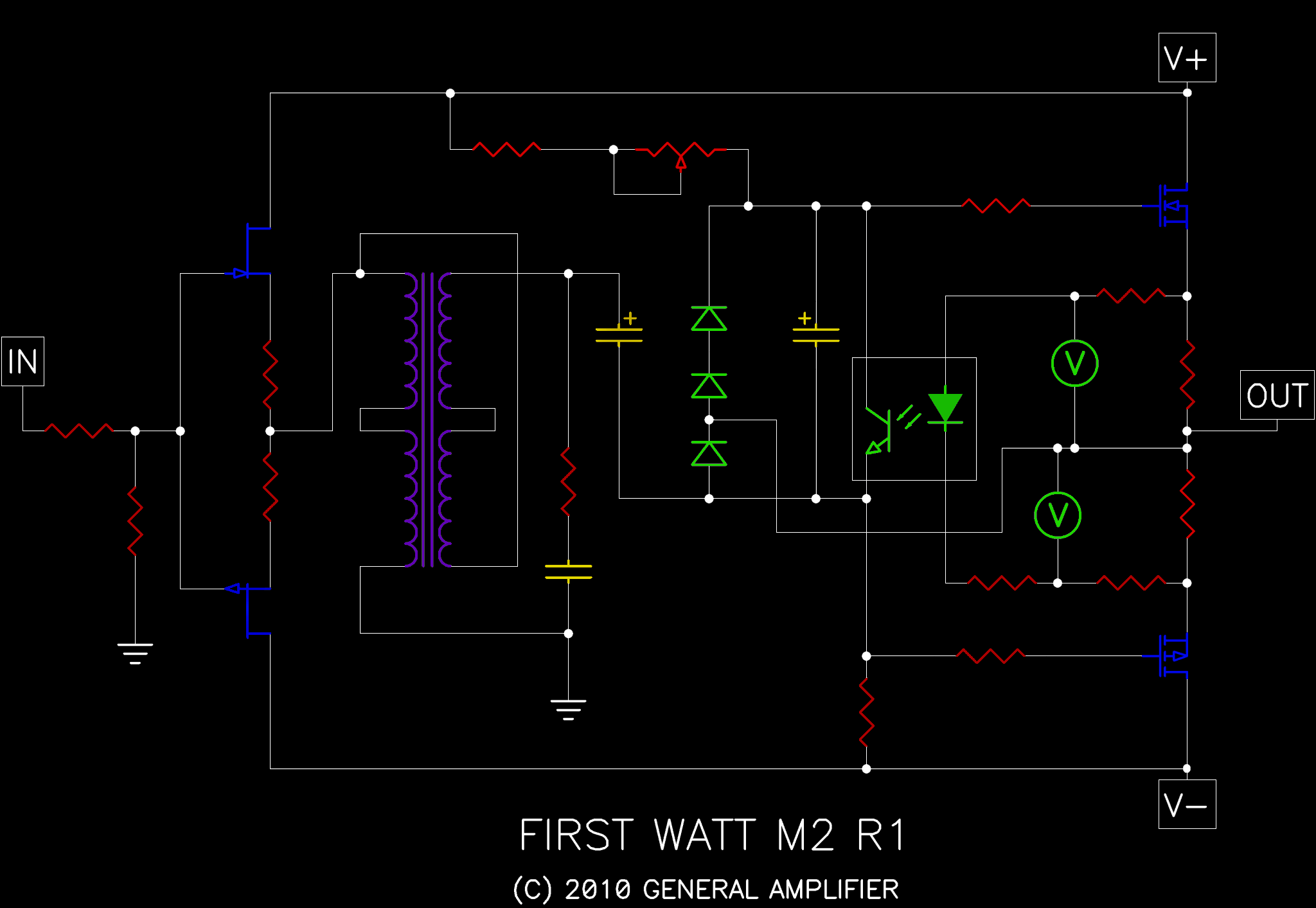

M2 coming in queue. After F4 and Gen 1 Sony VFET pairing.but, M2 ....... not "just" Swiss Knife of Papastable, but definitely most impressive wall poster
Ha! You coming up with these circuits? I can restore/build vintage aeroplanes, race cars, heavy iron, and make sawdust but you can corral electrons.Snagit and MS Paint
naah
I'm just stealing those from Papacoral

Still, it's like herding cats. Squeezing them into line and making them sing. I am in awe of your ability and of your mentor.Papa's

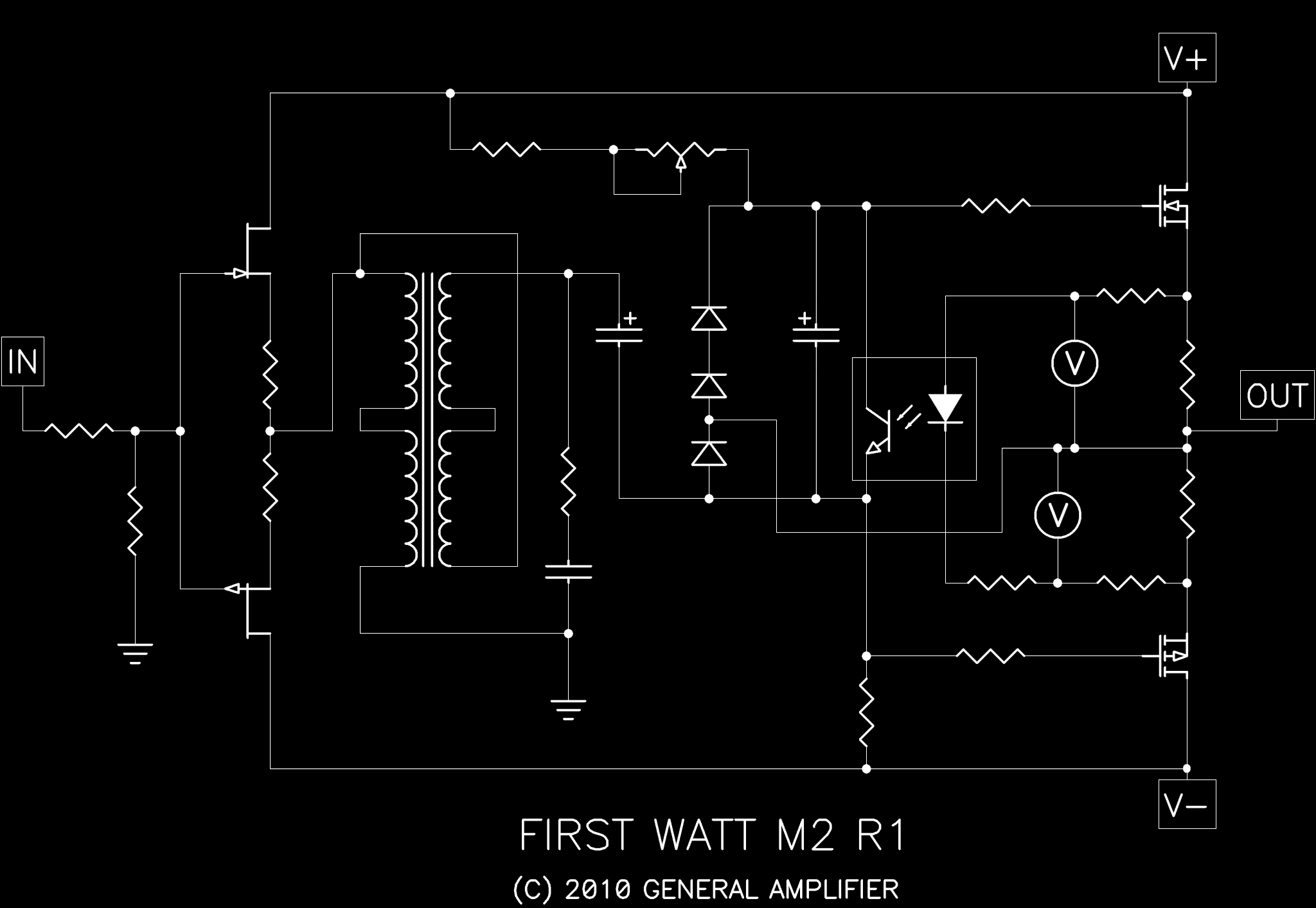

I hope you don't mind, ZM. I tidied up the thin lines in MS Paint to be more consistent and completely white.Snagit and MS Paint, simple as that
If you zoom to 100%, you'll see what I mean.
