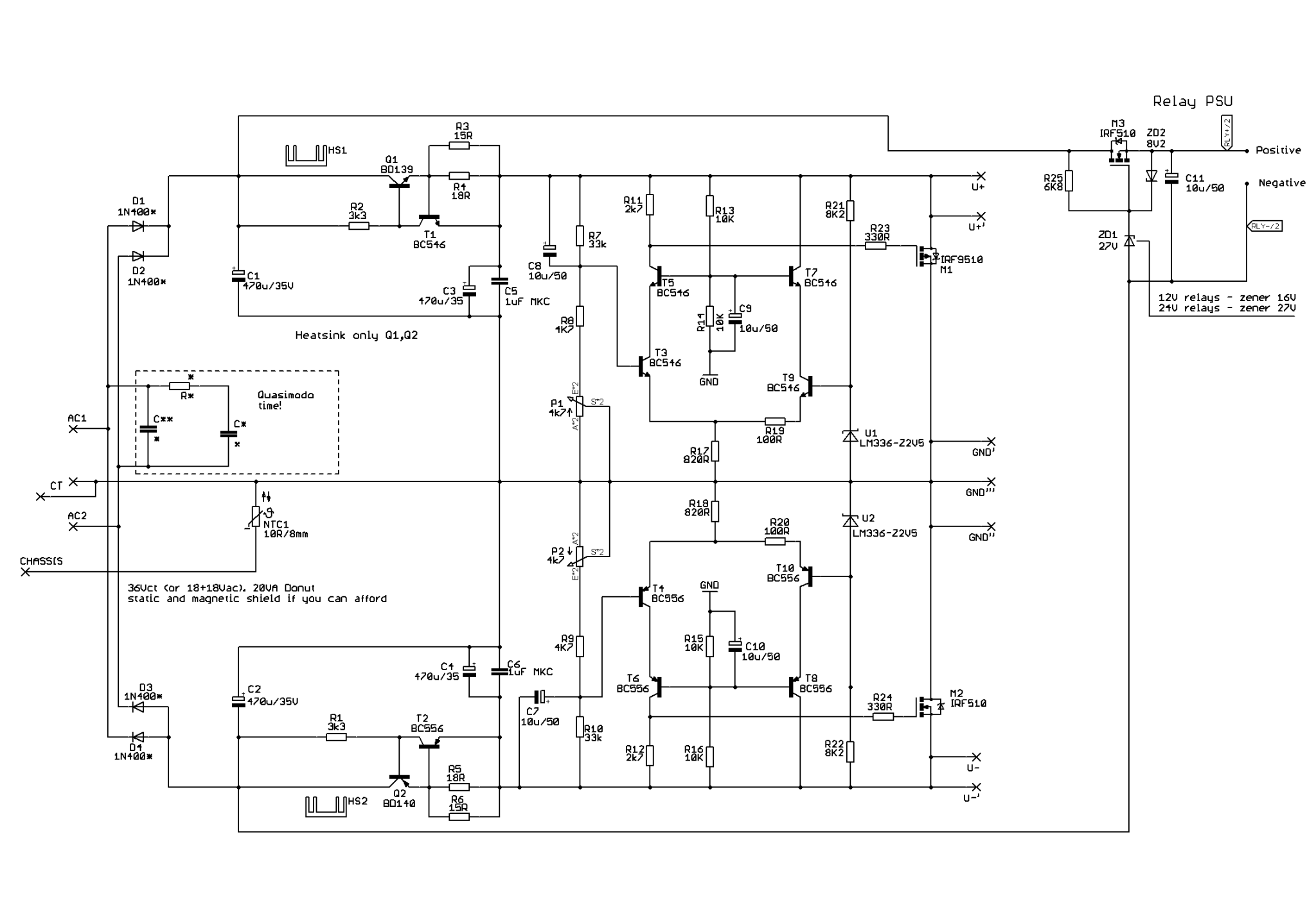

Schematic posted in #61 shows R4 and R5 at 18ohm, while the BOM and Mouser cart I'm looking at say 15ohm for R4 and R5...which am I to believe?

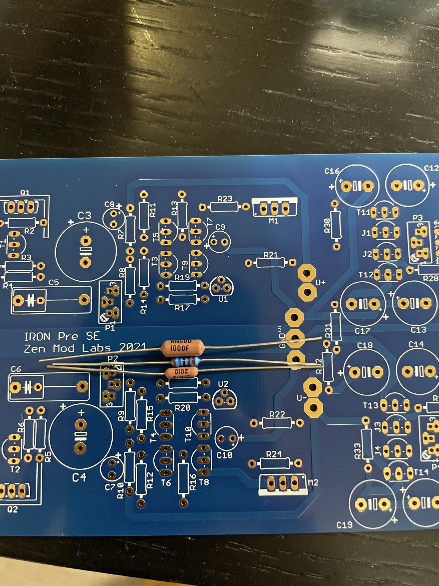

I believe I read Vishay RN60D does not fit this board. Can anyone confirm or deny? I do not have boards in hand yet.
^ I would not use RN60s. Too big physically, but you may be creative. Excellent call out re: R4 and R5.
@Zen Mod - We've had a few iterations. Should R4 and R5 be 15R or 18R or doesn't matter? In parallel with R3 and R6.
Specifically, we're referencing this latest schematic attached. Note... SE and Bal are the same for these positions. I can update as required.

Back home to do a few measurements. I'll do a quick BoM update noting pitch / size for resistors in addition to noting the 0207. Admittedly 0207 was new to me until ZM explained. 🙂
Pitch (space between the holes) is 10mm with the 'body' of the resistor in the silkscreen dimensioned to 7mm x 2mm. You can squeeze in something larger than 0207, and the leads for RN60s will fit the holes, but it would take some creativity to use them in all positions.
Here is a quick pic comparing an RN60, a generic 1/4 W resistor, and a CMF55 next to a resistor placement on the board.
use whatever you want .. 🙂
buffers are sinking, say, 7mA each
2 buffers per reg, so 15mA
shunt reg is programmed with simple calc Vbe/R, where Vbe is 0V65, R is (R3//R4)
if current consumption is 15mA, few mA needed for reg itself, funny figure for programmed current can be ......... 75mA
so, R= 0V65/75mA=8R6
conclusion - R3//R4 needs to be 8R6
practically- for R3 and R4 you can use any combo of 15R and 18R
either both 15R or one 15 another 18 or both 18
or whatever you have in drawer to get programmed current anywhere between 60mA and 100mA
R3,R4==R5,R6
edit: no need for LTSpice for such simple circs
I'll enclose schematics edited with all voltage nodes ....... noted
weekend, good enough?
editedit: 0207 resistors are perfect, none of them being stressed power-wise; in case of using bigger package resistors - use what your heart ache for, but don't weep later here just to determine having broken pad vias or something similar, just because you tried sneakers 2 sizes smaller than your feet
Yes, the 0207 is a Zen Mod Special. Hopefully no one has ordered RN65 resistors because they are listed as "1/4W". 🙂
