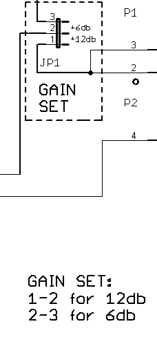

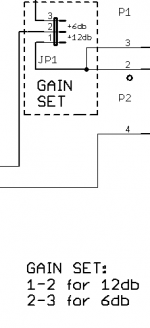

Hi guys, could you tell me please how's the gain of this preamp compared to B1 Nutube? Could I obtain the same level of this one?
Thank you,
Gaetano.

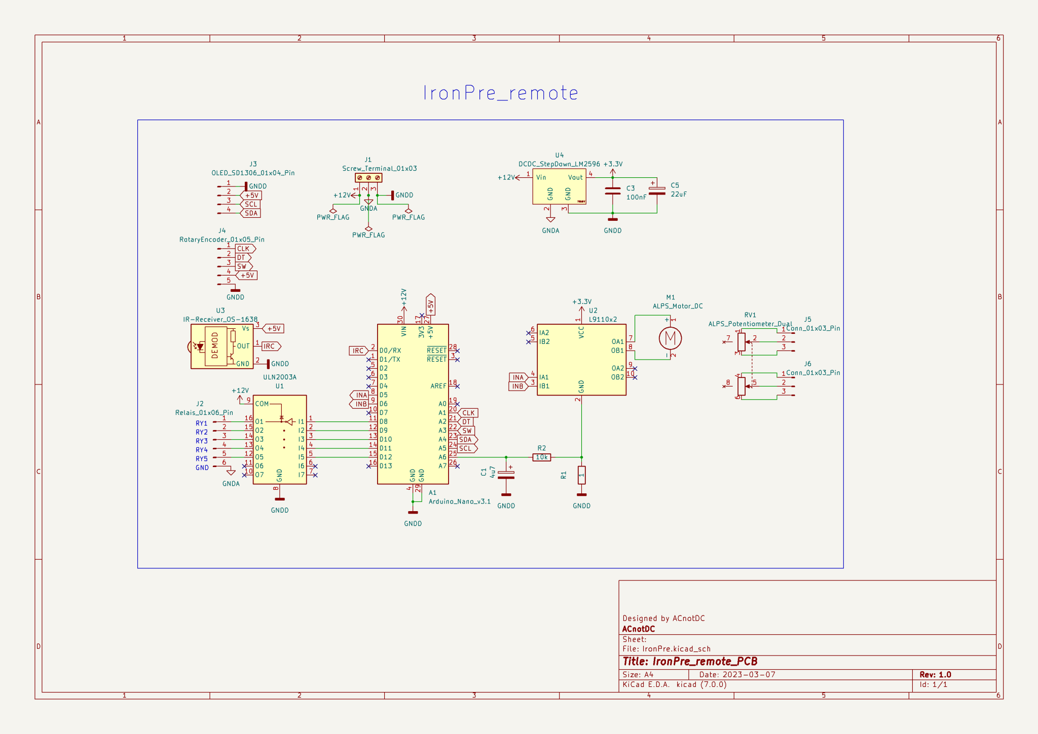

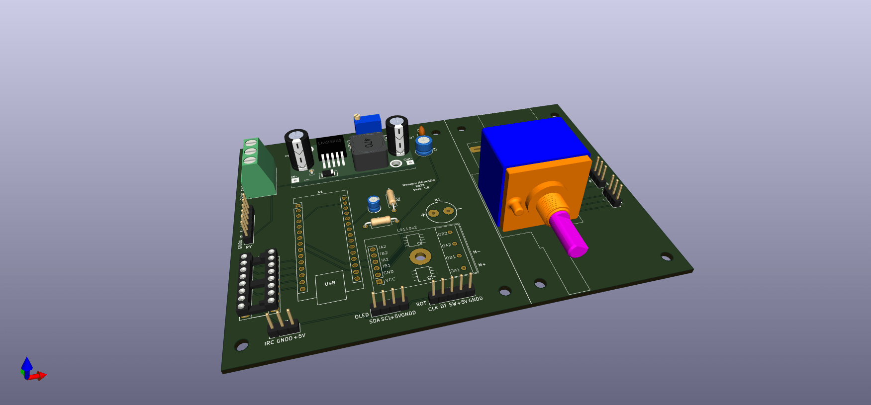

Gentlemen,
For those that have an empty bench waiting...
and want to remote control the IronPre with any old IR control lying around...
Long time ago I have asked if there would be an option for remote control for input selection and volume control in this project? (s. #15)
ZM's answer has motivated me to do something in between, because I am too lazy to stand up every time when I want to set volume or input on device.😉
Of course it has to be a low-cost solution as I'm an old GB too...🙂
Here are the requirements:
1. Remote volume control + muting with motorized ALPS pot
2. Remote control for input selection
3. Digital display of current volume and input with tiny OLED on front plate
4. Volume and input control with one rotary switch directly on device
If anyone is interested, I would provide more details...

Excellent idea. I'd love to see your remote control project in more detail.
I'm working on a similar project, but slightly different.
@ACnotDC - That is SUPER neat-o! I would definitely try something like that. Personally, I'm OK with manually selecting inputs, since I typically only do it once per listening session. However, remote volume (and particularly mute) is almost a requirement for me.
