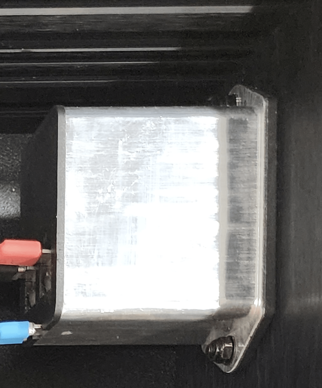

I have a DD12.9111.111 power entry module on hand from another project that I would like to use for the Iron Pre, but it's too big to fit in the modushop chassis. @MEPER am I right that that you removed the external metal enclosure from the power entry module? If so, how? I haven't yet resorted to a crowbar, but I'm not seeing how go get the metal off. I was about to order the DD12.1121.111 but from the spec sheet it looks like I'll run into the same fit issue. Would prefer to not deal with cutting the hole bigger if I can avoid it.The DD12 fits nicely in my built.
It was a "press fit" and it has to be inserted from the "inside" so it is the plastic frame that it inserted in the hole.
From the outside it is to possible. Then it is too large to fit.

How are you trying to mount it? It mounts from the inside, so the backplate is flush. See example pics.I have a DD12.9111.111 power entry module on hand from another project that I would like to use for the Iron Pre, but it's too big to fit in the modushop chassis.
If it does not fit, I'd contact Gianluca. He's a delight to work with, and I'm sure a solution can be found.
Wow, thank you all for catching me in a major dunce of a moment there! It's amazing the blinders I can put on in my thinking sometimes. The notion that the IEC could mount from the inside did not cross my mind one bit (and now I see that's what @MEPER was describing - I completely misread the post). Thanks for your patient explanation and counsel, and for preventing me from doing something even more stupid!

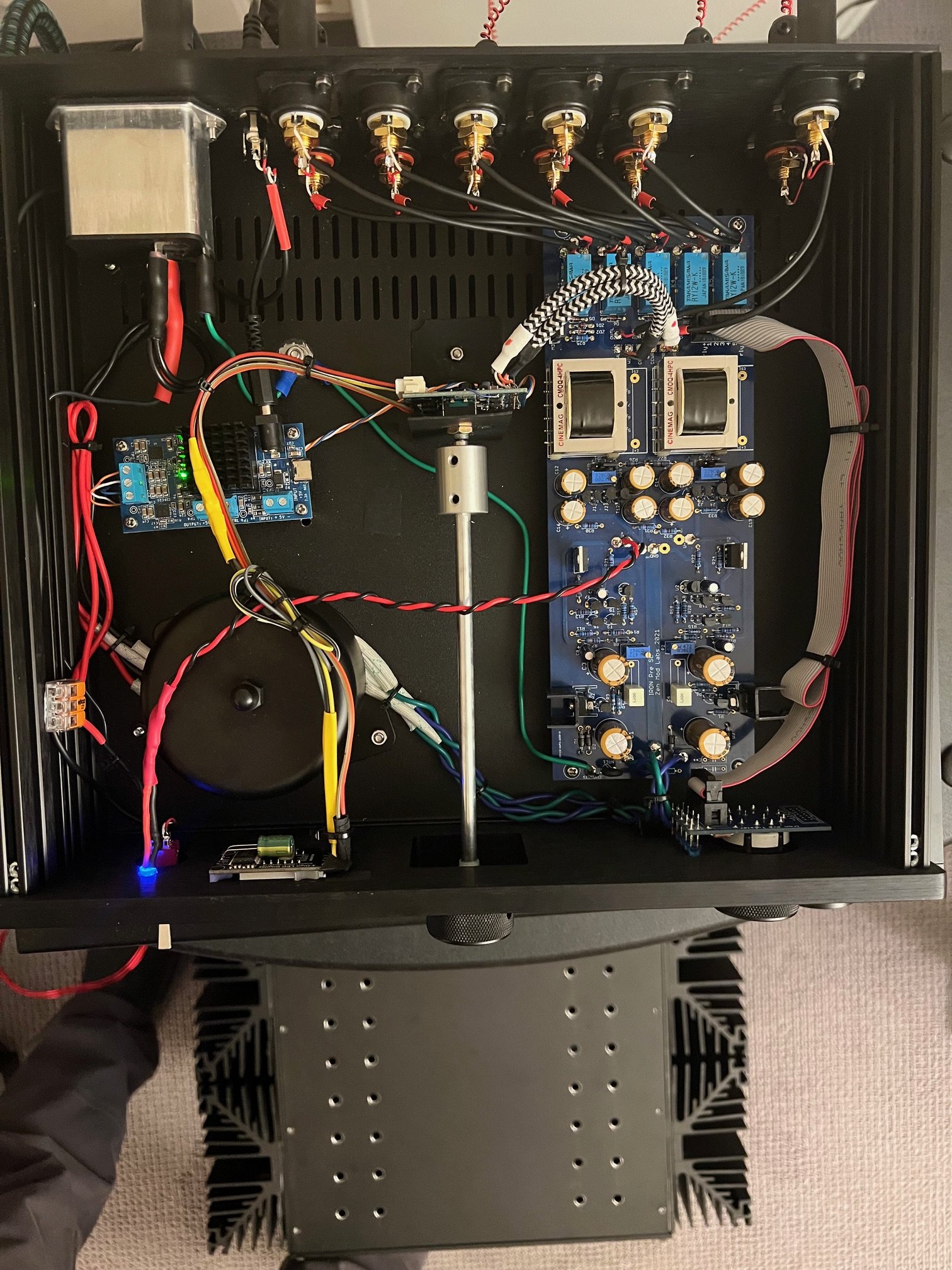

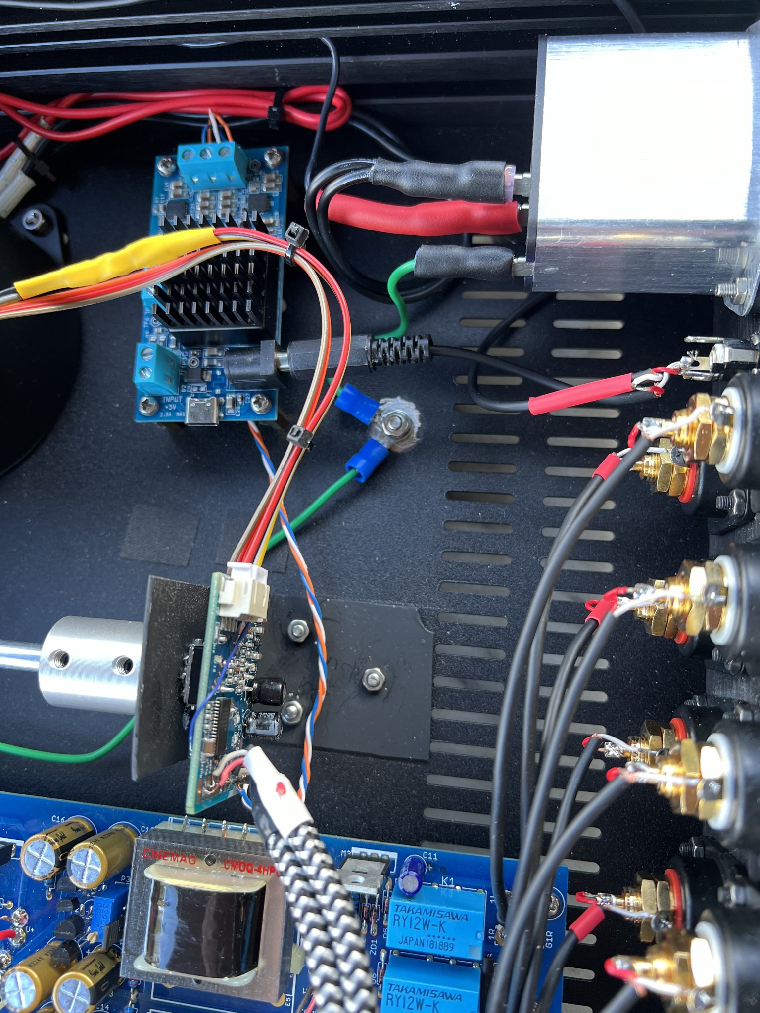

Wanted to add my thanks to ZM and IAIMH for making this gem available to us and all of you early builders for simplying the process for us plodders. Simply put the Iron Pre it sounds great when added to the Sissysits! I completed the conventional build with an Alps pot to verify everything was working. Using 12 dB gain as have relatively inefficient speakers (86 dB). Plays plenty loud and I can listen at lower volumes without needing to push the volume to hear nuance and detail. Lived with the Alps for a few days and inspired by Timkrone posts 1104 and 1561 went ahead with the Academy Audio Muses volume control that somehow had intimidated me. Used the VCX Micro. As it needs plus minus 14V and I didn't want to add donut or tap off power supply for Iron pre so I used their power supply- LPS9. It is powered by 5V wall wart. Added a jack in rear and it is switched by the front panel switch.

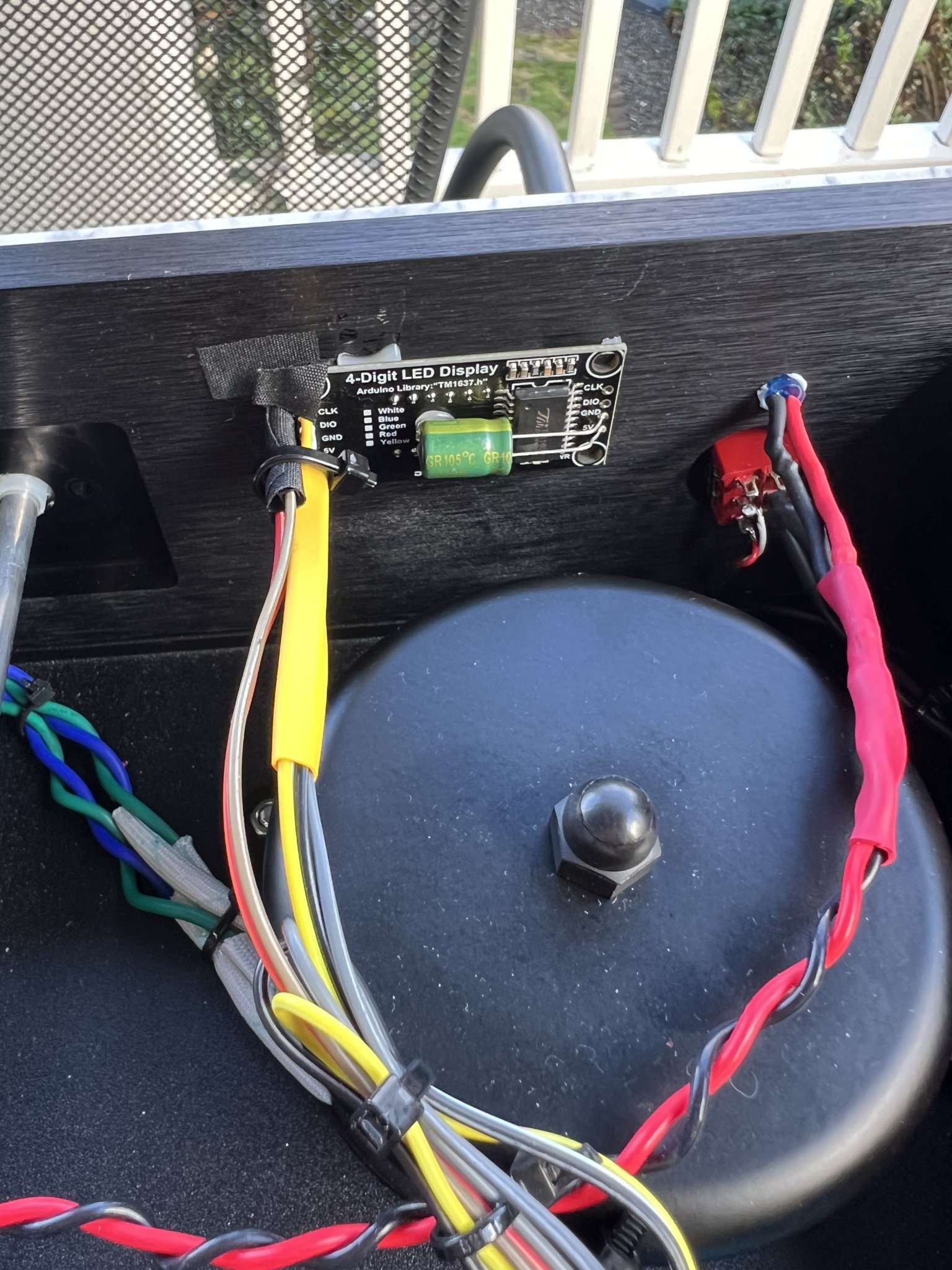

I had to extend wires for the digital display and also unsolder and place the ir receiver next to the display. I also had window cut in front panel to accommodate. So now have functional remote and in my opinion it sounds better with more detail than the Alps pot.
It powers up in standby and the volume range is 60-100. A bit odd but is very smooth and very convenient.
The Iron Pre replaced a DCG3 and Korg nutube and to my ear sounds great. Finding that I'm drawn in for extended listening.

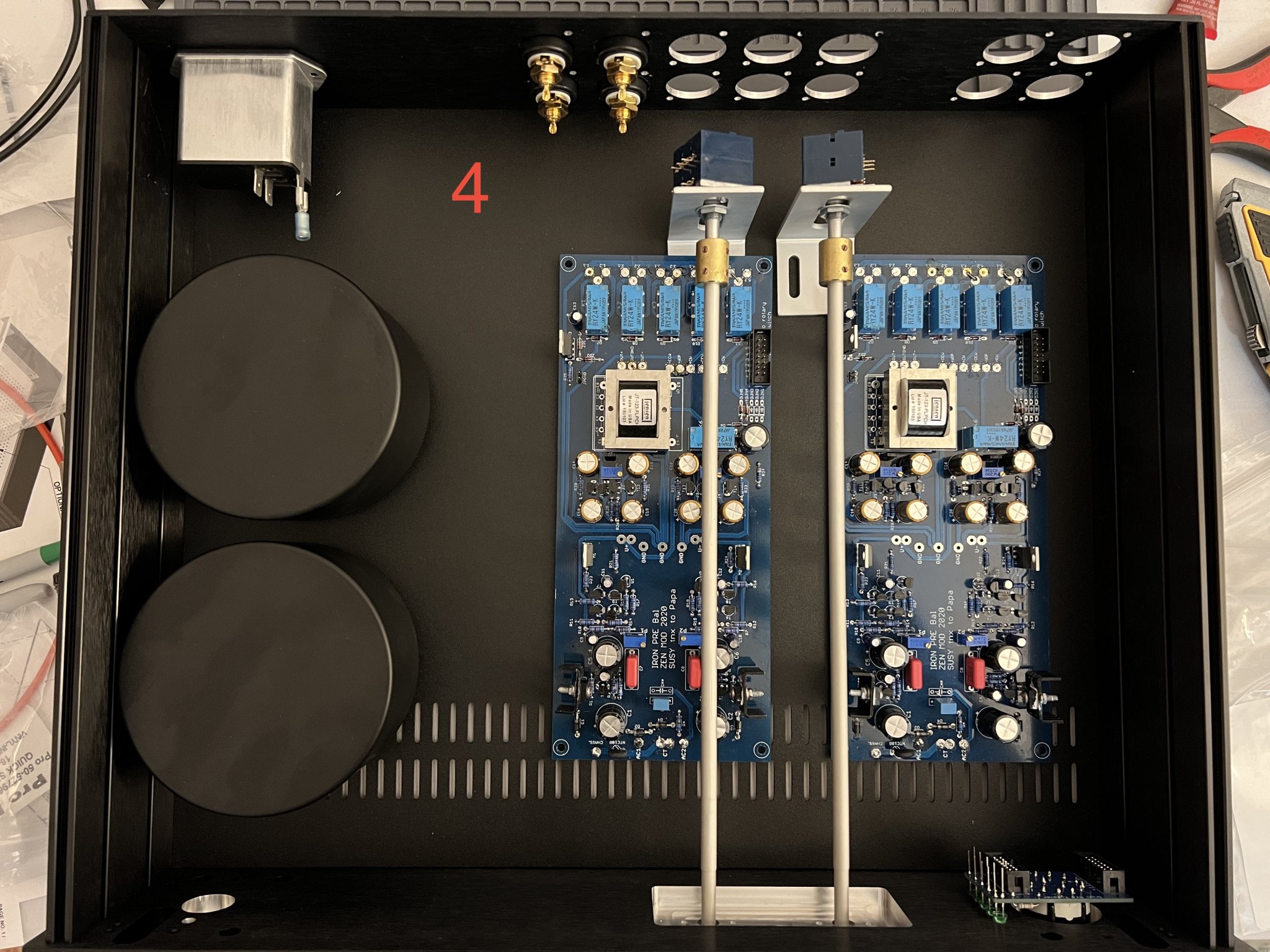

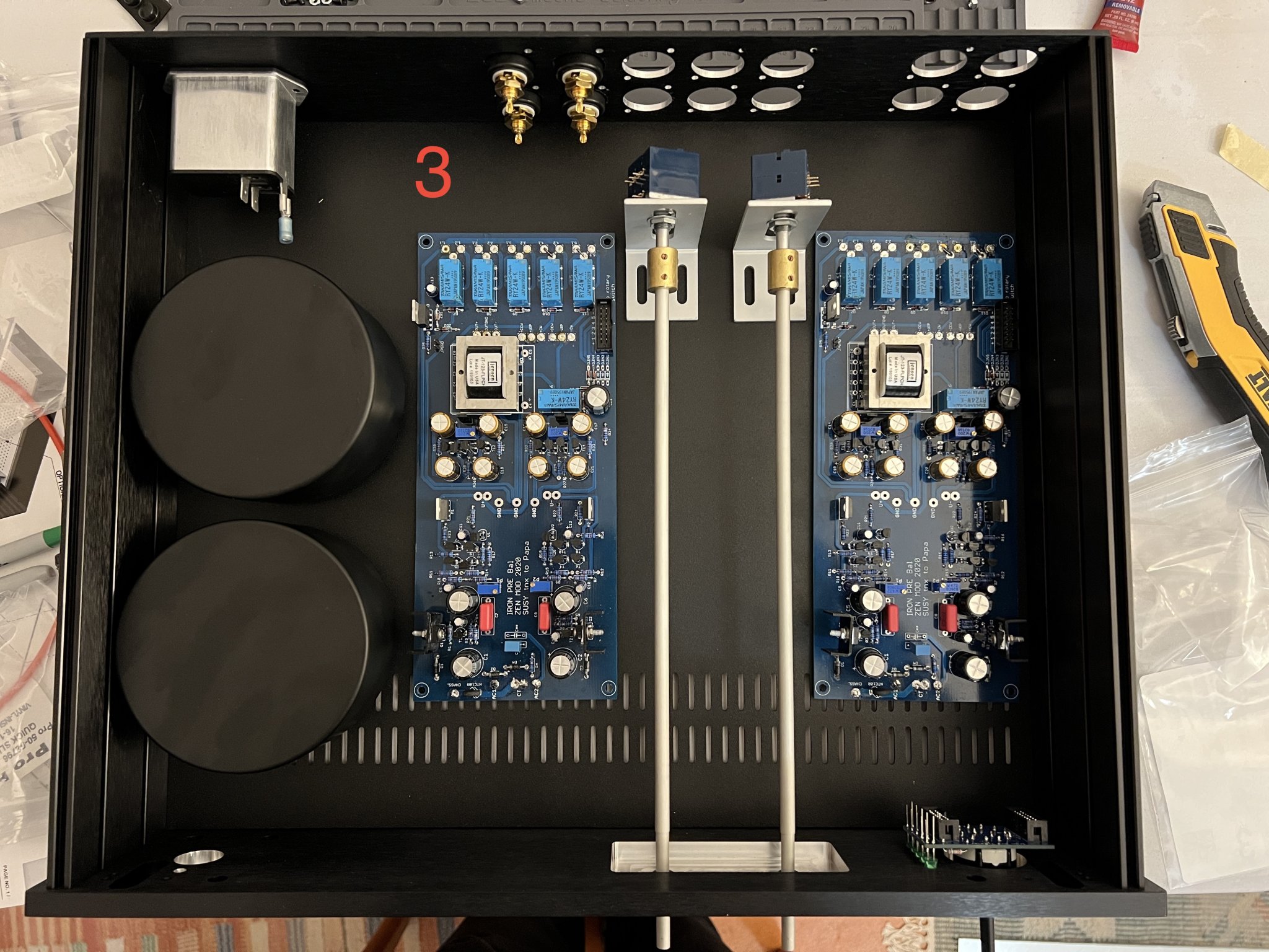

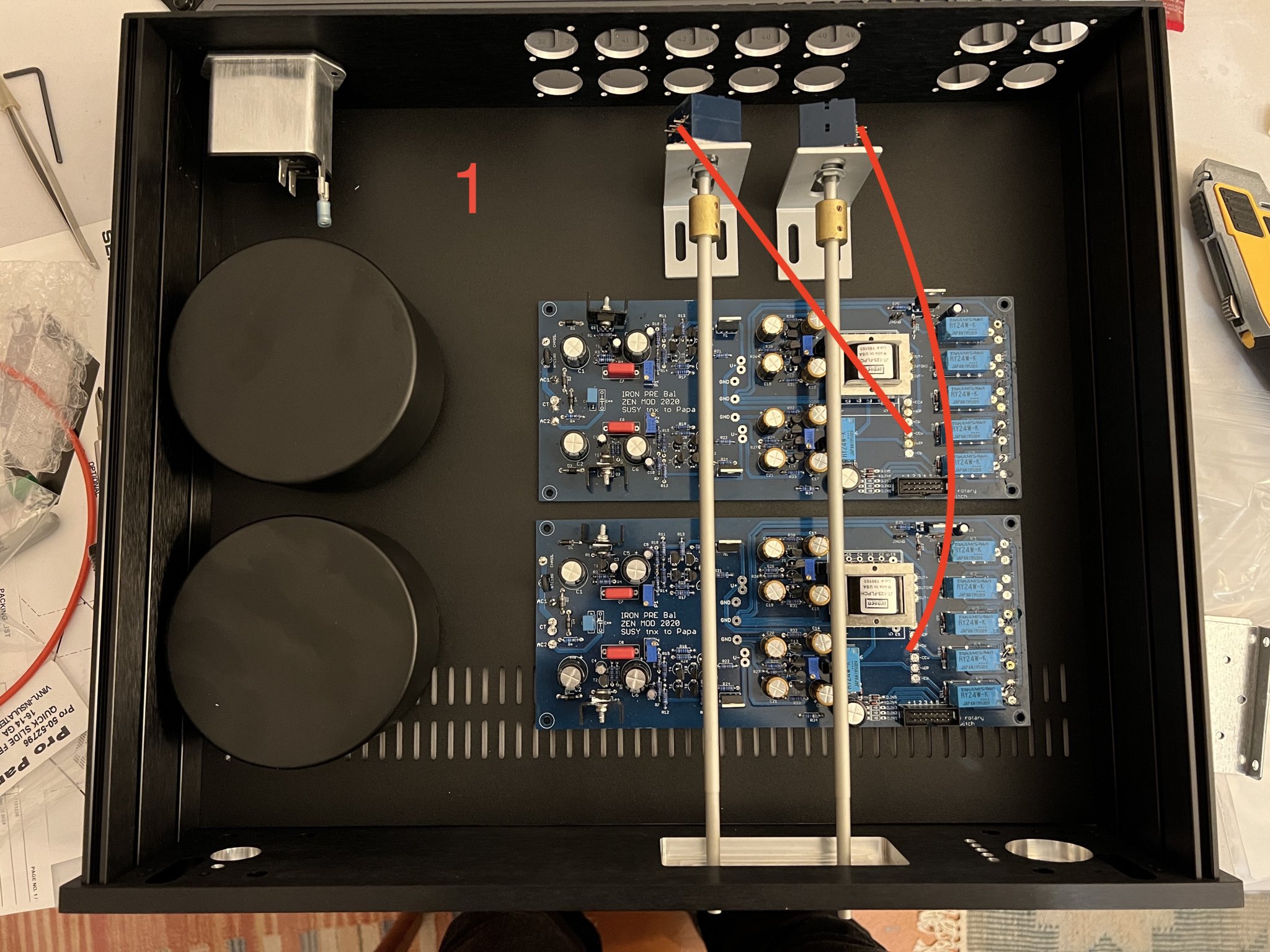

Trying to figure out best layout for a balanced IP that achieves the goal of short connections between volume pot and pcb and neat/clean wiring elsewhere. Attaching some photos with the configurations I've come up with. Here's my thoughts on each one:
1. I like the horizontal layout of the boards but nothing seems gained here by mounting the volume pots on extenders. Also, is there any disadvantage to having longer signal wiring runs from the PBC to the inputs?

3. I like how clean and tidy this one is, but worried the left board is too close to the transformers?
4. Better than #3 in terms of board proximity to transformers but signal wiring with the extender brackets in the way gets messy. Not as elegant or as clean as I would like.

4, but move both pcbs all tjhe way right, to keep them away of Donuts
have you Boyz any decent xformer mnfctrr in US of A, to buy some 10VA jobies, instead of forcing 1KW Donuts in preamp?
or is it peanut Donut in gallon sized pot?
you can spin those L brackets for pots to back, no reason to keep floor section under pcbs

I was a fan of the stacked boards idea and was considering going that route. Is there a compelling reason to avoid that idea?
