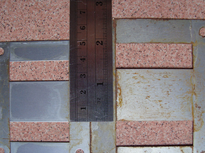

and i am waiting for you to give the core dimensions, core area is you can please....hard to tell from the photos....
i do not give credence to any label on the traffo alone.......

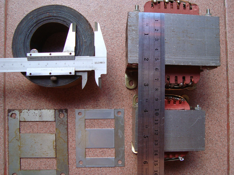

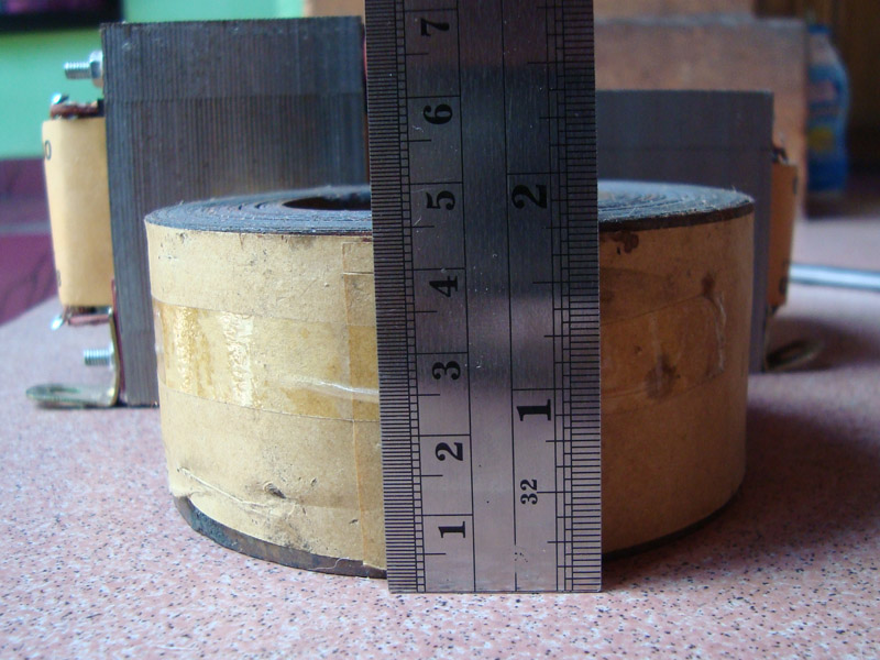

Sorry for that :no:, this is the core area size
no1 = 2.5cm * 4.5cm = 11.25cm²
no2 = 3.2cm * 5.3cm = 16.96cm²
& toroid = 2cm * 4.5cm = 9cm²

So here the formula + new formula:
for 50 Hz operation
@ B = 1T & E I core
N = 45 * U / A
@ B = 1.6T & toroidal core
N = 28.125 * U / A
for 60Hz operation
@ B = 1T & E I core
N = 37.5 * U / A
N = 23.4375 * U /A
Thanks for this formula
B = 50/f x 45 / (A x N) x U
f = frequency in Hz
U = rms value of voltage in V
A = magnetic core cross-section in cm²
B = flux density amplitude in T(tesla)
N = number of turns
Note : B can be vary from what material we use to make transformer

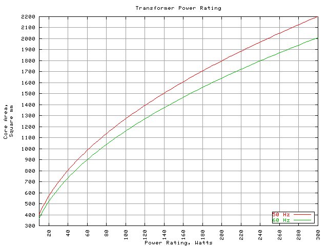

Then for the VA ratting we can see from those attachment
also from RDH3 VA = (5.58 * A)² or write like this VA = (5.58 * A) * (5.58 * A)
I hope No mistake from all that formula that I make
So next step is make it !!! :)
Thanks for all

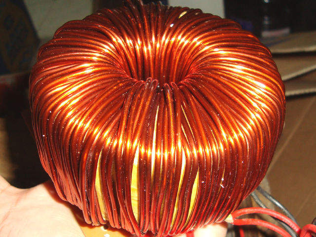

This one is trafo I have been made earlier
ImageShack® - Online Photo and Video Hosting
& this was how I winding the primary with double & same wire
to form input AC 110V in * 2 because easier to wind this way
but for safety it is not so good, better to use single 220V input
with good isolated per winding's layer

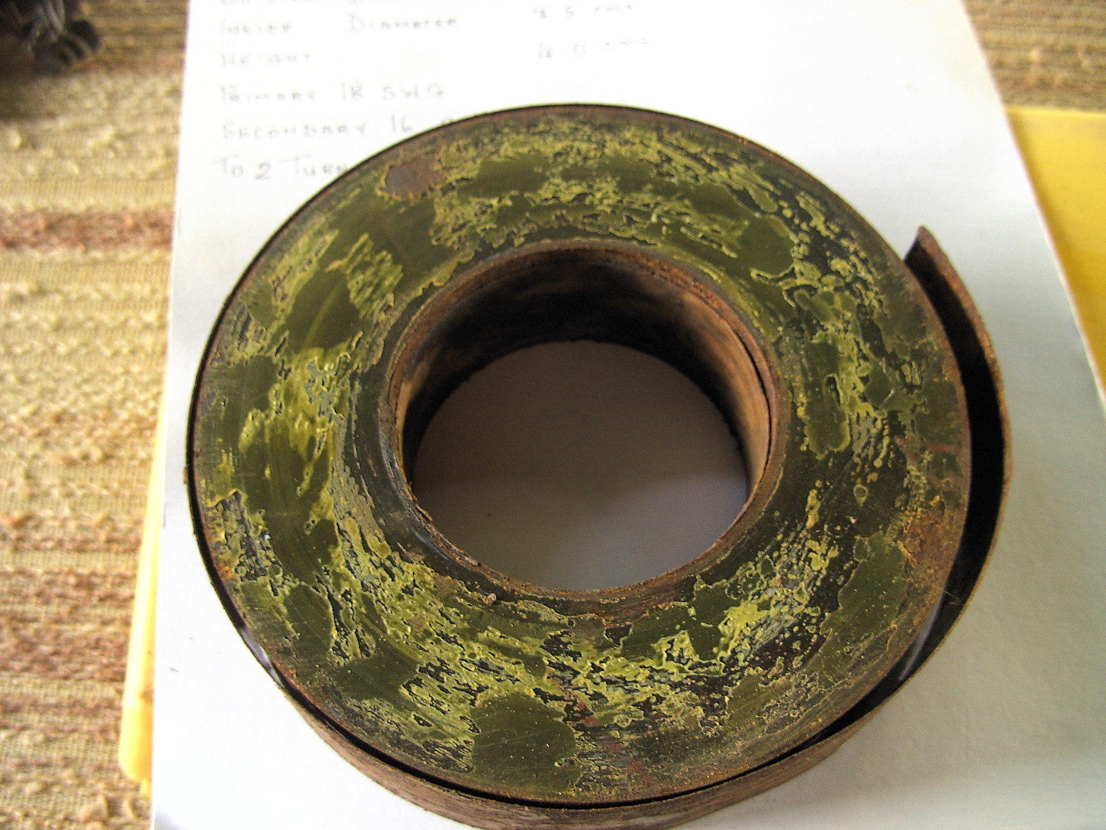

hi john
greetings sorry for not replying as i was out yesterday...this is my core and winding details...just want to know roughly power of toroidal as i have no idea what it's power is because a transformer 50 0 50 AC had burnt out and came for repairs we just counted the turns and SWG of wire and this is what data i used to wind my toroidal transformer by hand..need your help
Warm Regards
Andrew Lebon

I will try to answer ...
For primary no 18 SWG (see attachment, on table's right side, to get diameter in mm [* 25.4])
diameter is 0.0480 inch = 1.2192 mm (please measure your wire's diameter for sure)
wire area = 3.14 / 4 * (diameter)²
----------= 0.785 * (1.2192 * 1.2192)
----------= 1.167 mm²
max amps for S = 2.82A/mm² ---> 1.167 * 2.82 = 3.29A
max amps for S = 5A/mm² ------> 1.167 * 5 = 5.83A
so V/A ratting for 220 volt input = 724VA & 1287VA
there are 2 V/A ratting
724 is safe rating, if we draw 724VA, the trafo will be quiet cool
1287 is max rating, we can draw 1287 but the trafo will be hot
for secondary no 16 SWG
diameter is 0.0640 inch = 1.6256 mm
wire area = 2.074 mm²
max amps for S = 2.82A/mm² ---> 2.074 * 2.82 = 5.84A
max amps for S = 5A/mm² -------> 2.074 * 5 = 10.37A
V/A ratting for 100volt(50-0-50) output = 584VA & 1037VA max
I guess its good to keep VA rating of secondary less than primary, but please correct if I wrong.
I'm not trafo expert
Okay, now we enter the data to my formula...
but I don't know your mains voltage
your core area A = (16.5 - 7.5) * 4 = 36cm²
for 220volt 50Hz & toroid core
N = 28.125 * U / A
= 28.125 * 220 / 36
= 172 turns
for 220volt 60Hz
N = 23.4375 * U /A
= 23.4375 * 220 / 36
= 143 turns
Now we can see there is so big difference...
my formula say 172/220 = 0.78 turn per volt
but your data is 2 turns per volt
Where do this data come from? Is this core was a working trafo but somehow it melt down?
This really make me confuse, anybody help?
note: my toroid that I built based on "Automatic AC Voltage Regulator (Stavolt)" with same core size.
I open & calculate turn per volt of that stavolt to make my own toroidal trafo, then I calculate with my formula and the results are similar.
I also have one 2000VA(mark on the box) toroidal auto-transformer, not check data inside yet.
Now I'm also need any help, any reference will be welcome
Regards

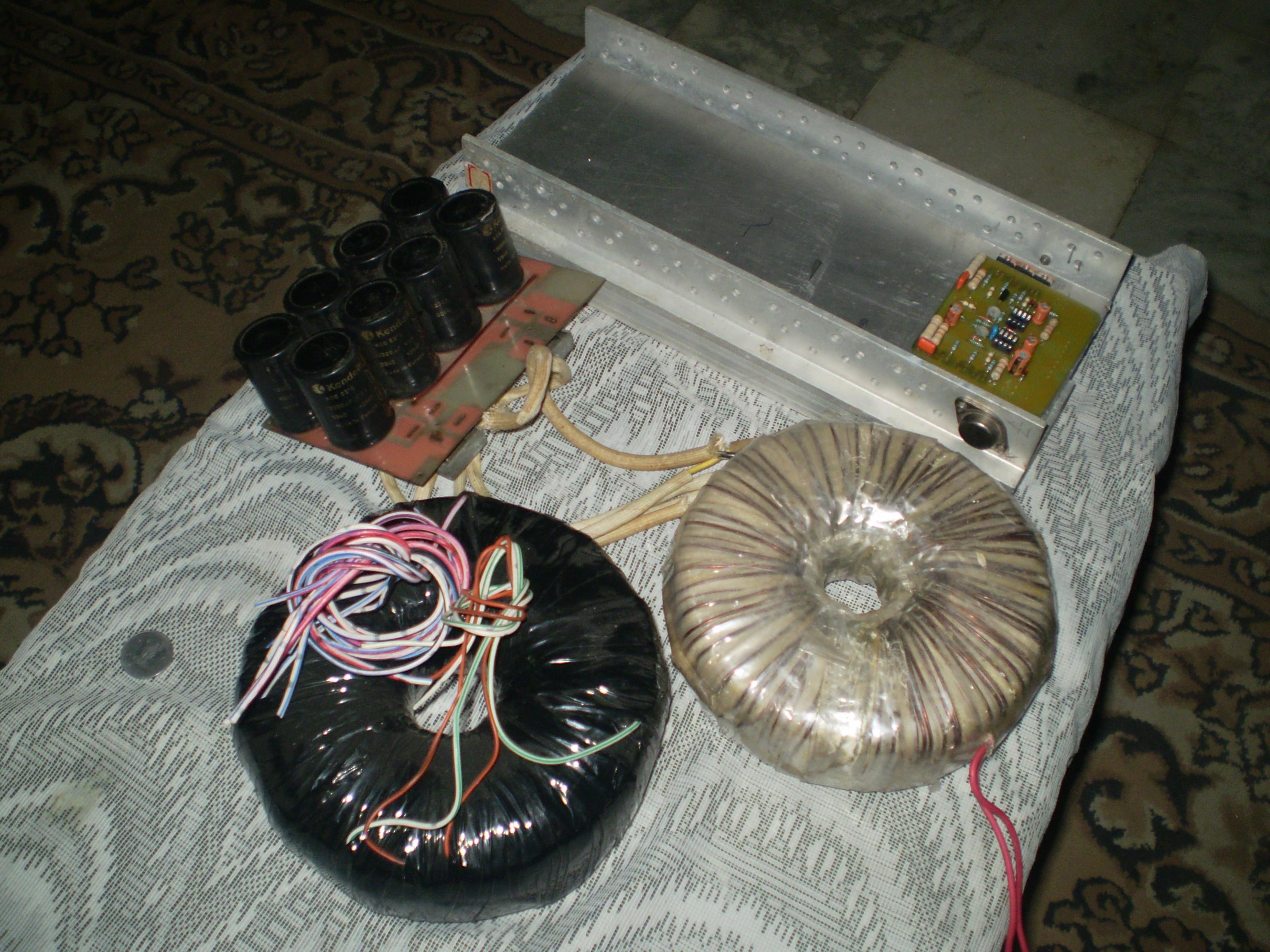

torridal
Hi John
greetings well some ugly hand wound ones torridals have worked good
1 ac input voltage 220 volts
2 freqency 50 hz
the black one is 50 0 50 into 2
white one 40 0 40 into 2 i use it for H900 AMP working for a year no problem
and does not heat confirming ITS 2 TURNS PER VOLT
warm regards
andrew lebon

i would tend to agree with andrewlebon's data as it came from an actual traffo...yours came from the formula....
what you could have done is count the actual tuns from the old windings......
you have different kinds of materials in your cores that is why the difference...
and this is what i am trying to hammer on.....when you are unsure about your core, operate it at lower tesla, < 1T.
Hi John
Hi andrewlebon,
the important is that your trafo worked good,
my toroid even not finish yet
not isolated yet

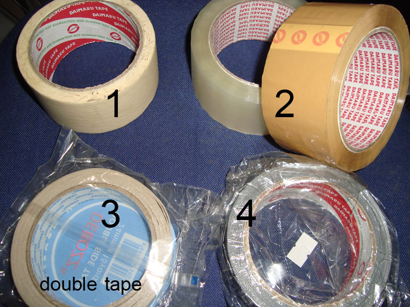

Already collect enough core & enameled wire but
I have a little problem with the insulation material,
I mean the insulator between layer
please someone give me reference...
I also thinking maybe usual A4 paper 70gsm can be used
my idea is paint it with special varnish so the usual paper can be used
I don't know what the name of "right" paper that usually used for making trafo
Here what I have, which one could be the best choice?
This some pictures of "isolasi" that what its name here
If this easy available thing painted with special varnish I guess it can be used
Any suggestion will be welcome...
because it will be 300VA or more, so if possible I don't want to any false
