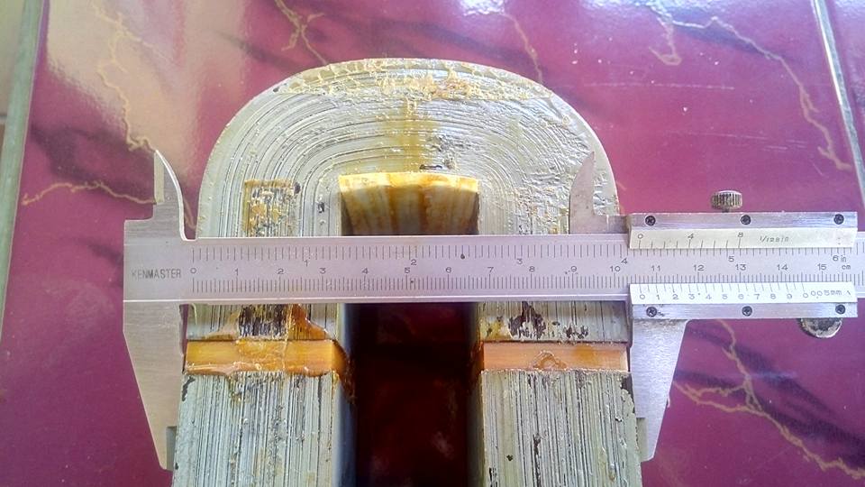

use whatever is available to you as long as it is thick enough for the job...
as you deviate from the square core cross-section and the more rectangular it becomes, then the mean length per turn becomes longer and with it the resistance of the winding goes up, but this is mitigated somewhat by the fewer turns required with bigger cross-section magnet wire....
use of insulation varnish after the built up traffo is good, the varnish not only insulates the windings but also goes in between the laminates and this reduces eddy currents as well....what i do is to dip the built up traffo into a bath of varnish lifting it up when bubbles dissapear, this is done at least three times.....

you can pretest yout finsihed traffo right after completing it to see that all voltages are ok.....and then you can dip the whole thing in varnish....
it is better to wait 3 days if using air drying varnish....

Hello sir.
As i read or saw the formula of core area=square root of output transformer/5.58 and second formula of core area of transformer=1.152*square root of output power of transformer
Cm.
What is right formula
Cm.
depends on what you are trying to build, the quality of the core and the working voltages..

Sir.i want to make tranfr.230v input.and 65_0_65v ac at 10A using crgo,E I core
What will core area and TPV ,thanking you,
