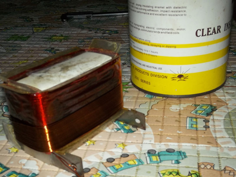

I think this is not good
This will be 300VA trafo that I'm going to make or maybe not.
I'm just not so confidence is this okay or not
I thing ask some suggestion here is a good way
I just use what I see around he..he... :D,
latter
I found better "things" to use as
inter layer windings insulation
also found good trafo as a reference
here 2 pictures
what do you think, give it a try or
I must start again with better way?
Any comment greatly appreciated

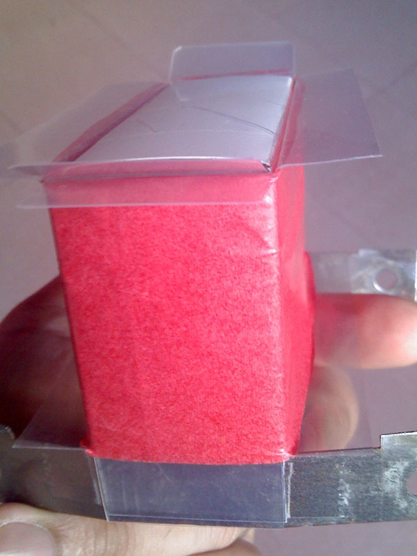

Thanks for quick reply from Tony & Metal
Very good suggestion & advice
Now I change my mind :D
I'm planning to make bigger trafo (about 600VA) but after look at
http://www.diyaudio.com/forums/power-supplies/191730-my-latest-traffo-build-28.html
then more question appear in my head :confused:
I will make bobbin for this one but the form is rectangle not square as Tony suggest.
Please tell me what the disadvantages with rectangle shape?
I want trafo that not so high that can be fit in the shorter case
Rectangle because I will use :
1 1/4 inch (32mm) center tongue stacked 6.5 inch (16.5mm)
The thickness of the laminated plate is 0.5mm & I will go bellow 1T
The bobbin I will made with "fiber" PCB
Every 1 stack complete winding, brushed with clear insulating enamel
then I have a choice to use paper or plastic for insulating.
The paper is "brown wrapping paper" &
the plastic is that what use as "laminating paper" it is can stand up to 150°C
& I guess its good to be used
but allmost Tony's trafo use paper insulator...
Again please tell me what to use here?
For finishing I'm not dip it into the insulating enamel because the winding is already insulated before & for the laminated plate just do with brush
So I'm on the right track or I must find bigger core size?
