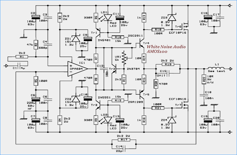

Re: Re: JojoD818
AMOS100
is using an OPA604 op-amp for input and gain control
and
two very high quality Lateral MOSFET for output.
As the output has got voltage gain of 4-5 ( common Drain Push-Pull )
the output voltage can be higher than OP-Amp can produce.
See my attachment schematic of
White Noise Audio
AMOS100
lineup
lineup said:
White Noise Audio -- http://www.wnaudio.com/
also has got a little forum at
http://www.audiocircle.com/
White Noise Audio - board
http://www.audiocircle.com/circles/index.php?board=36.0
but not much used right now, it looks
AMOS100
and
White Noise Audio
AMOS100
lineup
lineup,
Wasn't it mentioned somewhere that Lateral mosfets cannot be substituted with hex? But RSK was able to build it with hexfets so no problem there. Do you mean opamp has not enough voltage swing?
JojoD818 said:lineup,
In some amp circuits IRF HEXFET can be used instead of Lateral
without any danger.
This is has been explained in detail in previous postings in this topic.
By me as well as other posters.
Also is many other threads at this forum with such warnings to use HEXFET in some circuits.
If we focus on AMOS100.
Schematic in my last post here above.
This circuit uses Tr2, a VBE-multiplier, to control the idle current in driver stage.
Tr2 should be place onto heatsink to sense the temperature.
When heatsink gets too HOT, then Tr2 will reduce the current in Tr4 + Tr5.
But this case control is NOT directly to the output MOSFET.
It only controls current level in Tr4 + Tr5 = the drivers.
But the drivers current will effect MOSFET, by changing voltage across R13 and R16.
I would say this AMOS100 is a borderline case.
It might work with HEXFET,
but best is of course to use same Lateral MOSFET as in circuit.
Because this is what it was designed for!
I would, to avoid problems, build AMOS100 exactly as is intended.
And careful read and follow instructions in the good documentation PDF.
Generally Op-amps have a recommended max supply around +-15 to 18 Volt,
so this means that most op-amps will not be able to produce
an AC output voltage more than like +-15 Volt peak.
In AMOS100, OPA604 is supplied with +-15 volt, set by ZENERS ZD1 and ZD2.
So an output like 8-9 Volt RMS would be maximum, from OP.
But because the 4 transistors at output has got a voltage gain of
like 4-5, set by (R19+R20)/R20,
the total max output voltage of AMOS100 will be well up to deliver 100 Watt RMS.
** 8V RMS into 8 Ohm would give 8 Watt.
Advice:
You may try to use AMOS100 circuit using HEXFET like IRF240, IRF9240,
and there is a chance they may work.
Most probably for best result, even if they work, you would have to modify output stage a bit.
To fit HEXFET better.
But my advice would be to try and find
An Amplifier Circuit, that was originally designed for HEXFET use
and even best if using IRF240-IRF9240 or very similar transistors
as standard devices, from the beginning.
regards
lineup
