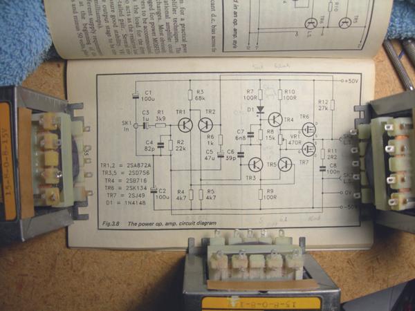

You can compare with an almost identical power amplifier,
using lateral mosfets, from a book edited in London 1991.
I wouldnt be surprised if what you want to build
is a variation constructed from this 1991 MOS amp.
See attached schematic.
Two details that differ.
The C7 - R8 filter. Some sort of compensation for better performance.
The LACK of emitter resistors in output stage.
Enjoy an old amplifier from a designer that has written several books
with all sorts of transistor audio amplifiers as well as most every kind of audio circuits.
Regards
lineup
"Can I use the 240/9240 devices on the schematics that were posted? Simple drop-in?"
I didn't see a schematic that had temperature compensation for the bias. I am not normally a betting man, but I would wager that you will have problems unless you take care of the bias.
Nelson Pass makes it work by running it in class A with the necessary large heatsinks, and even his amps like the A75 have a bias transistor.

Of course you can use IRF240 / 9240 HEX MOSFET in a power amplifier.
They are good transistors, used in the correct way.
But they have a different temperature caracteristic than 2SK1058 or other LATERAL MOSFET
There are many topics, if you search for lateral in this forum!
The solution how to properly use HEXFET and BIPOLAR compared to LATERAL MOS
is to use a good temperature sensor transistor at the heatsink.
Also called VBE-Multiplier.
In the simple mosfet schematic
http://users.swing.be/edwinpaij/images/amplisimpleV2.gif
a plain trim potentiometer resistor P2 may not be able
to control the output 240/9240 HEXFET.
There is a risk for thermal runaway.
This is like when a train out of of control goes downhill
- it will only go faster and faster ... until .... .... .. smoke and fire
Nelson Pass helped to advice in topic started by luixssj3.
You can see howto do this temp control, in the schematic
showing a part of a Nelson Pass amplifier ( A75 )
in this post by me:
http://www.diyaudio.com/forums/showthread.php?postid=1011461#post1011461
