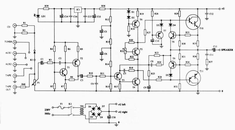

Here is The Ion Obelisk! It is a Class AB 30W amp with astonishing musical sound. The designer was Richard M. Hay ( also designer of some Radfords! ) The Ion is the basic of the legendary Nytech amps.
It is easy and cheap to build and living with it too. (small and little heat).
The amp build with turn on thump blocker and overcurrent protection.
I didn’t say that it is the best amp, but it can easily outperform many comercial amps.
I will continue with part list, more detail and some more photo.
The schematic is a version of the Ion Obelisk.
Greetings for every Diyer!

Nothing like a NAD 3020, remotely.
The Ion was an update of the Nytech, and has similarities
with other UK single rail designs, all of them not good IMO.
The basic Mission Cyrus circuit is far superior IMO.
🙂 sreten.

"Nothing like a NAD 3020, remotely."
Q601 and Q605 of the NAD comprise the voltage gain stages, other than being opposite polarity they are hooked up the same.
The Ion uses an active current source for the VAS, the NAD a bootstrap. Big deal.
Actually , AKSA claims it is a big deal, and that the bootstrap sounds better.
They both use complementary darlington connected output driver pairs. NAD uses discrete transistors.
The Ion has an output cap.
The Ion has foldback current limiting that will make nasty 'farting' sounds if activated driving low impedance loads.

the schematic you posted differs sigificantly from orginal service schematic drawing I have for the ION SYSTEMS OBELISK 1 from 1990 by R.Hay
Line Input stage: no
Input switch: fully different
Disc stage: missing
Amp: differences
psu: fully different
Please check your sources / or your drawings

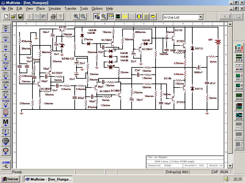

Sorry, but i made some modifications in your PZOLTAN HUNGARY
regards,
Carlos
Tyimo, it is working reasonable on simulation
Power was a little more than 100 watts RMS at 4 ohms
- 3 dB points are 10 HZ and 40KHZ
Sinusoidal perfect till 60 Khz, square wave good from 50 Hz to 18Khz
Sensitivity is around 70 milivolts in input to 105 watts output on 4 ohms... an resistor divider in input allow you use 775 milivolts.
Maximum current is 2.3 Amperes DC
Voltage used was 68 Volts, voltage on amplifier center, the output before condenser is 34.5 volts DC.
Bias adjusted in 100 mA.... all transistor VBE voltage good.
Non oscilation, a little modified Eva Method, because could not use 1 uF, audio was cutted in simulator.
Efficiency around 60 percent.... consumption near 160 Watts
Very good square wave on low frequencies around 20 Hertz... difficult to find in new designs.... on simulator Multisim.
Reallity may be different, but will work!
regards,
Carlos

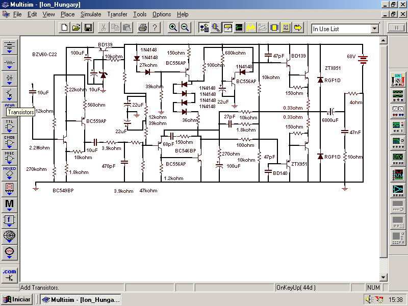

Oh, ZTX851 & ZTX 951, pretty cool devices with superb specs. It's a pity they were not intended to handle the dissipation levels required for linear audio applications... :hot: [they are mostly useful in SMPS]
