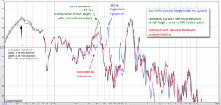

Bad news is: the absorbing resonator interacts with the port and creates a new (lower frequency, unfortunately) resonance. This phenomenon seems to get stronger for shorter ports.
here is the response graph indicating how the helmholtz resonator (absorber) at half the port length and tuned to the port longitudinal resonance interacts with the port:
the absorber indeed absorbs the longitudial resonance of ~560 Hz BUT:
a new stronger and even lower resonance is created, apparently combining longitudinal resonance with helmholtz absorber.
it's now at 410 Hz which is worse, because near to the useful output of the port. in addition the useful port output is slightly reduced (about -1 dB)
this resonance can be dampened with fibrous material in the small helmholtz absorber at the expense of another reduction of useful output (about -2 dB).
so in short:
it makes much more sense to use a less resonating port shape (see post #52, #53, avoid straight tubes without big rounded flanges!) instead of installing small resonators to absorb port resonance.
it may be sensible with very long ports, though (see the first posts in this thread).
