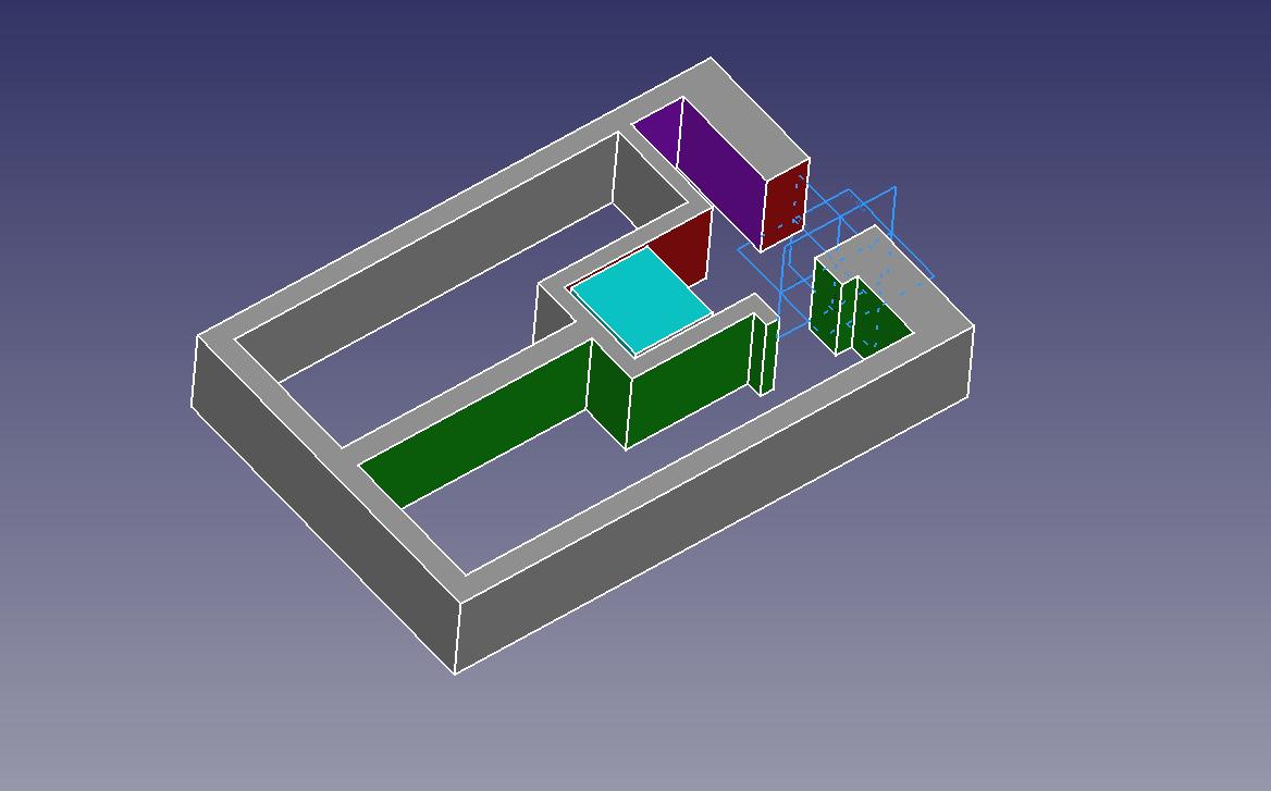

I've had this in the idea pile for some time. It's for a small 2way BR that I'm currently working on, and its similar in concept to what @b_force posted earlier. There are a lot of resonances that can occur when you stick a pipe in a box. Trying to damp them away usually kills the BR response.

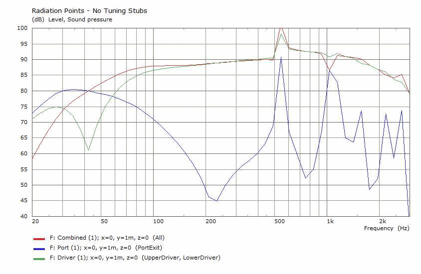

The idea (see attached pic) : the main port (red) is sized to tune the box to the desired freq (used Hornresp). The main port connection to the woofer chamber is via a hole at the top (light blue). Then a short closed stub is added (purple) to reduce port pipe resonance, then an "open" stub (green) with a damped chamber (green) is added to reduce other woofer chamber resonances. This stub tuning arrangement (acoustic filter?) could be built as an internal layer, or plumbed in pipes (maybe, distances are critical), The original port tuning notch does not move, indicating the additional stubs did not change the alignment.

This is basically just a helmholtz resonantor. Dampening that chamber will really help btw.
Although I find it a little hard to see what's going on.
Also construction wise it's very tricky to do.

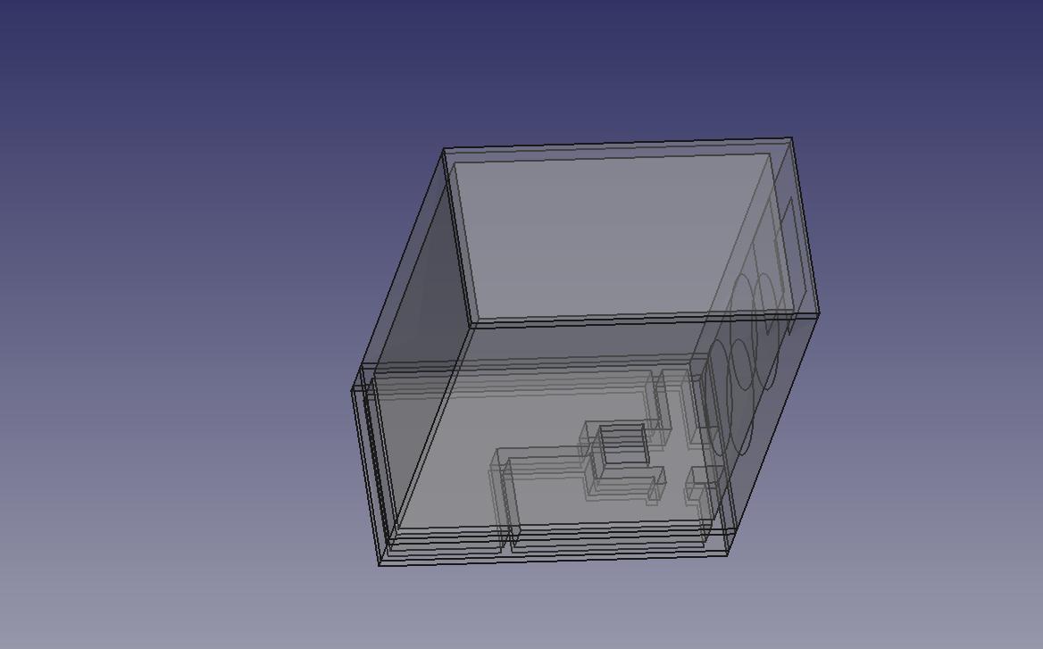

^^ The front baffle (port exit) is 25mm thick, the walls are 12.7mm thick. No CNC, just pieces of 12.7mm thick plywood (50mm high) glued into the pattern shown in the slice layer. I've removed the top and bottom panels of the slice to make it easy to see in. My cabinet cross section has this exterior outline.

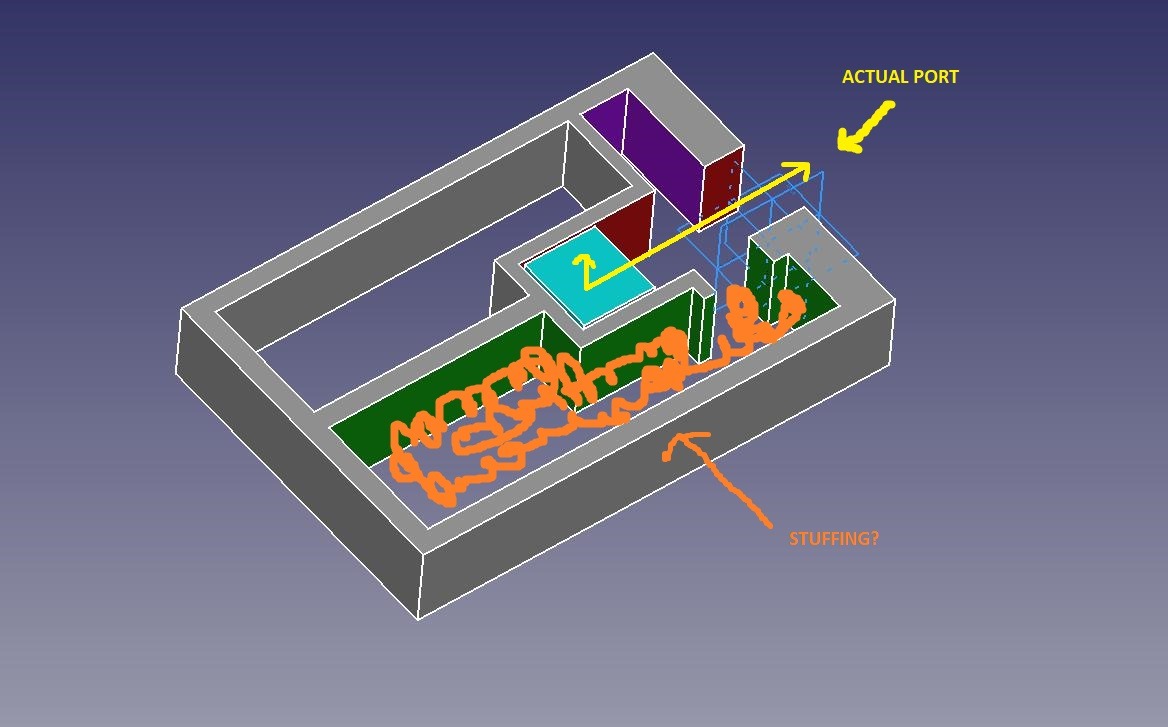

Have I labeled this correctly? If so, it appears the taps, at least the purple one, are not at the center of the port? What resonances did each of the taps work to lessen? When you say the green is for the woofer box, you mean this dampens the typical standing waves in the box? Not so much about resonances of the port itself?

@augerpro That's the correct interpretation of the drawing. My originally attempts, had stubs at the reflex port length center, then I found I could move the placement, length and the cross section and get similar results. So I made it easier to build. The major improvement is in "other" resonances, but I needed both stubs to prevent just moving the noise. The actual port resonance should be spikes at (c/2L) at even harmonics but there seems to be more noise than that. I suspect there is a more complicated system interaction. The stubs and chamber were trial-error attempts in LEM (easiest) and I'll repeat in BEM to verify and then again in the prototype. I was trying to minimize the total port "noise" . I thought it was an interesting result,

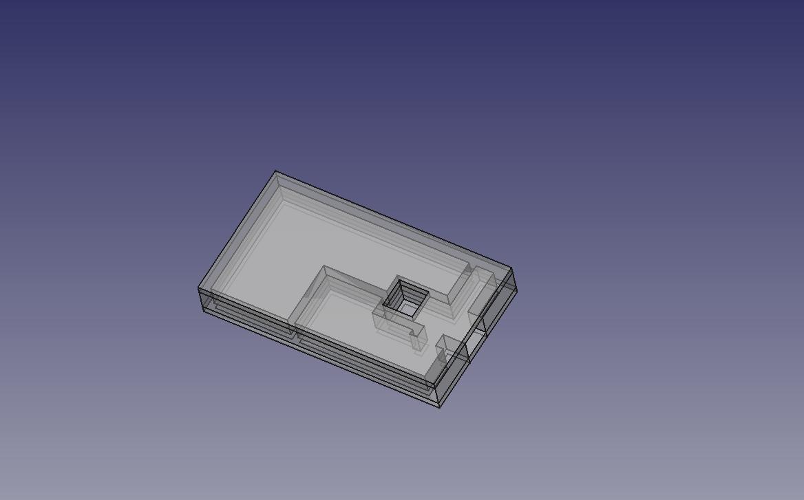

I've tried to increase the transparency of the drawing to better show the intended assembly. The bottom cover would be removable to make adjustments if required.
