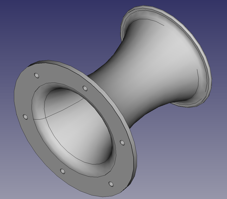

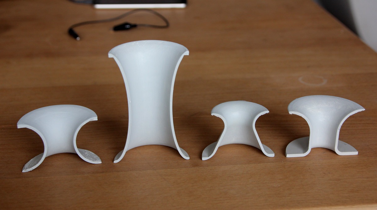

FreeCAD NFR=0,5 port example including STL and STEP​
In the meantime here are my models for a NFR=0,5 port.
The freecad model is parametric and can be adjusted as required.
Please note that mounting holes are not (yet) connected to the port exterior diameter/radius, so the respective circle radius in the sketch eventually needs to be adjusted, in case of port diameter adjustment.
The step and stl models (and the as-is-freecad model) have the following parameters:
actual length= 120 mm
effective exterior diameter = 80 mm (defined as radius = 40 mm)
flange width = 25 mm
thus, total exterior flange diameter = (40+25)*2 = 130 mm
flange thickness = 4 mm
port wall thickness = 3 mm
one important hint: the interior port surface should be as smooth as possible (mainly in the central are).
so if the port is to narrow to be smoothed by hand you might eventually want to print two halves for better access to the interior surfaces.
I'll post some pictures of my workflow.
Have fun!

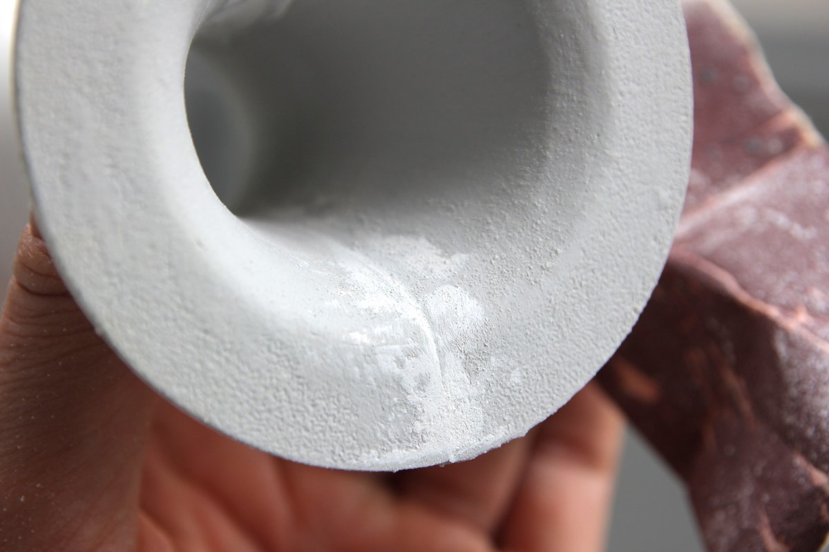

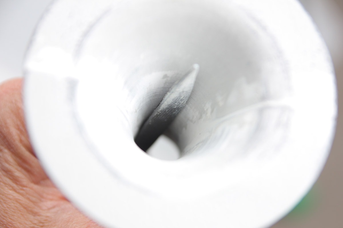

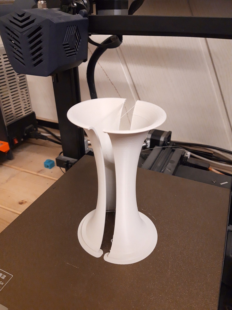

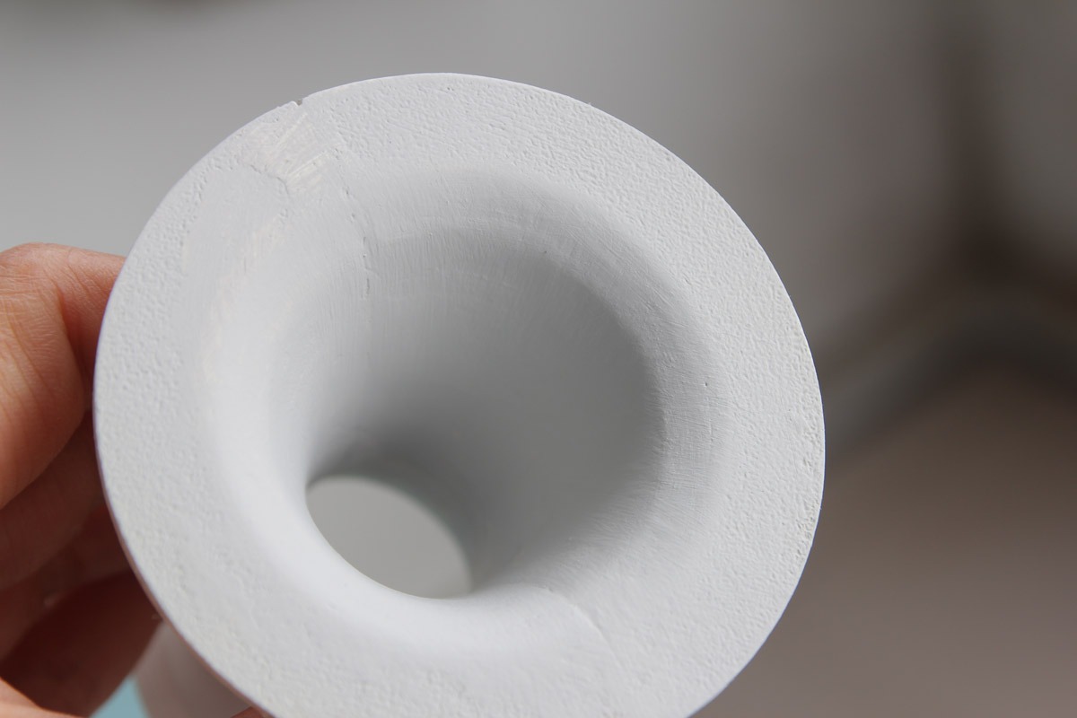

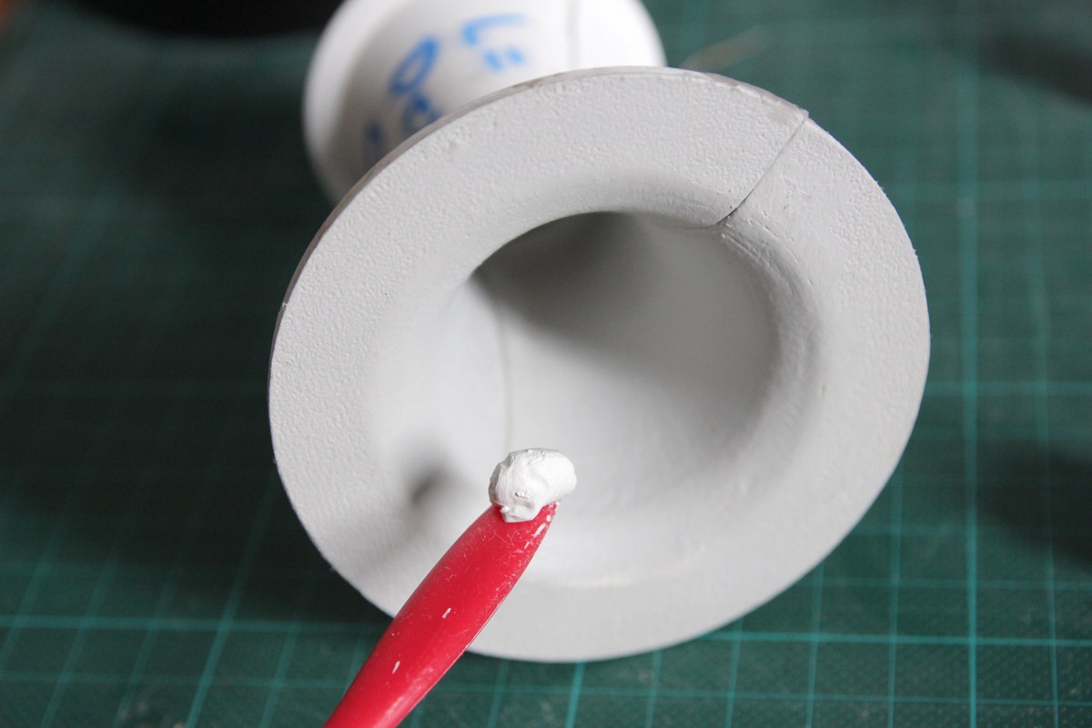

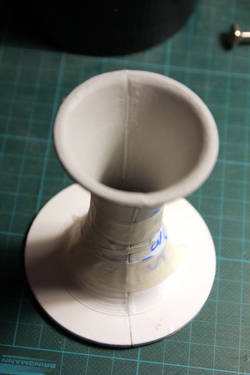

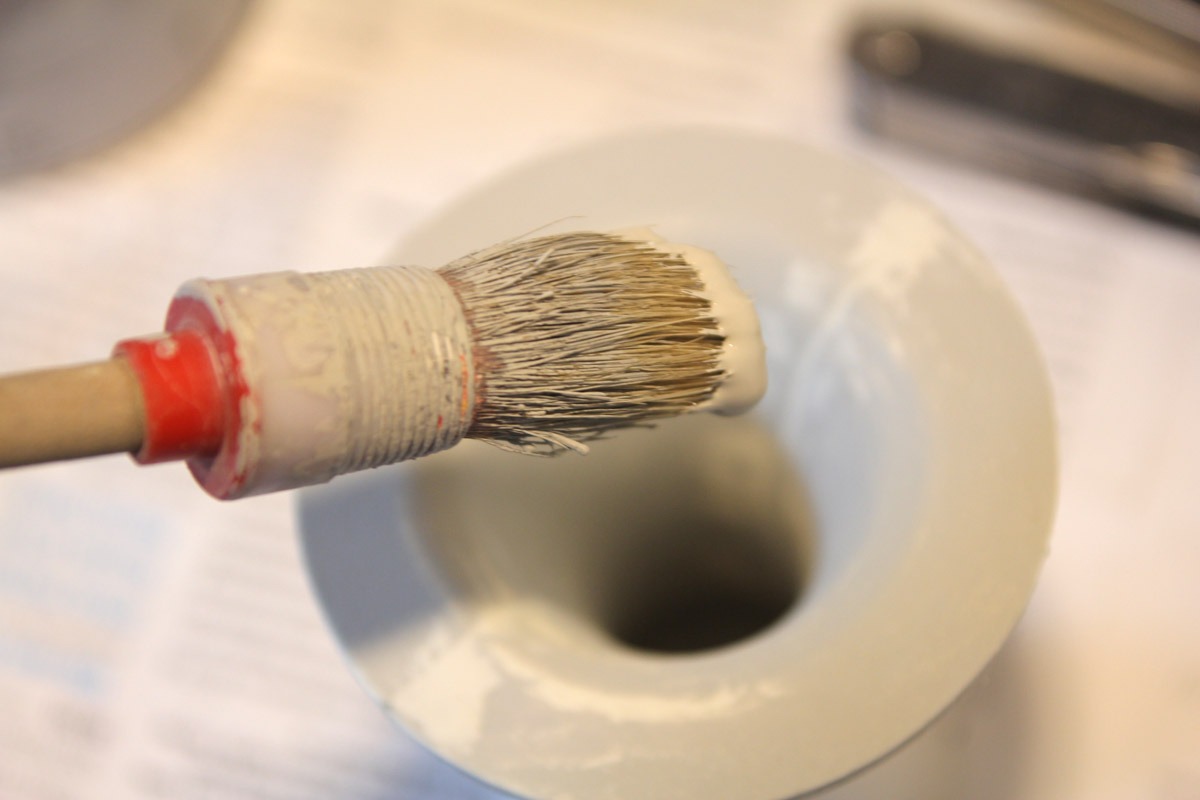

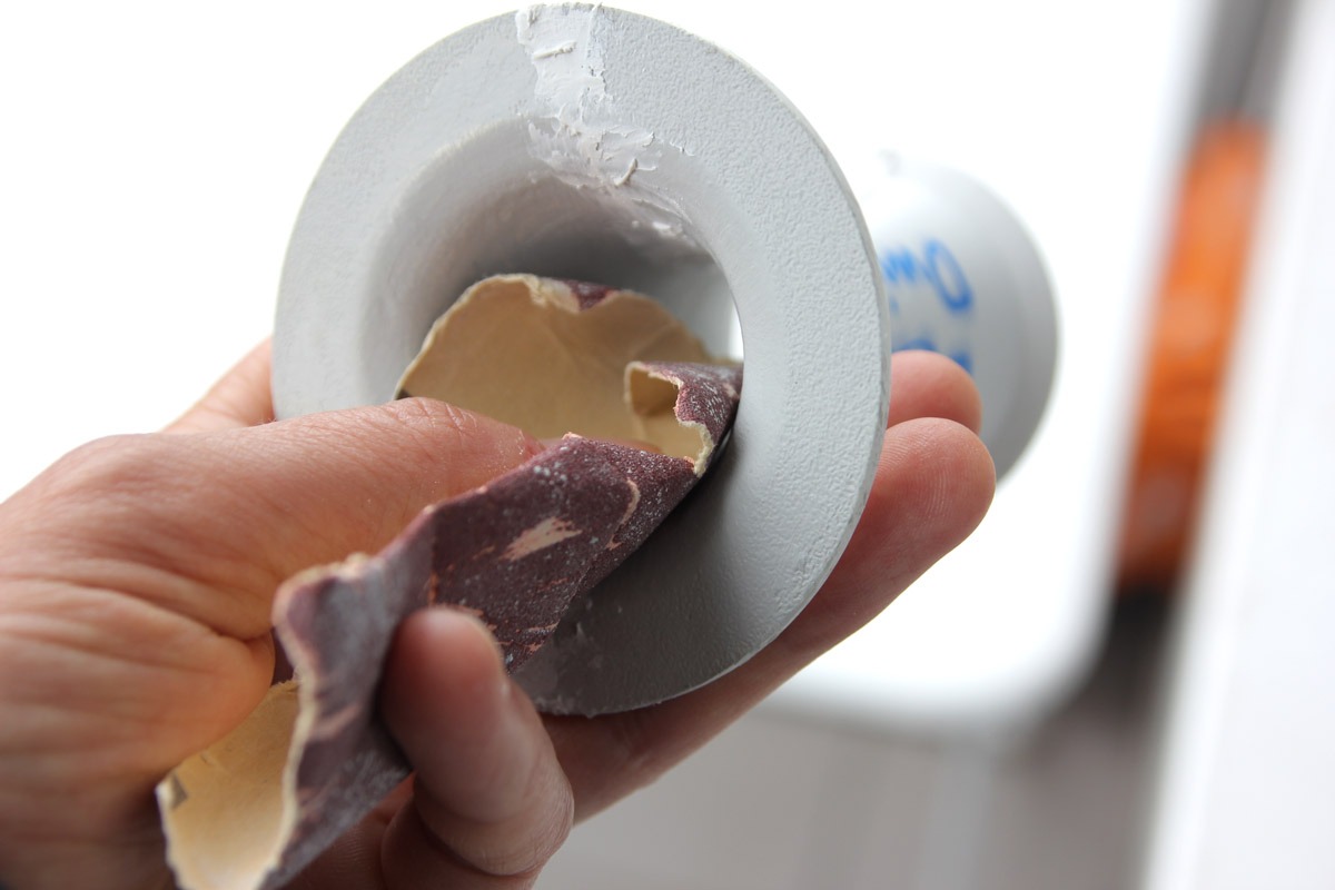

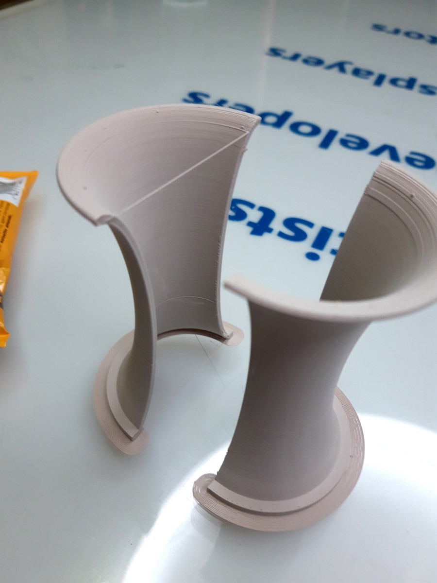

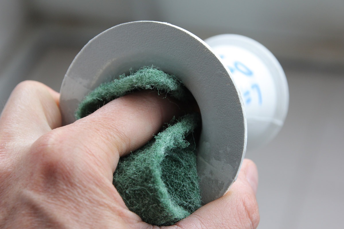

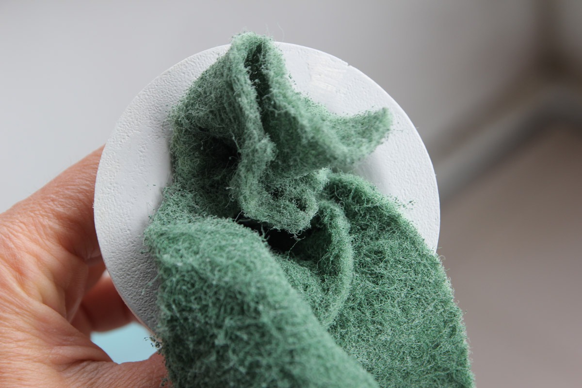

how I make my 3d printed ports​
this is how I make my ports used for testing and hopefully finally also for my loudspeaker projects!
there are probably several different ways, but I found my method works well to get a smooth interior surface.
this is essential, mainly for the central high airspeed section.
see my tests in post #230!
still no mounting holes, because the ports are temporarily mounted with play dough.

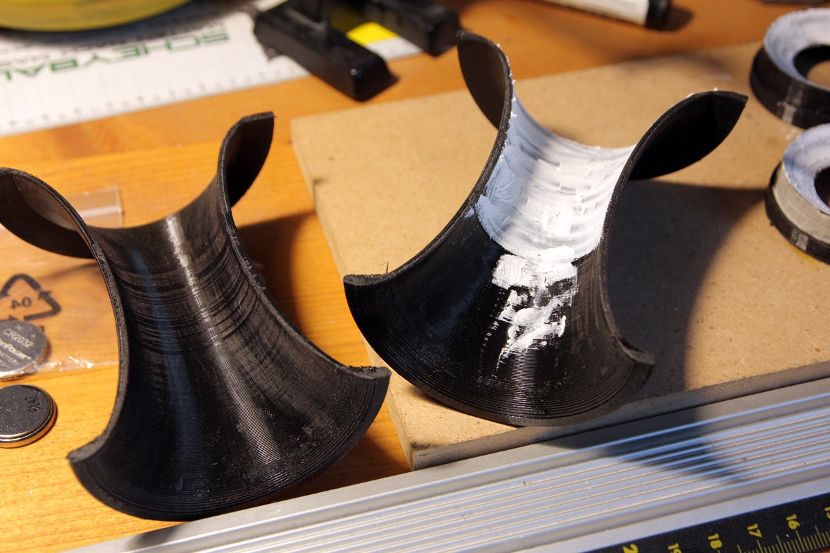

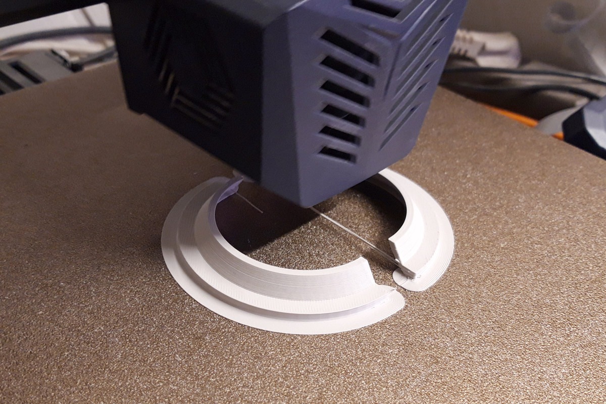

01: printing upright in two halves, flange at the bottom. I use "brim" surround for better adhesion to the printer bed. this is essential with long ports that may otherwise come loose because of the "lever" length.
02: print complete!

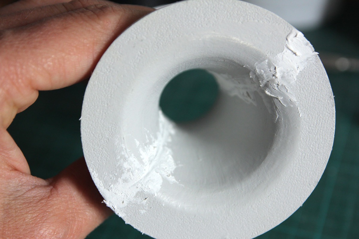

03: inaccuracies and printing layers (perpendicular to air flow) must be sanded, filled, sanded
04: applying wood putty after first rough sanding of 3d prints. I use 80 grit sandpaper.
for big ports it may be possible to print one complete piece and sand, fill and smoothen the interior surface. But it's still much easier to do that with two open surfaces.
use 120 grit (and finer) sandpaper to smoothen the filled parts, once the putty is dry.
05: smoothed port halves. I like to apply a coat of grey primer to better see any remainig grates or holes.
06: guing the halves. I use pva wood glue but epoxy or superglue are probably much stronger.
07: filling the joint gap (3d printers are not good at printing sharp edges)
08: filled gaps
09: sanding of joint. for my very small port I use small files.
10: sanded joint
11: using 320 grit pad to further smoothen surface
12: applying primer to fill small scratches. I use a matte primer that dries very fast and can easily be polished.
13: primed surface, some particles and brush strokes need to be smoothed out ...
14: smoothen surface again with 320 grit pad
15: smooth surface of finished port (still not optically perfect, but perfectly usable in acoustic terms).

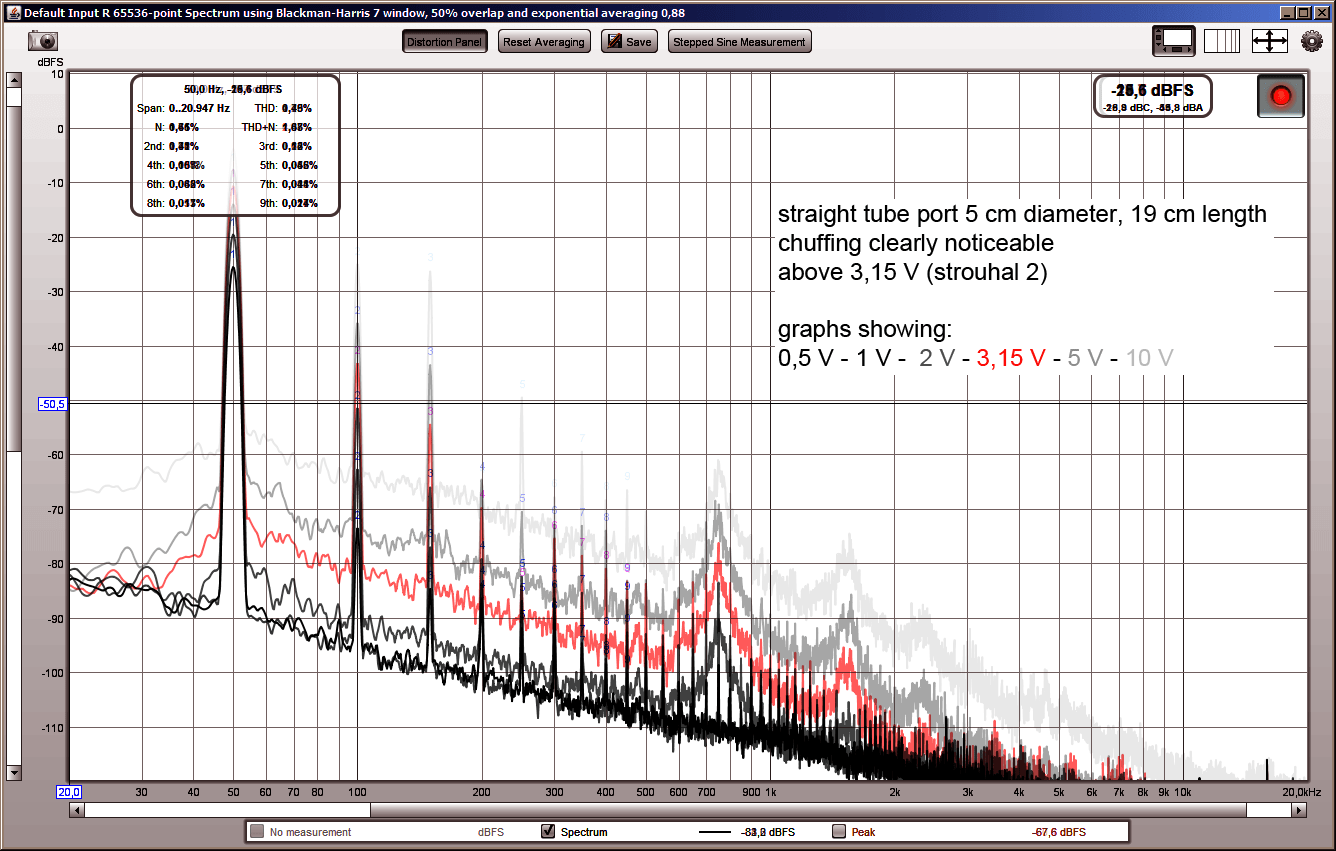

because the graphs above are mostly interpolated between the measurements at 0,5 - 1 - 2 - 4 - 8 V, I will provide a new measurement with smaller increments and additional subjective impressions.

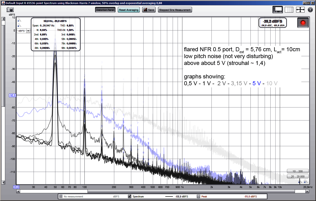

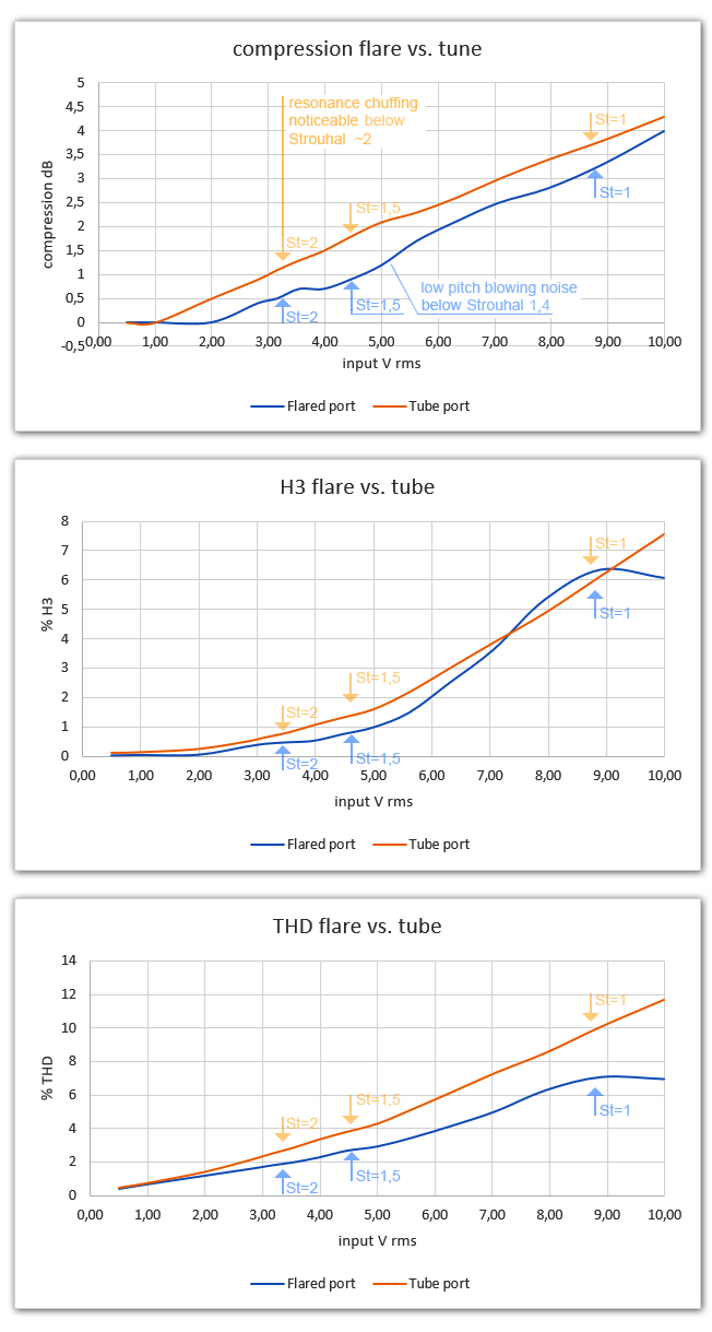

detailed measurement of straight and flared port​
I used the straight tube port with small roundovers (0.6 mm) and the "BIG port" described earlier with a NFR=0.5 and took measurements with small one dB steps for the relevant range.
It was quite easy to determine the point where the turbulent/chuffing noise was clearly audible, using the 50 Hz sine test tone.
It was also very interesting that the straight tube port tone is getting ugly quite early (strouhal number around 2), but this is only related to the sharp chuffing resonance noise peak, which I suppose is not strongly related to strouhal number.
I suspect that even for the flared port the low frequency noise is not very audible, because it is masked by the fundamental 50 Hz tone. The noise gets audible once there is a slight resonance hump, at strouhal number of about 1,4.
Once more I noticed that compression and THD/H3 distorsion are not audible per se. It's the chuffing noise that is annoying.
As I noticed earlier with very high outputs (strouhal number far below 1) the straight tube port has less turbulent low frequency noise.
But as I pointed out earlier, the chuffing/turbulence noises for these levels is far beyond everything that is bearable for serious music listening.
Here are the chuffing spectrum screen shots and the comparison graphs for compression, H3 and THD:
conclusion for these port examples:​
keep strouhal number above 2 for straight ports
keep strouhal number above 1.5 for flared ports with NFR=0.5
Reactions: 4 users

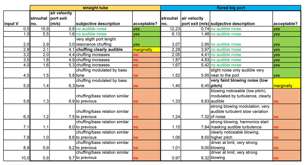

Do you any idea what the velocity levels would have been?
here is an overview of strouhal numbers, port exit air velocities and my subjective descriptions, referring to the test posted above.
the speaker has a sensitivity of roughly 84 dB @ 2,83 V / 1 m and was about 1 meter distant (except if mentioned in the description) positioned on a stand 1 m high (near 4 pi radiation).
the strouhal numbers and velocities are slightly different between the two ports because the straight tube port has an effective exterior radius of 2,77 cm and the flared port 2,88 cm. see plan in post 529.
furthermore the velocities/air particle displacements/strouhal numbers correspond to the real output. they reflect the real, compressed output (see post 565 for graphs!).
by the way: the air velocities in the central smallest part of the port is 123% of port exit velocity for the straight port and 369% for the flared port.
