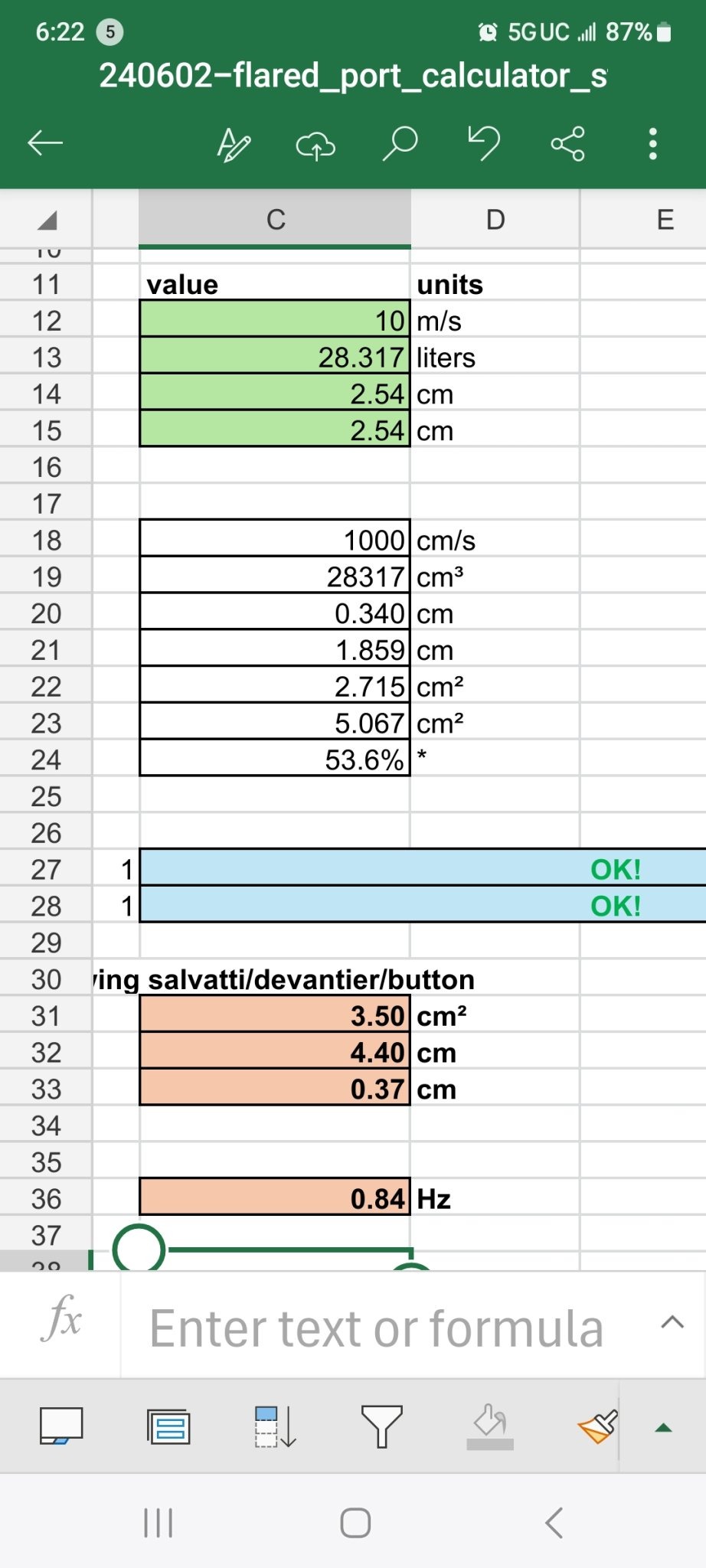

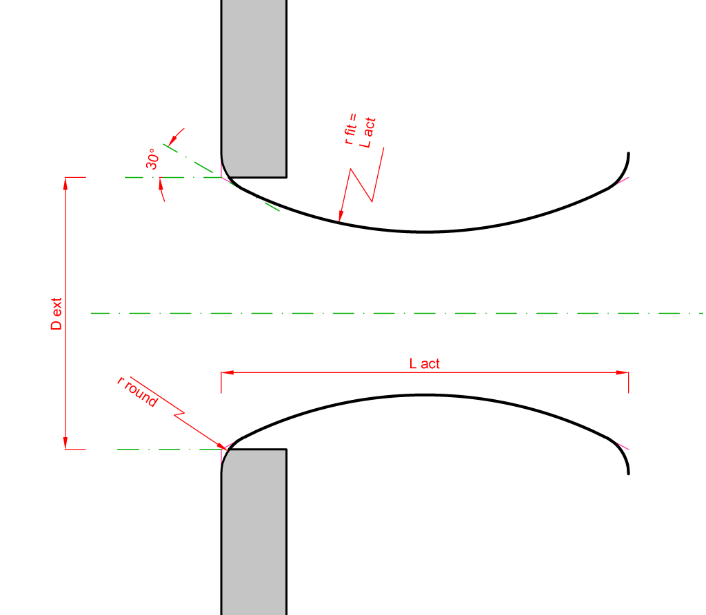

Simple Excel sheet for calculating a flared port with NFR=0,5
I used basic geometry and the formulas by salvatti/devantier/button and set up a simple excel sheet to calculate a flared port, providing- effective surface area
- effective length
- enclosure tuning frequency
- suggested flare roundover radius
- effective exterior diameter, which can be defined using my method explained in post #595, based on strouhal number
- actual port length
- speed of sound
- and (net) enclosure volume
there are two warning fields that will turn yellow
- if the port length and the effective exterior diameter combination leads to intersection of flares (thus sealing the port)
- if the ratio between central minimum surface and exterior port surface is smaller than 1/10. this is just a safety feature based on my tests, where narrowing the central cross section area to 10% of port mouth area worked flawlessly. It might even be possible to extend this ratio
NFR (normalized flare rate) is fixed to 0,5 for this first version, thus the flare radius is equal to the actual port length.
you can use your defined actual port length and the calculated effective surface area to feed a simulation tool of your choice with data for a equivalent tube port. the tuning of this simulation will be correct, but the air speeds / air particle displacement and the volume occupied by port will not.
The excel sheet is protected except user data fields just to avoid unintended changes, but there is no password protection, so feel free to unlock it!
If you find any bugs please let me know!

The excel sheet also includes a sketch indicating the geometry.
- speed of sound
both warnings ask you to increase the effective exterior diameter or decrease the actual length.
0.84hz tune in a 1ft3 enclosure with a 1" diameter x 1" length port?
yes, with a speed of sound of 10 m/s, as you defined.0.84hz tune in a 1ft3 enclosure with a 1" diameter x 1" length port?
you might just leave it at 340 m/s or change it according to your meteorological situation (but that won't change it to 10 m/s).
"In Earth's atmosphere, the speed of sound varies greatly from about 295 m/s (1,060 km/h; 660 mph) at high altitudes to about 355 m/s (1,280 km/h; 790 mph) at high temperatures."
https://en.wikipedia.org/wiki/Speed_of_sound

Would you mind checking the tool with some of your test ports?
I quickly realized one issue (or feature?) in my tool: it is a bit "dangerous" to calculate the most important parameter (the minimum diameter) based on the unprecise ("soft") effective exterior diameter parameter.
I should probably add a remark that for verifying an existing flared port it's essential to get the center diameter right, even if the exterior diameter differs slightly.
But I guess it is OK for defining the geometry for a port still to be built.

exactly! That's how the salvatti et al. formula works (post #600).
My excel sheet first calculates the minimum diamater geometrically, using the length and the exterior diameter, for convenience.
It follows the formula by salvatti/devantier/button and it's incredibly simple: you just add the minimum diameter to the actual port length. see post #600 with the relevant paper excerpt.how are you handling end correction in the spreadsheet?
That's again very simple: just use the the actual length input data and you have no end correction values added.I would prefer a user input, or, for less complexity, use no end correction and leave it to the user according their build methods.

I already did that, but here is a more refined and extended comparison table:Also, you might verify the predicted Fb is correct by printing a variety of ports and measuring impedance.
BIG port 10 cm length 5,76 cm effective exterior diam. (3 cm minimum diameter) | MEDIUM port 9,4 cm length 5,55 cm effective ext. diam. (3 cm minimum diameter) | reused failed "progressive geometry" port from my bandpass test speaker 7,26 cm length 4 cm eff. ext. diam. (2 cm minimum diameter) | |
measured tuning frequency (impedance phase = 0° between bass reflex peaks) | 48,9 Hz | 49,8 Hz | 39,0 Hz |
tuning frequency as calculated with excel tool | 48,86 Hz (-0,08%) | 49,32 Hz (-0,96%) | 38,62 Hz (-0,97%) |
tuning frequency using effective port surface area and the actual port length and simulating in hornresp | 50,4 Hz (+3,07%) | 50,9 Hz (+2,21%) | 39,8 Hz (+2,05%) |

I've had a heck of a time predicting the length for my ports (which are Roozen-type and NFR=.5 also).
so did I - the third port in the above table was such a failed part for my other test speaker.
I think it is mostly tied to aspect ratio of the port minimum diameter and length, but it is not a straight line relationship, but a curve.
