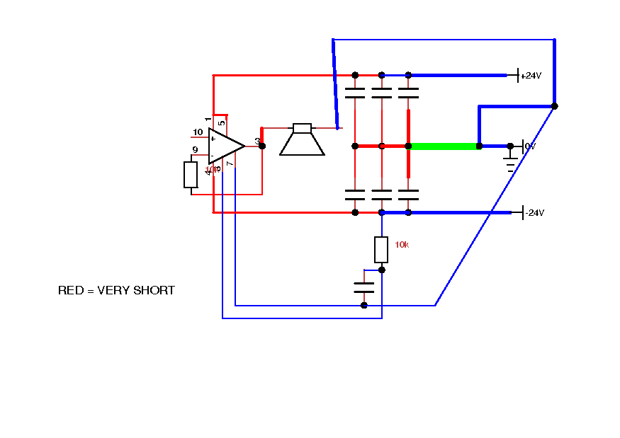

A ground plane with 6 caps, 1 speaker return and 1 supply return will have 9 charging currents and 7 speaker currents. Add to that ground loops and ground connections, it all becomes very uncontrollable.

A classic class B output stage switching distortion (and harmonics)...The same current will flow through be it ground wire or ground plane, it's loop they have to travel we are interested in. Do you see a little cap that is connected between amp PSU pins in psb that I proposed previously...do you understand its role?

The problem with using planes is getting the speaker return and the charging currents correct. Try drawing the currents.
From the TI DS, "common ground point through separate paths", really does exclude a ground plane.

Hi all,
My juvenile approach to star grounding 🙂.
Best regards.
