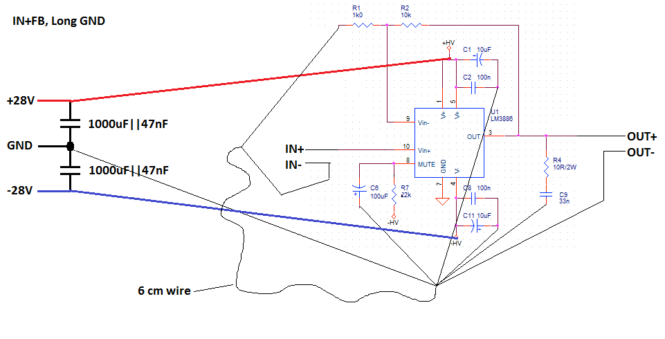

This is just a demo to show what I mean, it still needs some tweaking and I would run some sims before making this.
I cheated a bit by using 2 PSU and I still need to work out the 0V connections between the two PSU.
The Speaker is connected to the trace at pin 3 and the return is connected to 0V star.

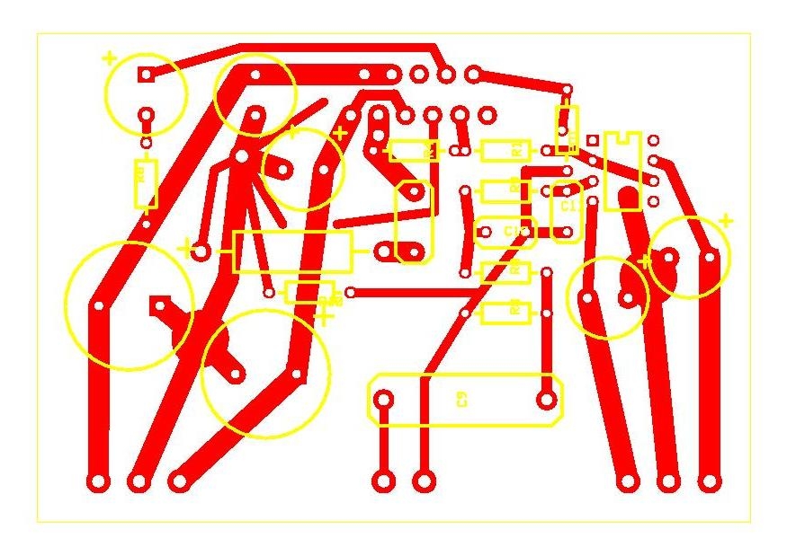

Mark, you are missing HF decoupling capacitors for the LM3886 and opamp. Also, a star at star-ground term (and real pcb), means a POINT rather than surface from which the lines on the pcb emanating from. The lines that goes to decoupling capacitor pins should be so thick that the AC current going TO the pins, not around them.
HF decoupling caps are on the underside of the PCB and can be rail to rail and/or rail to 0V.
Most designs only place the HF decoupling caps close to the supply pins and then place the speaker return on the other end of the PCB. The HF current must return to the HF caps to be effective.
This design study is implementing TI data sheet guidelines, as I see them and tested with P2P. It could be improved by redesigning as a 2 layer PCB.
Ok then, I could not see them.
Right, that's what I'm saying right from the start.

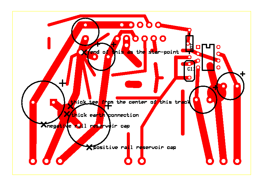

I think you're both wrong, here is why...
The positive and negative rail reservoir caps will be joined together by a thick earth connection; this is called reservoir ground (RG). Do not attempt to use any point on this track as the audio-ground star-point, as it carries heavy charging pulses and will induce ripple into the signal. Instead take a thick tee from the center of this track (through which the charging pulses will not flow) and use the end of this as the star-point.
Audio Power Amplifier Design Handbook, Douglas Self, 5th edition.
Do your homework gents. 😛
Quite the opposite, you have to do your homework, 'cos you don't know what is reservoir ground (RG)...let me help you - it is right in the middle of your bulk capacitors.

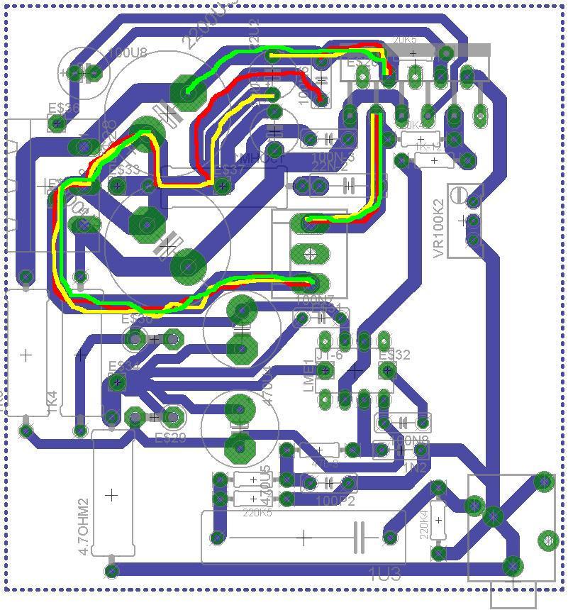

Okay people putting aside some lame comments and ego maniacal personalities, back to the main topic at last. My latest attempt at board layout is below, any productive advice is much appreciated.
The loop areas of the input side are far too big.
The HF and MF decoupling have traces that are far too long on both the chipamp and the opamp.

I'd say you have some very tight spacings between traces/pads carrying different signals which with some more careful thought could be improved on and will make the board more reliable to fabricate and solder. As to other aspects of the layout - there are already others who have more knowledge than me that have offered their input - even if the language of their input is irritating to you it might not have been intended that way and it is worth reading carefully what they say and then making your own mind what to accept and what to reject.

Um, dude... Arguing with the ref is not a recipe for anything good. I saw your posts from yesterday and really had to bite my tongue. Communication is a two-way street. Just because you say something that's perfectly clear to you, doesn't mean it's received clearly. Regardless of the language proficiency of the communicators.
Now, on your layout, I suggest thinking through the loops like AndrewT hints at. For example, the supply for your LM3886: On VCC, the main current loops run from the decoupling caps through the IC back to the decoupling caps. Minimize the loop inductance by minimizing the loop area (L is proportional to the loop area). The main supply caps are less important here. You can live with a longer route as the bigger caps mainly supply the LF currents. All the high-speed stuff (if 1 MHz can be considered HS these days anyway 😉) takes place in the local decoupling.
Always remember: Signal flowing out has to return to the source somehow. Trace those routes and minimize their loop areas.

In the schematic above you took a wire from between the reservoir capacitors to the star ground also that's what i quoted from Douglas Self book and that's what i did in my last layout is something wrong with that?
Regarding long return routes...Is there any component placement advice you would like to add, How long is too long a route to the ground?
