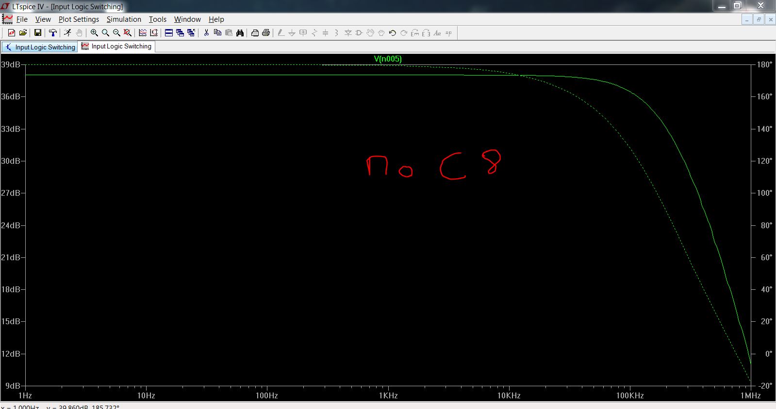

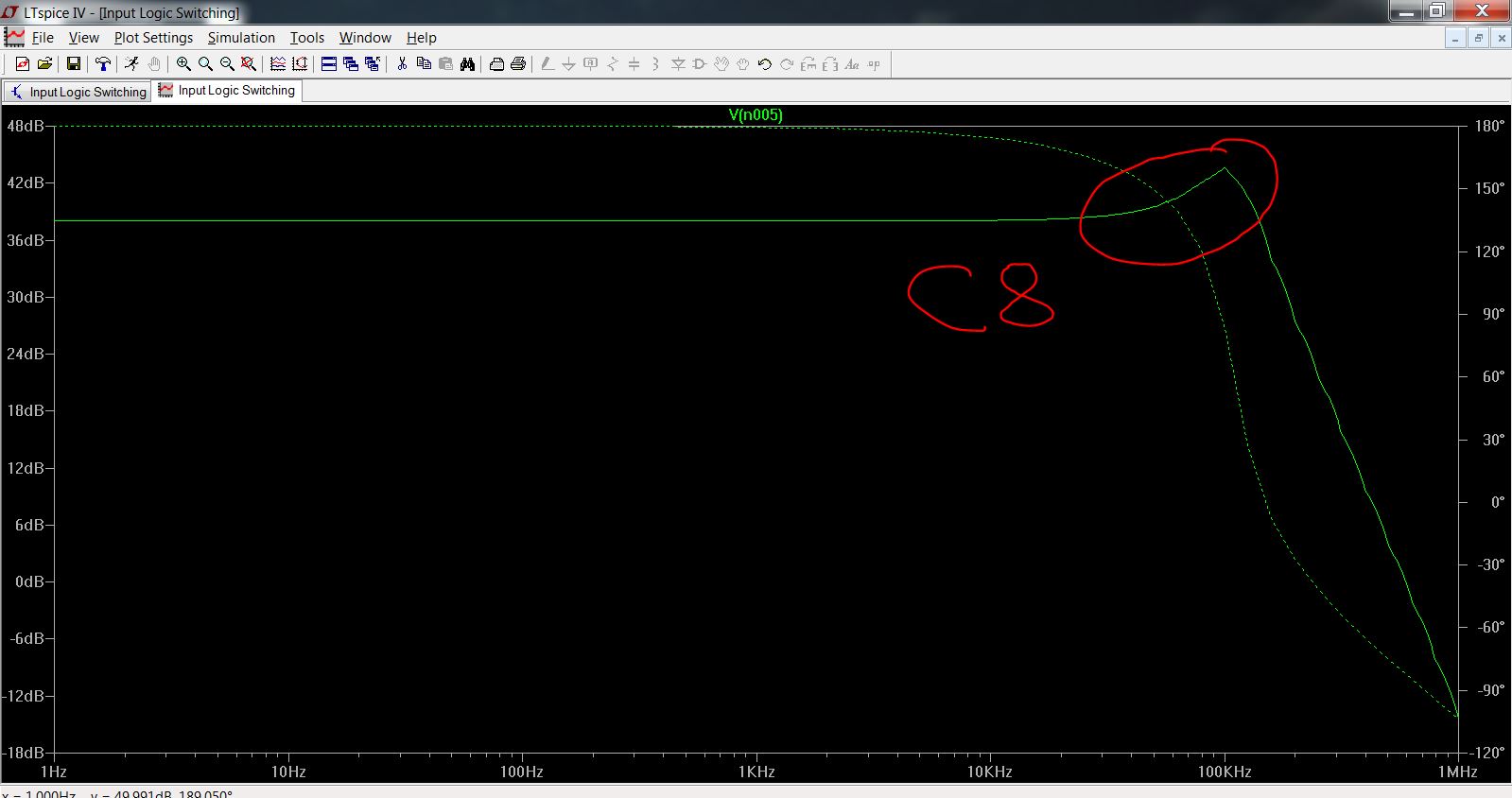

C8 will cause a peak in the loop gain of the amp. I just put your values into a basic opamp circuit (not an LM3886) to show you what it does.
So what value do you suggest for this capacitor to filter out RF noise? and why do many chip amp (LM1875, LM3875, LM3886) implementations include this cap between the amplifier inputs as a means of filtering out RF frequencies?
