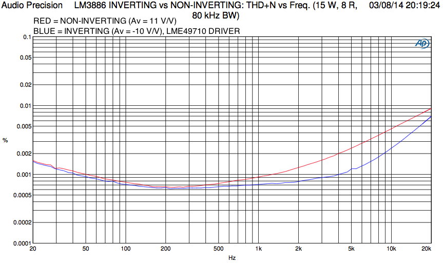

The circuit is the "GND STAR" topology I posted last night in the LM3886 PCB vs P2P Thread, Post #30. For the inverting configuration I added an LME49710 buffer to drive the 1 kΩ input impedance of the inverting LM3886.
Note that the noise floor of my HP 8903A results in a reading of 0.0018~0.002 % THD+N, so basically, the two circuits are neck and neck with the test equipment until about 5 kHz when the inverting configuration shows slightly worse THD. I plan to retake the measurement using an AP SYS-2712 that I just happen to have access to... 🙂 Stay tuned.

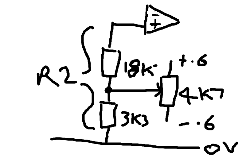

And one idea for trimming offset. Use two diodes to generate a -/+0.6 volt supply. That's just one resistor and diode across each rail. Connect a pot across this reference and use it to inject a current into a "split" R2. This should allow adjustment of the offset to zero. I've just guessed at typical values but it should be workable.

No problem Tom and thanks for the valuable contribution, as for the future tests could you please exclude the driver op amp (the LME49710) from the circuit as i believe for a meaningful results both the inverting and non inverting LM3886 configurations should be isolated from other factor (other components). 🙂
I did actually run the test with no driving op-amp at first, but my HP8903A cannot deliver the needed 2 V swing into a 1 kΩ load cleanly. The input impedance in my circuit is 1 kΩ because the feedback network I use is 10k, 1k. I did not test to see if the AP would drive 1 kΩ directly as I already had the buffer in place.
The LME49710 delivers a 3 V RMS swing into a 600 Ω load at 0.00003 % THD. I will not - repeat NOT impact the measurement of the LM3886. That's the whole point. Using a buffer that is strong enough to drive the input impedance is the only way to get meaningful data. Now, to get this performance, you have to be very careful with the layout, in particular with the ground connection between the LME49710 and the LM3886.
See attached data. For the inverting configuration, I drove the LM3886 with the LME49710. For the non-inverting, I drove the LM3886 directly. The THD is dominated by the LM3886 in both cases (by at least two orders of magnitude).

That's really some revealing data Tom, so the message sent by that last graph is that between 20~200 Hz they're both have equal performance but above that the non-inverting standard configuration is actually better. One question remains though...why is your circuit , the "something better" 🙂 revolves around the inverting configuration whilst it requires additional components (LME49710) and careful layout? was that for experimentation purpose or just playing around with different chip amp configurations?
