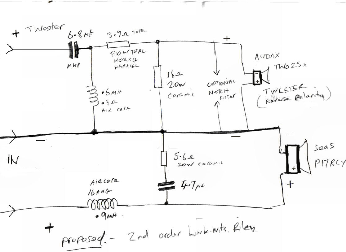

OK Thanks, I'm going to try a 2nd order linkwitz-riley again and drop the
x-over to 2400Hz with polarity reversed on the tweeter. I did try this a few weeks ago but the top end was a bit splashy for me so maybe I need a notch filter in there also. Tried it with Pink and white noise and there was definitely an audible rise at the top and it didn't blend well.
This was the circuit I used for 2nd order a few weeks ago.
It's worth a try, and at the least will give you the chance to cross some possibilities off the list. Don't lock yourself in to one polarity, there are a number of factors that will detract from what the texts will say, as true as they might be in an ideal world.

I always swap the polarity on the tweeter between every new configuration test so as not to miss anything.
What do you mean here, do you design the speaker by ears or by software? (Software will tell you sufficient information)
Yes it is the treble region I'm having the most difficulty with
Is that acoustically 2nd order too? (It looks so to me). Acoustically LR2 is difficult. First issue is to get the overlapping phase at Fx is not always possible with normal measures. When you get it right (the phase, the response) the sound may still not right, especially at high spl where the slope may not be steep enough to avoid the driver resonance (Fs).
I don't recognize the tweeter, but the values are a bit strange to me. For the woofer, 0.9mH/4u7/5R6 is relatively very high, but for the tweeter 6u8/0.6mH is relatively low. Are you sure there is no extra dB at midrange frequency?
From my experience, no tweeter will sound good with 6u8/0.6. This of course depends on the tweeter parameters, what I mean here is from tweeters that I have ever used. Honestly, by intuition I think the crossover won't work, but you know better.
mart.s, sorry I just read your previous posts regarding your crossover. I think you should post the original crossover before the original tweeter blew.

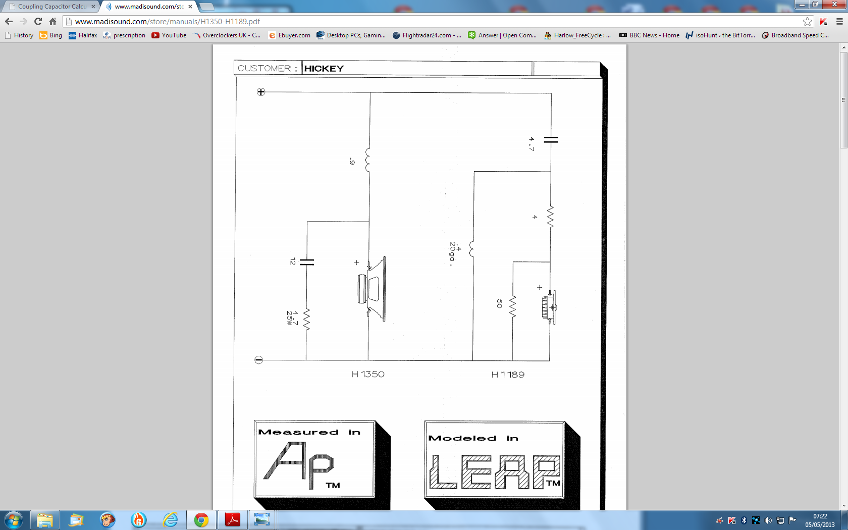

But you still can show the original crossover at 4kHz, to understand the "properties" of the woofer. It is also difficult if both woofer and tweeter has different impedance (e.g 4R versus 8R). What is the impedance of this Audax tweeter?

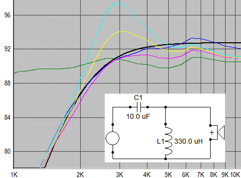

I think it's more to do with how different the response can be by using any single value for the impedance rather than the full plot, and the fact that tweaking is to be expected when measurements are not taken. I set up an example of this with a simple crossover changing only the impedance.then I think the designer would also want to base the values of inductance and capacitance on a load impedance that is at least a good deal closer to the actual impedance than nominal.
The tweeter (green) has the crossover applied (blue) for the target (black).
The pink trace shows the effect of using the full impedance plot after the phase has been set to zero. Zero degrees has no significant meaning in this case, it could be set to anything but it gives a clue toward the benefit of including it, as usually when it is left out it is left at zero.
The yellow and cyan traces show the result of setting the impedance to equal an eight ohm resistance, and a twelve ohm resistance. The peaking is because this crossover was designed for the true impedance, rather than a compensated one but this is of course irrelevant. It is the difference from the target that I'm trying to show.
The more thoroughly you can compensate the impedance, the less significant all this becomes but at some point this too is going to need measurement, and once these initial measurements are done there is no longer a need to choose a value for the impedance.

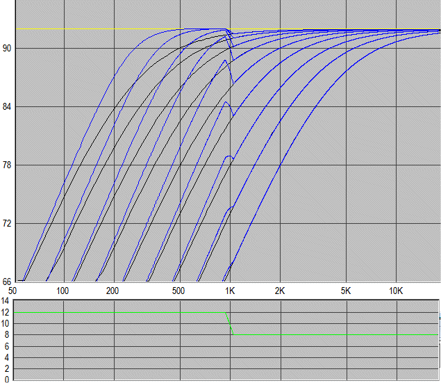

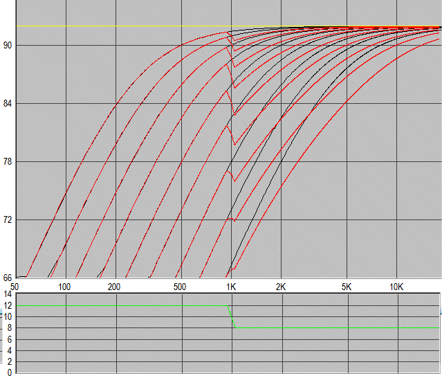

I went and had another think about how to show the differences in a way that would help others decide how significant this can be. The behaviour of a second order electrical filter tends toward being correct at both frequency extremes regardless of the impedance, while being more sensitive to it in the middle. A lower Q filter (such as the Linkwitz-Riley (Q=0.5) that we often start with) will tend to be more sensitive over a wider region.
I modelled an impedance that is resistive at 12 ohms below 1kHz, and 8 ohms above that. I set a target L-R rolloff at 1kHz, and also in half octave steps for two octaves either side of 1kHz. I then used calculated values of filter for each of these using 8 ohms (blue curves) and 12 ohms (red).
This way, one could look at the driver impedance curve and roughly estimate how much the response could be affected by how far away from the crossover point the impedance peak is.

Sorry chaps I hadn't realized you had replied to my post regarding 2nd order crossover.
The original crossover values were not known, But originally I believe it used a Seas 27TBFC/GH1212 tweeter. The x-over consisted of an ferrite core inductor for the bass driver and a 5uF cap with a 5 ohm resistor for the tweeter. The nearest x-over I could come up with that matched these parts was a first order Solen split crossed somewhere around 3000Hz with the woofer inductor about 0.6mH.
I reduced the capacitor value in the new 2nd order to 5uF and it sounds about right now with the Audax tweeter.
The new 2nd order was based on the following circuit from madisound (based on the closest match to my drivers) with a few slightly different values, And yes I have done it all by ear with no measuring tools or software, just a friend's Proac Studio 100's as reference.
I am STILL getting a little sibilance on the tweeter which I guess is due to a rise at the tweeter crossover point and I just cant be bothered to mess around with notch filters or re designing the x-over to a 3rd order which I know would help. I am lucky that the Audax tweeter I have is buttery smooth which helps somewhat. I also tried a SEAS 25tdfc a while back which I didn't like the sound of so sold on for peanuts and went back to the Audax.
Madisound x-over below:
