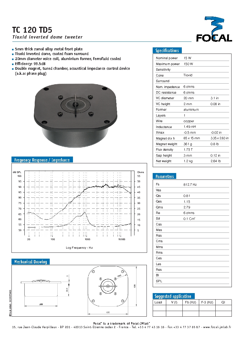

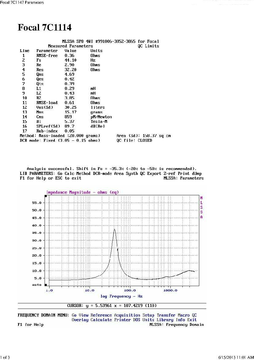

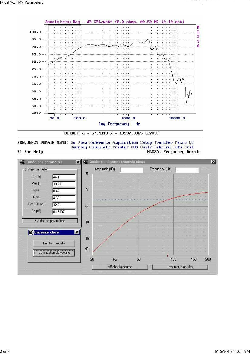

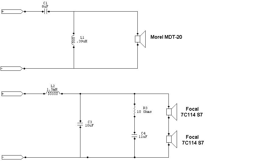

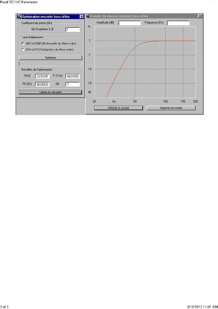

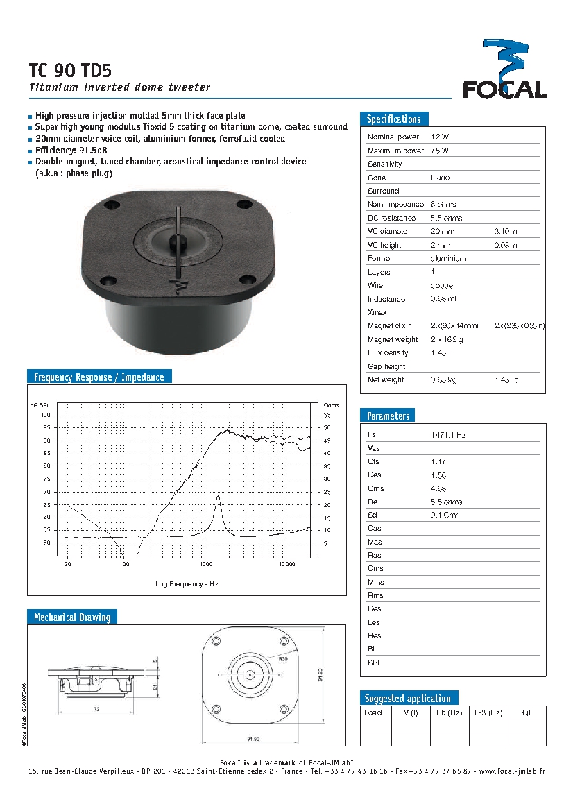

The box is about 36 high 10 wide 10 deep. My son has fried so far three tweeter coils. I would like to replace the TC90TD5B tweeter with something as good that can handle some real power but I don't understand crossovers, I have a ways to go learn it.
I tried a Dayton Audio DC28F-8 1-1/8" Silk Dome Tweeter 275-070
Specifications: • Power handling: 50 watts RMS/100 watts max • VCdia: 1.14" • Le: 0.09 mH • Impedance: 8 ohms • Re: 5.5 ohms • Frequency range: 1,300-20,000 Hz • Fs: 637 Hz • SPL: 89 dB 1W/1m • Qms: 0.82 • Qes: 0.9 • Qts: 0.43 • Dimensions: Overall diameter: 4.33", Cutout diameter: 2.72", Depth: 1.54" • Replacement diaphragm 275-072.
It doesn't sound good.
The Morel MDT-20 from what I have read is no longer made.
Why is the woofer crossover different when a different tweeter is used?
perhaps some tweeter and crossover recommendations.
The amp is a dual mono BrianGT chipamp.
Thank You
