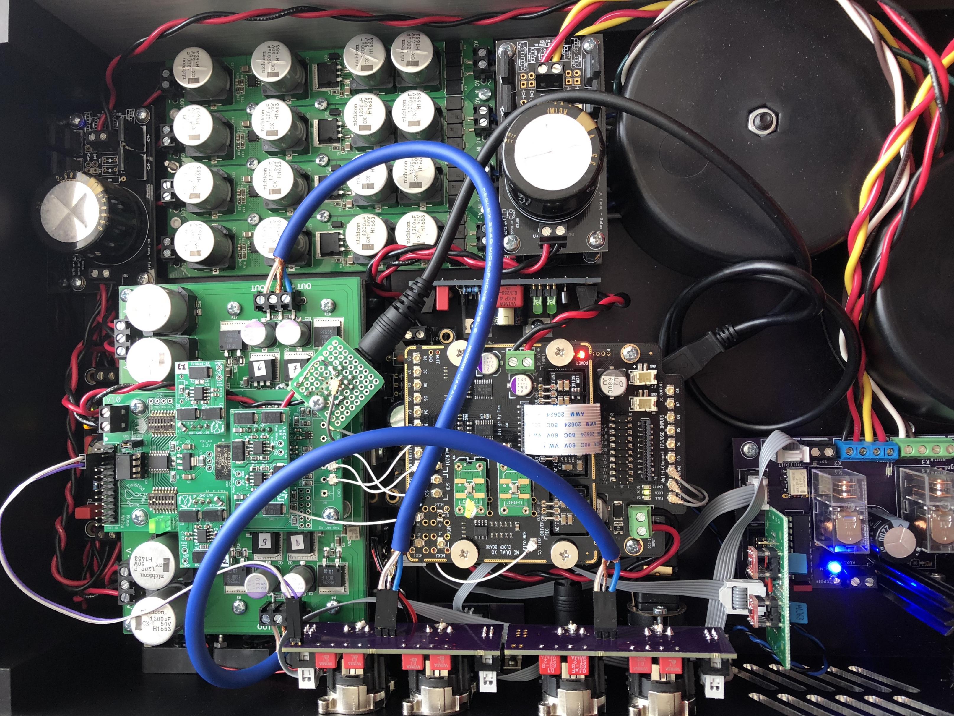

I finally got the modified firmware on a new ATtiny85 (somehow I managed to brick or fry the original since couldn't even reset the fuses with HVSP).
I can confirm that modifying the firmware as in post #511 results in having both PCM/DSD in "pure sync" mode and SPDIF in async mode. It works well using the original method of switching between the two inputs.
In pure sync mode I can echo what Twluke and Fedor have already said: the sound is more open and lively while remaining "full bodied". Sounds very good! The only issue I have is that with DSD512 I get a high pitched constant noise superimposed on the music, and only in the right channel. Changing back to DSD256 the noise completely disappears. Not sure if this could be a firmware issue, or any of the other parts that come before the buffalo?
As for the pop on pausing the music, I cannot reproduce it, but maybe it's because I have the Buffalo hooked up to the NTD1 which has coupling caps on the output?
Paul
