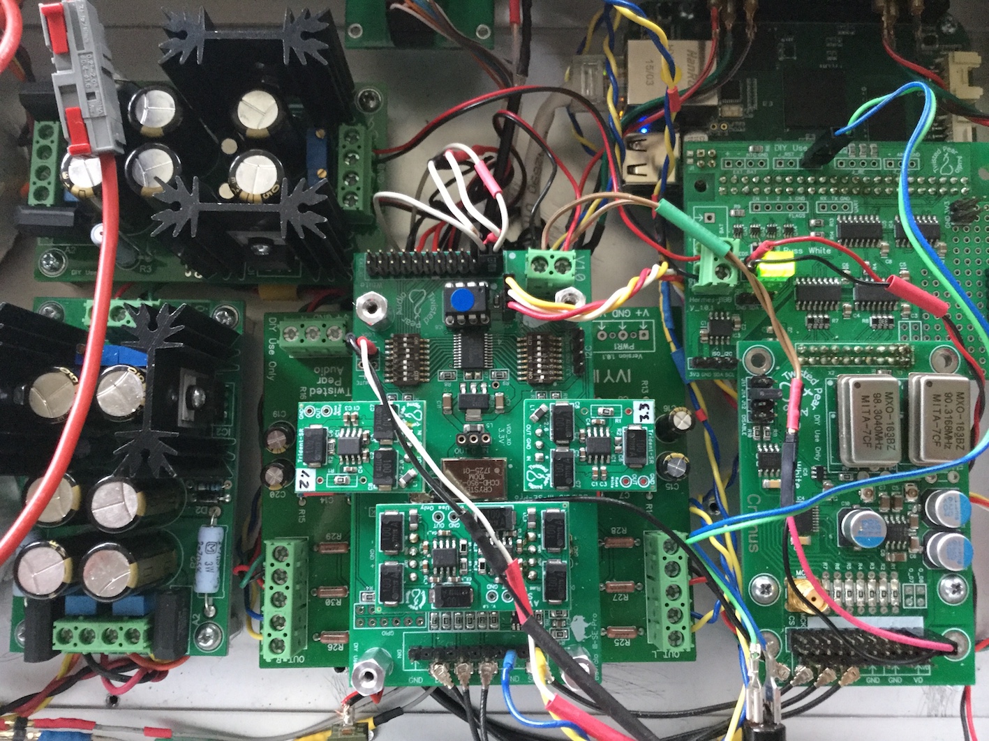

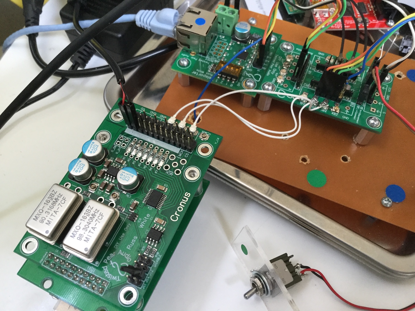

I performed a few experiments to check the feasibility of 90/98 clocks for DSD512 play under Amanero with Hermes/Cronus.
First the Amanero complex was connected to a BBB running Arch Linux to receive a native DSD512 source played by MPD on it and the output was sent to B3SEpro via Teleporter (and Otto II) as shown in the picture.
Results: The 90/98 clocks (actually 90MHz in this case) on the Cronus worked well for playing DSD512 in async mode. The SQ was quite satisfactory. The 45/49 clocks from Crystek also worked well in this setting, showing no stuttering in playing DSD512, though hampered by a continuous rumbling background noise.
Then the Amanero complex was directly connected to the B3SEpro, receiving upsampled DSD512 sources via USB from HQ player running on a linux machine of i7 6700k.
Results: There was severe pulsating noise when the DAC was set to sync (slave) mode by disconnecting the onboard XO, almost masking the music sound of DSD512. The DAC appeared trying to lock but could not achieve even after 10 minutes waiting. The situation became slightly improved when the sampling was changed down to DSD256 but could not eliminate the noise.
My tentative conclusion: It appears quite difficult to get optimal DSD512 sound in sync mode even using 90/98 clocks. Async appears to work quite well with these high speed clocks, whether using Amanero alone or using it in combination with Hermes/Cronus: probably reflecting the advantage of onboard XO, which was nicely placed in the vicinity of the Sabre DAC chip on the B3SEpro.

Hi Russ, thank you for your quick support. With the given hex file, I think the preparation of this experimental firmware chip went well. Please let me know if there is something wrong with my setting. BTW, I added a 10K R between Vcc and Reset and a 0.1uF C between Vcc and GND for this procedure to avoid verification error.
Code:
root@parabuntu:/usr/src/avr# avrdude -pt85 -cdragon_hvsp -Pusb -u -Uflash:w:"Buffalo-3-SE-Pro-OB-SyncMode-PCM_DSD.hex":a -Ulfuse:w:0xE2:m -Uhfuse:w:0xD5:m -Uefuse:w:0xFF:m

Results: As in the case with Amanero, playing DSD512 with 90MHz was hampered by continuous pulsating, periodic noise, similar to the noise with xruns in Alsa. The pulsating interval became gradaually longer and sporadic after waiting patiently, making the music sound more audible but the noise never ceased...
Then I changed the clocks to 45/49 combo: I was surprised to hear very clear DSD512 sound with this sync-only setting. This was a great bonus but there was something odd: with the regular jumper setting for 45/49 clocks on the Cronus (1 x 2), the rate of playing music became twice faster, like using a 90/98 combo and the rate became normal when the jumper was set to 1 x 4. I'll be happy if this can be explained.
BTW, during this experiment, the Vin of noise-rich B3SEpro with 90/98 combo measured 4.38V while 5.07V with noise-free 45/49 combo.
So, I'd like to conclude that your sync-only firmware is, for now, working quite well, though there may remain something to be refined further. Thank you so much for your great support.

You must also remove L5 or Short R7 (either is fine) on the slave DAC. This will disable the port expander on that board. This is important - otherwise the port expander on the slave board will conflict with the master.
A single controller will be controlling both DACs and so you need to connect the two I2C headers between the two DACs. Only connect GND,SDA,and SCL - do not connect 3.3V on the I2C headers.
This firmware should work for SPDIF, PCM, and DSD.
Analog outputs will be same phase on both sides (unlike mono mode in old ES9018 B3/B3SE firmware).
if anyone tries it and runs into any issues - let me know. I will try to get it sorted 🙂

Thank you for your experiment and for tying out Russ's modified firmware for sync only mode. It would seem that going that route would negate the need for 90/98 clocks for DSD512.
With this SyncMode firmware, the MCLK is always defined by 128fs. For DSD128 of 44.1K family, it is 128 x 44.1 x 2 (dual). For DSD512, this becomes 128 x 44.1 x 8 (octa) = 45MHz. So this would be no surprise to find the 45/49 clocks are well working with DSD512. Using 90/98 may become redundant other than for DSD1024. This is my humble assumption.
That's correct - in this mode you would only need 90/98 clocks if you want PCM at ~700Khz or DSD1024 - but lower sample rates would still work just fine as long as they are in sync with the master clock.
I think Twluke's initial experiment was hampered by a sagging supply at the very high sample rates - otherwise it should have worked as expected.
I had some time to try the 128fs sync mode firmware myself and it worked for generated DSD64/128/256/512 as well as 44.1khz - 384khz PCM(I2S) with 90/98Mhz and 45/49mhz clocks.
