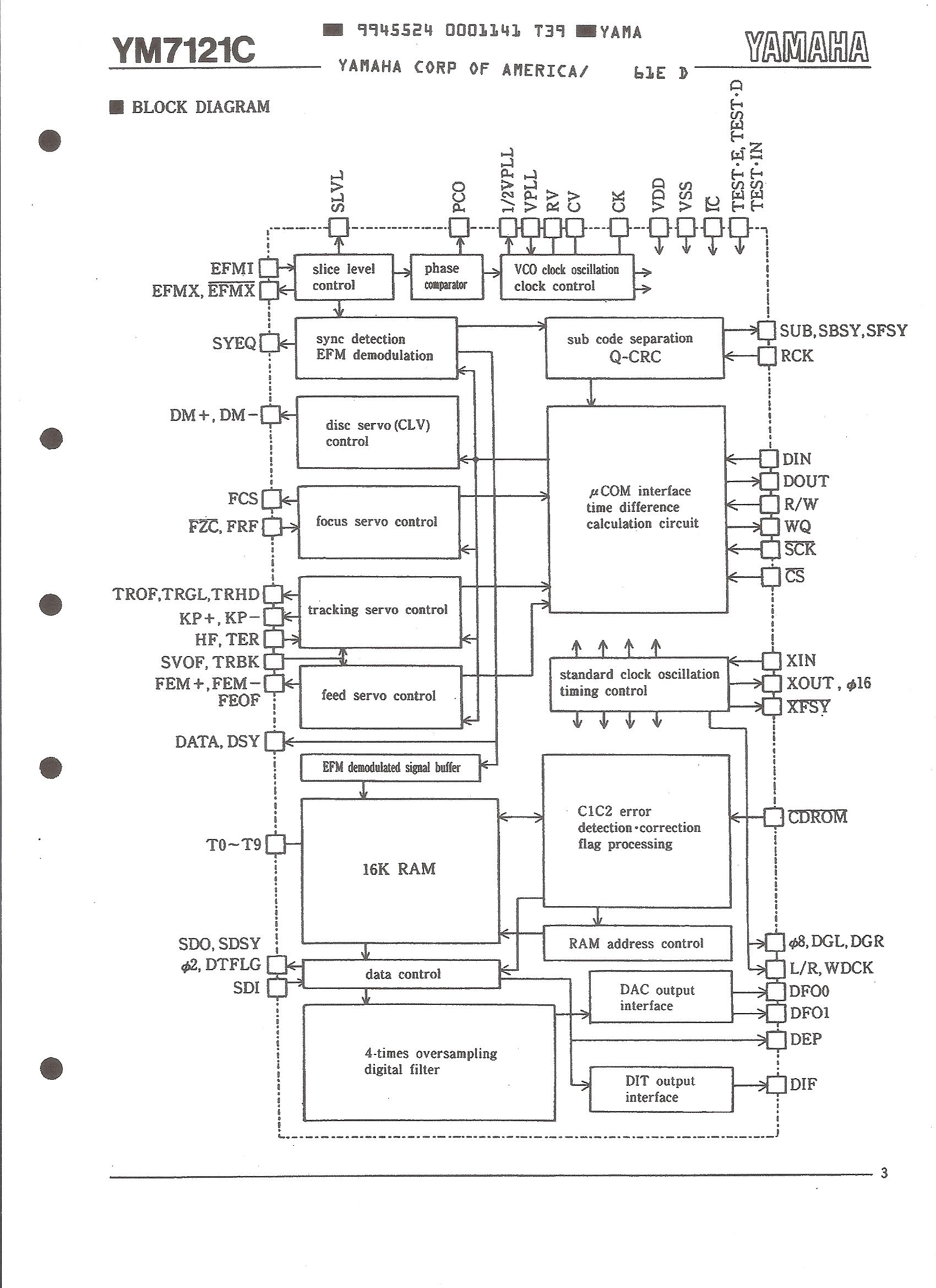

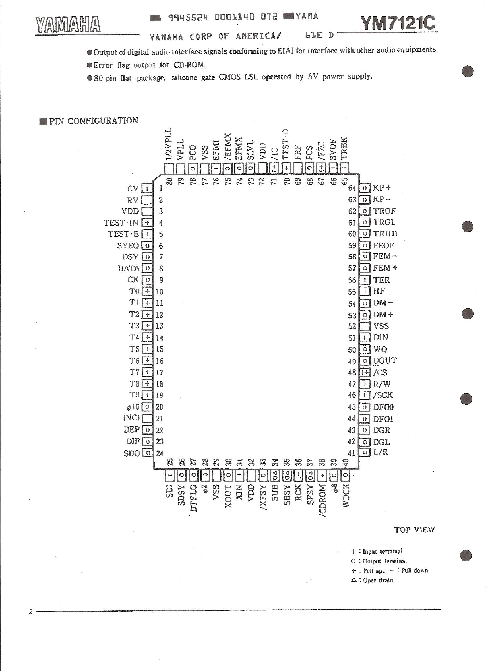

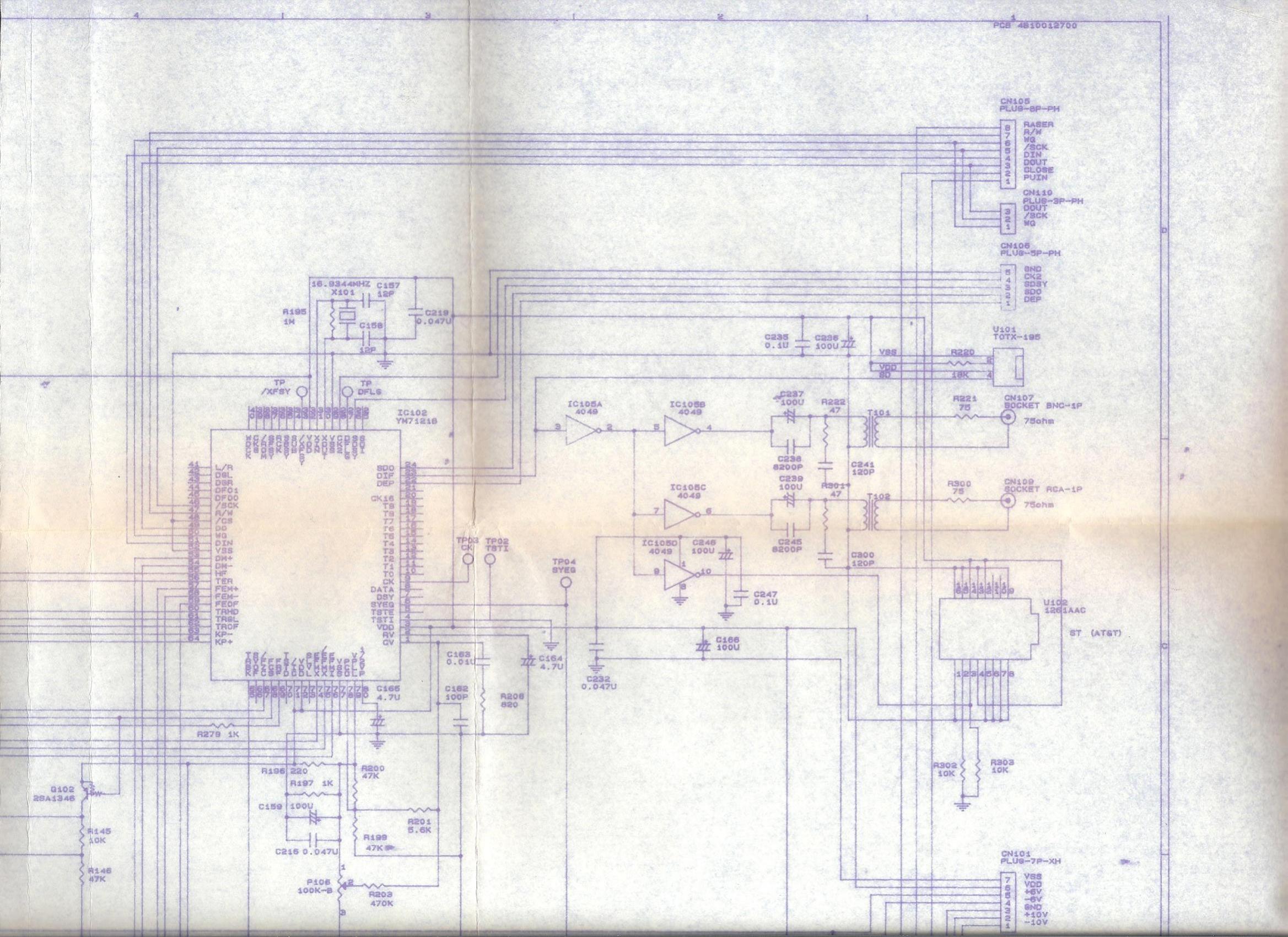

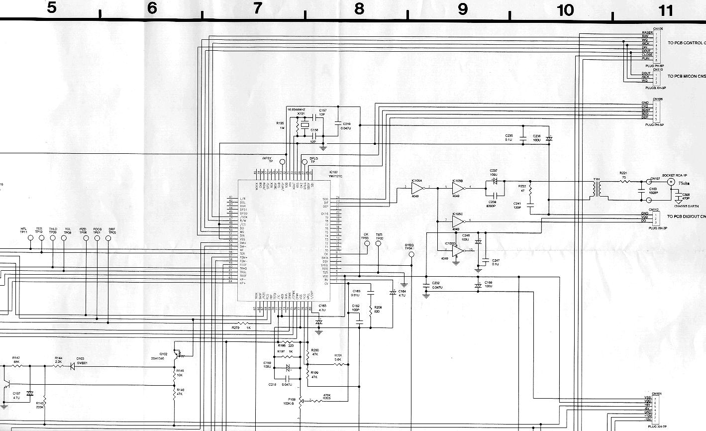

Please take this to the support forum. It is not directly related to the Teleporter.
EDIT: Also, it would be helpful to see the portion of the schematic with the DAC chip.
