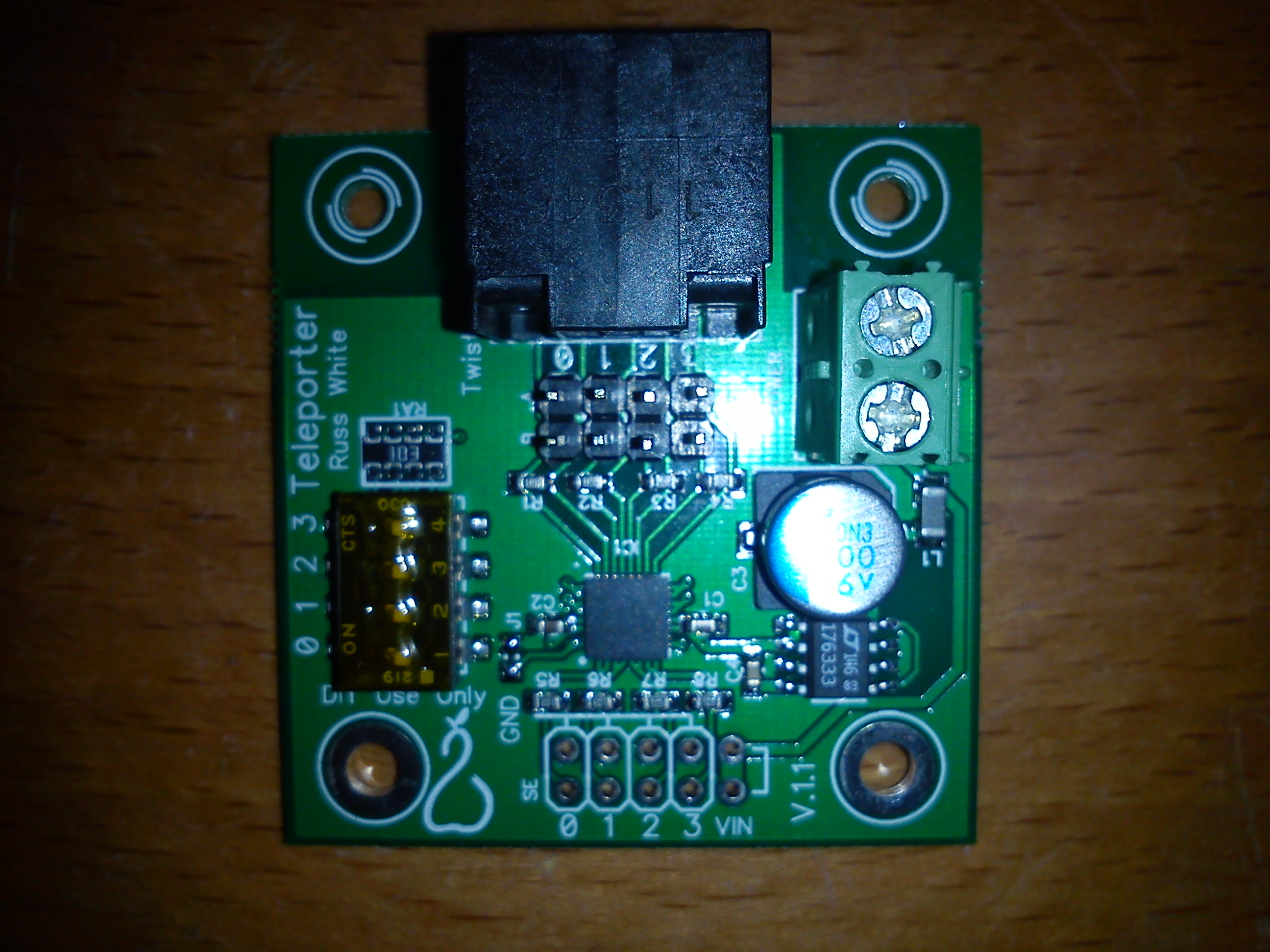

Attached pic, Left teleporter "off" is transmiter right Teleporter "on" is receiver? I have to connect 4 I2S wires and I have 8 holes, wich one have I to use (where is writed SE near the numbers: 0, 1, 2 & 3)?

If you look closely, the holes further from the board edge are connected to the ground plane. Therefore, you want to use the four holes closest to the edge.
Are those jumpers on the LVDS header on the module on the left? If so remove them, you would never want to do that.
How can configure for receiver & transmiter?
That's what the switch is for - on the left of the board in your pictures.

So I have the DIP switch all four positions "off" for the transmitter & all four positions "on" for the receiver, attached pic (where was jumpers now is the transmiter), it's OK?

Teleporter has a local regulator, so you don't really need anything too fancy. Lm317 type is just fine. 🙂 Even LM7805 is fine.
The supply range on the Teleporter is pretty flexible. 4-8V should be perfectly fine.
:EDIT: 9V may be on the high side - looking at the VREG junction temp. I would recommend 4-6V if you can do it and about 8V max.

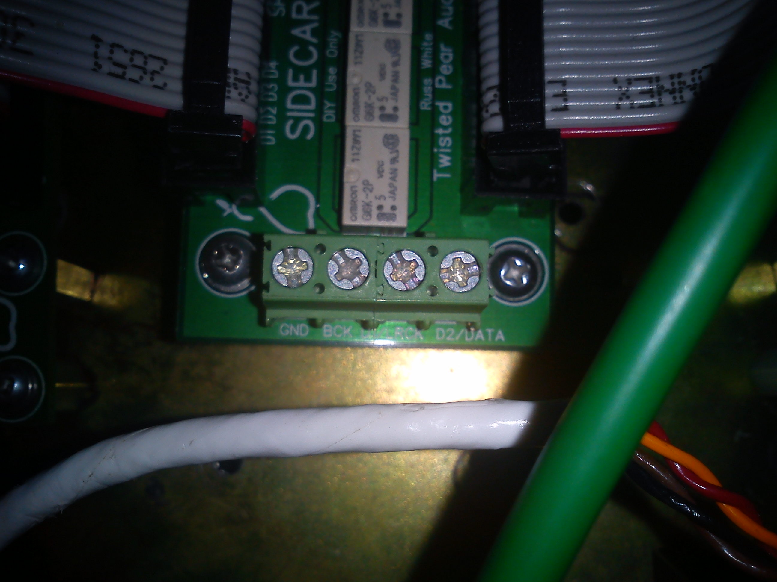

Attached Sidecar pic, I believe:
PCM
Teleporter receiver - Sidecar
bit clock - BCK
word clock - D1/LRCK
data - D2/DATA
DSD
bit clock - BCK
data left - D1/LRCK
data right - D2/DATA
It's OK
Yes that is the correct signal order for PCM and DSD.
