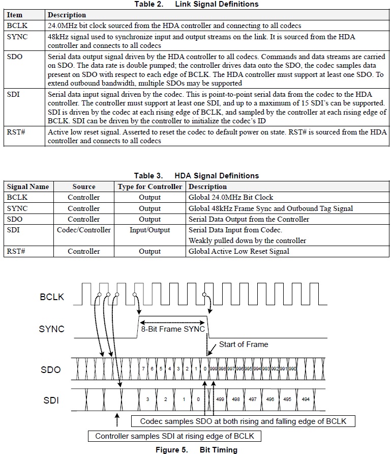

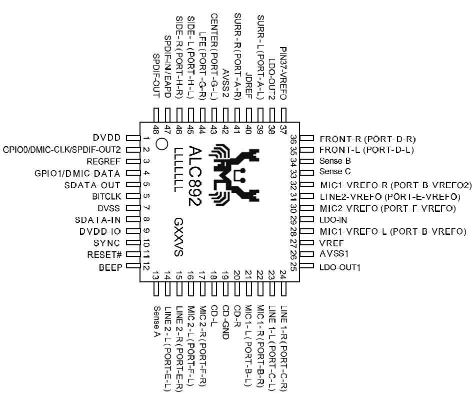

My apologizes if this is the wrong place to ask. I'd like to use the Transporter to send signals from an ASUS motherboard with onboard sound that has the Realtek ALC892 codec. See attached chip info....
What format is the data in? It does not say I2S.
Not sure I'll have another look through the data sheet, but I seem to have read 'High Definition Audio Link Protocol' ? Input and output streams it says are PCM data isochronous. Whatever that is, I'm not experienced in this.
It does not look like a format the ES9018 would support.
