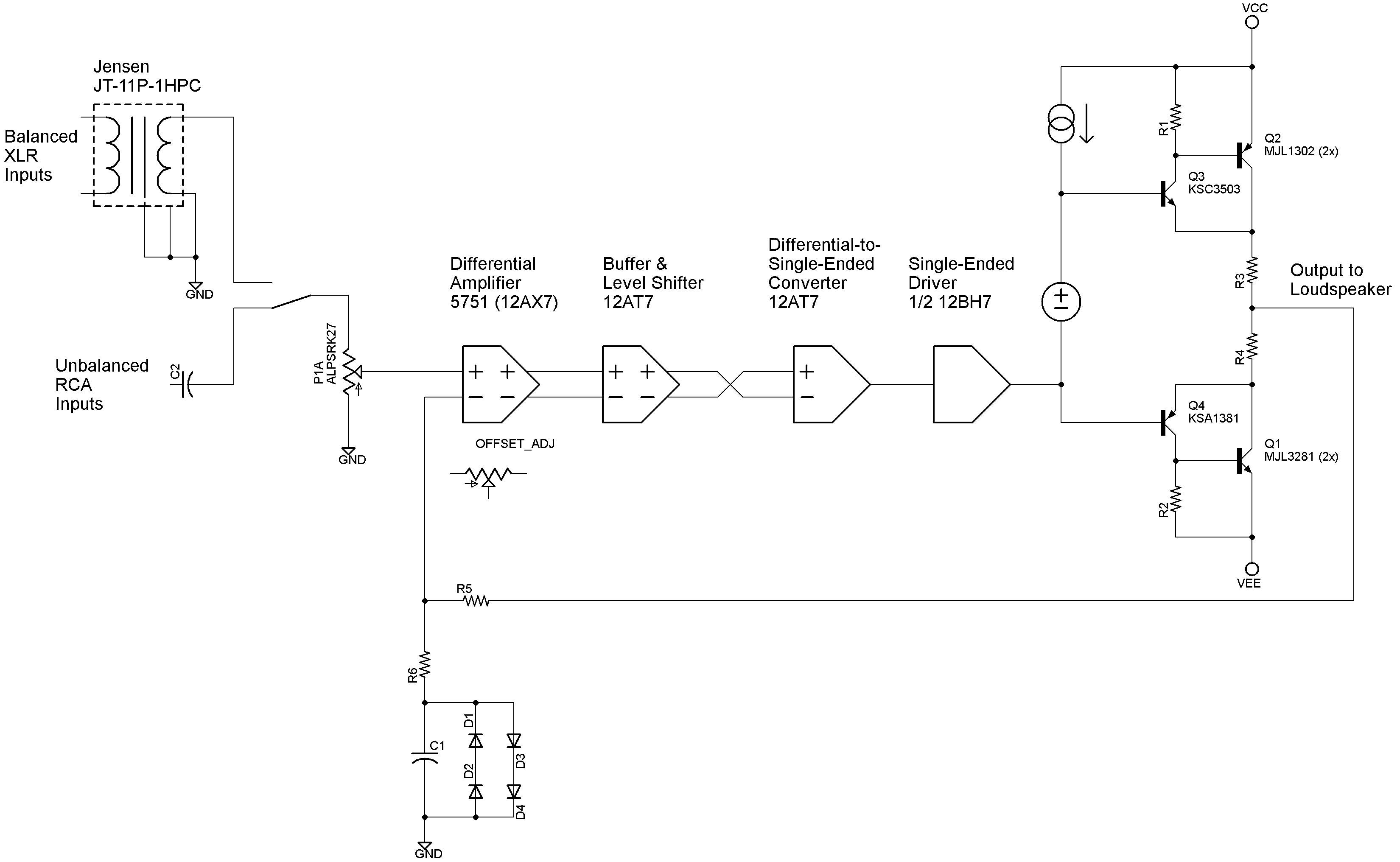

Thanks Scott. I'm still thinking about circuits for hybrid amps, and I hope you don't mind if I ask a few more questions about yours.
Is it really direct-coupled - if a DC voltage is applied to the input, is it transferred to the output? I think I see some Jensen audio transformers in your photo.
If so, how is the DC offset at the output controlled? Is there an offset correction servo? How stable is the output offset?
There are many ICs and transistors on the PCB. What parts of your circuit are tube, and what parts transistors?

Hi Iwan,
Yes, it is really direct coupled, from the input stage to the output. But between the input connector and the input stage is either a DC blocking capacitor (in the case of the unbalanced RCA inputs), or a Jensen line-balancing transformer. Most direct-coupled transistor amps work the same way - they use a DC blocking cap at the input, to prevent a DC offset from your source from reaching the speakers.
The offset at the output is set by the input stage, which is a 5751 (a 12AX7 variant) differential pair. The offset is trimmed to within +/- 0.02V with a pot in the cathodes of the input diff pair. The amp is protected from excess DC offsets the same way that a transistor amp is: offsets greater than a predetermined amount open an output relay.
There is no offset correction servo. That was one of my motivations for direct coupling the amp. In an AC-coupled hybrid amp with a servo, the two feedback loops fight each other and slow recovery from overloads.
A number of these amps have been in service for almost three years now, and offsets are maintained < +/- 0.05V and are monitored by a microcontroller.
The output stage uses bipolar Sziklai pairs, as well as a bunch of transistors for biasing. The rest of the signal path is tubes - but the tubes do have current-source or current mirror loads in the 2nd an 3rd stages. And there are a bunch of solid state devices used in control circuits.
Hope that is useful. I could draw a block diagram, if you give me a few days.

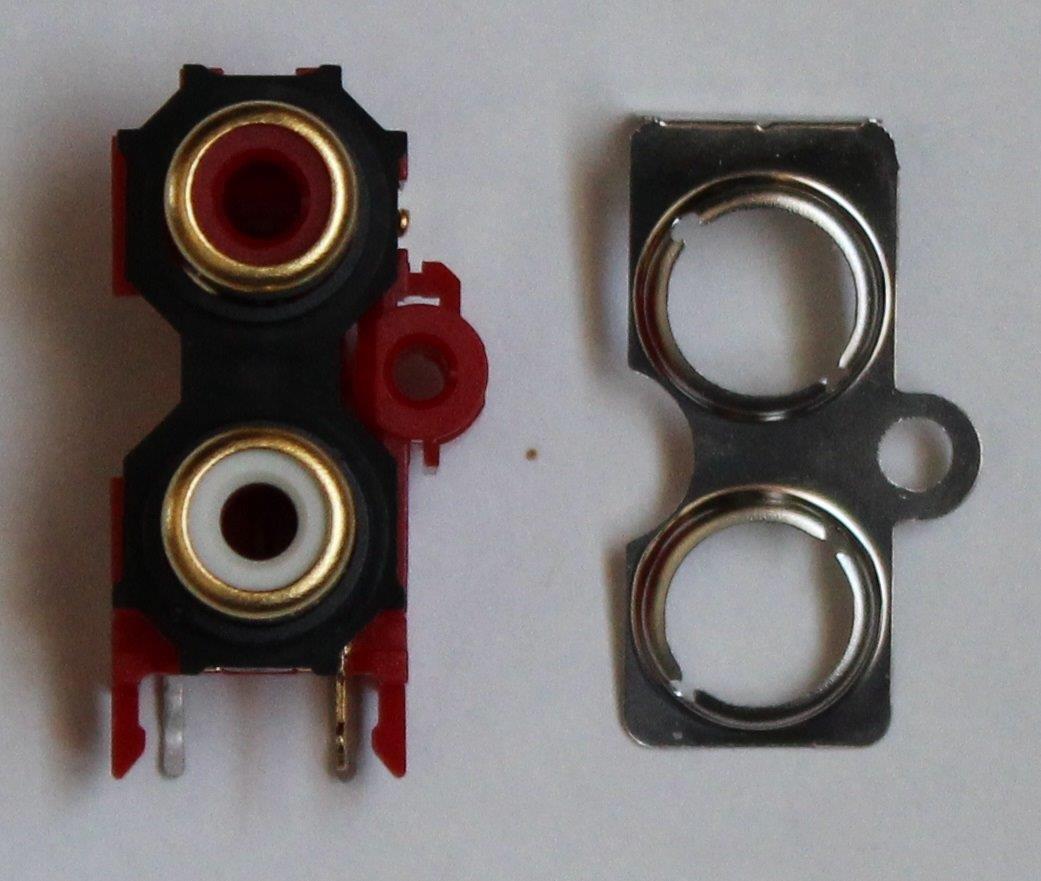

Thanks Scott, nearly finished, but the output connections seem to be earthed?
Cant see anything obvious wrong.
Haven't powered it yet.
Hi Paul,
The output connectors should not be connected to the chassis, if that is what you're asking. There is a photo in the assembly manual showing how to remove the metal ground piece and expose an insulator - I attached it here.
Best,
Scott

Ok once it powers up and the relay kicks in it stops grounding the signal.

Hi Scott,
Good to see your thread active. I’ve run a spice simulation of a direct coupled tube-mosfet amplifier, based on your block diagram, and also based on your headphone amplifier schematic. I couldn’t see exactly how the driver stage in your block diagram was direct coupled, so my circuit looks more like a 2 stage version of your headphone amp. It all works. It’s possible to direct couple a multistage amp using split supplies and your level shifter. I’m intrigued.
One thing I can’t simulate is the DC offset stability. As I understand your circuit, the output DC offset depends on the input stage DC offset. You say that the offset can be adjusted to less than 20mV, but how often does it need to be readjusted to keep it there? Is it only a manual adjustment, or does your microcontroller adjust the offset? How much offset do you think is reasonable?
Iwan
Hi Iwan,
And good to hear there is someone else interested in hybrid amp circuits like this…… Feel free to contact me by email or PM if you decide to build something and have specific questions about your circuit.
For the Minotaur, DC offset in the input diff pair is a manual adjustment; the microcontroller monitors the output offset and alerts the user if it exceeds 50mV, but there are no automated adjustments.
I don’t have extensive data on long-term offset drift, but the data I do have suggest that the offset may only need readjustment when replacing the input tube (5751).
I built my initial prototype in 2011, and some “early adopters” have been using the Minotaur since 2012. No user has reported an indication of offset >50mV. The highest long-term offset drift I’ve measured is ~25mV on one channel of my initial prototype, and I believe our current amplifiers are better, because I now select input 5751 tubes with well-matched sections, and I also discard tubes that show bias drift during burn-in.
As part of our burn-in process, I adjust the offset to <10mV, then monitor the offset post burn-in to make sure it is stable. The attached plot shows the offset over a 2+ hour time period. After the first 5 minutes, the offset settles to ~+3mV and stays there. Not all samples are quite so good as this, but even some solid-state amps aren’t as good. This degree of offset stability is only possible with regulated HV and heater supplies.
Of course, the long-term drift of any specific tube is impossible to predict. At any rate, I think these offsets are too small to affect either the amplifier or a loudspeaker.
