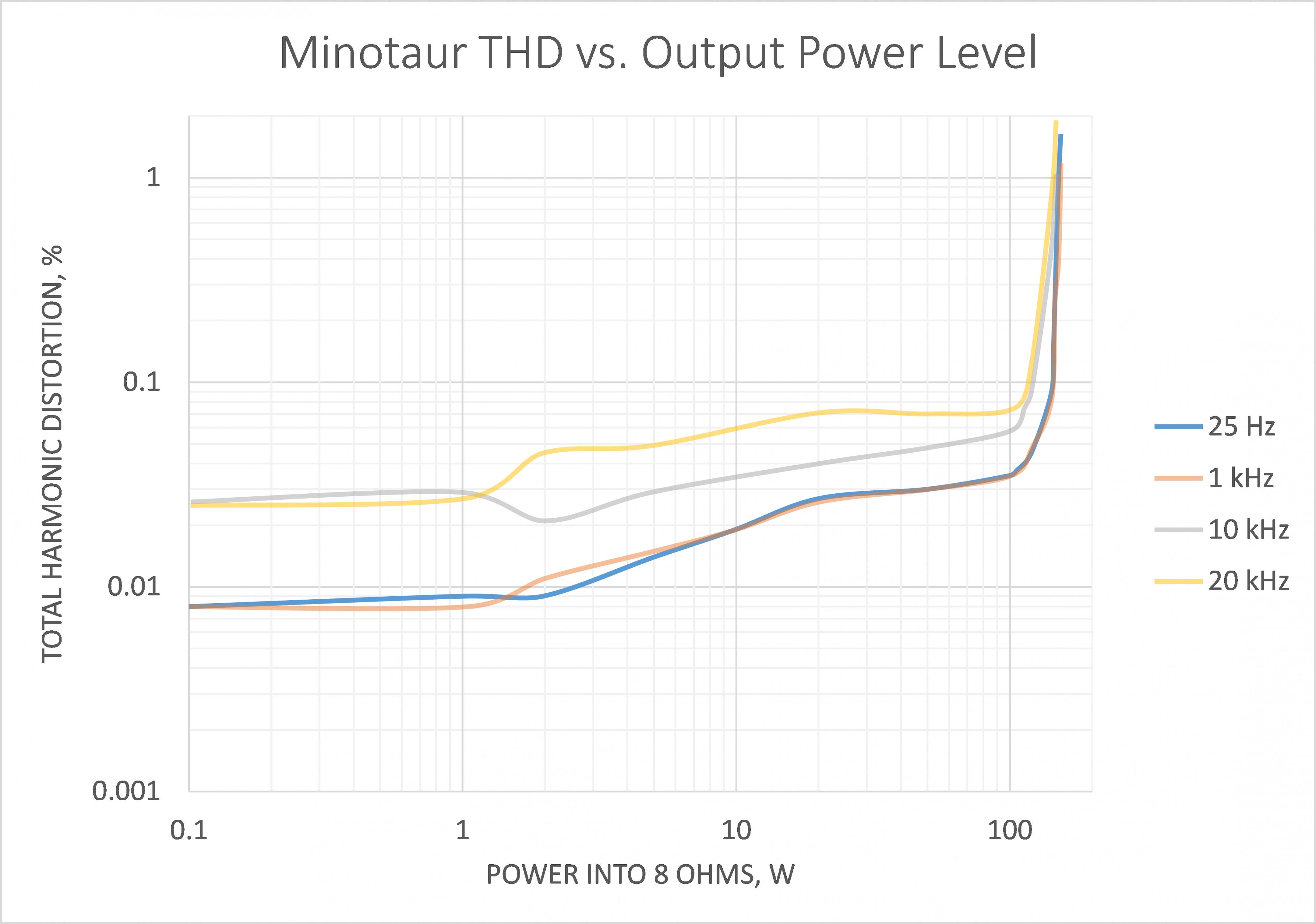

The Minotaur; was thinking of the graphs for LF distortion and IMD. Is the design cap-coupled or DC-coupled? Just curious.
Ok, I'll post some plots of distortion vs level and frequency.
The Minotaur is Direct-Coupled, except for a single blocking capacitor at the input. I added that cap to prevent a DC offset from the source from being applied to the amplifier.
We're back from vacation. In response to Quip's request, my son measured the Minotaur distortion levels vs power (from 0.1W up to 140W into 8 ohms), at four different frequencies (25 Hz up to 20 kHz). He also captured some distortion spectra using the Picoscope 4262. I've updated the Minotaur owner's manual, adding an appendix to include these plots.
Minotaur Direct-Coupled Hybrid Integrated Amplifier – Tavish Design
For a hybrid amp with a predominantly vacuum tube signal path and only 24 dB of negative feedback, I think the results are pretty good.
