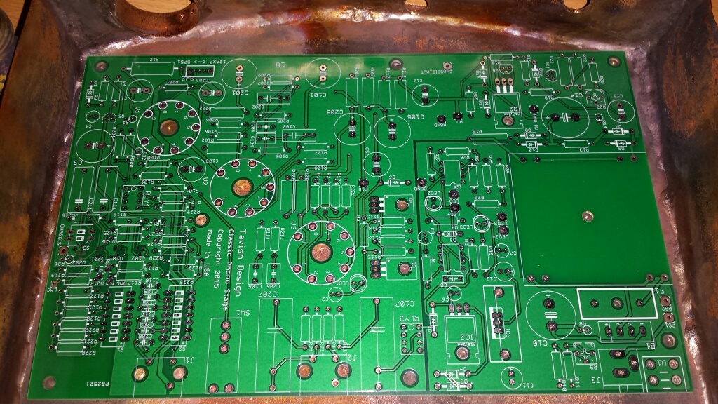

Hi Scott
Board turned up today all in one piece.
Even fits inside the box I started making in anticipation🙂.
Have a bag full of bits from Mouser and some valves on the way.
Will get started some time soon and Im sure there will be a few more dumb questions for you.
