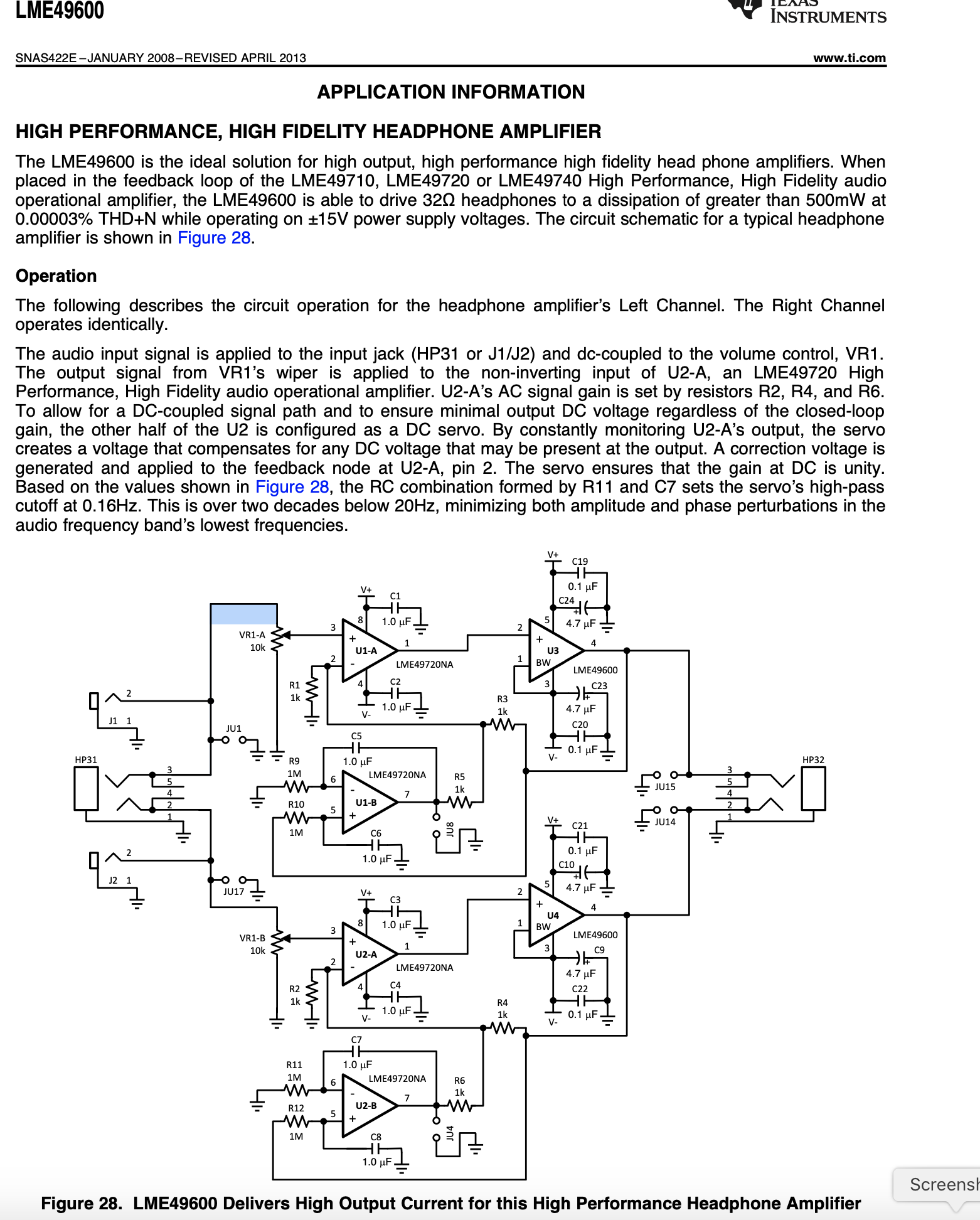

I have a basic question about the common mode servo that compares the common mode voltage at the transimpedance output to the common mode of the input:
While operating, would this servo correct for any abnormal disturbance in DAC chip differential output in which plus versus minus amplitudes significantly differ? In other words, would it 're-balance' to diminish or eliminate output of DC from the I/V stage?
...guessing it is different from the servo on page 10 of the LME49600 datasheet, but need to ask... TIA!
Frank

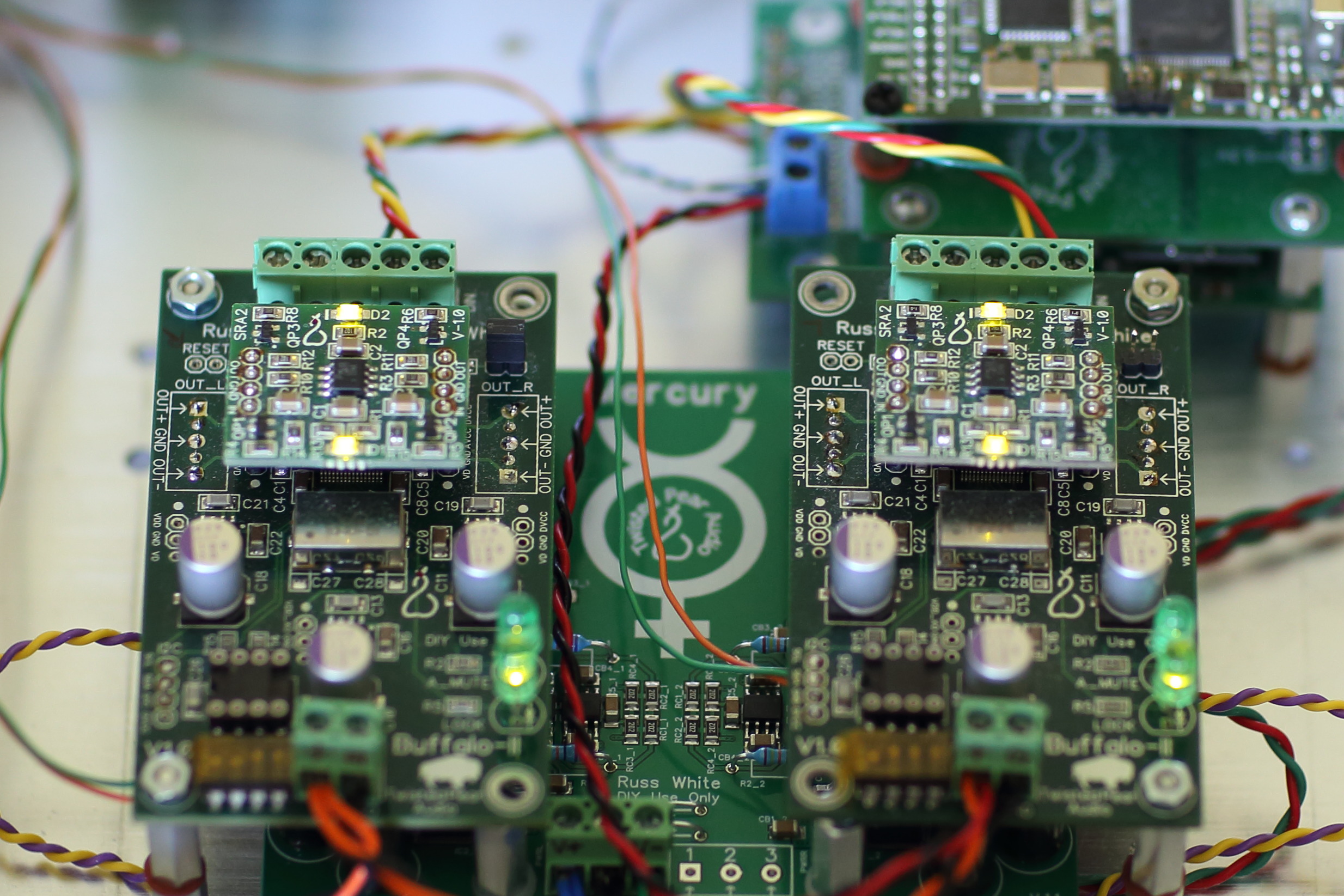

My new Mercury has been running for 48+ hours now with my dual-mono Buffalo II. I had previously used both Legato and IVY for IV converter.
I tip my hat to Russ and Brian. The Mercury takes my DAC to a different level. The extension, resolution, tone/timber and soundstage all improved.
Because of the similar footprint and all, it was minimal work to substitute the IVY/Legato with the Mercury. I had some additional work due to my dual-Buffalo setup and had to improvise a bit to accommodate the shorter pin headers shipped with the Mercury.
Thanks for a wonderful product!
