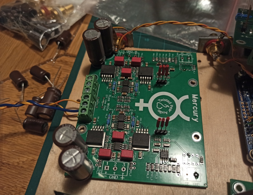

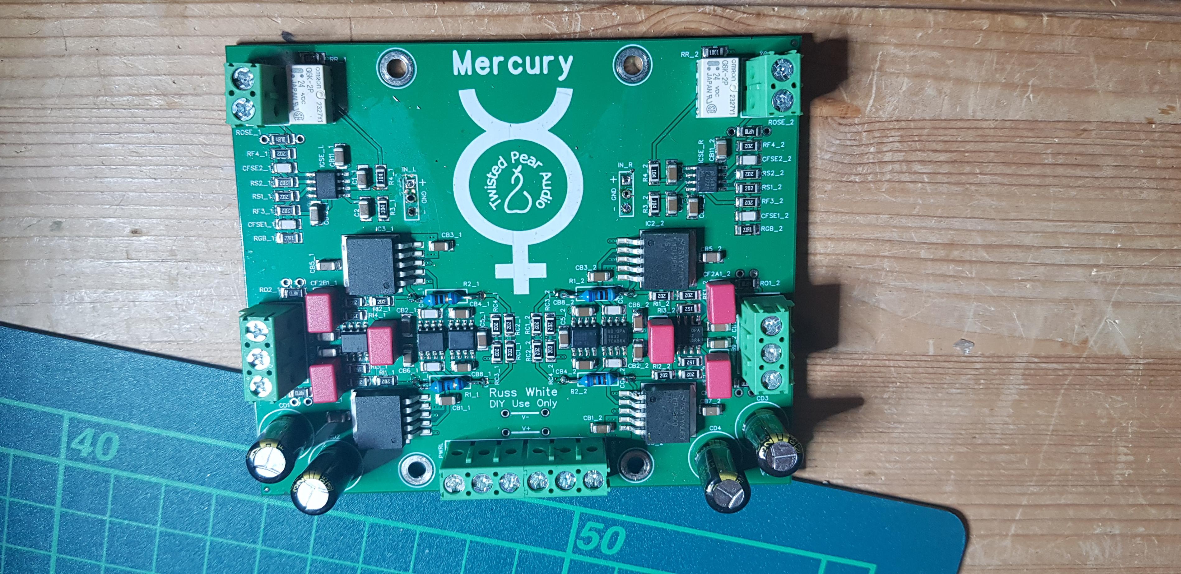

measuring 0.7 Ohms on SE out put
Hello ,
Nearly ready to power up my brand new Mercury card ,but measured 0.7 Ohms on the left and right SE out puts ,is this correct .
I have a old IVYIII and that measures 22 Ohms on the SE left and right out puts .
I do know twisted pair audio had a card that the components were mounted upside down and the customer got a new card .Please take a look and see on the image if all is well .Are the relays mounted correctly .found a simular post and i followed that for the orientation of the left and right relays .
Thanking you all again so much .
Regards shaun .

Thank you
Hello Stephan1212b,
Very kind of you to answer so fast ,really happy about the support people get on DIY Audio,great place to be .
I am running dual mono configeration and will solder the DACs directly to the Mercury ,yes i do admit it looks messing ,cleaned up now and looking much better .
Now i can continue and soon good music playing this weekend.
Thank you again for your kind support .
Regards Shaun
One small layout suggestion: test the system with signal wires that are long enough so each Buffalo can mount separately beside the Mercury. When you are satisfied, you could shorten those wires if you stack the Buffalo 3s on each side of the Mercury using two different standoffs - one into the Mercury that is just long enough to clear Mercury's electrolytic caps, and one longer one that supports the free edge of each Buffalo. The vertical layering feature of the B3's component design is very nice, and serves a purpose.

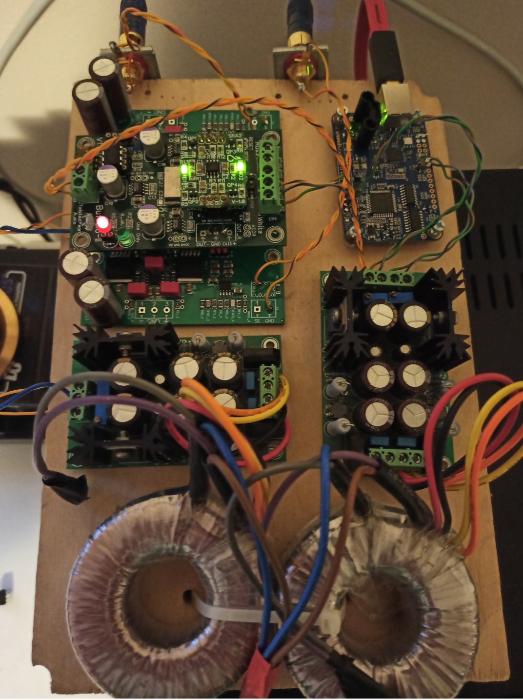

I have been trying to get the best possible sound from rescently acquired B2 dac with legato output stage. I only use SE output so I had to deal with bal/se stage... I changed many opamps but never was satisfied with the sound comoletely. My friend has B2 with legato but for bal/se he is using ventus, and I could never get close to them even when using really great opamps like opa1612 etc...
So I tried to go with Mercury... Boy does it make a difference.
It delivers hugely detailed and powerful sound, and I just can't belive how different can one dac sound based on output stage only.
Next step would be to upgrade power supply, but at this moment I just want to listen more muzaak 🙂
