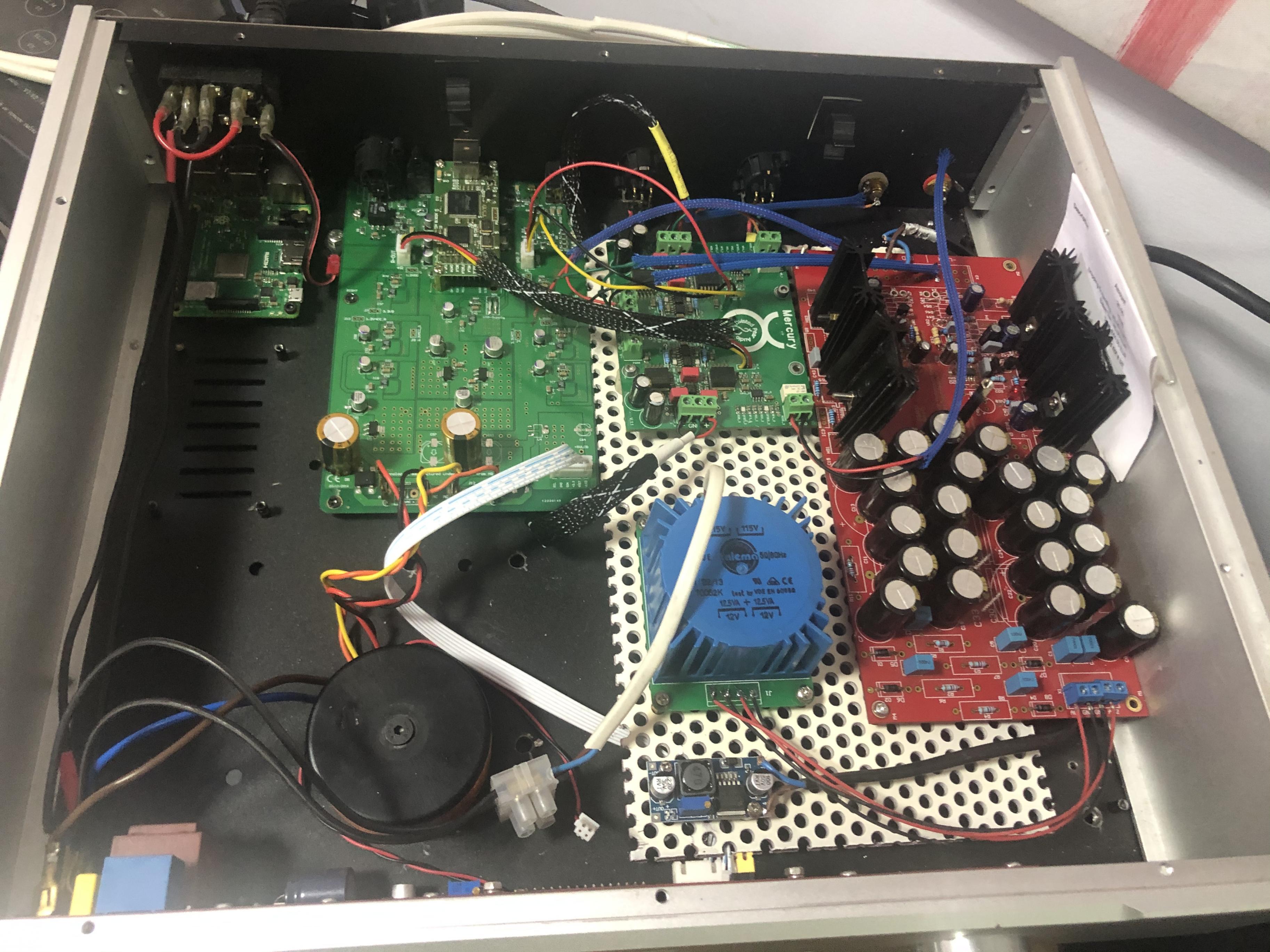

Hello ,
Now I am using 9039 pro (Quanhao )with mercury ic stage conveter ,but sadly
No sound . But direct Dac to pre amp is ok .
Voltage power supply SSR03 +/-15 volt rail .
But I don’t know power display on board or not now no light .
Pls help me what wrong?

It appears you are only getting one side of the Mercury. There are two jumper spots in from of the power terminals which will let you per both sides from one set of per terminals (or just run wire to both sides).
