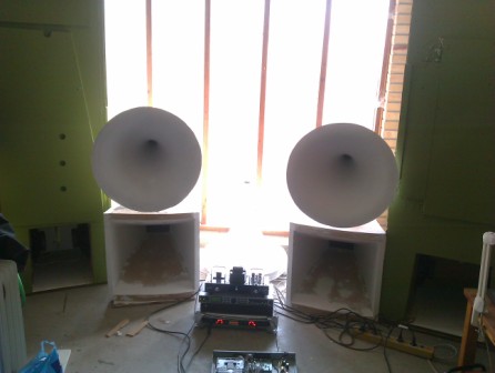

Yesterday I pulled the trigger and ordered 4 horn-rockets:
B&C 12PE32
Stronger motor, half the moving mass.
37gr. MMS, BL 19.1 and EBP 270 !

Actually I´m on a date with 4 italian virgins.
They stole my heart from the first sounds they whispered !

But the drivers got just a quick treatment. Just 15 minutes free air working with 20Hz. Couldn´t wait to test them in the horns.
The rest will settled the next days with loud music.
Most likely the rearchamber will have to be a little smaller next week, when they loosen some stiffness of the suspension.
But by now they are really stunning.

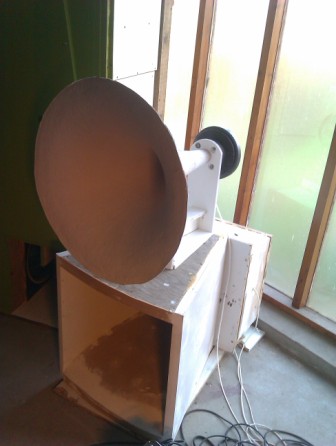

First congrat to you for your impressive midbass horns, top notch work. I´m also hooked on a couple of B&C 12PE32 for my midbass horn. Have to save some money first. The perfect driver for that kind of job 🙂
You took the long, environmental unhealthy road and with excellent result 😉

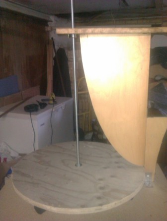

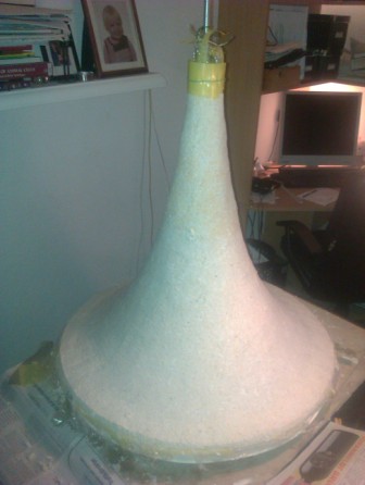

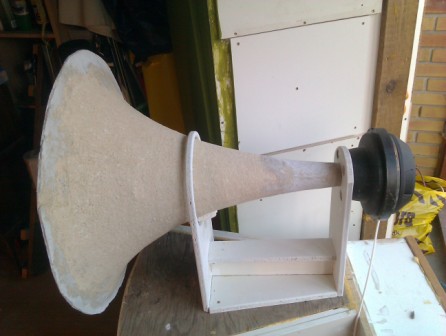

I took a different route and made a jig with a tractrix curve (I know, no round horns for you😛). Made the mould out of concrete and made a pulp of normal cottenpaper (paper for printers), sawdust, wood glue and some plaster.
Here is some pics of the process and result. This I have only done for the tweeter horn (420-20khz) but the plan is to make a bigger jig for the mid bass horn. This process is inspired by inlowsound.com, very interesting DIY guy.

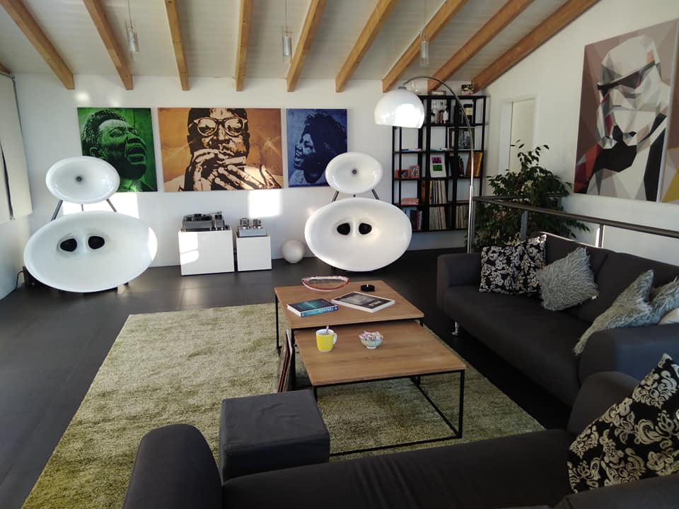

I´m currently working on room acoustics a bit.
The room before:
I want to bring down the reverberation time above 300Hz a little (bass is good, because all walls are built as panel absorbers) and I´ll try to add some more or less hidden acoustic absorbing “objects”
(I intended to turn the whole wall behind the speakers into an absorbing wall, but my wife insisted)
What I did until now:
Captain America: porous absorber behind canvas, stuffing 220cmx105cmx10cm / 2.3m², 5mm gap, >6 kPa ∙ s/m²
stormtrooper/C3PO: porous absorber behind printed acoustic cloth , stuffing 2x100cmx150cmx6cm / 3.0m², 3cm gap, >16 kPa ∙ s/m²
left tapped horn: covered with 2cm acoustic foam + carpet underlayer , 1.7m²
sliding curtains/panels: 2x 280gr./m² cloth plus 2cm acoustic foam 4 pieces 150cmx60cmx2.5cm / 3.6m² , 10cm gap
curtain: 300x600cm / 18m², 280gr./m², gap 15cm (will give me something like 0.3@300Hz/0.4@500Hz/0.6@800Hz and above)
- 2 Basotect Panels 50x100x10cm, gap 10cm, as “mobile devices” placed behind the midbass horns (only when listening)

I believe that a reverberant time of 0.6 sould be optimal, try clapping your hands to get an idea on how big the problem is.
You have a rather large listening space. How close are you sitting when listening to music?

I sitting appr. 4m away from the hornmouth (nearly 5m from the drivers/wall).
This means I have ~3m behind me and I´m not sitting in the middle (a little 50Hz mode in the middle).

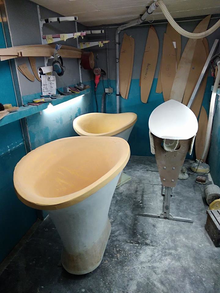

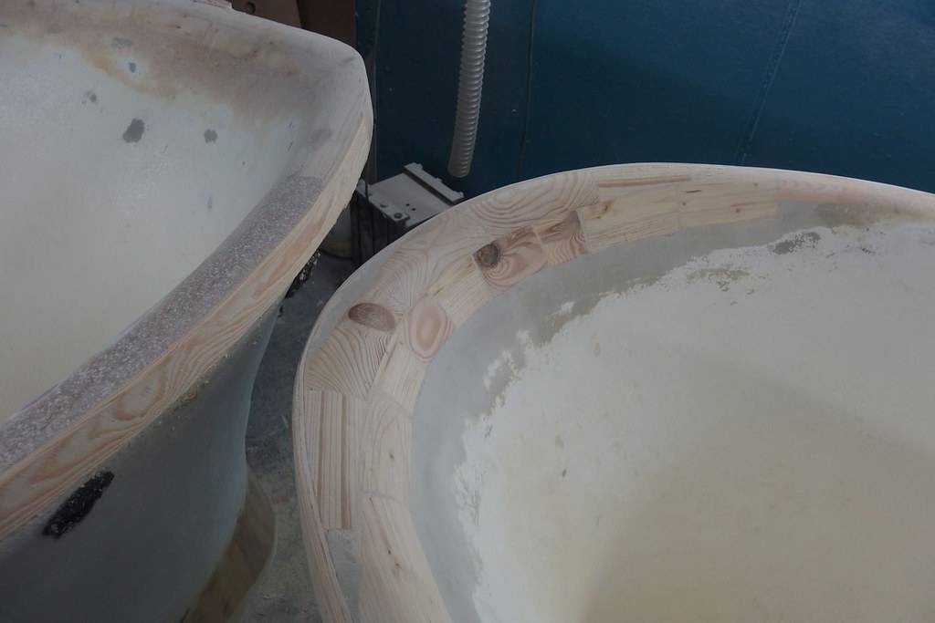

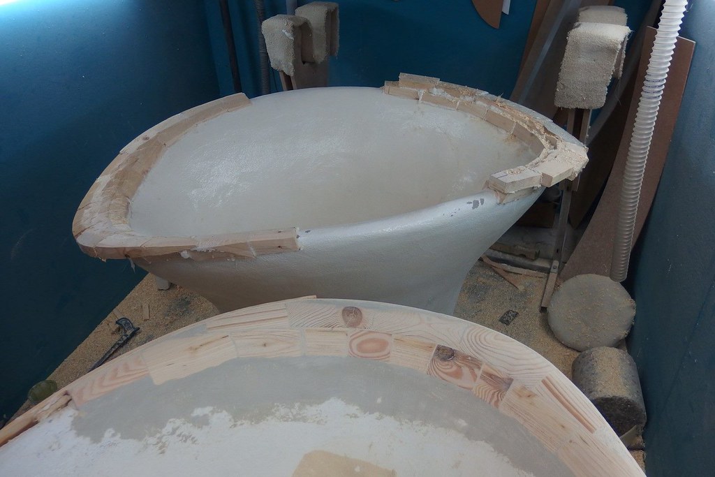

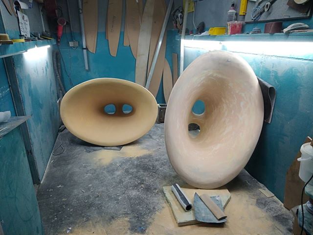

I revised the midbass horns a bit and I´m still enjoying them a lot.
- smooth out the irregularities in the shape
- add a stiffening and dampining frame to the mouth
- stiffening of the throat and make it look a little more appealing
- spackle everything
- sanding, sanding, sanding...
- new paintjob (white inside, flat lightgrey outside)
The frame around the mouth extended the lower cutoff apr. 5Hz.
