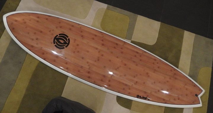

My board is a hybrid, yes. (7.2x22.75x3)
It has 5 fin pockts, so it can be a thruster, but I´ll first try to run it as a quad. A lot of big guys recommended it. Won´t be able tod do cutback soons. 🙂 I´m happy to if I manage a a bottom turn from time to time (2x2 weeks surf holiday till now).
